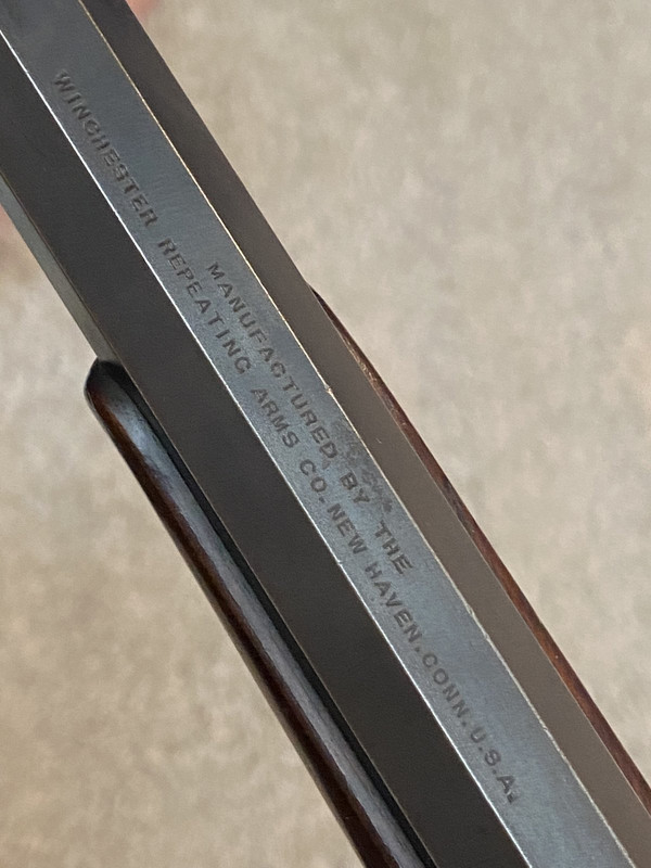

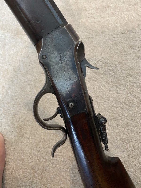

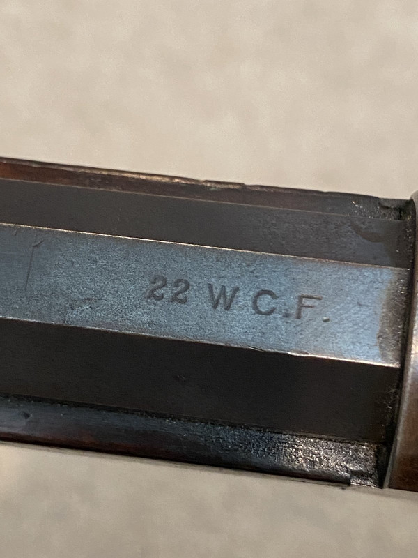

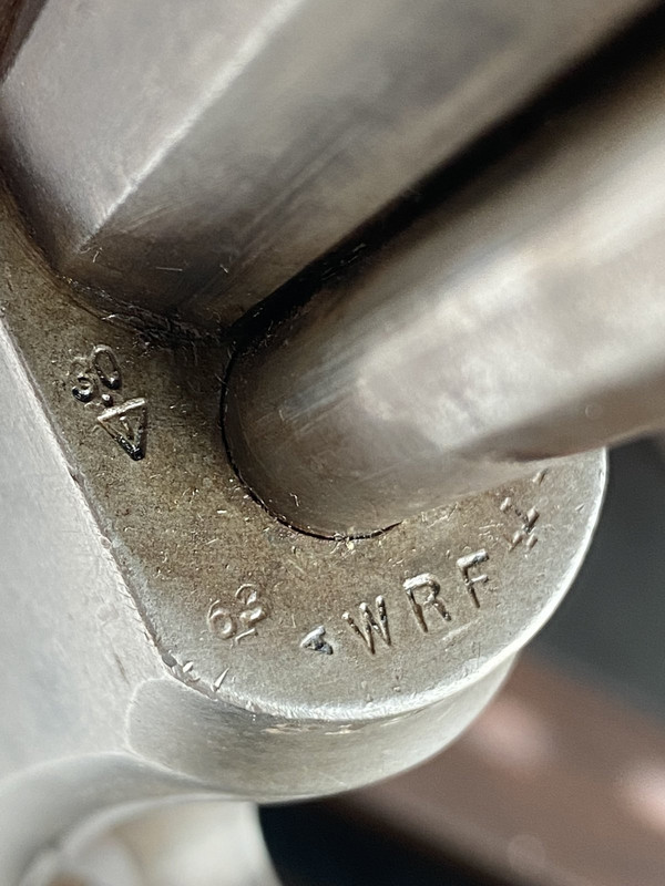

‘I recently moved across country and am unpacking my old rifles. I have always loved Winchesters. My father passed down to me a model 1885 low wall, serial #86963 in 22 WCF. Very clean. Barrel looks good. My father called it a Hornet but I don’t know if that is correct. Would you folks advise me. I will be researching in the meantime. There are very few markings. I would just like to bring these rifles up to speed and shoot for fun. Here are a few pix.

Your Winchester Single Shot rifle (a.k.a. Model 1885) was manufactured in October of the year 1900.
The 22 W.C.F. cartridge was essentially the black powder predecessor to the 22 Hornet, but it used a slightly larger diameter bullet.  The 22 WCF bullet was .228″ whereas the 22 Hornet uses a .224″ bullet.  22 Hornet ammo can be safely fired in a 22 WCF chambered rifle, but the accuracy will more than likely be marginal.  You can fire form 22 Hornet cases to reload using .228 bullets and be in good shooting shape.
Your Model 1890 rifle is what we refer to as a “Frankenchester”… a gun assembled from the useable parts from more than one donor carcass.  It has no value or interest in the collector arena but should be a reasonable “shooter”.

Marc, are you looking for a period box of ammo for display or are you wanting to shoot the rifle?  If you plan to shoot it use Hornet brass and some .228″ bullets.  Both are easy to find.  You fire form the cases by using a mild load.  I was shooting mine before I had dies.  If you use Hornet dies don’t full length size.  Just size the neck.  The neck can be belled just enough to start the bullet by using a tapered punch.
