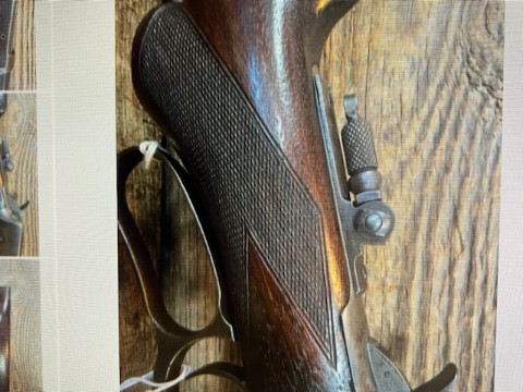

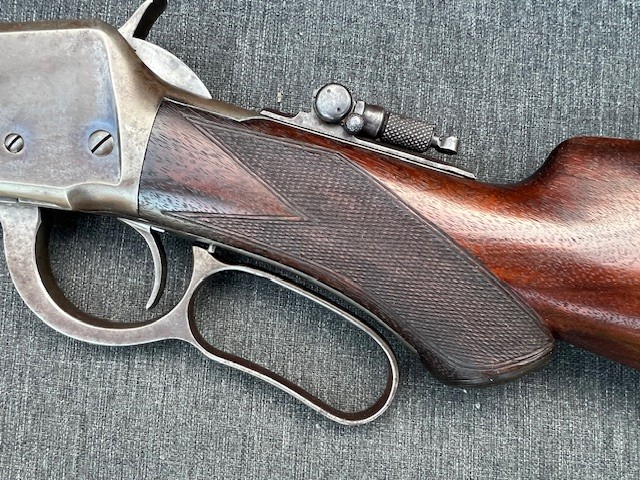

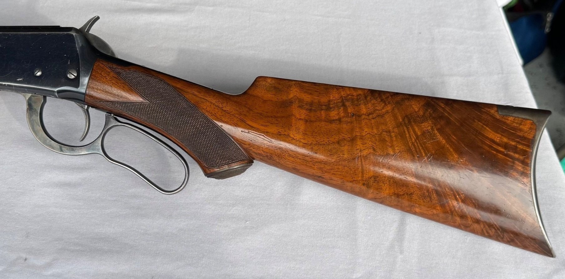

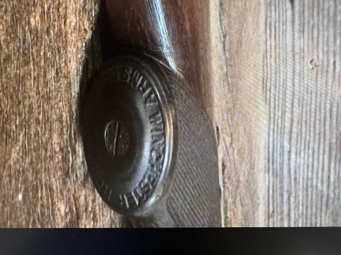

I know this is a poor picture but I was wondering if this checkering looks correct for a 1907 model 1894?
Forum Posts: 2553
October 19, 2026 - 4:50 pm
Yes.
October 19, 2026 - 5:04 pm

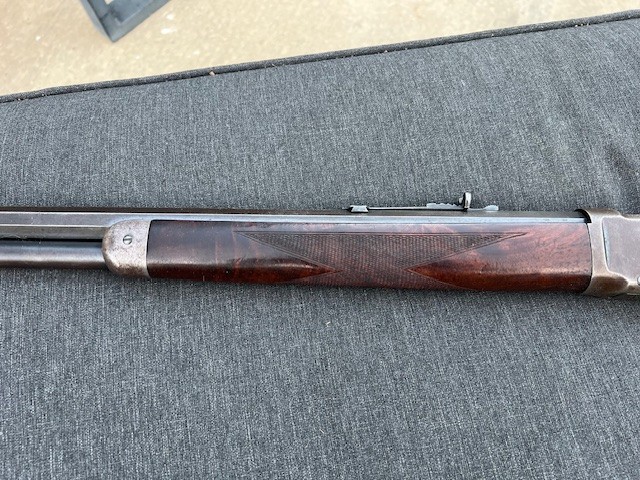

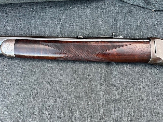

What does the checkering on the forend stock look like?
I personally do not believe the checkering on the pistol grip is factory original.
R.Marshall
Forum Posts: 40
February 24, 2019
October 19, 2026 - 5:23 pm

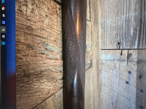

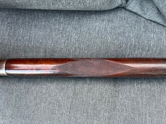

pictures of forend
October 19, 2026 - 5:48 pm

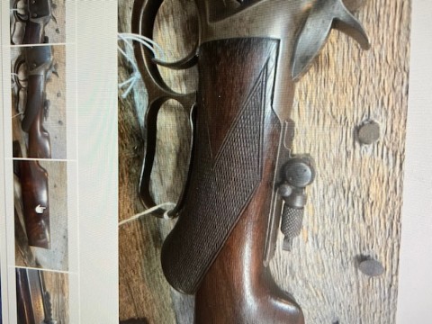

Please add a clear 90-degree side view picture of the pistol grip area like this example;
R.Marshall
Forum Posts: 40
February 24, 2019
October 19, 2026 - 5:50 pm
The rifle has deluxe wood and everything looks to have the same wear. Wood to metal fitment looks pretty good. Chambered in .32w.s.

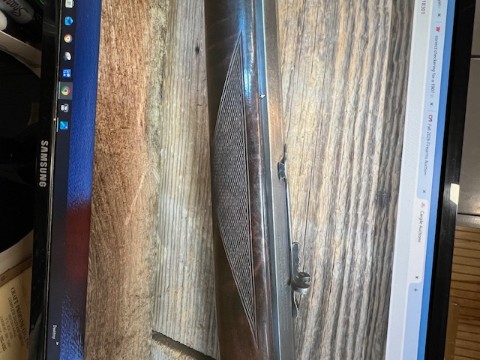

Sorry Bert this is the best I can do right now.

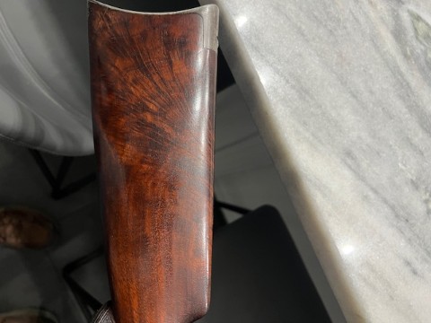

opposite side of grip and a poor pic of the bottom side

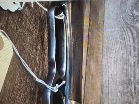

one more

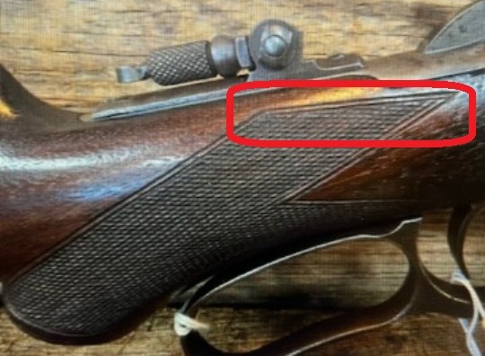

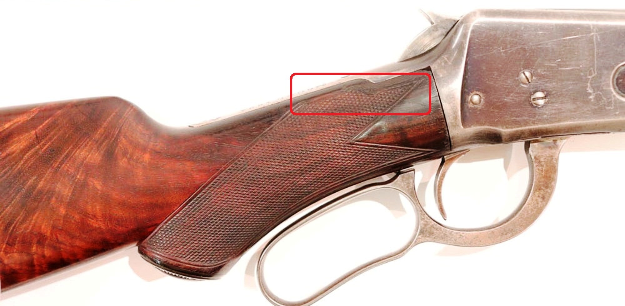

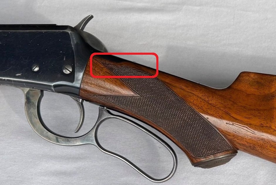

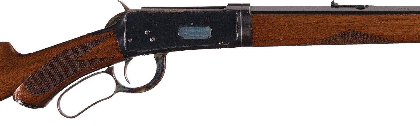

The checkering pattern on your Model 1894 does not exactly match the H-pattern found on verified factory original specimens from the same time period.
Specifically, the area that I have hi-lighted in your picture and mine.
Your rifle…
Verified factory examples…

Thanks for the info Bert.
Your rifle…
I agree with this assessment.  At first, it appeared to be a pistol grip with checkering, but the subtle differences…. Do you think it was a plain pistol grip rifle and checkering happened later?  I imagine it’s just beyond the range in which factory letters are available?

The pistol grip looks like the I checkering pattern, but the forend is not a factory pattern.
October 20, 2026 - 4:11 pm

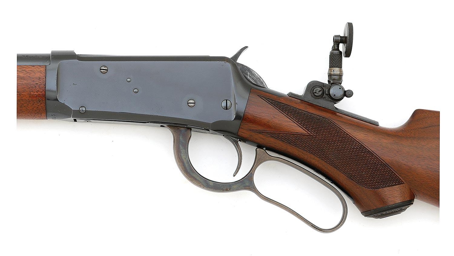

This is factory I-pattern on a pistol grip… noticeably less total coverage.

I thought the forend looked correct for a full deluxe rifle and the pistol grip looked like a cross between the I and H pattern. The wood looks to be upgraded to deluxe. I’ll have it in my hands this evening. Maybe kill a deer with it later this season.

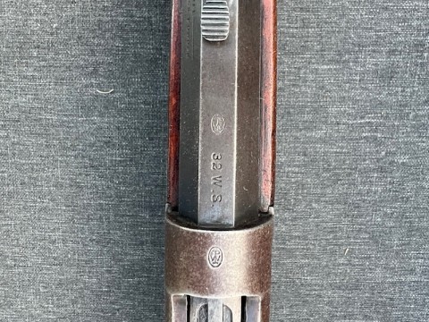

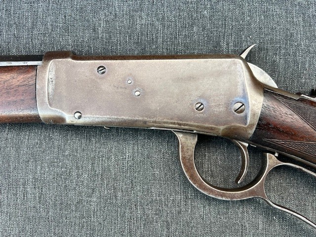

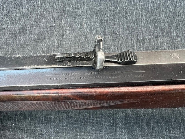

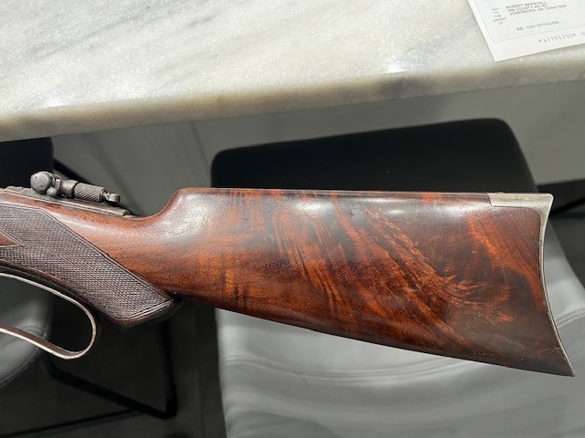

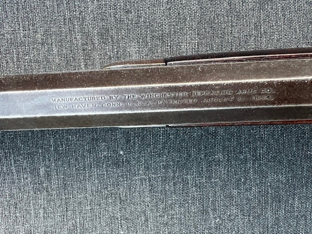

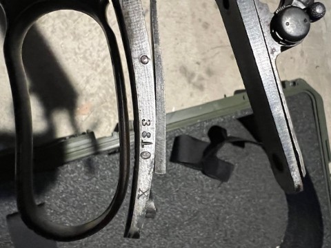

I picked up this rifle yesterday afternoon. It looks better in person but it does have a toe repair that was not mentioned. Here are some more pic’s
IMG_1063-1.jpgIMG_1061-1.jpgIMG_1060-1.jpgIMG_1059-1.jpgIMG_1050-1.jpgIMG_1051-1.jpgIMG_1046-1.jpgIMG_1062-1.jpg
October 21, 2026 - 4:20 pm
It appears to have a slightly modified version of the factory H-pattern checkering on the pistol grip of the stock.  In viewing your latest pictures, it does appear to be factory work.  Is the serial number early enough to get a CFM letter for it?

Based on my research survey, I am now of the opinion that your rifle is 100% factory original. The picture below is a snap-shot of my survey file.  It appears that Winchester made a small batch of similar rifles in that serial range.
