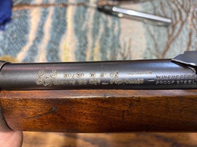

Here are the Pics of the proofs on my Model 94

Its got two sets of proof marks. The original ones with letters in a circle and the word Cordite and the bullet weight and case length are Birmingham proof marks which is interesting.
The circles around the letters such as NP and BP are or when the firearm is of foreign manufacture. Its bit hard to read nut it appears to have the stamping for NOTBRITISHMAKE but the form of this looks a bit different to usual. These markings would have been applied during 1925/1955.
There is a a second and I think latter proof next to the WCF on the barrel. This will be some letters and a number through crossed pennants or flags. Have a look at these with a glass and if you can read them clearly I can give you the date this second proof took place.
