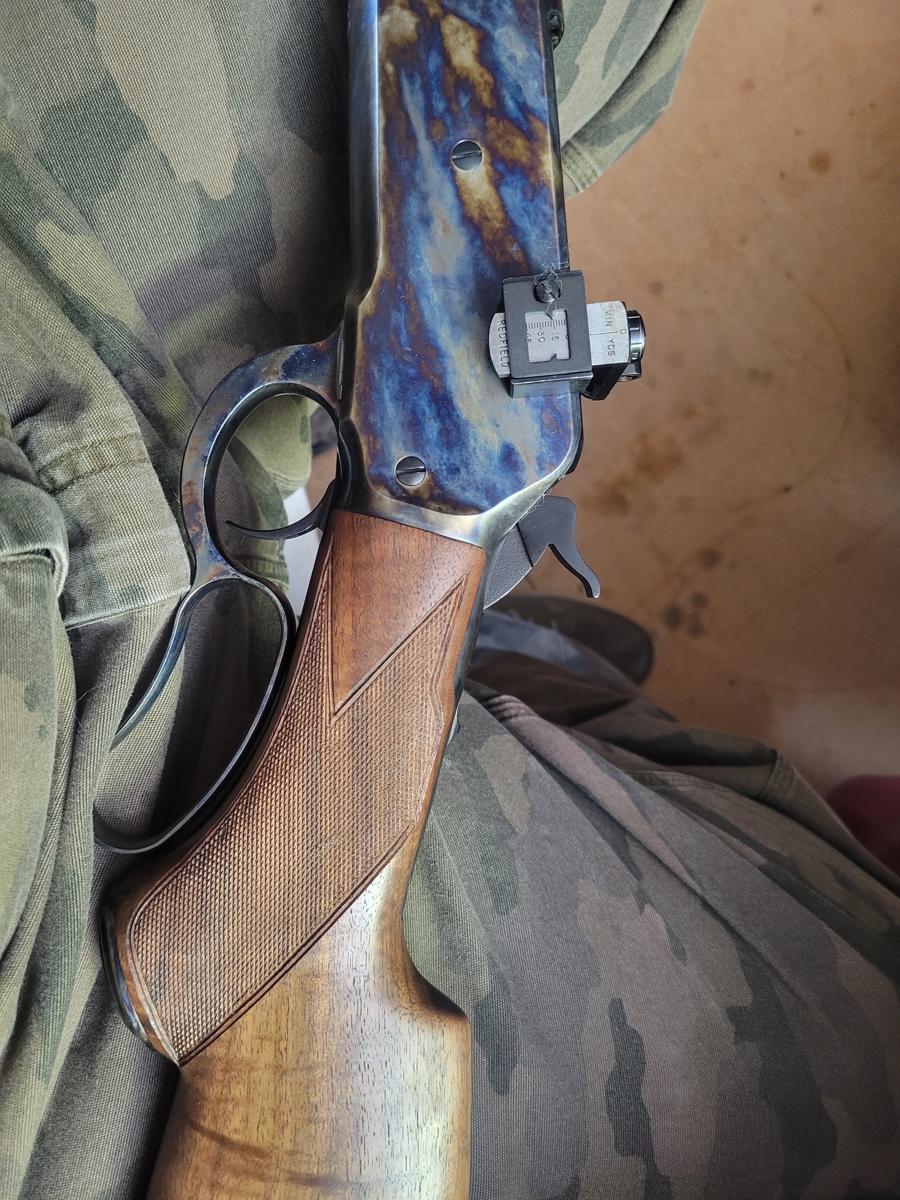

Were bolt peep sights available from factory on short tang Model 71’s.
Am  I correct to assume that the bolt peep sights were prone to breakage due to how high they sit above the receiver 9compared to side mounted receiver sights)?I have assumed this to be the case given the large number of bolt peep 71s I’ve come across which are missing part or all of the sight.

I will hazard a guess along with some information. I don’t know the exact date the 98A ceased to be standard issue and the Lyman 56W replaced it but it was well after the short tang was adopted. The late Fortiies.
I believe a number of Model 71 rifles were assembled with bolts drilled and tapped for the 98A, after the 98A inventory was depleted. Winchester didnt waste useable parts.
I also believe bolt peeps were.stripped from.some existing rifles becaus demand for the sights is strong and the sights can be worth as much as the rest of a heavily used rifle.
July 26, 2026 - 12:11 am
The “short” tang Model 71 was introduced in late June 1939 and replaced the ‘long” tang by mid July 1939.  The No. 98A bolt peep sight was used through 1947 when it was replaced by the Lyman 56W receiver mounted peep sight (January 1948 catalog).  I discussed this in my last Model 71 article in the Summer 2021 edition of the Winchester Collector magazine – Summer 2021 (winchestercollector.org)
The No. 98A bolt peep sight was actually quite robust, not prone to breaking.

The bolt peep is very compact, sturdy and about as close to the eye as you can safely get. It leaves both receiver walls slick.
Although the 98A is not a finely adjustable micrometer sight — more of a set it once and leave it alone device — it was expensive to make, requiring a lot of machining.
At one point, NECG made a fine replica of the 98A but it was almost five hundred bucks years ago.
That is why the Lyman 56W and the Redfield 70 replaced it. It is probably my lack of experience but I’ve actually seen more Model 71 rifles with the Redfield 70 than the Lyman versions. Redfield was a catalogued option at one time, I believe.

I have 71s with both the old Lyman and Redfield sights. I find the REDfield sight more “elegant” (aesthically and in the finest of the machine work) and more pleasant to use.
I am still leery of the bolt peep regarding robustness.It sits higher above the receiver and looks like it is waiting to be damaged when going into or out of a horse borne scabbard. But it sure is pretty!Laugh

I have a Merit Disc in my bolt peep on my 1936 m71 . Not sure what the thread is bur the same disc fits the Lyman 21 sight that’s on my ’92 Winchester .38/40 rifle. I prefer the bolt peep or the m21 , they don’t go on target rifles so I don’t expect target grade adjustments . They are both hunting sights pure and simple . Both adjust as fine as I can shoot with the rifles they are on , they just require a bit more fiddling to get them to do it. Mine has been on my m71 since 1936 and is still in good condition so I doubt they had any structural weakness . I agree with the above posters that the missing parts were taken off by previous owners for some other reason other than breakage.
