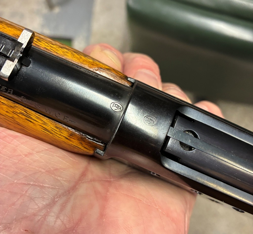

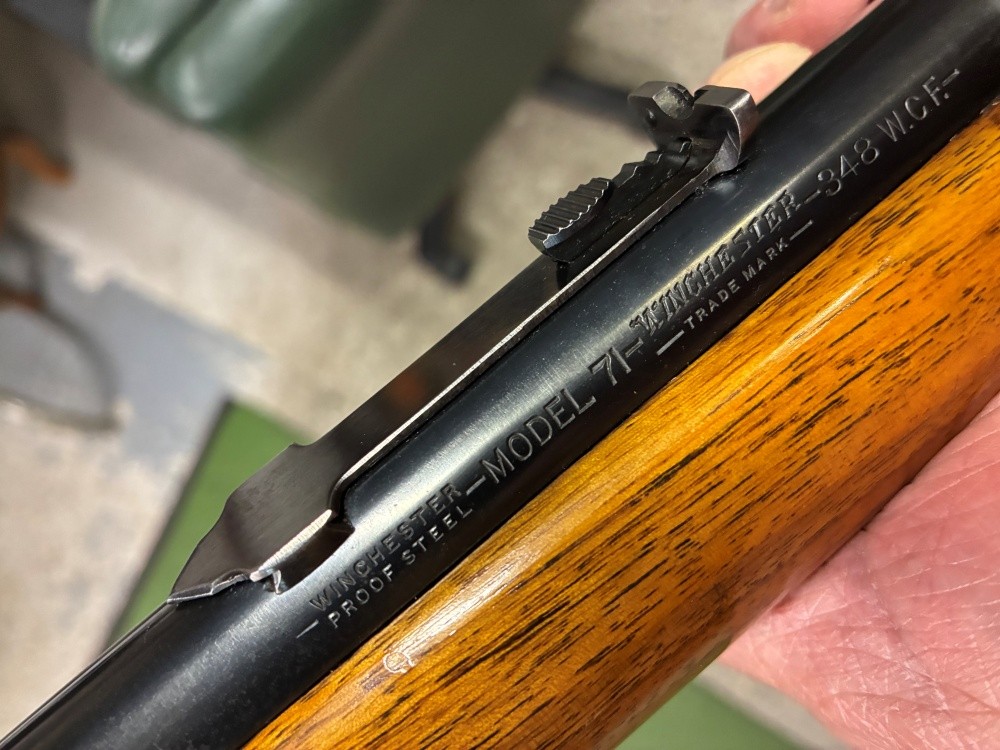

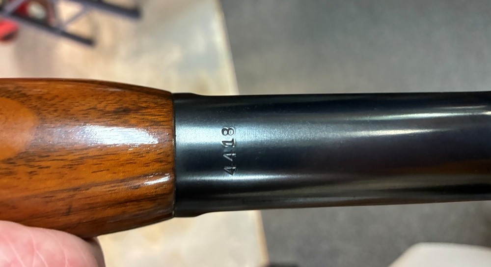

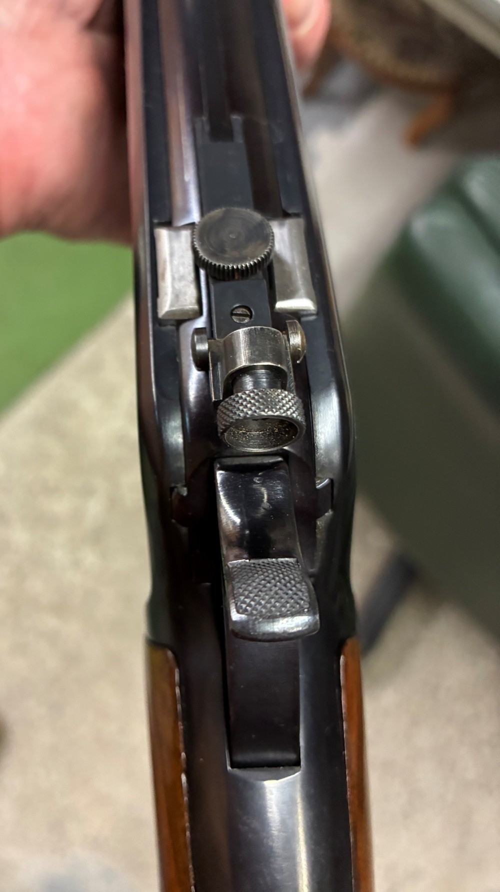

July 25, 2026 - 3:54 pm
The proof mark stamp on the frame ring is partially “washed” out, indicating it was lightly buffed and then reblued.  On an original early production Model 71, the barrel should have a flat (uncrowned) muzzle face that is in the white (not blued).

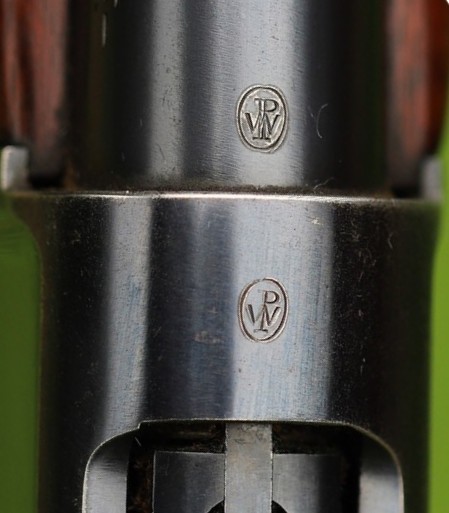

This is what the proof mark stamps should look like. Note the slightly raised perimeter edges and the “graying” of the raised edges.
Also of note, the barrel mounted rear sight is not original.  Winchester never installed a sporting rear (open) sight with a No. 98A bolt peep sight.
Whoever it was that refinished did a very professional job of it.  Overall, the rifle looks really good, and it would be difficult for most people to ID it as being refinished.

Over the years I have seen a few Model 71s and Model 64s with the bolt peep and a barrel rear sight that appear to have come that way from factory.  Is this possible?  RDB
July 28, 2026 - 6:40 am
I am not of the opinion that Winchester would have installed both a bolt peep sight and a barrel mounted sporting sight as the two sights interfere with one another’s sighting plane.  I suspect that the barrel mounted (dovetail) sights were added by a former owner/dealer.

In addition to the added barrel sight, the 3 extra screws visible on the left side of the action show there was a scope mounted on the gun at one time, too.
