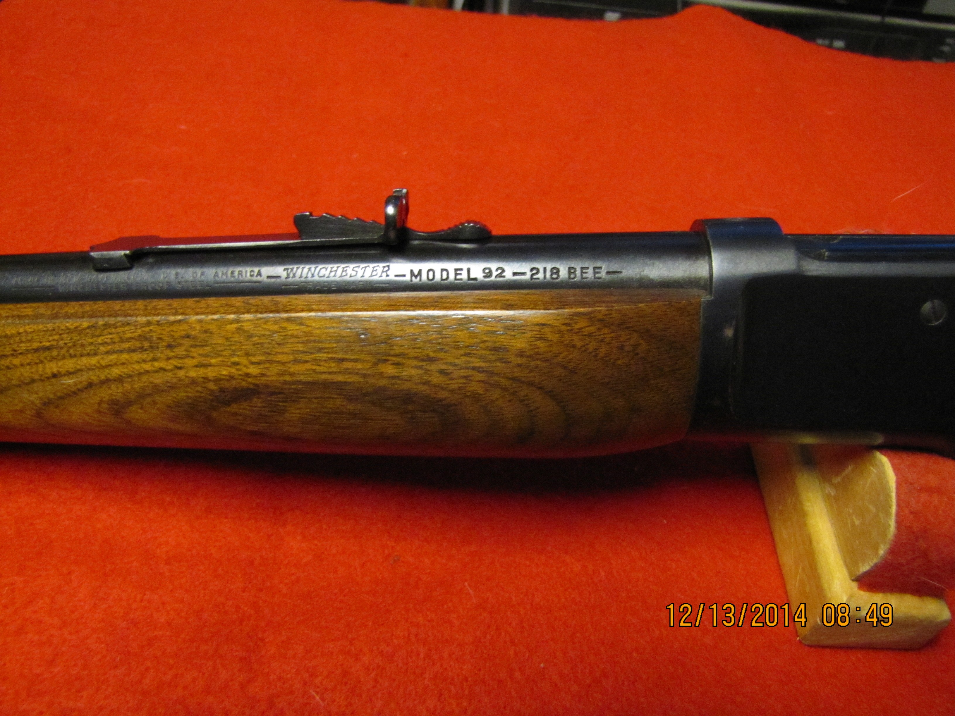

I didn’t know whether to use the existing 218 Bee thread or start new one, so I started a new one, this one is for a 92.
I don’t own this rifle, a friend of my son does and he wanted to know what the rifle was worth. I told him I had no idea, but I
would ask the forum.
This man is in his 60’s and his father left him the rifle, the Winchester Collectors site said the rifle build between 1921-1928.
I know there are suppose to be no 92 218 Bees below 1,000,000 s/n.
Looking at the photos the forearm doesn’t right and I can’t say I have seen factory lettering on the right side of the barrel below
the rear sight.
Any information would be appreciated.

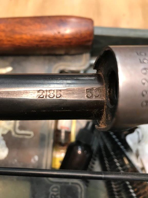

Bert, sorry it took so long to respond, the fellow had a death in his family.He got the forearm off and the barrel is stamped with #50 and 218B
I believe the barrel is 24 in.
Does it look right to you
Thanks
Bill
Forum Posts: 14671
August 20, 2018 - 2:04 am
Bill,
That is a Model 43 barrel.  It could have been installed by Winchester sometime in or after 1950.

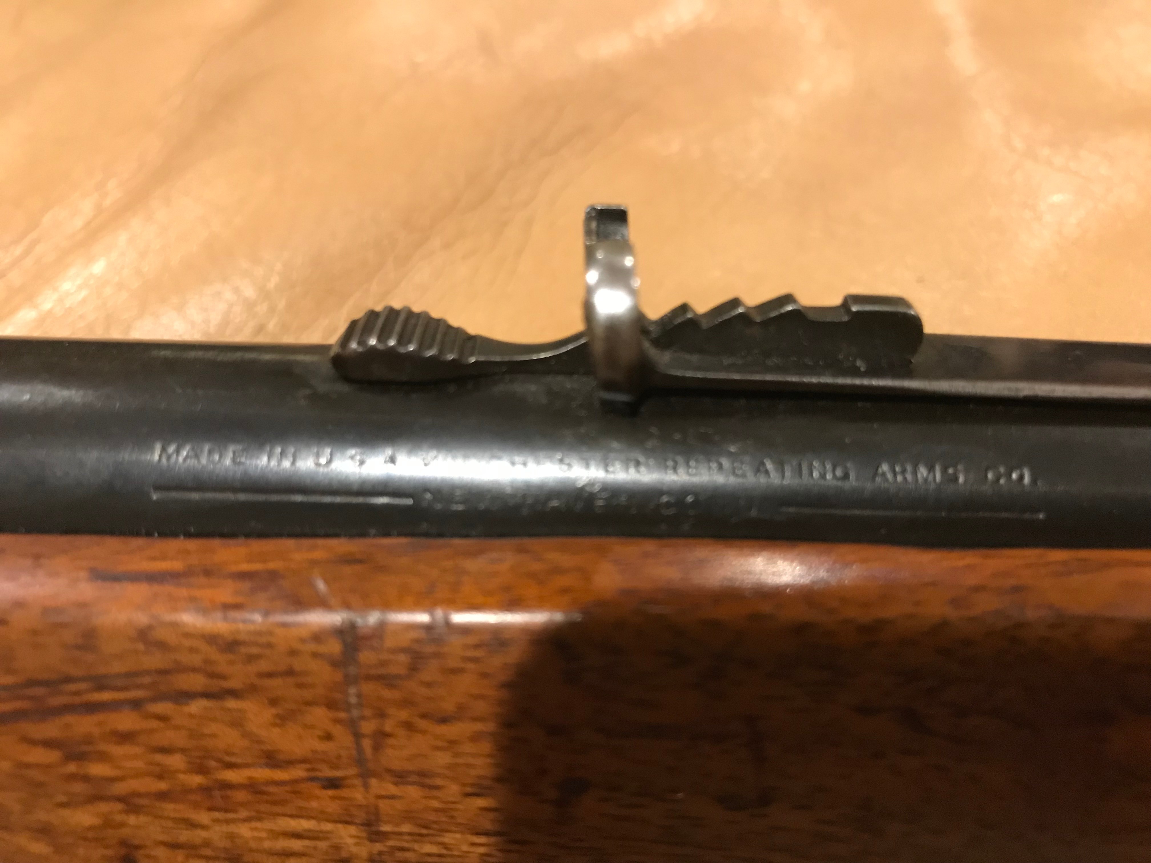

Dan G
June 1, 2020 - 4:38 pm
I have the exact same gun .I have had it for 25 years .It has the same barrel markings and proof marks on the receiver and barrel. same front sight . All is exactly the same

Dan G
June 5, 2020 - 12:29 pm
Bert i do not want to sell the gun but does it have any value or is it just a shooter?   Any information would be nice.                                                                                                                           Thanks Dan G
Forum Posts: 14671
June 5, 2020 - 2:22 pm
It has value over & above a shooter.  Exactly how much is hard to say, and will depend on the knowledge level of the buyer.
