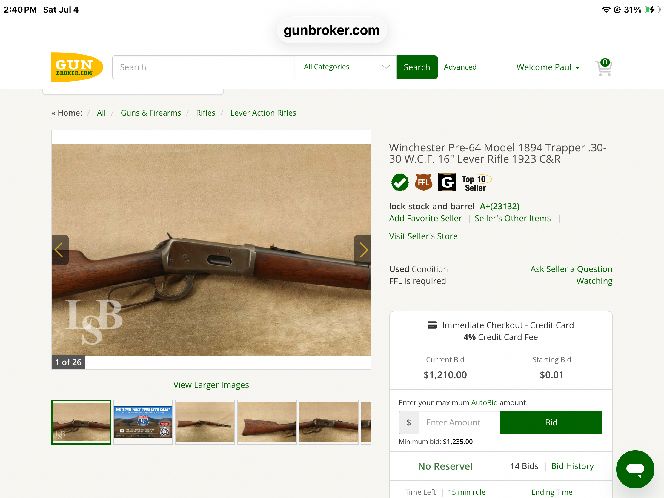

On GunBroker this week as listed by Lock Stock and Barrel is a later model “94” in the Trapper configuration. Looks to be legit but I’m not too well versed in “Trapper” models.  If anyone has the time after the 4th to check it out and render an opinion it might be educational and would certainly be appreciated.  The pictures aren’t great—ad says it’s been refinished. It’s late enough to have proper “walnut” stocks w/long forend wood—the pinned front sight looks correct in relation to the barrel band—a saddle ring is present. A few days remain on the auction and it’s already generated some interest.  Thanks for all your inputs and expertise.   PH

As for the Trapper in question, it appears to be legitimate.

It is a nice looking 1894!

The gun is not legit tThere are two red flags wrong fore arm and the barrel marking are in the wrong place and look at pitchers 9-13 you see the sight has been put on this gun

I disagree.
Unless you have exceptionally acute (x-ray) vision, the quality (resolution) of the photos (9, 13, & 22) is not sufficient enough to determine if the front sight post was installed after the fact.  Based on its position on the barrel, it appears correct.
The barrel address roll marking in is the correct location for a 16-inch barrel. On the 14″ and 15″ barrels, it was moved forward of the barrel band.

Barrel address roll marking are not in the correct location if has the correct short  forarm  i have a 16 inch 94 it in front of the barrrel band

James,
I have seen several Model 1894 and Model 94 16-inch Trappers.  The early (Model 1894) usually have the roll marking forward of the rear barrel band, but many of the later (Model 94) 16-inch Trappers have the roll marking located behind the rear barrel band.  The Trapper in question is one of the later production Model 94s.

Looks like this all original, REFINISHED, 1894 “Trapper”, sold for $4,132.00! Amazing to me, what a refinished example could go for in the 16 inch barrel configuration.
