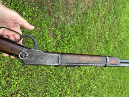

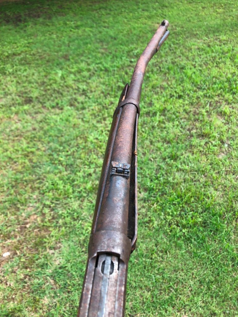

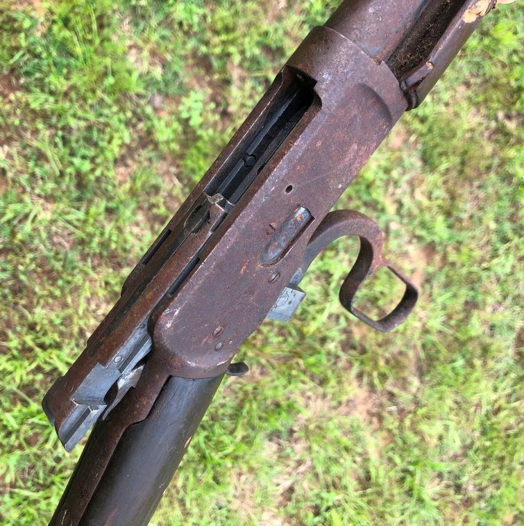

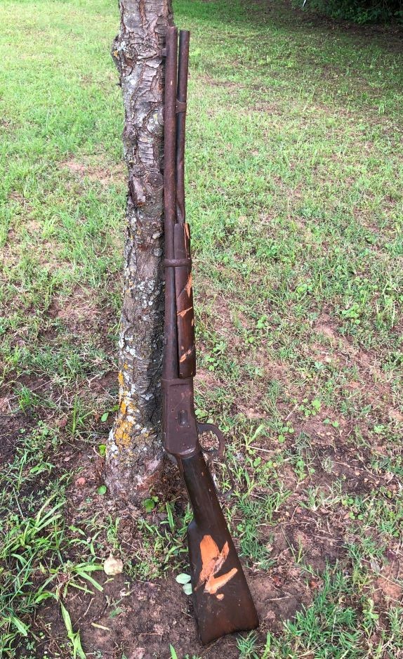

45 years ago, a young man decides to buy a farm in Mckinney, Texas to raise alfalfa hay. He would plow at night because of the hot Texas heat. One night, he noticed a few coyotes and decided to bring his 1917 Winchester 1892 chambered in 32-20 along the next night to pick off a few of them. When he got home, he found that the Winchester, which was riding on the back of the tractor, had fallen off. The young man searched and searched but never found his beloved Winchester. The following year, he was back at the plow, breaking ground for a new crop of alfalfa ,when he thought one of his disc had hit a rock. Low and behold, it was the Winchester! An so, here she is. Some rust. Some stock damage. Some barrel and magazine tube damage but an action that is as smooth as the day it was made. A testament to the truly strong, well designed Winchester 1892 action!

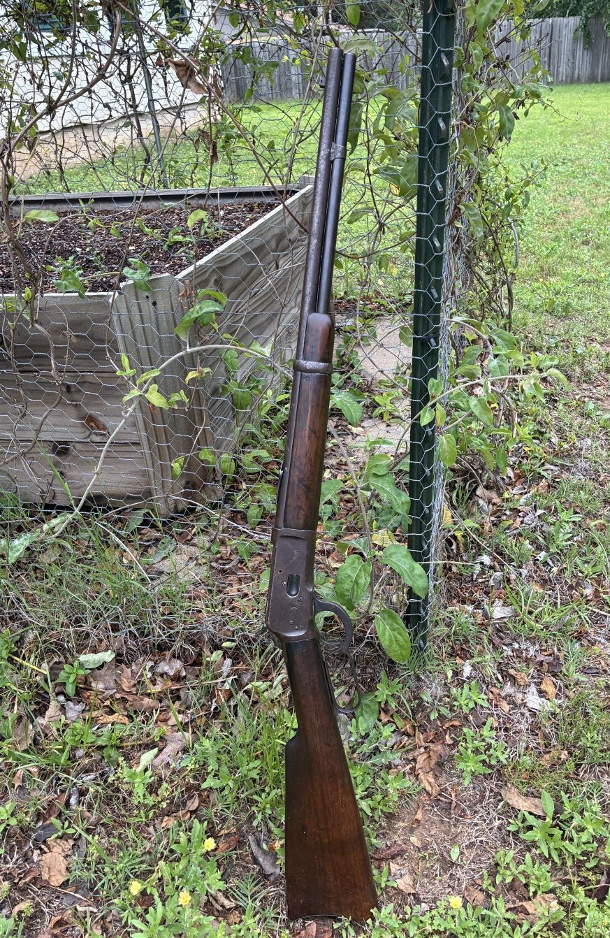

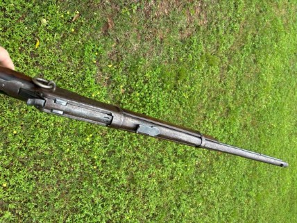

Moving forward 5 years, I have began the restoration/conservation of this rifle in his memory as he has since passed away. I straightened the barrel as best I could for proper assembly, found some decent replacement wood and a magazine tube. Im still searching for a 20″ 32wcf barrel though. I cleaned the metal with Big 45 Frontier Cleaning Pads. I am anxious to shoot it! Enjoy the before and “almost” after pictures as well as the story.

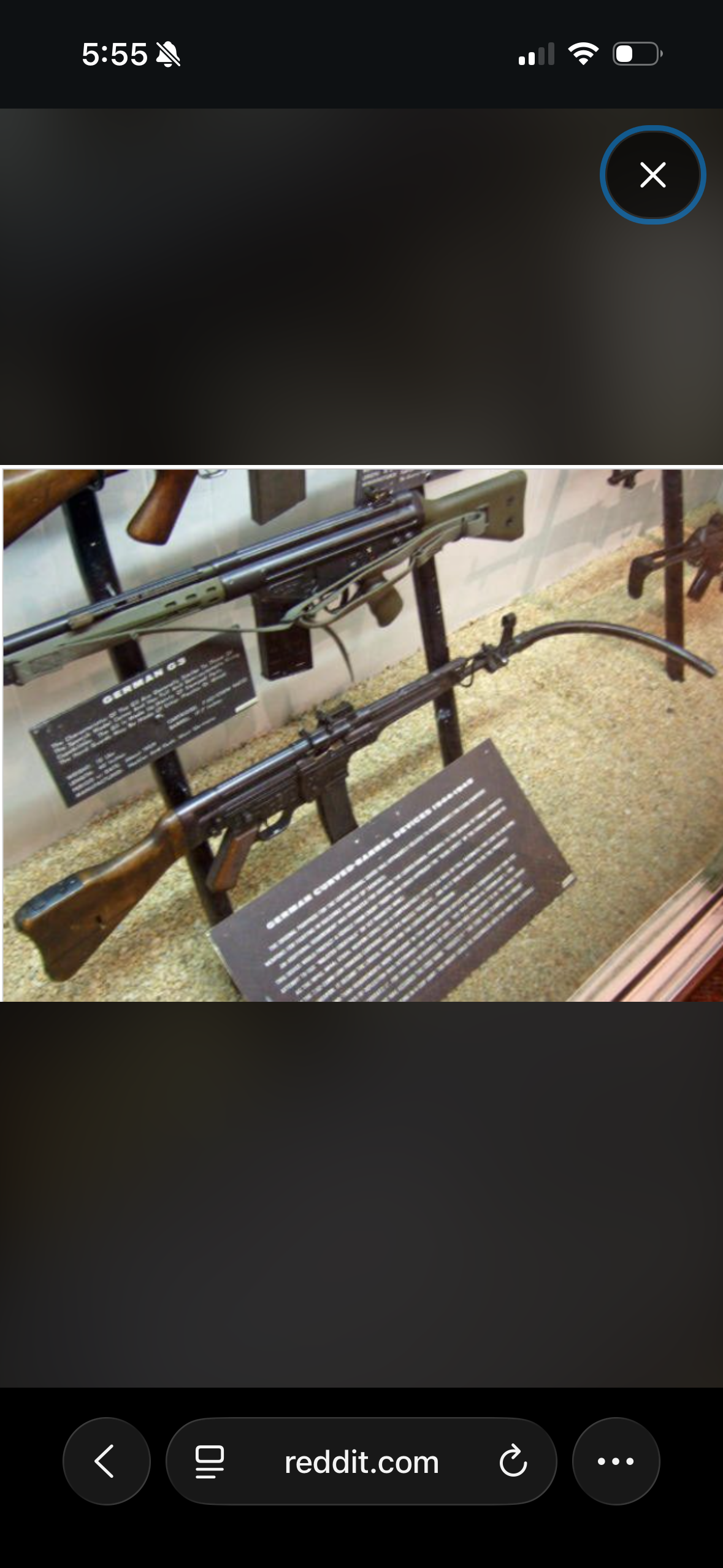

You’re talking about this device that the nazis came up with toward the end of the war for inner city fighting.  I believe I’ve seen one for the k98 that had a mirror mounted to it for sighting.  The history channel stuff is crap.  On you tube, look up demolition ranch and his last video on shooting through pipes.  He did it several times and I’d say perfected the test.  That barrel seems to have a kink, that I’d expect would explode the barrel.

I believe MidwestCrisis is correct. A curved barrel might work, a sharply bent barrel will have a restriction that will dramatically raise pressures, likely even after attempted straightening. I would advise slugging it to confirm but you would need a flexible rod to drive that slug. A bore scope may be helpful, maybe not. I like the replacement barrel idea.

Ive actually got this one straight enough to shoot right now. There is  still a slight ‘S” curve in it but, I wouldnt be afraid to shoot it. Im sure accuracy and velocity would suffer though. The bore aint bad but it aint good either.  I can wait on a barrel 🙂
