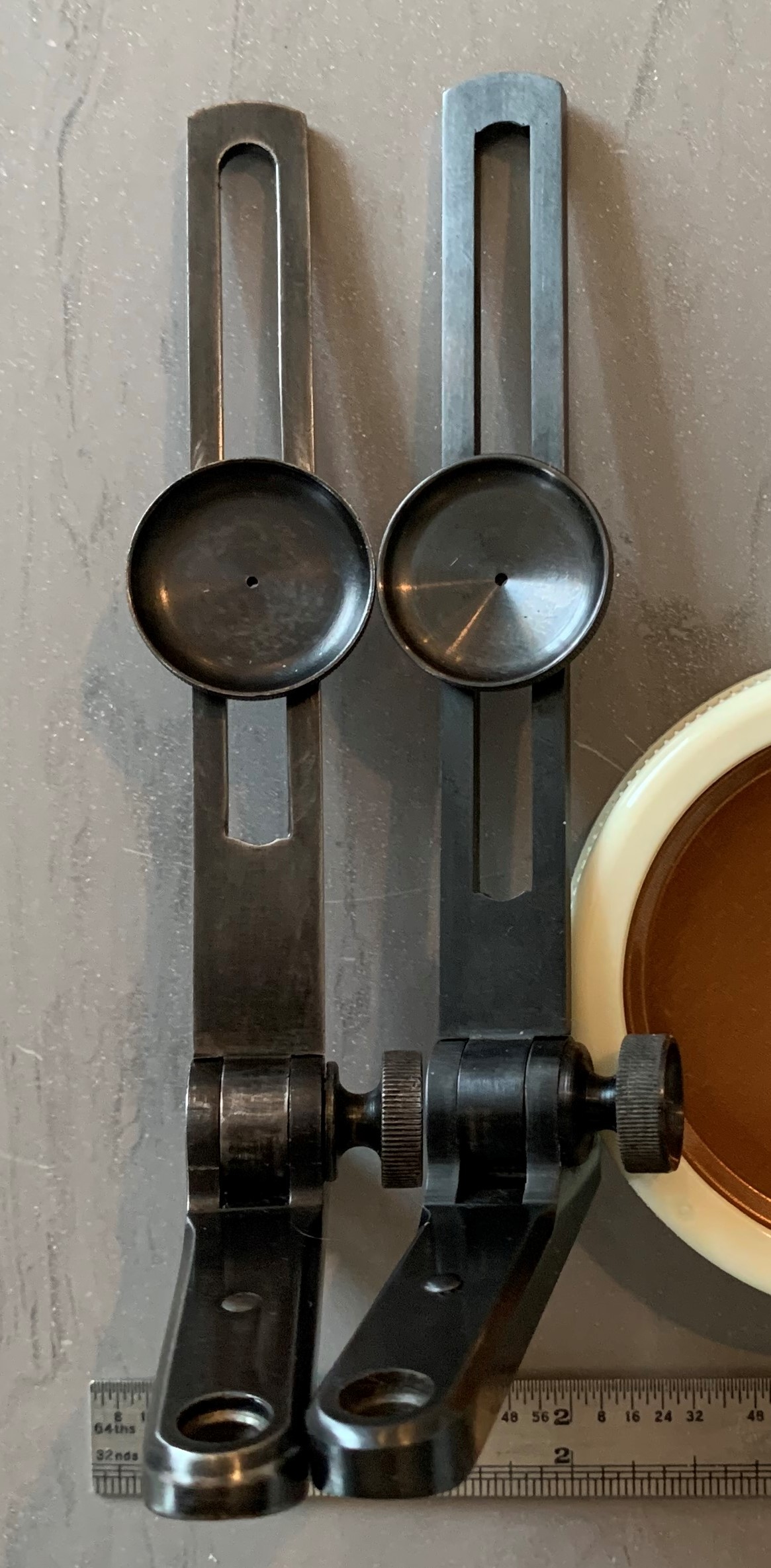

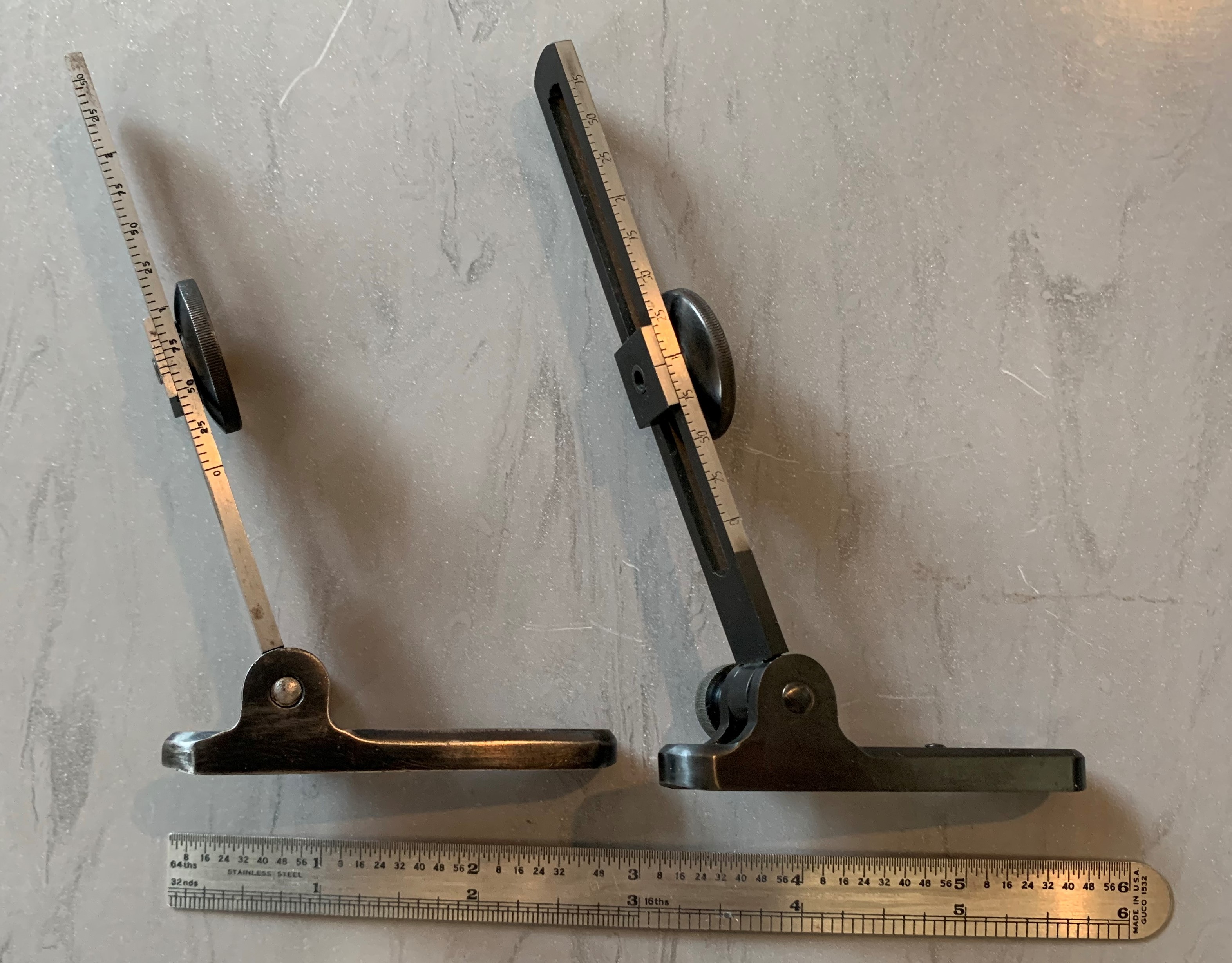

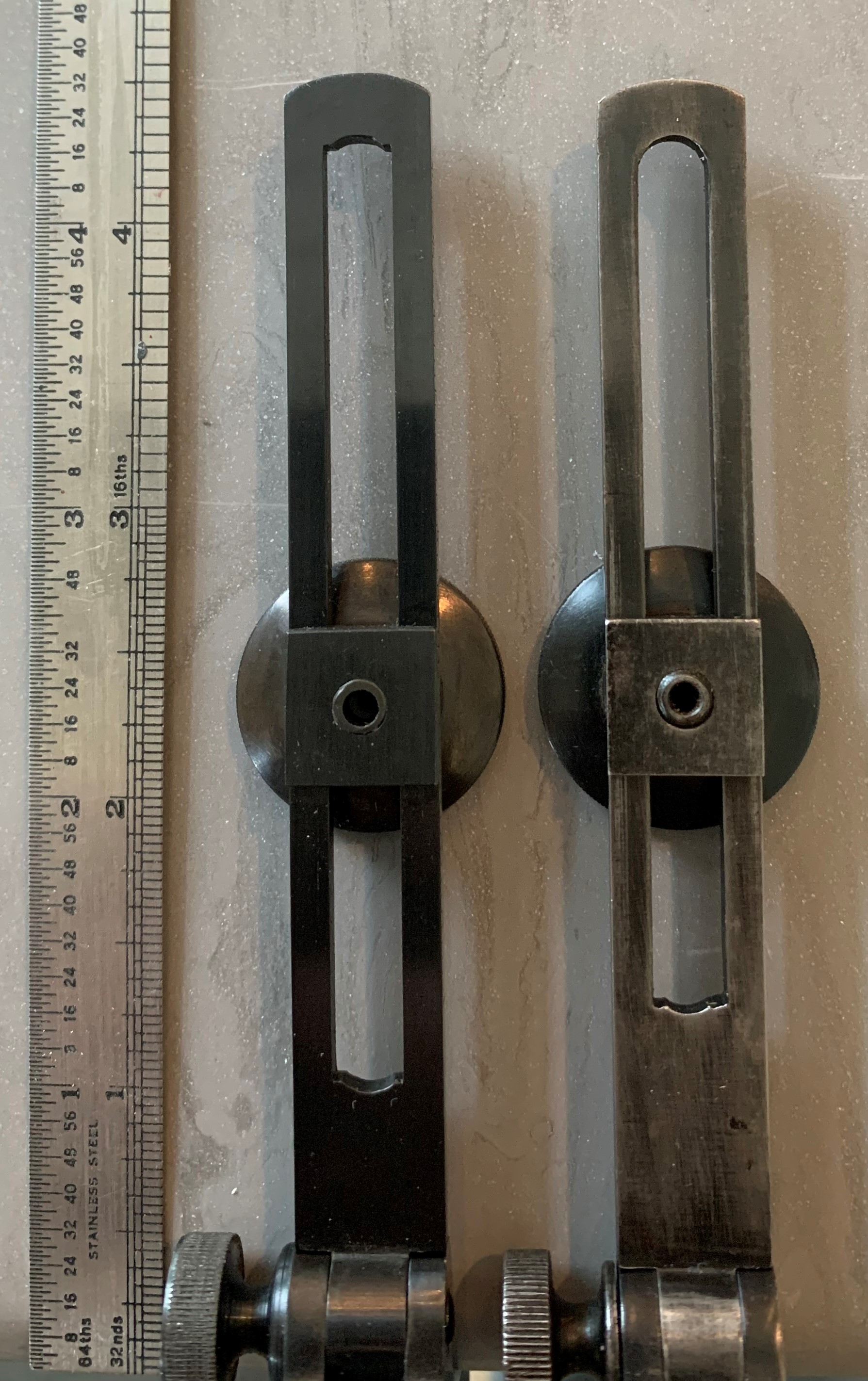

  I don’t know about the exposed spring tang sights, but the thick base graduated and vernier had a lot of differences from original. Knurling on disc and screw, machine cuts in lower base, the placement of the number on the spring, and the size off the elevation numbers on the staff were very different. You can see these differences at a glance. Axtell did have a blue that was close and with a little aging would pass. T/R

I happen to have both an Axtell and original thick base graduated peep sight in my collection.  Here are a few comparison photos.  See TR’s comments above.
First few photos original on left, Axtell on right.

A few more photos comparting original vs. Axtell graduated peep sight.  Original is now on right, Axtell on left.

 Bill,
 Nice pictures, very educational. Thanks!
