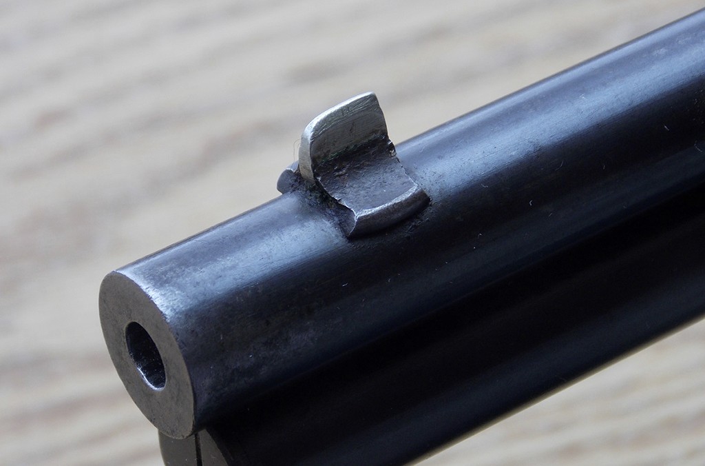

I have been looking through my files today for the better images of certain front sights to post.   I hesitated to comment because I don’t know anything about 1892s and this is concerning what I’ve observed on 1894s and 1895s.  Hopefully someone like 1892 Takedown or Twobit will also comment on 1892s someday when they have time.
It’s my opinion from the 1894s and 1895s I’ve looked at that the screws start showing up sometime in the year 1895+/- also.  There also seems to be a transition period of Sporting Front Sights with and without the screw.
These are two 1st Model 1894s, both in the 1600 s/n range.  I have observed quite a few after this without the screw also, but I think these two are interesting, especially because of the size of the screw head.  I also included an image of the rear sights so that you can see the general condition of the rifles, which appeared pretty much un-messed with to me.  If anyone has any other early rifles with this type of screw head, please comment or let me know.
This next one is a 1st Model 1895 with an image of the rear sight also for the same reason.  I have looked at a lot of early 1895s that have front sights with the screw. SN 3481
Here’s a higher condition ELW 1894 without the screw.  Ramped ELW 1894s and the ramped M 1895 sporting rifles often do not have a sporting front sight with the screw.  I imagine that could have had something to do with the narrow ramp and sight base? SN 67000 range.
Earlier 1894 in low condition, s/n 134369
1/2 OB full magazine 25-35, 148607  These should have the tall front sight blade, you can see this one has been filed narrow rather than being swapped for something else:
The 1902 patent date that is found on some sporting front sights, but also other sights including carbine and musket blades, relates to this in case anyone is wondering why it’s found various sights:

Here is the one I picked up today. It matches the one on my 32-20. It is right at .358 high. I was told this was an original for the 1892’s and not a reproduction. Looks original to me.
