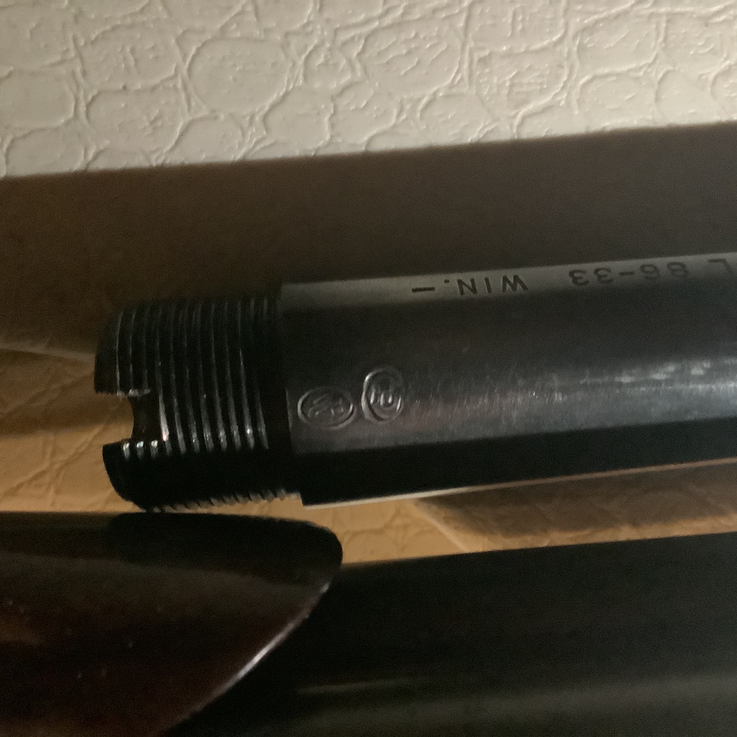

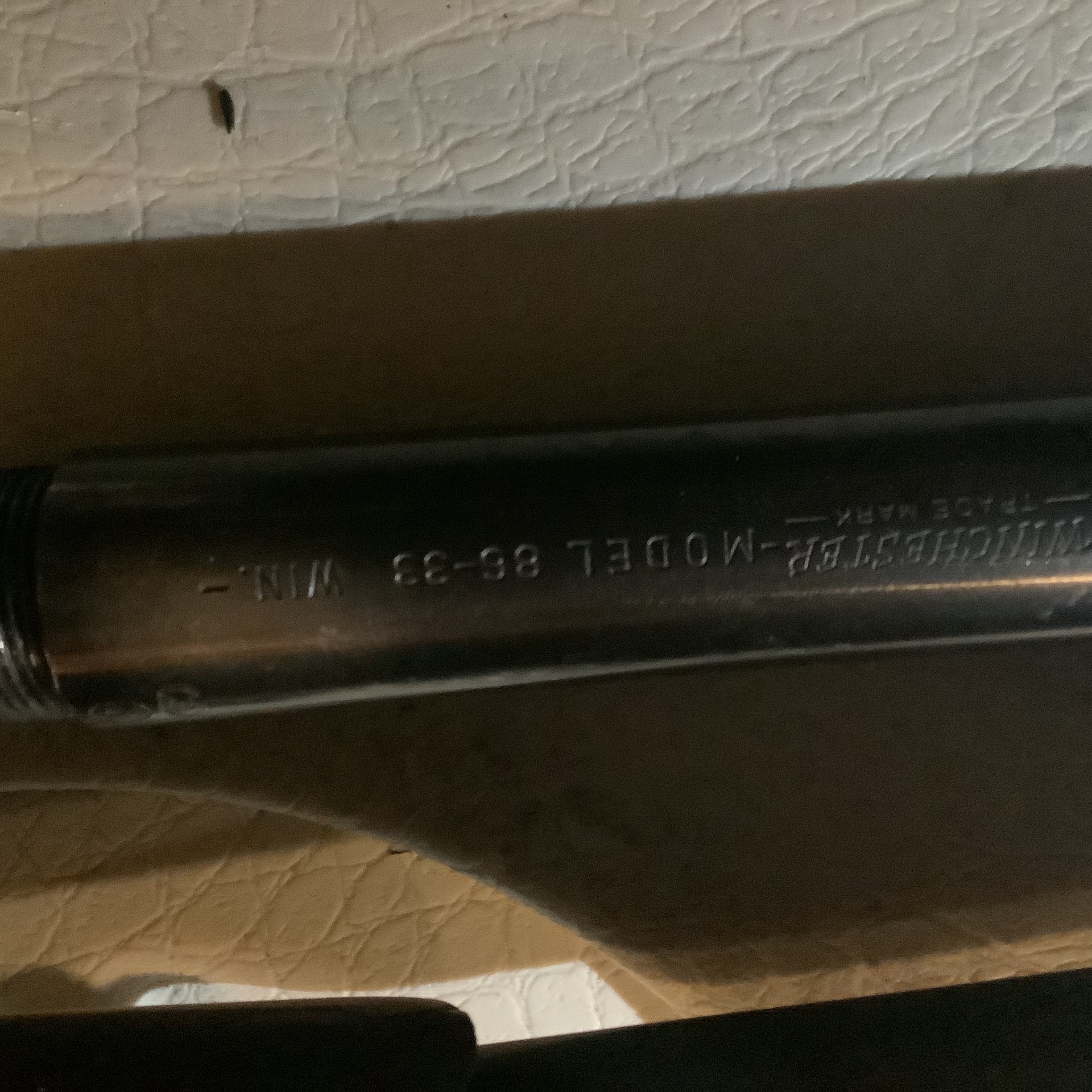

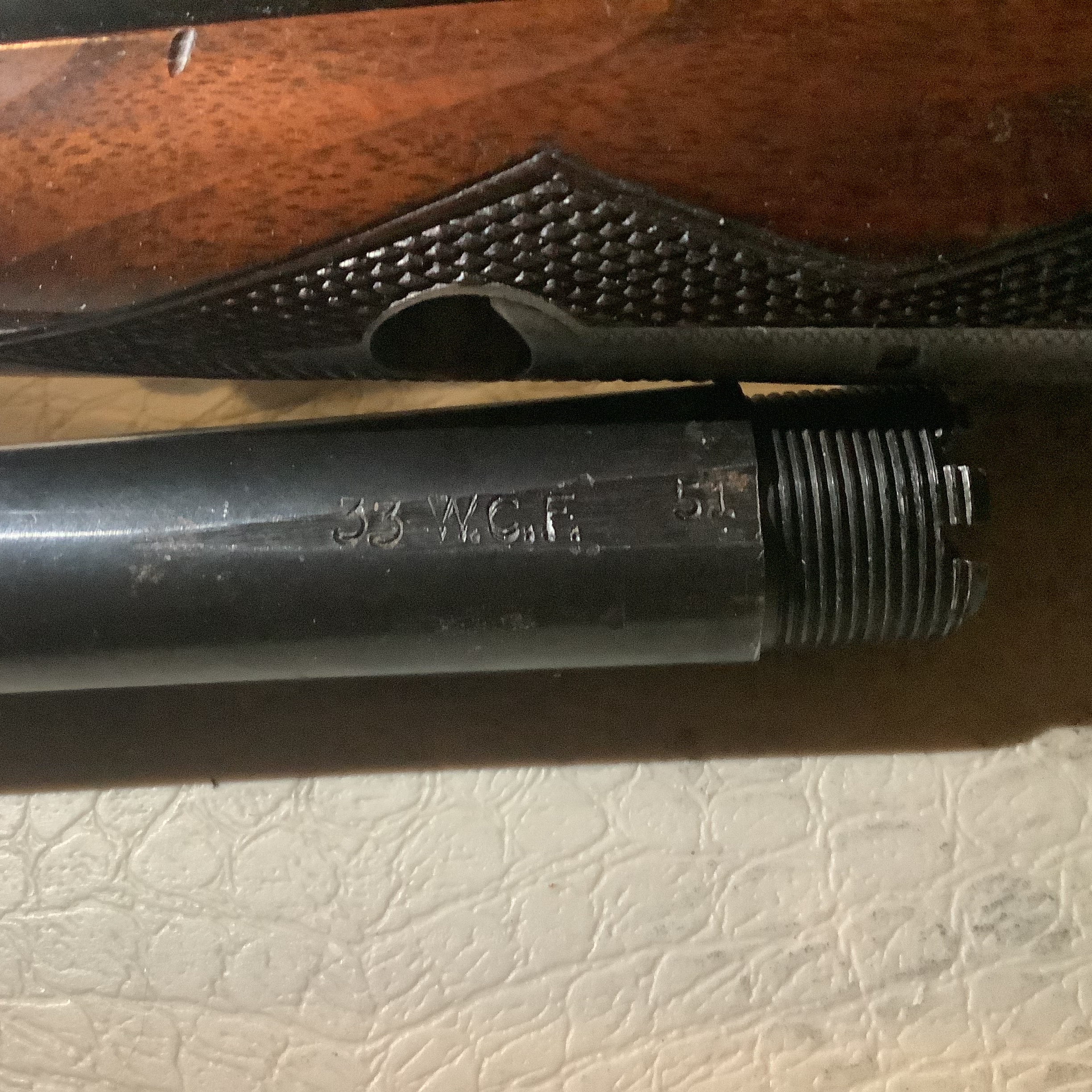

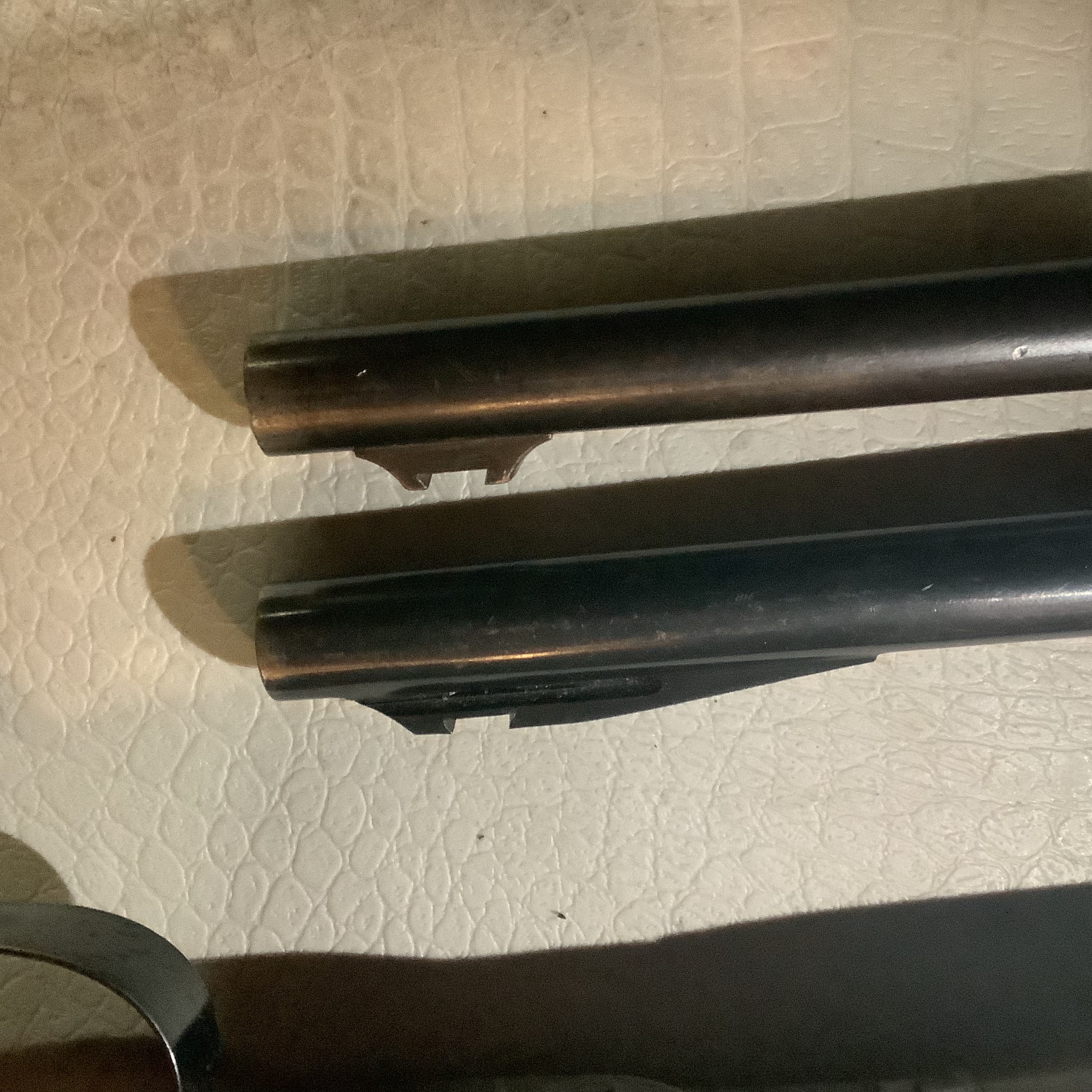

I have on hand a barrel for the 1886 model.  See attached pictures.  It is dated 1951 and resembles a model 70 Winchester barrel regarding the front ramp, it takes a hood and has a low angled ramp.  I remember hearing that Winchester used to rebarrel and reproof 1886 model guns very late, even into the mid-fifties.  According to what I heard, Winchester would rebarrel even black powder era guns and reproof them yet only for the 33 WCF.
1) I would welcome any informed comments!
2) Does anyone have a documented factory documented gun with a rebarrel with a barrel like this?
3) Were these barrels sold to gunsmiths?
4) What does the group make of the barrel markings and proof marks?
5) How late did this rebarreling occur?70A96CAE-6735-4744-B712-0CB4976520C9.jpeg3FB247AD-A710-475D-9B6D-FA74AA13BD57.jpegE331DC7B-82A6-4DAA-8617-7FD1FFF4CC39.jpegCB0BB42D-217F-4AAC-A1A3-7906DCDB37B7.jpeg

I think this barrel was sold mail order to a gunsmith or private individual. Factory installed barrels would just have the WP proof on top of the barrel. Yours looks to have a P in a circle as well. Pretty sure the P means it was sold mail order. Others more knowledgeable may correct me.

No, mail order barrels were installed by whoever purchased them. I think that was the reason for the circle P proof mark. No liabilty was incurred by Wichester for barrels installed by a third party. At least that is the way I would do it anyway. I have a 1901 production 1892 rifle that has a 1931 marked barrel on it. Pretty sure it was returned to Winchester as the whole front end; barrel. forend, mag tube. mag hanger, forend cap and mag plug are all newer issue. No P in a circle on barrel just standard WP factory proof.

Iskra, thanks for your comments!  I too am mostly intrigued in how late such rebarreling was done, in this case we see a barrel year stamped for a model introduced 65 years earlier.  I assume Winchester must have offered forend wood in the same period (circa 1951) as most 1886 guns were not made with lightweight round barrels.

As to this particular barrel being a sold for parts barrel, thanks, Mike for pointing out the circle P mark, I did not know that!  What I would still wonder about is:  was Winchester installing the barrels they were selling in the same time frame, without the circle P?  Does anyone have an invoice showing such work done?  I would also welcome more comments as to the advent and period of use of the circle P mark.
