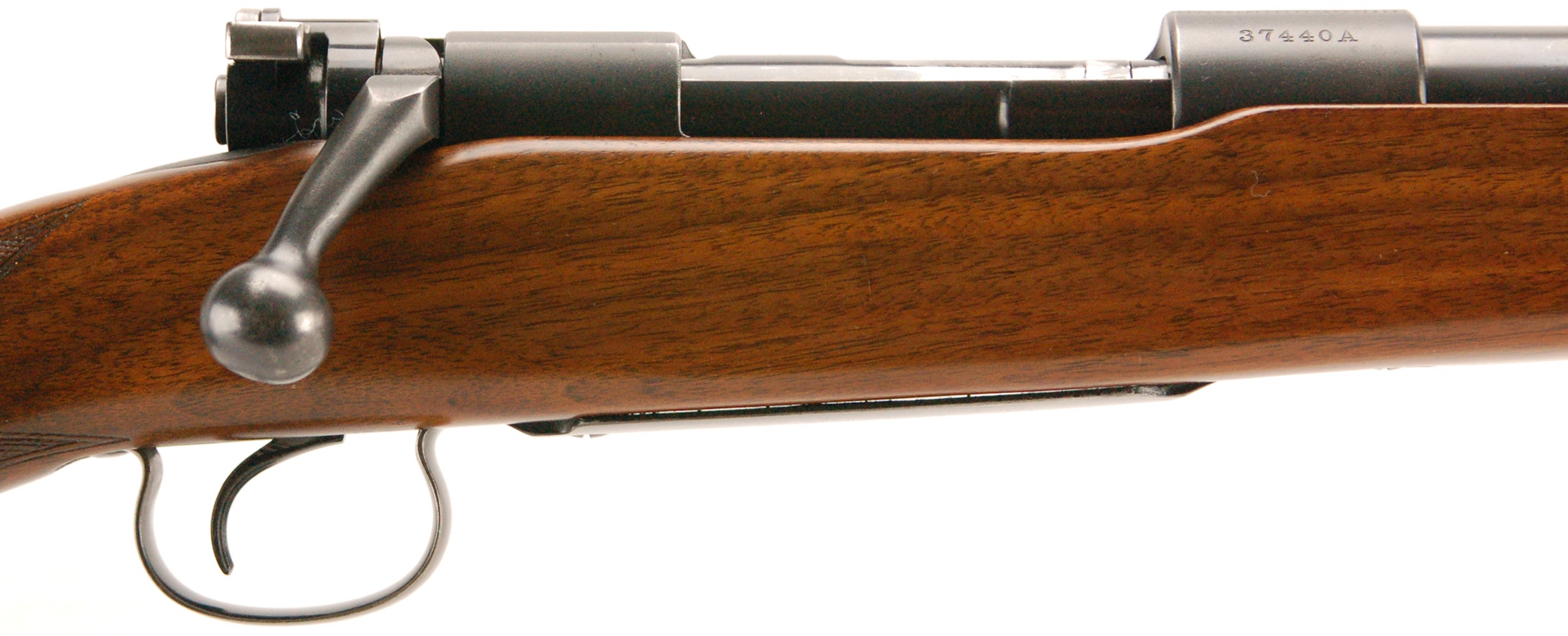

I saw a model 70 receiver serial 39850A.  Ive never seen a Model 70 serial with an A behind it.  The guy was a military match shooter and its a loose receiver.  I thought of the military stamping an A behind duplicate serials.  Is this military or commercial?
It is for sure a pre WW2 receiver by features.

Are you sure that it was a Model 70 receiver? The number you mention appears to be a Model 54 receiver.

I suspect (as usual) that Bert is correct Laugh.  The bare receivers of the M54 and M70 are quite similar in appearance except for the absence of a slot for the bolt release on the M54 and some milling differences underneath to accommodate the different trigger, bolt stop, etc.  Did the number look like this (M54 S/N 37440A):
The “A” suffix was added to to M54 serial numbers around 21,000 and denoted a change in the design of the extractor.  I imagine it helped the parts department send out correct replacements.
On the M70, duplicate serial numbers were initially indicated by a letter prefix, e.g. D39850.  Later this was changed to a “x” suffix, e.g. 422990x.  Since the letter prefix/suffix was hand stamped only after the erroneous duplicate serial number was noticed, the letter stamp is usually misaligned, and in the case of the “x” often smaller.
