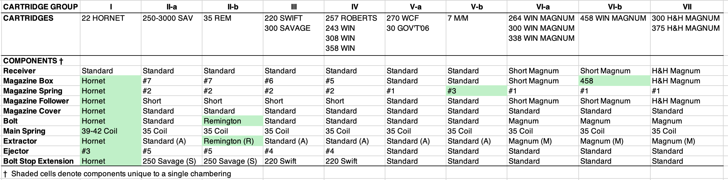

I’m currently slogging through the (monumental) chore of photographing all the component parts that made up each M70 (for book purposes).  Look at the attached table I put together to help me keep the chambering-specific parts organized.  It’s basically copying Rule’s Table 4-15 but I added a few things to suit my preferences.  The point is that with very few exceptions each of the bolts/extractors/ejectors/magazine boxes/followers/etc. that went into a M70 were used (in different combinations) for more that one chambering.  A lot of tinkering to minimize the number of different parts that had to be kept in stock…
Only where a cell is shaded green is there a part that was unique to a single chambering.  Obviously, the 22 HORNET had MANY unique parts, which is why they basically stopped making Hornet parts (except barrels) in 1950 or so (although it remained in the catalog in one Style or another until 1957)…  The 35 REM used a unique 0.475″ bolt face and “R” extractor.  The 7 M/M had a unique #3 magazine spring. The African had a different magazine box than the other Short Magnums.  Other than that every part had multiple applications.
So… Some “exotic” chamberings would be more problematic than others.  But as you pointed out, Winchester would not have let a gun go out the door that didn’t feed/fire/extract reliably, and I doubt they’d want to invest the R&D/tinkering time to make rifles in one-off chamberings function…
