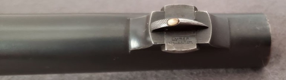

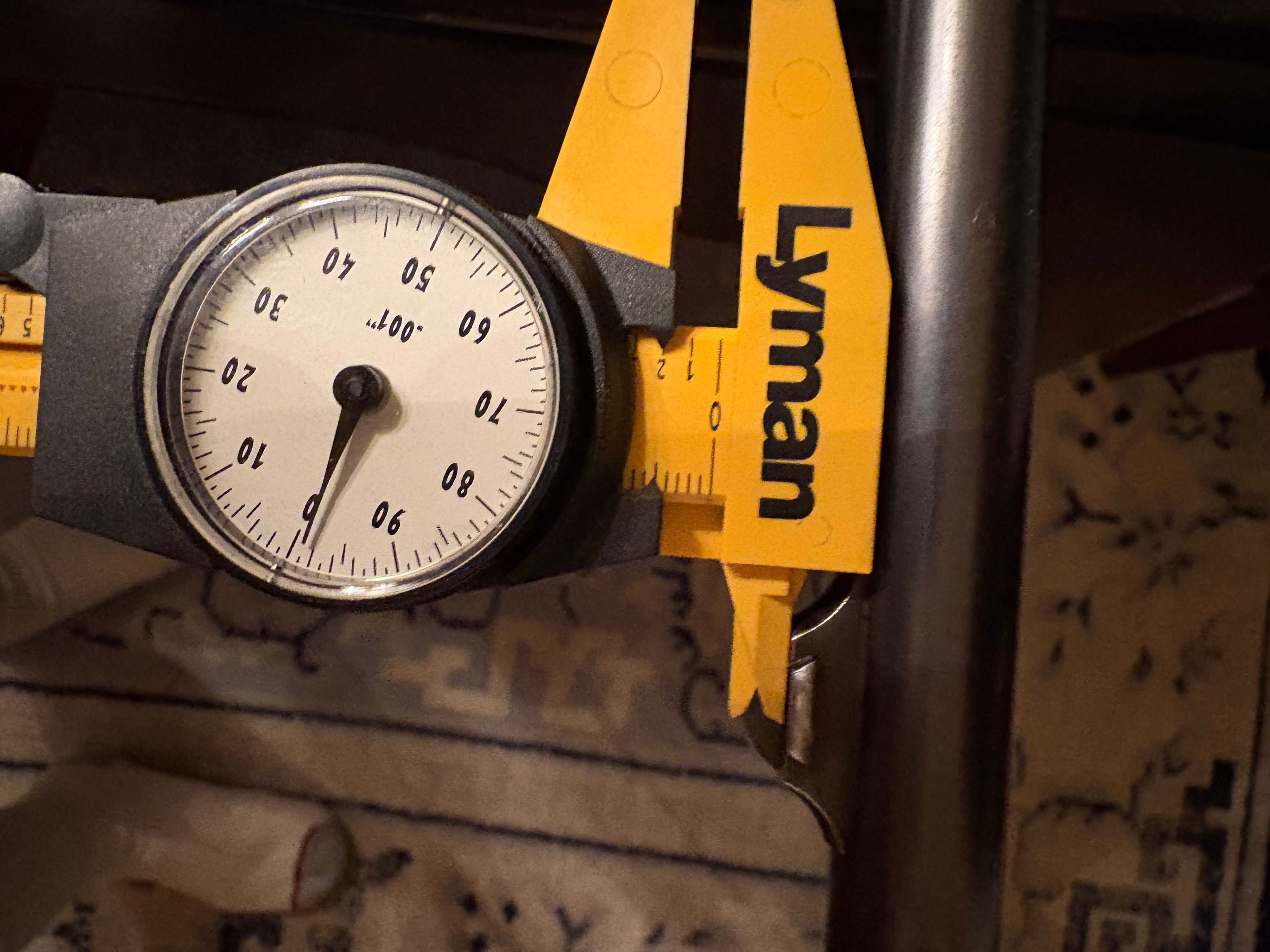

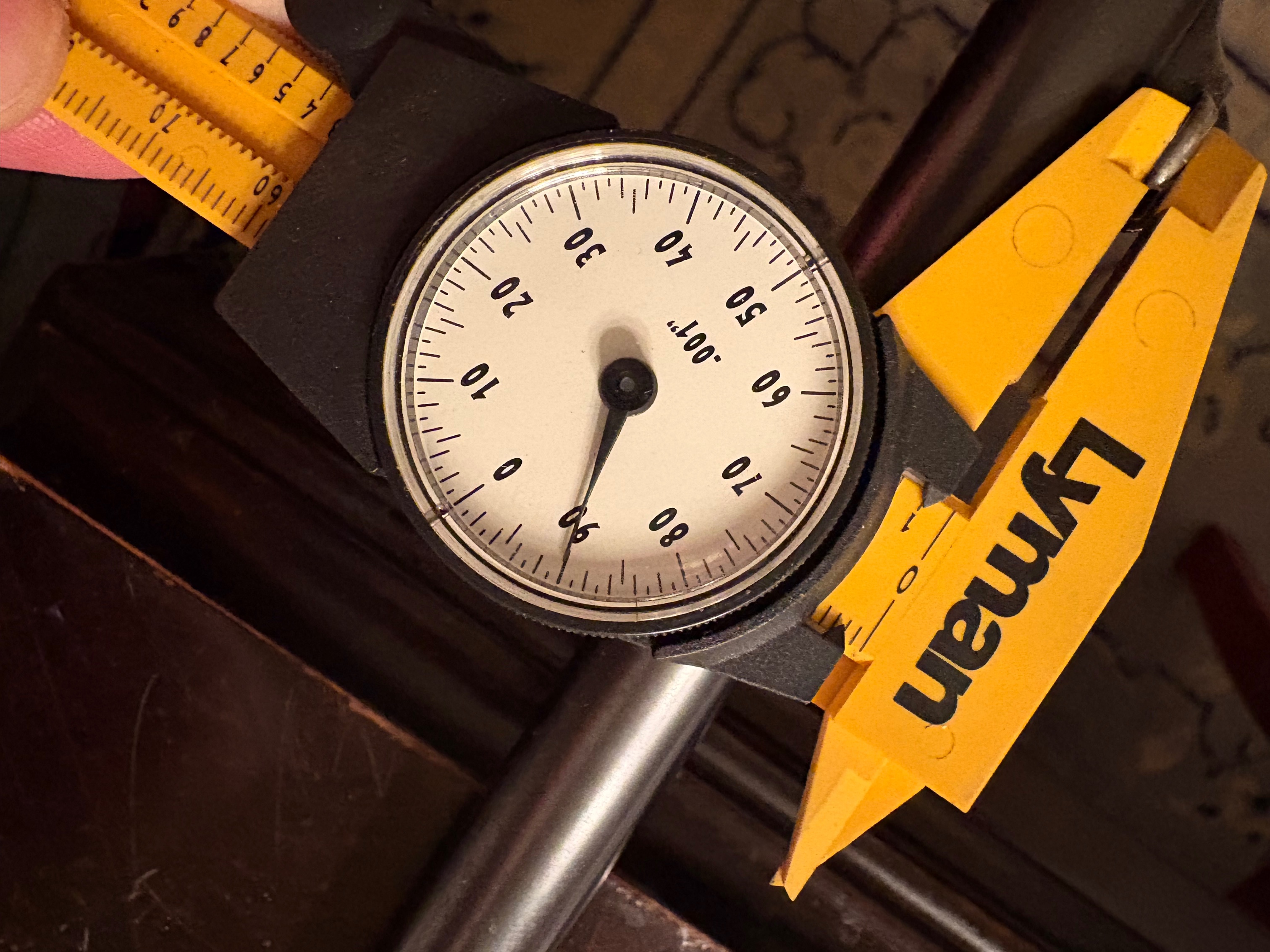

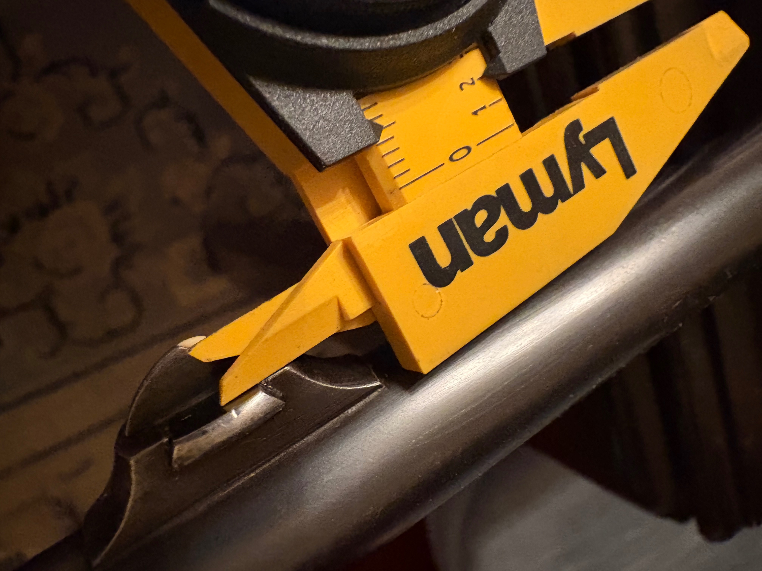

This is from an early Model 1886 Takedown in .33 Winchester, manufactured in 1902.  The fromt sight wedge appears to be 0.90”.  The sight appears to be ~0.20”at its greatest height, making it ~0.290” in total.IMG_4302.jpegIMG_4303.jpegIMG_4304.jpeg

Exactly what I need, thank you!

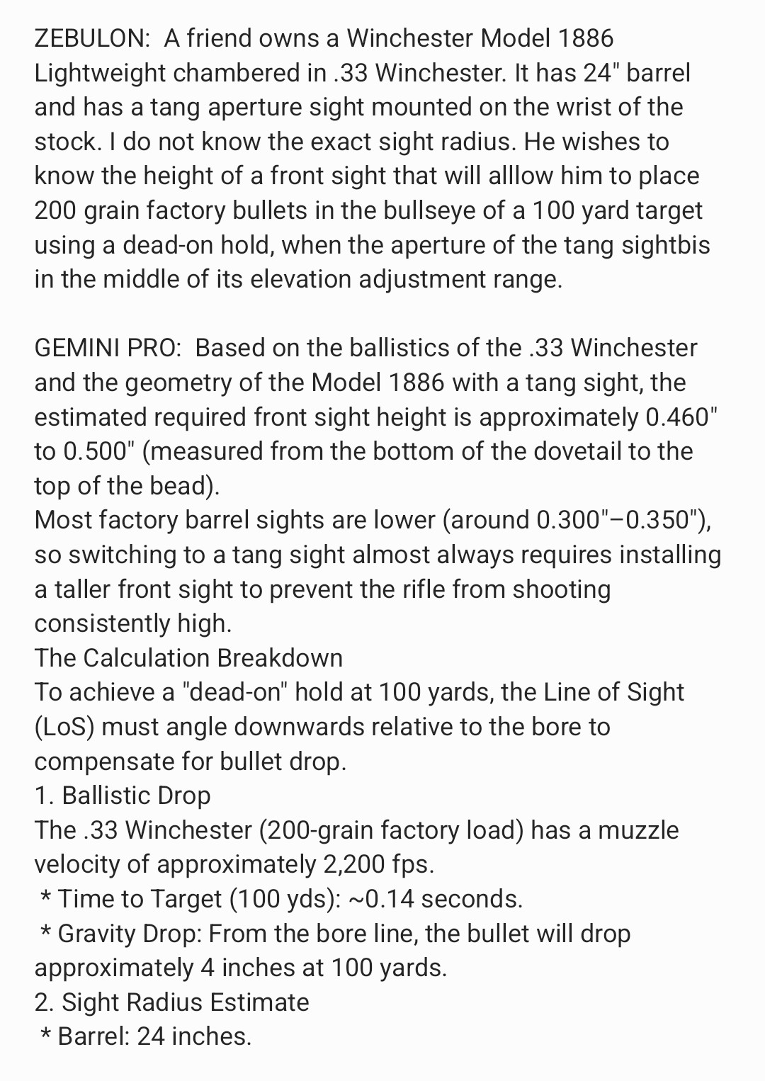

There are formulae that will compute the correct height front sight, that require a lot of tedious measuring. I own a rifle similar to yours – an 1886 takedown lightweight in .33 Winchester with a 24″ barrel and a Lyman tang sight. This evening, for my amusement, I’m going to tell Gemini just that and ask it to compute a correct front sight height for a 100 yard zero using a dead-on hold with factory 200 grain ammunition. Tell me a different yardage and I’ll use that.
The first time I used Gemini for that purpose, i did it as a joke. When I got the answer and the underlying data, I didn’t laugh. Ive used it several tmes since and it’s been on the money. It knows a hell of a lot about ballistics and gun and ammo specs.

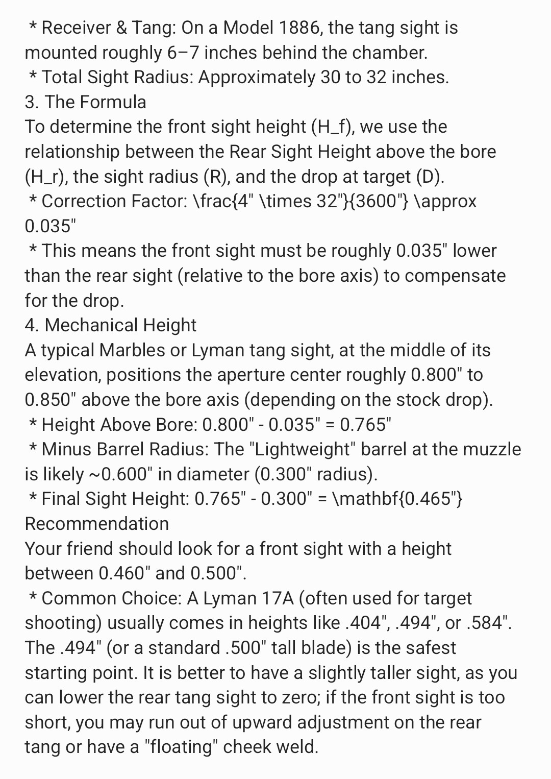

Gemini says you need a front sight from 0.460″ to 0.500 high, measured from the bottom of the dovetail to the top of the bead. It suggests the Lyman 17A in size .494 or a .500 blade and remarks that taller is better because you can always crank the tang stem down but too low a front sight will cause a “floating cheek weld.”
I’ve attached the query and full response as three image files so all can read it who are inclined.
I hope this at least gets you a starting place.

Thank you, that is alot of really helpful information.  I think it definitely gives me a solid starting point. Now we just hope that it shoots good!
