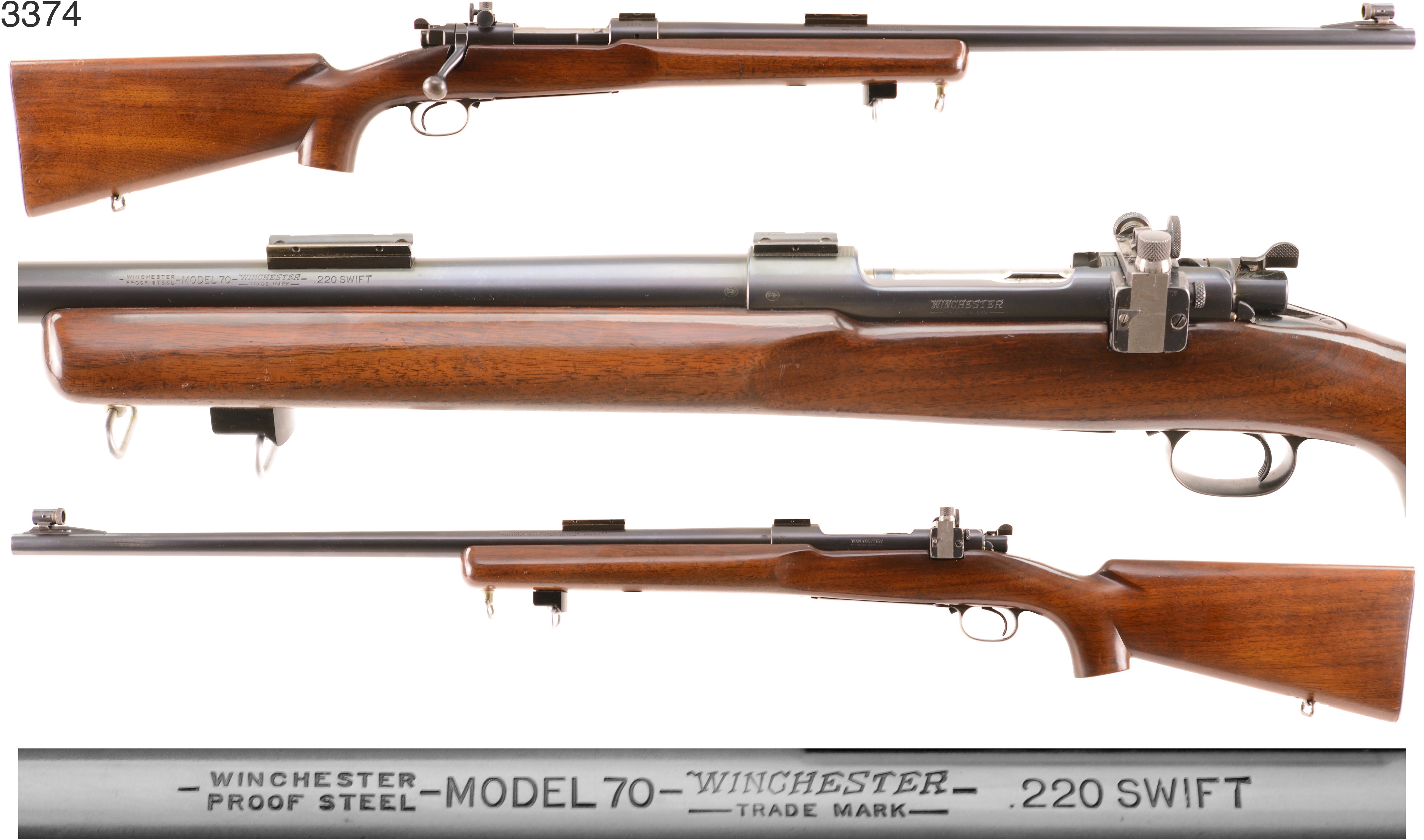

As for “pre-war” versus “post-war” there aren’t any numbers I know of.  If intact, with most parts still attached, in decent condition, and with no added holes anywhere, the pre-war rifle would probably be more attractive to collectors.  But the real pre-war 220 Swift prize would be a “1st variation Target Model”, the ones with the same medium heavy straight taper target barrel but an integral front sight ramp…  They were pretty much only made in 1936-37, after which Winchester ditched the ramp and replaced it with a muzzle dovetail.

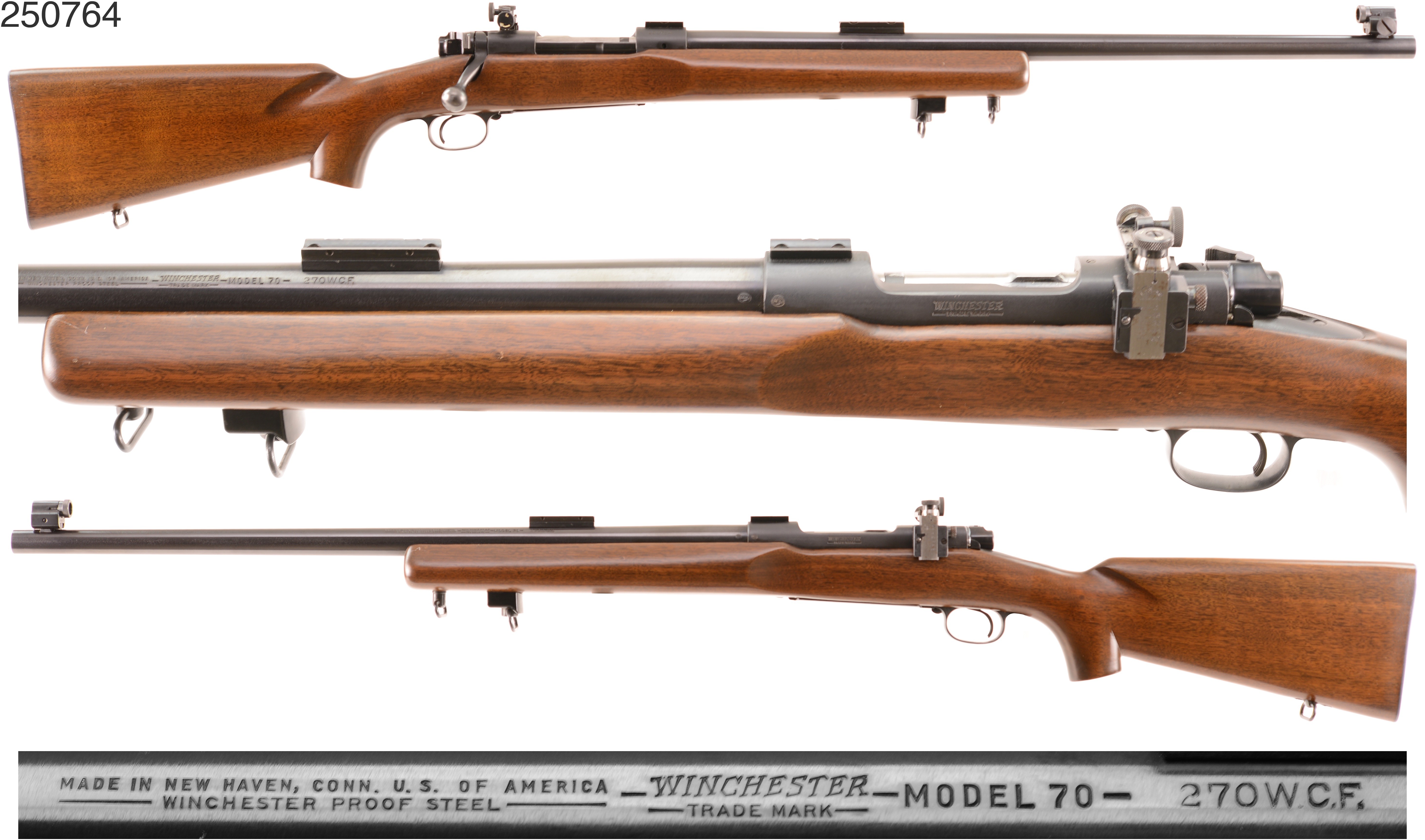

Here are pics of two 220 Swift Target Models for comparison, a 1st Variation (s/n 3374) and a 2nd variation (s/n 250764).  Both have all the parts on them that came from the factory (except the slings that were removed for pictures).
