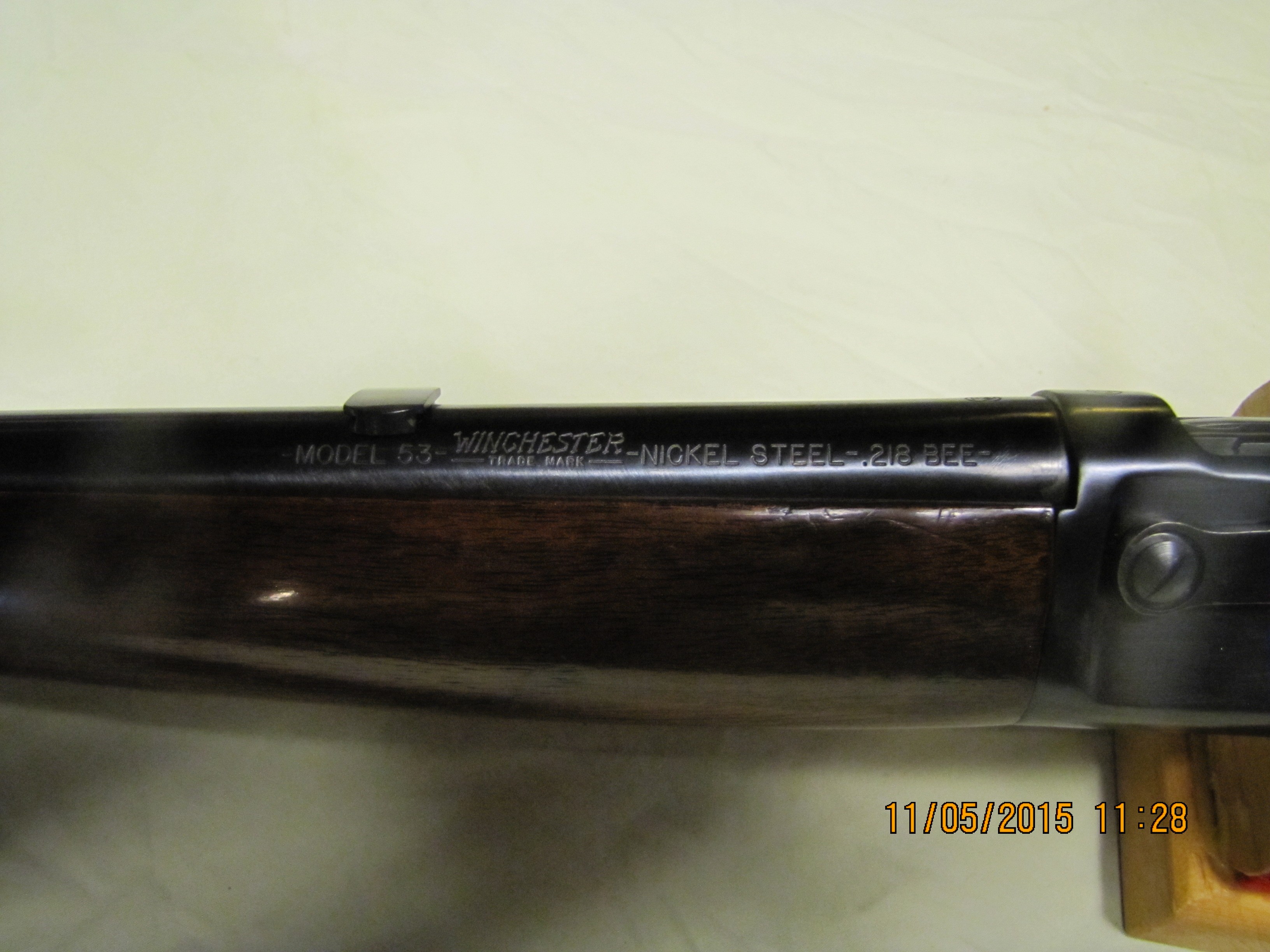

I bought this model 53 in 218 Bee back in the early 1980’s.  So they do exist.  Even has a Nickle Steel barrel.  Counterfeit Winchesters have been around for some time!  I have more than one counterfeit, but not on purpose!  I lean towards ‘unusual’ guns and now I have some that are not real, but some are the real thing.  You win sometimes and you loose sometimes.  Buy what you like, you may get stuck with it!   RDB

Serial #933650 much to early for the 218 Bee cartridge.  The barrel isn’t dated and if I remember right only has an indexing mark.  I think you saw this when I had my “Undocumented Winchester” display at the Reno show (Nov. 2016).  It shows well with my 218 Bee 92 and Model 64 219 Zipper carbine.(You’ve ok’d them).  I bought the 53 when I first started collecting.  Way before we met.  I had no idea people would make up phony guns back then.  I have always known that it was refinished. I was told that the 53’s flaked badly and this was done to improve the looks.  I was told it was made in the late 1940’s parts clean up.  I bought it.

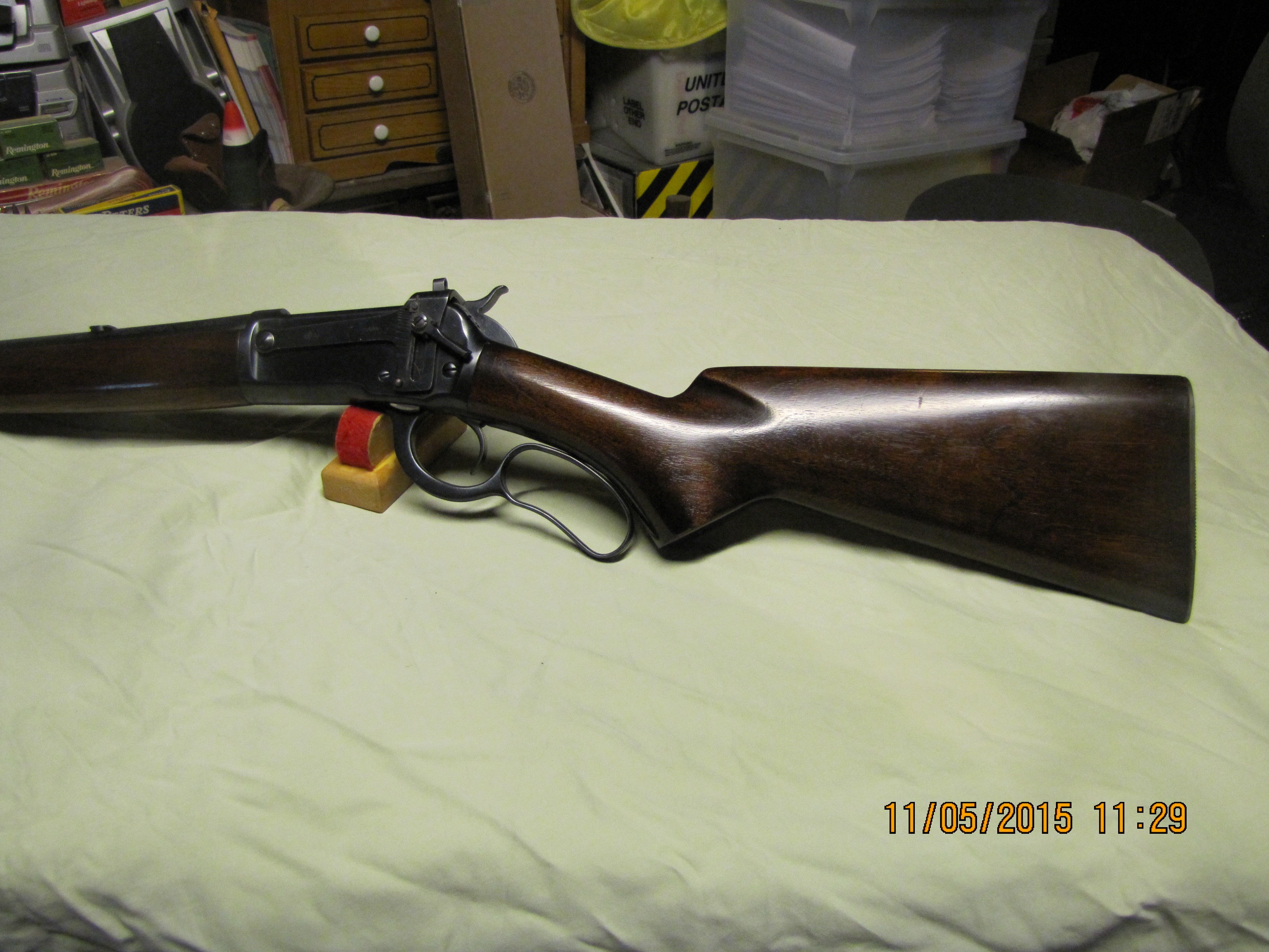

Hi Bert,  That’s why the “parts cleanup” explanation seemed to make sense, at the time I bought it.  I only had the Madis book to go by.  I understood that Winchester just used what they had available to clear inventories of unused parts.  I bought into this explanation more than once.  I have a Model 92 ser. #1006356 25-20 round barrel with what appears to be model 64 deluxe wood and a round proof steel barrel.  I was told the gun was purchased at the in plant “Winchester Store” for the employees.  The gun appears unfired and I left it that way.  RDB
Forum Posts: 14830
July 2, 2018 - 8:17 pm
Roger,
I remember your late production Model 92. It actually has Model 65 deluxe stocks (which are for the most part identical to Model 64 Deer Rifle stocks). Base on how late the serial number is in the production run, it is reasonable to believe that it was a “parts clean-up” rifle. Based on the caliber marking style, and the other markings on the barrel, I suspect that it has a repurposed Model 43 barrel on it. The date stamp on the bottom of the barrel will be the key evidence. All of the other serial numbers that I have surveyed in the same range are Model 65 rifles.

No, do not take it apart just to look at the barrel date. Clear pictures of the address stamp and caliber stamp on the barrel will most likely tell the story.

Roger, looking at the Model 53 survey that I have, regular production of the Model 53 appears to have ended around the last week of June, 1930. No further Model 53’s appear to have been manufactured until March of 1932, when there seems to have been a final ‘clean up’ of Model 53 barrels chambered in 25-20 and 32 W.C.F., all assembled in the month of March. The estimated number of rifles in the “clean up” was roughly 80, extrapolating from the survey. These were all serial numbers (thus far discovered) in the 999xxx range.
As Bert mentioned, your serial number is too early for the Model 53 and much too early for the 218 Bee. It is strange that your 218 Bee barrel on the Model 53 does not have a date stamp underneath … nothing but an index mark. That is “fishy”. Are you sure it is a Winchester barrel? Does it have the “MADE IN U.S.A. WINCHESTER REPEATING ARMS CO.” with “NEW HAVEN.CONN.” between too long dashes, on the left side of the barrel? I do have one Model 53 that has a 218 Bee barrel, but is an obvious re-barrel with the Model # peened out and over-stamped with “53”. It is mounted on a receiver which was serialized in 1928 and in a serial range that probably was chambered in 32 W.C.F.
I compared the font on the barrel with a normal Model 53 barrel and there are subtle but definite differences. For example, the “53” uses a different font on your rifle. A normal “3” on a Model 53 has the top half of the “3” rounded, whereas on yours the top have is composed of two straight line segments. If you refer to my article on the Model 53 in the WACA journal a few years ago, you can see what the “53” font looks like. There is also a difference in the “W” of “Winchester” …. note that the little curlicue makes the top of the “W” look like a “T” on a normal Model 53, rather than the abbreviated version curlicue on yours. The “TRADE MARK” is much closer to the underside of “WINCHESTER” on your rifle than it is on a normal barrel. I’ve not compared the font with a Model 65 barrel, however, to see if yours matches the later, Model 65 barrel fonts. I see there is a Winchester proof mark on the top of the barrel, which is totally out of sync with the absence of markings underneath the barrel where no one normally sees. This suggests to me that the barrel might not be a Winchester barrel, but was made to look like one only where people would see, but not under the barrel where no one would see. Whoever did it, however, did a very nice job on the engraving/roll stamping.
The rounded edges of the receiver show it has been buffed and re-blued, as you already mentioned, and that is likely when the 218 Barrel was mounted. I’ve owned a Model 1892 that was rebuilt by Winchester in the 1930’s to a Model 92 carbine, and the receiver edges and proof marks were sharp even though Winchester had rebuilt the carbine from an early rifle made in 1894. The rounded edges on yours suggest that the refinishing of the receiver was not done by Winchester. (Note that I am just going from the photos, so my assessment depends on the lighting in those photos).
I think it most likely that your receiver was originally part of a Model 92 assembled in 1923 and when the 218 Bee came out, someone thought it would be great to re-barrel it to 218 Bee and restock it with Model 65 stocks.
If you get a chance, could you post a photo of the barrel address on the left side of the barrel? I would also be grateful if you could post a photo of the upper tang stamp.

Here are some quick pictures.  Both upper tangs have the type 6 Winchester logo with the dashes present on the 53 and no dashes on the 92.  The sling appears correct with the keeper having the diamond shaped staples.  The sling was still offered and pictured in the 1950’s parts catalog.  The 92 has sharp edges and the proof marks are well defined and show no signs of polishing.  The 92 was purchased from a retired Winchester employee who said he purchased several of the guns offered at the “Winchester Store” as “no longer in production”.  Just a note of interest, the muzzle of the 92 is flat and not crowned.  The forend of 53 measures 8 3/8″, like a short rifle, and has a 22″ barrel length.

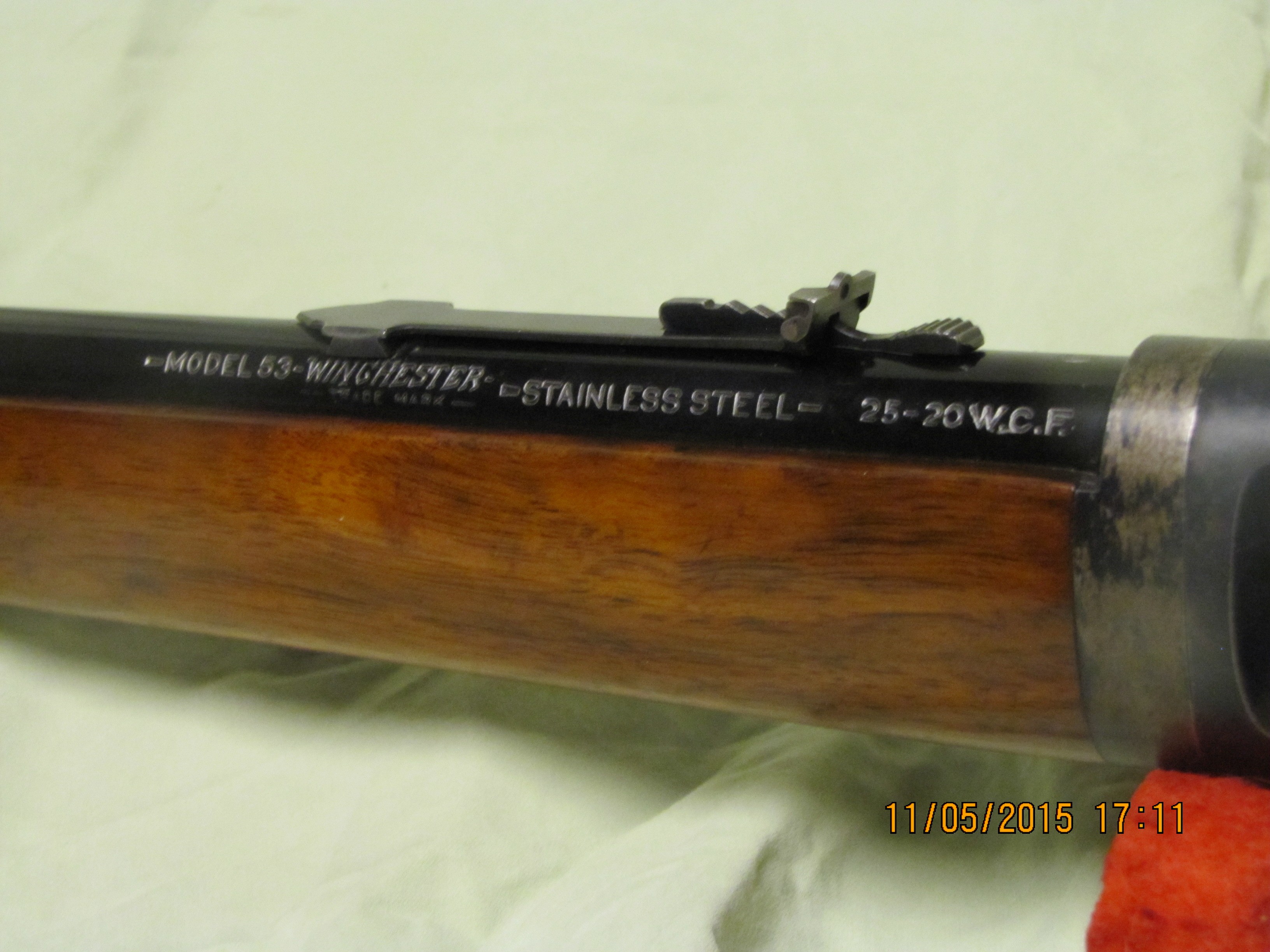

A thank you to Kirk for his informative post.  I do have a legitimate 53 with a stainless steel barrel and was able to see the ‘3’ difference in MODEL 53 numeral.  The rest of the lettering seems to be identical in what seems to be a proper location with adjustment due to more digits in the lettering.  Very different from the digits or lettering on a Model 65 barrel stamping.  Please don’t interpret my post as an attempt to legitimize the 218 BEE model 53, I am convinced it is counterfeit.  The model 92 I believe to be legit, but I only have a letter of authentication from the original owner.  RDB

I think I gave Bert the number years ago but, it is 995387, take down, 25/20.  It had a special rear sight, but I was informed that it wasn’t correct, so I replaced it.  I will add the original sight picture.

The barrel markings on your late production (parts clean-up) Model 92 are identical to those used on the Model 43 barrels.  I have seen several other just like it (in 218 Bee).
The tang marking without the dashes is a type 7, and it is the predominant type on the Model 65 rifles.
