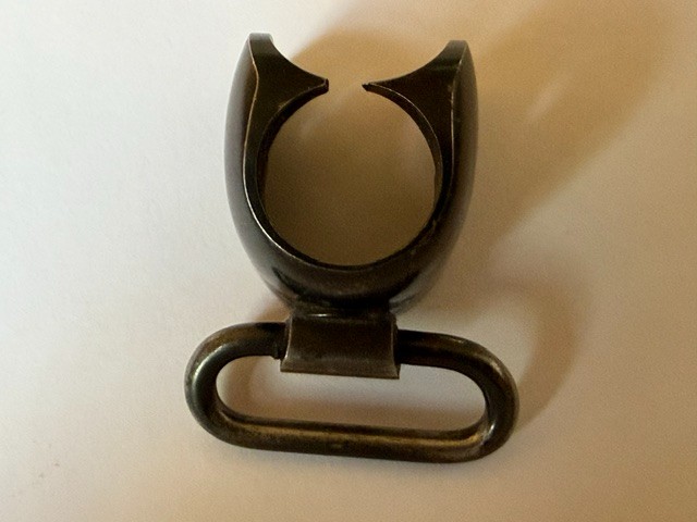

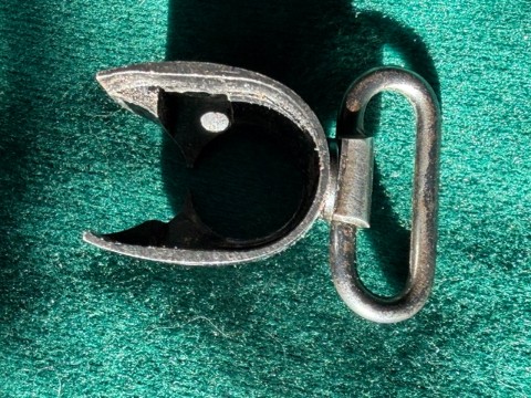

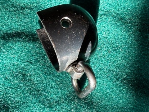

IMG_3643.jpegIMG_3640.jpegIMG_3641.jpegIMG_3642.jpegI wonder if this would be the right swivel nose cap.  Probably not as it wouldn’t match the rear swivel.  I know this fits a Model 53, so probably would fit a Model 65.

Steve,  The big difference (to me) is that nosecap is fitted with a non-detachable swivel, whereas the 71 and 64 – and I assume the 65, if special ordered, were furnished with Super Grade detachable swivels.
Bert,  so there was never a catalogued “Special” style of the M65. No wonder I wasn’t sure what to call one fitted up like a Deer Rifle.
Both:  the nose cap illustrated by Steve appears to have a swivel base welded or sweated on.
The 71 and 64 nose caps with swivel bases (at least the two in my possession) seem to be of a single piece, as if forged or machined that way. Is that just because of careful filing and finishing or are at least some made with integral bases?
No, it would not be for a Model 65 Special
This is the correct sling base…
Correct… Winchester never officially cataloged a Model 65 “Special” but that is how they labeled the end label of the cardboard box.
The Model 64 and Model 71 nose caps were dovetailed for the SG swivel base.

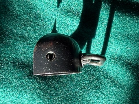

What kind of swiveled nose cap for a M53?  This one fits on a M53 perfectly.
I have not ever encountered or documented a Model 53 fitted with sling swivels.  A very small number of them were equipped with sling eyes.  The nose cap you have was most likely made for a Model 1892.
