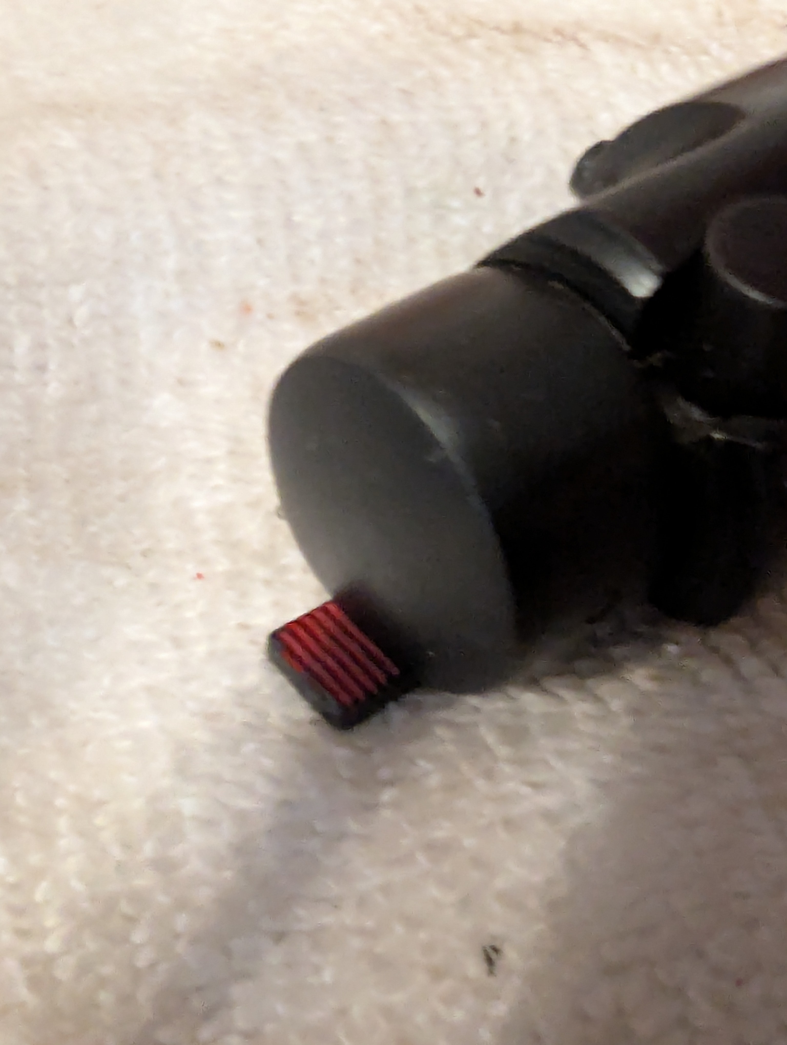

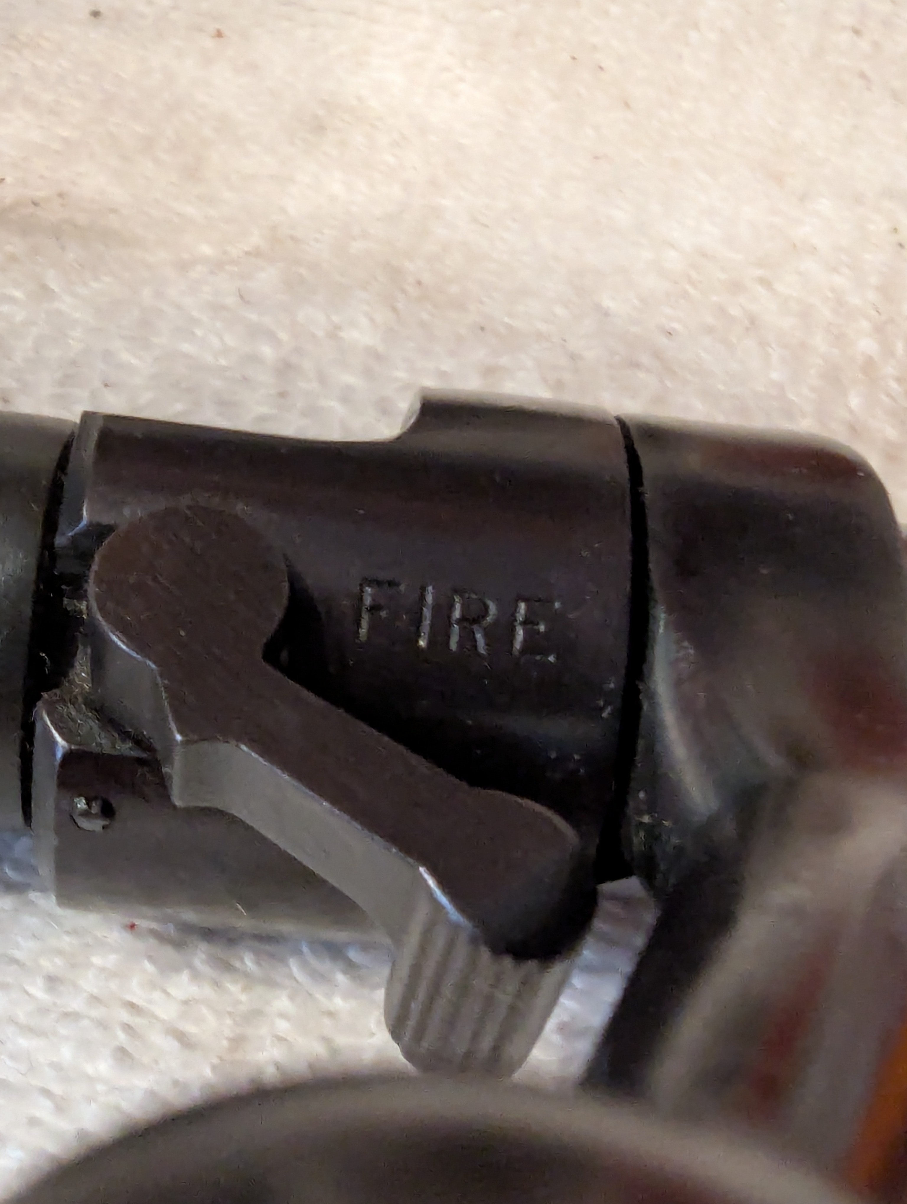

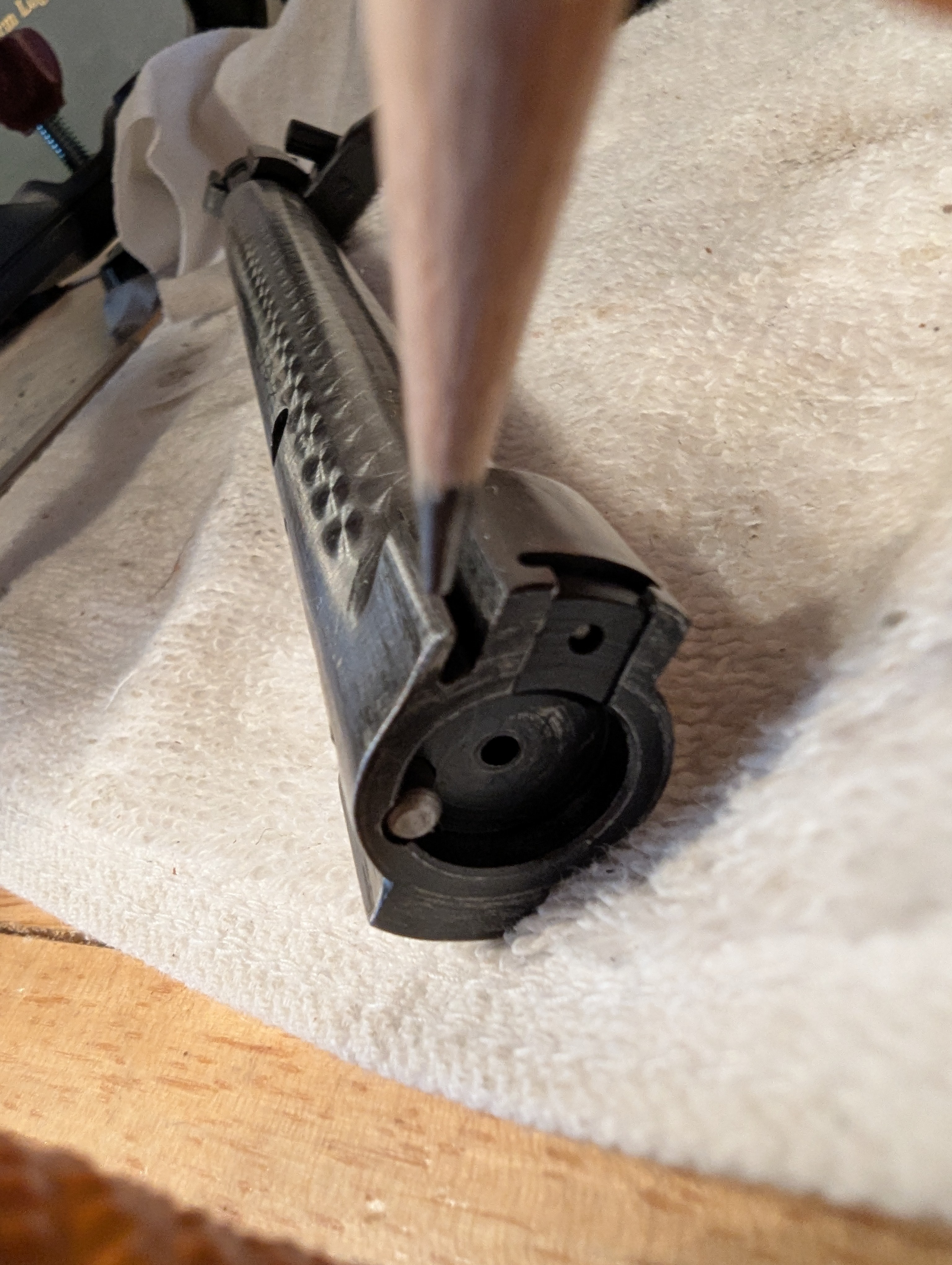

Hi Boe,
Some items that may help identify your rifles year of assembly would be the “FIRE” stamping on the bolt sleeve and receiver/bolt slide rail. In 1968 the word “FIRE” on the bolt sleeve changed from a casting with an oval around it to a die stamped variation similar to the pre-64. The back of the sleeve cap was also changed to a smooth rounded profile. The biggest change in 1968 was the anti-bind guide rail to smooth out bolt movement. An integral rail on the inside of the receiver and a slot cut into the bolt’s right locking lug
If your rifle has any of these features, it was likely assembled in 1968.
Photos are from a 1968 rifle.PXL_20260104_182852661.jpgPXL_20260104_182923085.jpgPXL_20260104_182931357.jpg
