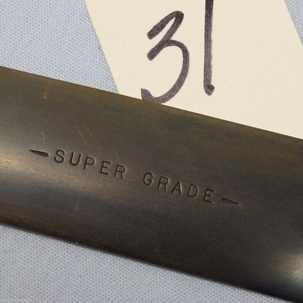

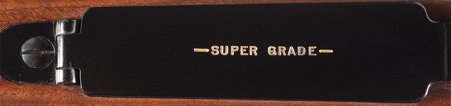

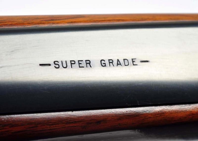

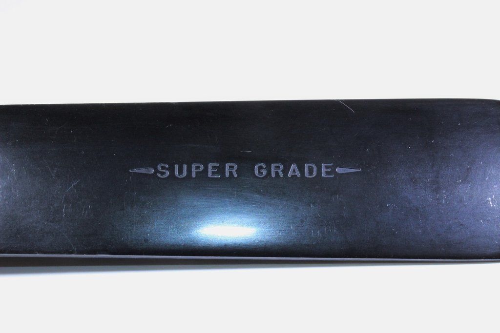

The photo you attached is of borderline quality to answer your question, but I’ll go out on a limb and say YES, that looks like a M70 SG floor plate.  There is A LOT of minor variation in these stamps, but in general the pre-war stamps look something like the photo below:
The slightly oversized and misaligned “P” and “A” are typical as is the “S” that sometimes looks “upside down” (not backwards), but the main thing on pre-war (and early post-war) SG floor plates is the font of the “G” (being a Helvetica serif font with the little “tail” on the vertical downstroke).  Sometime in the 1940’s (around later type II and type III rifles) the “G” was changed to a sans serif font and the stamp looks something like this:
The above are pictures I’ve saved off the internet and I was trying to select worn out examples that are likely to be real.  There are indeed many fakes out there, but many are crude like the one below.  This one was probably laser engraved as the ends of all strokes are completely round and the letters too uniform and wide:
The “teardrops” on real SG floor plates can both point “out” (far and away most common), both point “in” (not rare), and even both point in the same direction, i.e. one “in” one “out” (probably a factory error).  There are also numerous minor variations in the letters that show up in “real” SG floor plates, but that’s too much to try and cover here.  Besides, I’m sure I’d just get into trouble given the level of debate this topic can spark!!! Cry As for the “teardrops” versus “dashes” issue… I’m SURE to get into trouble here!!! Wink Both Rule and Whitaker state that all pre-64 SG floor plates have teardrops and that post-63 SG floor plates have dashes.  The post-63 floor plates were castings, very different from the pre-64 milled part, but do indeed have dashes (this is SN 769974):
Yet I have seen several LATE PRODUCTION pre-64 SG rifles with dashed floor plates, mostly Africans or SG FWTs with receivers dating from 1957 or later.  By this time the factory was not making many M70s in SG configuration (all SGs except the African were last cataloged in 1959, and they only made 900-some SG FWTs and 1200-some Africans).  There was never a complete transition from teardrops to dashes, but I SUSPECT that these dashed floor plates on late production SGs are “real”.  It’s just that the change was made after the majority of SG rifles had been manufactured.  Others will disagree, of course…  WinkIMHO a dashed floor plate on a M70 SG dated earlier than 1956 has certainly had parts swapped, but I’m not so quick to condemn one with a SN above, say, 400,000…
Your explanation of these differences is the clearest I’ve seen, but I think you should reserve “crude” for the original, first variant marking!  The “S” IS upside down & the “A” belongs to a different set of dies!  That the company should have allowed such sloppy work on their top-of-the-line rifle makes me wonder where the quality-control inspector was while it was being done.

Well… I’ll at least go with “distinctive”…  “Crude” is so judgmental!!! Wink For the OP, here are a couple more of the first style:
Note the weird little “feet” on the “A” on SN 57766, like the “A” suffix that was added to M54 serial numbers.  I’ve seen two otherwise believable M70 SGs, both early post-war, with that funky marking.  Real???
And a couple more of the second style:
This one is from a 1961 African with dashes:
Note that the whole font is different, the serif “G” is back and the letters more uniform.  The “dashed” ones I’ve seen on some late pre-64 SGs are in this third style.  I can’t say whether these are truly of pre-64 Winchester manufacture or made up by some non-factory source using genuine pre-64 floor plates.  I can’t imagine the factory made these milled parts up in the post-63 period after they’d changed the floor plate to a casting, but they’re not “rare” on late SG rifles in both steel (SG rifles and Africans) and aluminum (SG FWTs).  Anyone have a definitive answer?

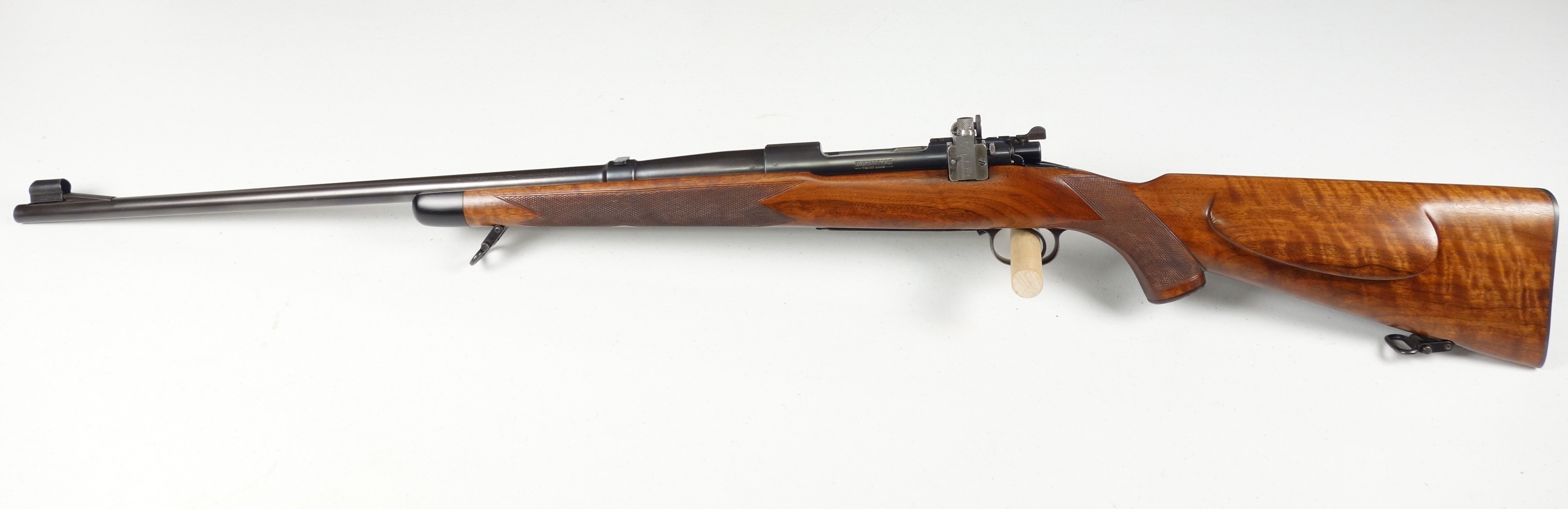

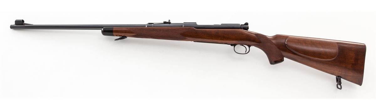

You put your finger on the problem with M70 SGs…  Prior to about 1955, there were no differences in the metal finishes applied to Standard Grade and Super Grade M70s:
Pre-war (type I) receivers (1936-1945) had the cloverleaf tang, undrilled roll marked bridge, and rust blued barrel, regardless of style.  Post-war “transition” (type 2) receivers (1946-1948) had the cloverleaf tang, factory D&T smooth bridge, and Du-Lite blued barrel, regardless of style.  The later (type III) receivers (1948-1954) had the oval tang, D&T bridge, and Du-Lite blued barrel, regardless of style.  Since there were no practical differences, these barreled actions are almost never stamped “SUPER”, and there is really no way to reliably identify if they came from a Standard or SG rifle.
It wasn’t until 1955-1959 SG production that the bolt body, extractor, and follower were jeweled and the barrels went back to being rust blued.  Unlike the earlier guns, these actions are almost always stamped “SUPER” under the barrel, so from 1955-on it takes outright fakery to turn a Standard Rifle into a SG.  Prior to that, whether pre-war or post-war, it only takes a period correct stock, floor plate, and front sight.  Still fakery, but simple exchange of parts without needing to apply a “faux finish”… Cry
The stocks also evolved, but the timing of changes did not exactly parallel the action changes.  I’ll try to illustrate this b/c it’s easier than trying to explain without pictures:
The earliest SG stocks (found mostly on 1936-1939 S/N rifles) had the low comb oval cheekpiece, and a front sling swivel base that was located very close to the Bakelite forend tip.  Rule’s book claims that these stocks also have an extra “fishtail” to the pistol grip checkering, as pictured in the M70 introductory brochure, but I’ve yet to see one.  Below is S/N 1748.  Note the position of the front swivel:
The first change started appearing (as best I can tell) sometime in 1938.  The front swivel base was moved back about half an inch to prevent wood splitting between the front of the base and the fore end tip. Below is S/N 50821:
This stock style stock continued, virtually unchanged, through type 1, 2 and early type III production.  It wasn’t until 1952 that a significant change occurred.  Something to mention though is checkering density, i.e. 20 l.p.i. versus 18 l.p.i.  On standard stocks, the distinction is easy and 18 l.p.i. was phased in (rather gradually) starting in late 1941.  To my eyes, the distinction is less obvious on the SG stocks with their more complex wrap-around checkering, and the book authors differ on this point.  Rule asserts that pre-1941 SG stocks were checkered 20 l.p.i. and the checkering changed to 18 l.p.i. in parallel with the standard stocks.  Whitaker asserts that from the outset SG stocks were checkered in 18 l.p.i. or 20 l.p.i. depending on the checkerer and the characteristics of the wood.  I don’t have the answer, except that I’d swear one of mine (S/N 3748) that has the early swivel placement measures out at 18 l.p.i. on a checkering gauge. Confused
The biggest change occurred with the introduction of the MC stock style in late 1951. The cheekpiece was changed for both the Monte Carlo and low comb styles.  Obviously, this affects only type III oval tang rifles:
Note the two illustrations above are from 1952-53 rifles, so the metal finishes are still the same as the Standard Grade.  The jeweling, rust blue, and “SUPER” stamp under the barrel were still three years off.  It’s also worth noting that there were apparently a bunch of those oval cheekpiece stocks in inventory in 1952, so they continue to turn up well into maybe 1954.  In other words, a M70 SG with a S/N earlier than 1951 and a later style cheekpiece is probably “made up”, while one from 1954 with the oval cheekpiece could well be “legit”.
It gets confusing, I know.  It would take a book chapter to cover/illustrate all the nuances that help the M70 collector figure out whether a given gun is/is not “correct”.  Note I did NOT say “original”… Confused FWIW… I don’t recommend that a M70 newbie go shopping for Super Grades without doing their homework.  There is a lot of good/accurate information in Rule’s book so that’s a place to start.
