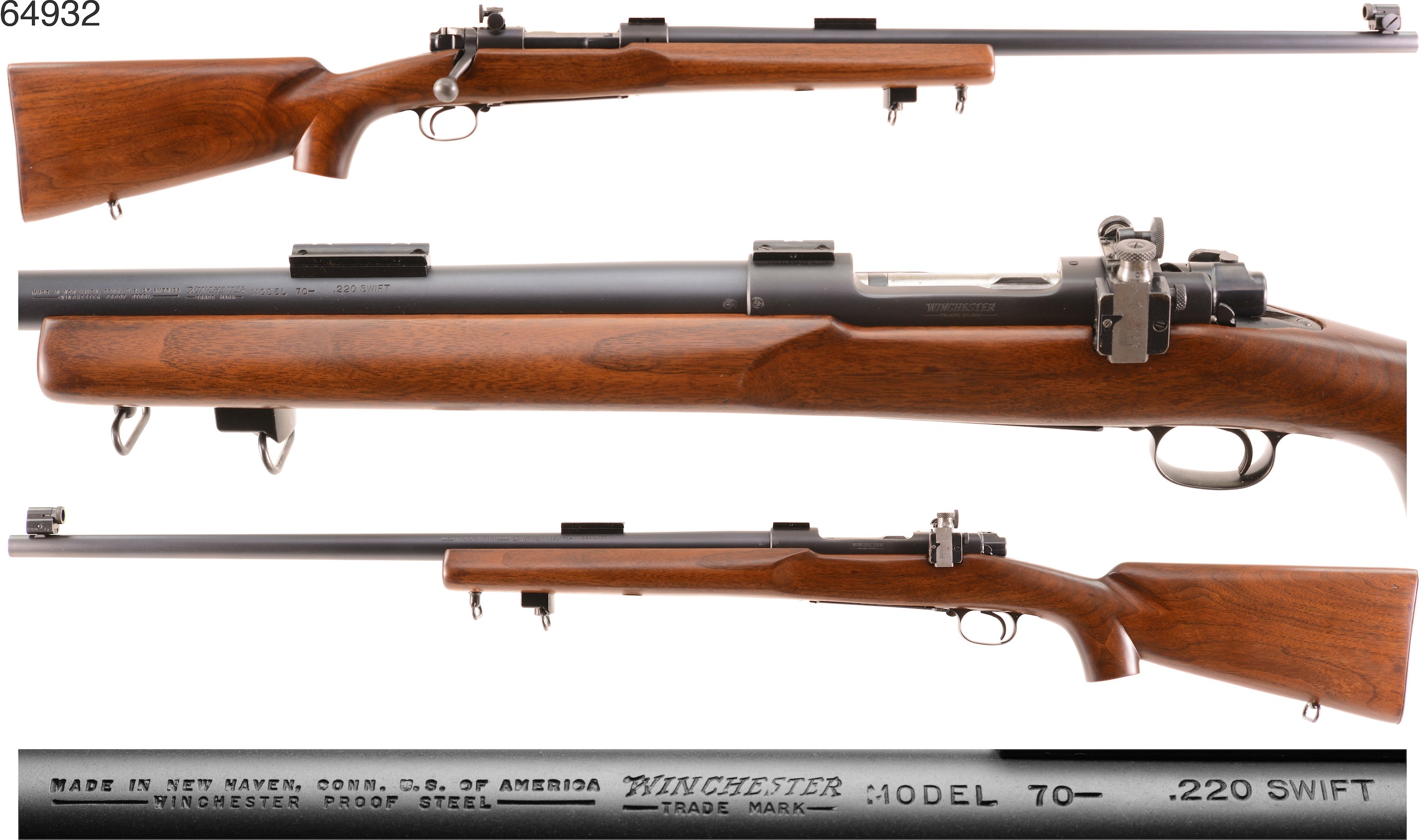

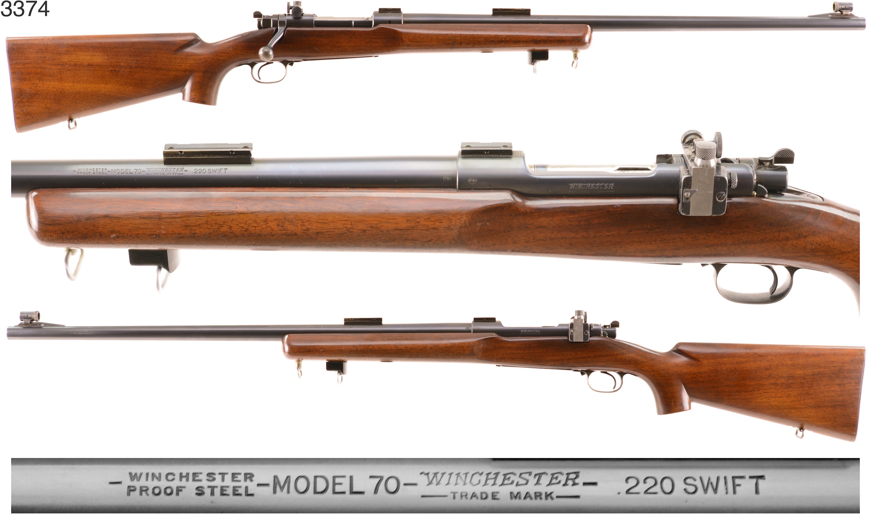

Meanwhile, here are two 220 Swift Target rifles.  Neither is exactly what one should look like if it’s got a 46,000 serial number.  First is the early pre-war (s/n 3374) with the front sight ramp.  Below it is a transition era rifle (s/n 64932).  Your rifle basically should have the (pre-war) action of the former but the matte stainless barrel (with muzzle dovetail) of the latter.
Hope this helps,

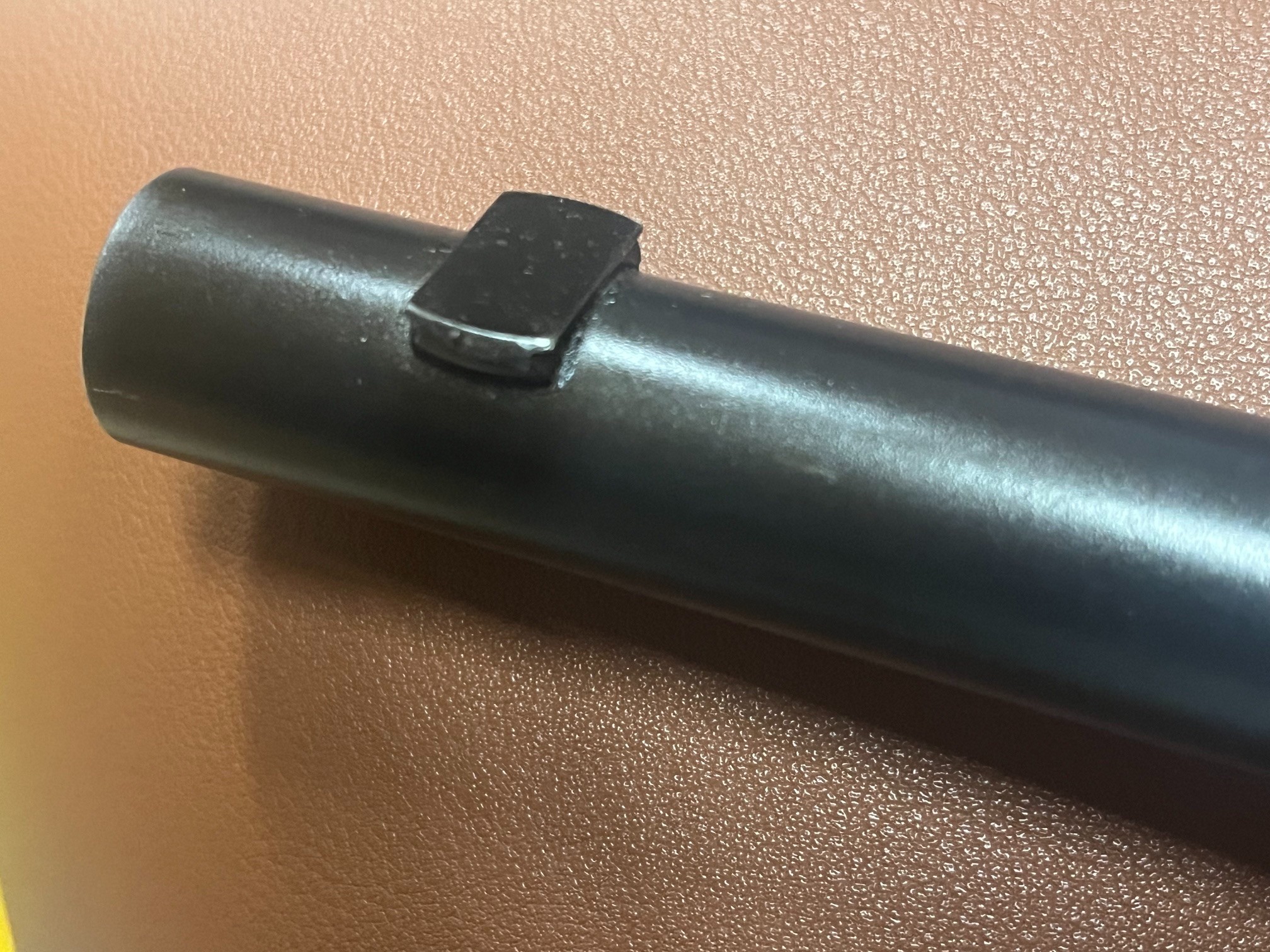

I will absolutely send some pictures, the front sight dovetail is as you described. No front sight just a filler. No threaded holes in the rear of the receiver, just on the front and mid barrel.  I’ll send some pics shortly.

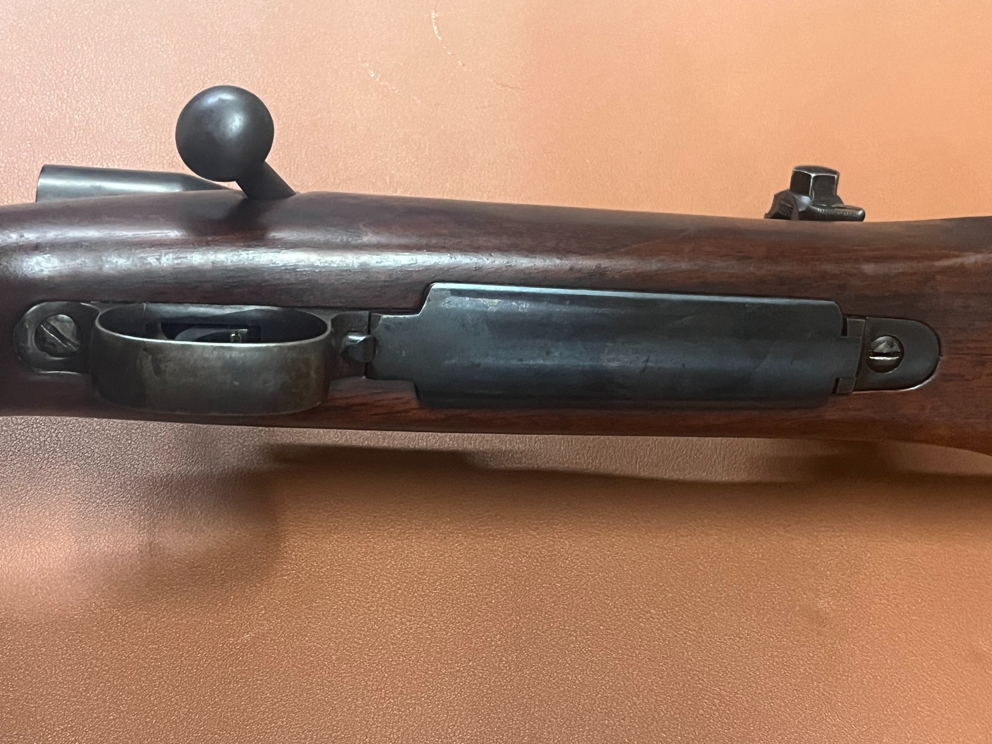

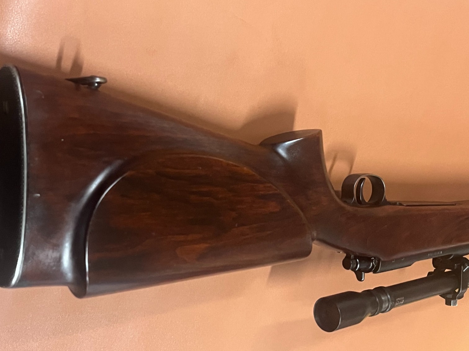

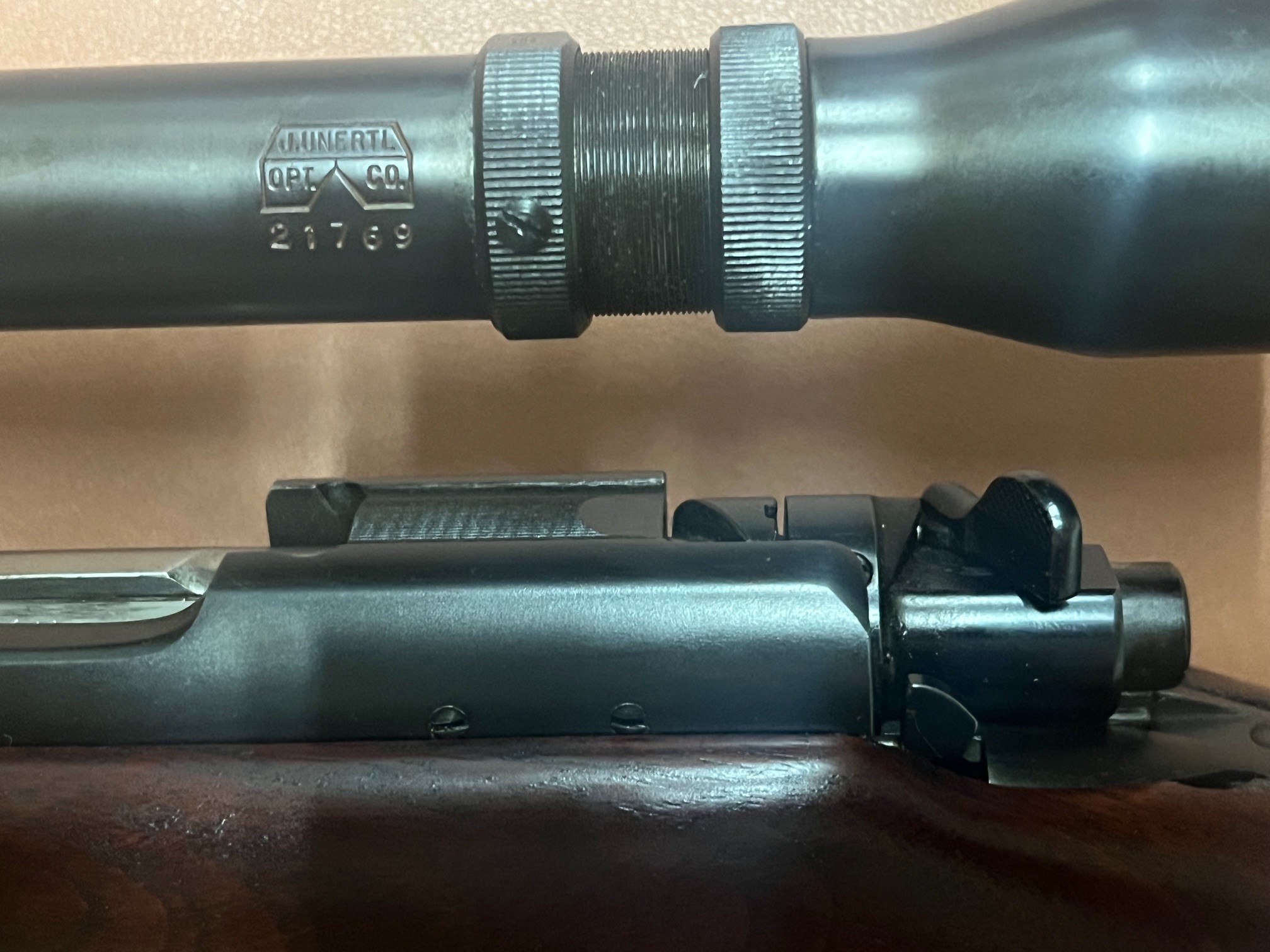

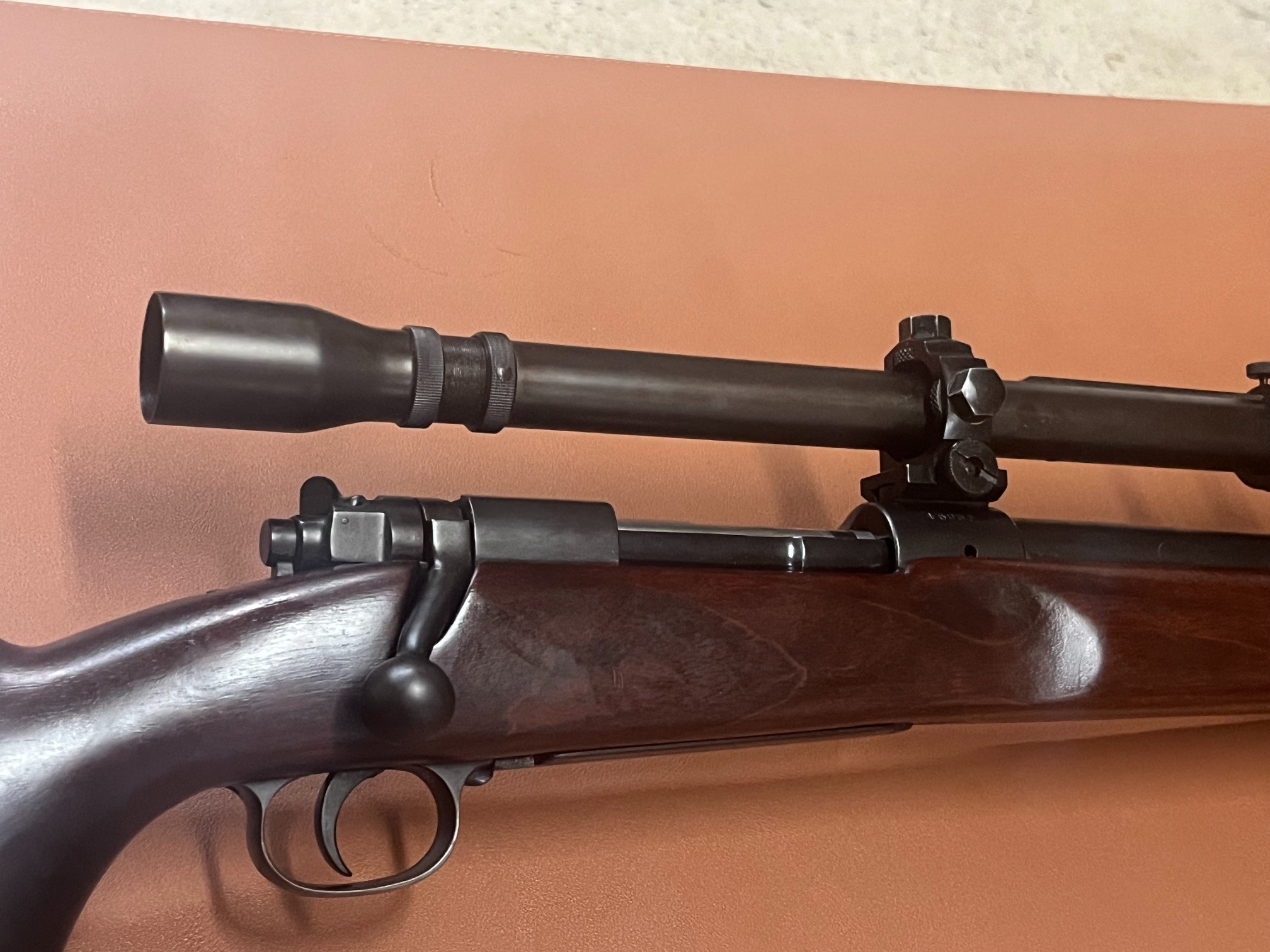

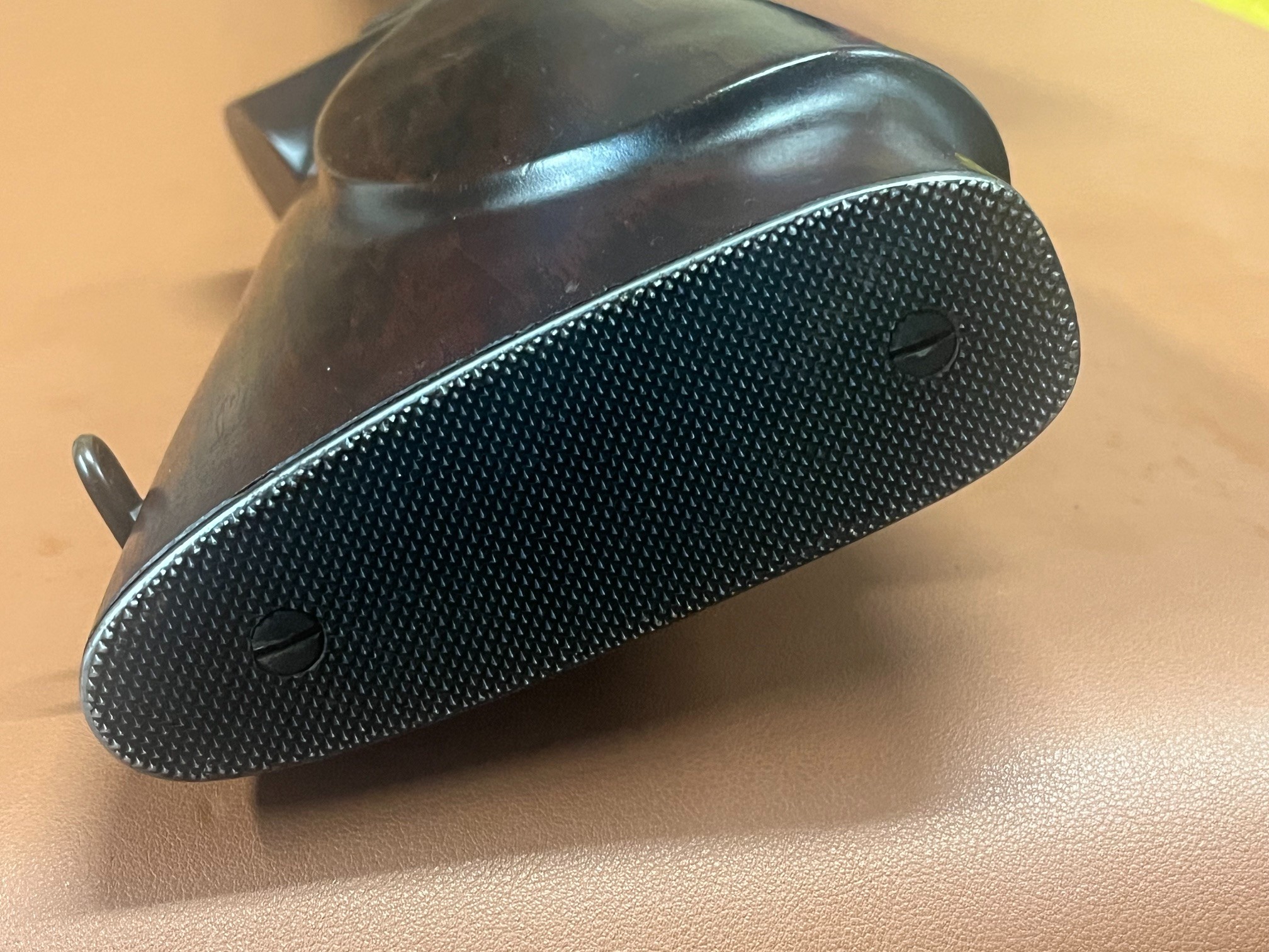

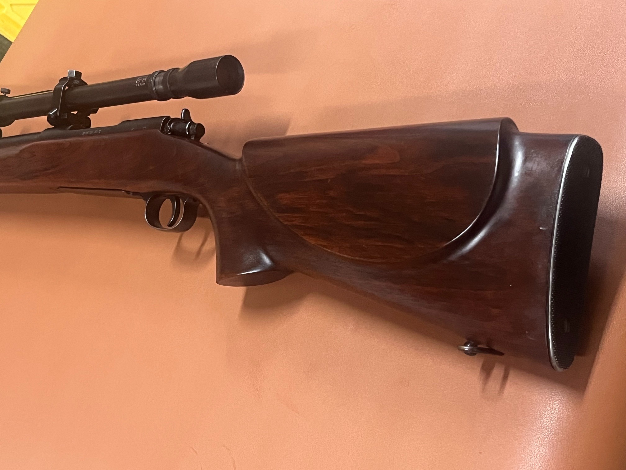

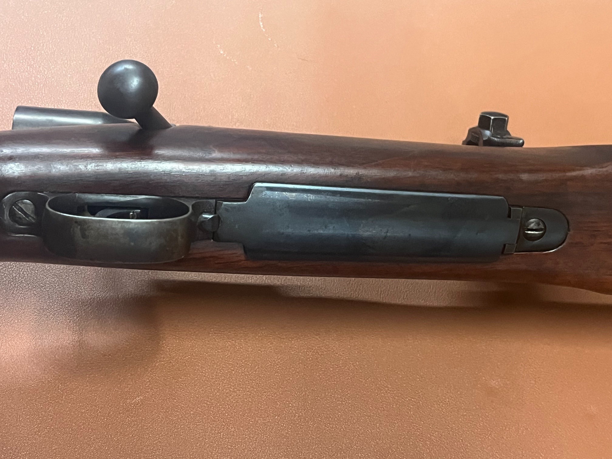

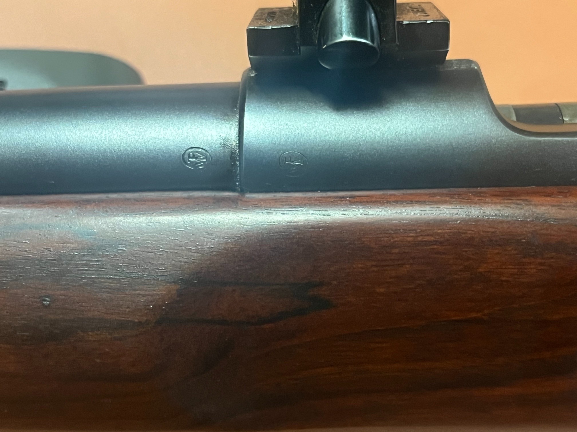

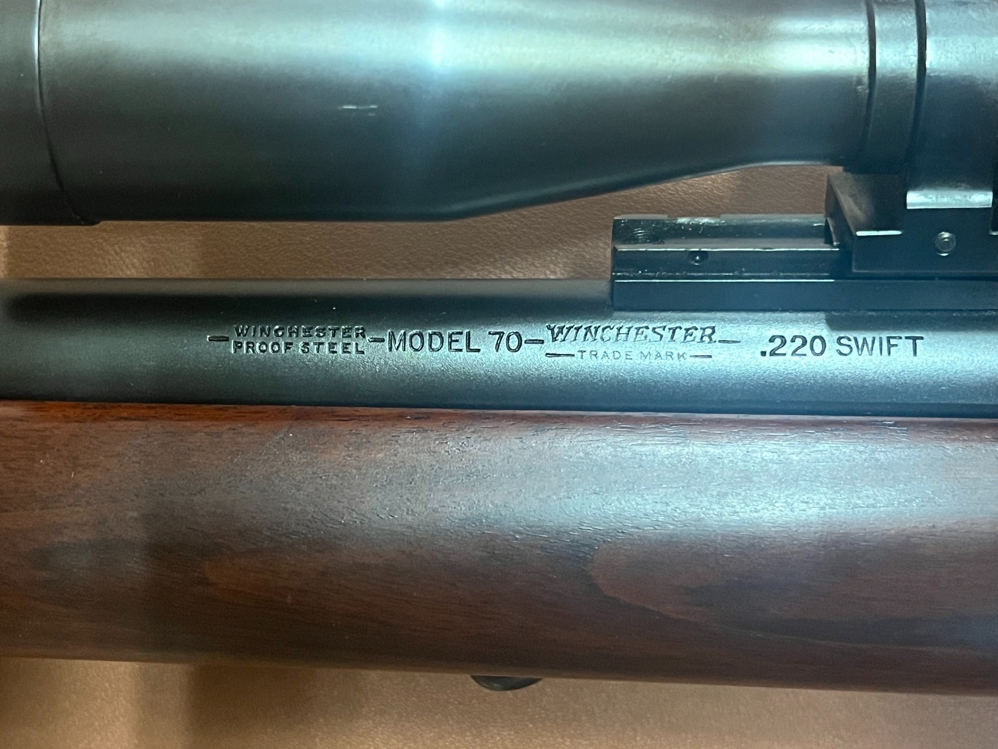

Here are the photos…
Unknown.jpegUnknown-1.jpegUnknown-2.jpegUnknown-3.jpegUnknown-4.jpegUnknown-5.jpegUnknown-6.jpegUnknown-7.jpegUnknown-8.jpegUnknown-9.jpeg
Blue Ridge Parson
Forum Posts: 422
June 1, 2023
May 31, 2026 - 10:48 pm
That is an interesting custom stock on that rifle.  I wonder who created it.

June 2, 2026 - 2:54 pm
I agree would love to know the provenance of the stock, its gorgeous.  And it certainly wasn’t somones first attempt at making a stock.  No marks that I have found, thought I found an easter egg under the front of the trigger guard.  A perfectly folded piece of paper, but it was just the corner of a target, I think it had Boyles printed on it.  Must have been using it as a thin shim.
