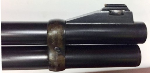

In reply to your question regarding the front sight hood.  The first production ramp front sighted carbines were not machined (cut) for the sight cover.  I am not sure of the exact serial number range of these carbines.  RDB
Forum Posts: 15000
June 27, 2021 - 12:58 am
The earliest Carbines manufactured with a ramp front sight were in the 1082500 serial range (early April 1932) and they were not milled for a hood.  The earliest S/N I have found thus far is 1082562 (April 1932), and the latest is S/N 1090419 (June 1933).
Below are pictures of several;
Winchester_Model_94_1082935_001.jpgWinchester_Model_94_1082935_011.jpgpix655231513.jpgRamp-sight-no-groove-1086500.jpgRamp-sight-no-groove-1086500-1.jpg

For info…  My Model 94, SN 1129740 matches your Carbine “description” but for SN of course,  a “King” full buckhorn aft sight which I’ve retained ‘aboard’. Sort of ‘worn into’ it! “Personalized character!”  Such and the errant sight hood likely discarded decades ago. I’d restore the feature if I had one, but other than ‘hood’ as utility sight protector & anti-snag device, my belief they weren’t particularly popular!  Few pix of my Carbine, King sight & slotted front ramp, below.
Jimbo, my personal observation, this model is the absolute ‘sweet spot’ of this entire decades wide model production!  Combo of milled-integral ramp front sight as well as classic carbine ‘wrap-over’ butt plate… “Classy Classic Carbine!” 🙂

JWin-94-Transitional.jpgWin-94-Transitional-1.jpgWin-Model-94-King-Full-Buckhorn.jpgWin-94-Integral-Forged-Front-Sight.jpgWn-94-Carbine-Butt-Plate.jpgJust my take and…
