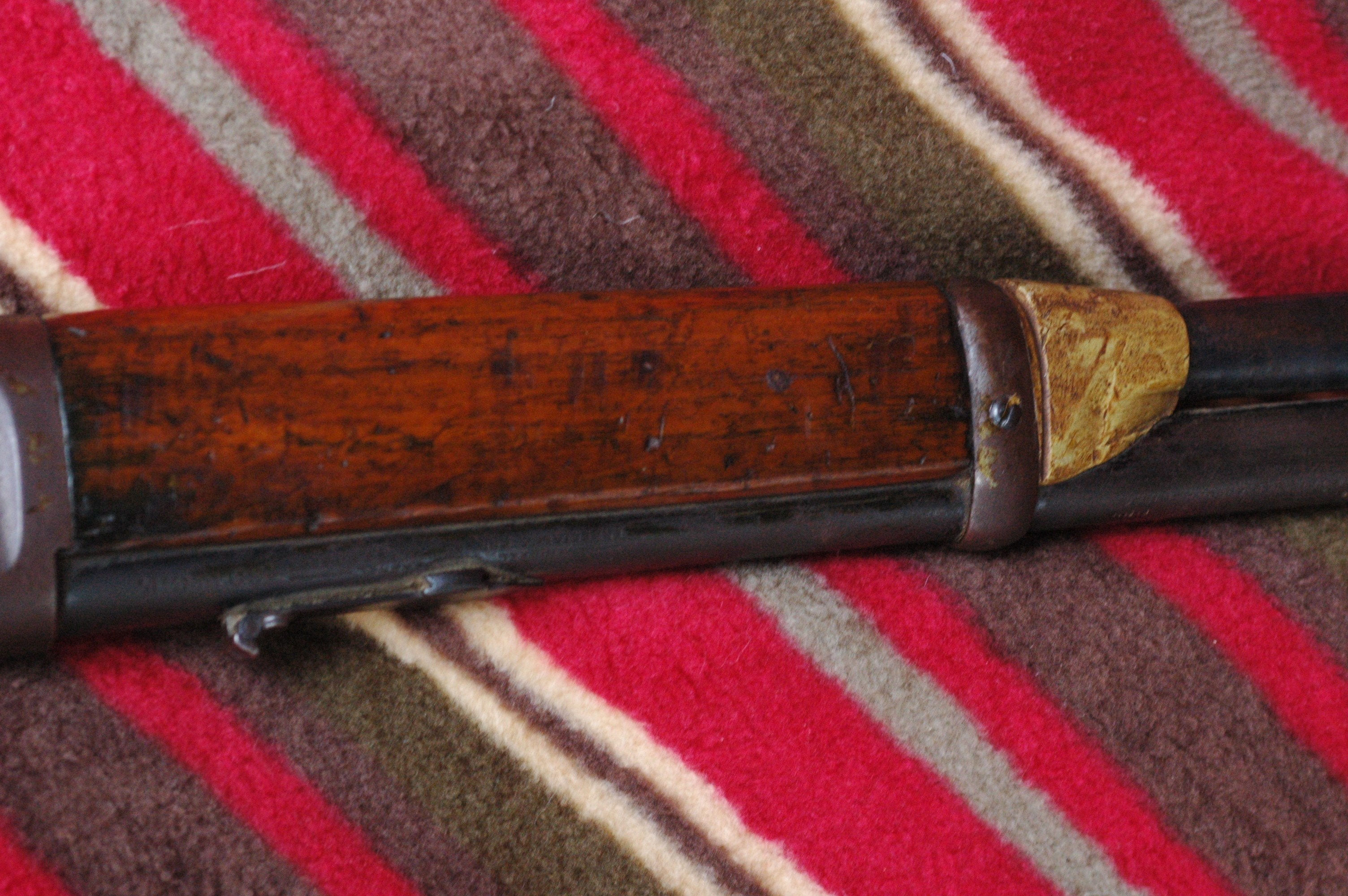

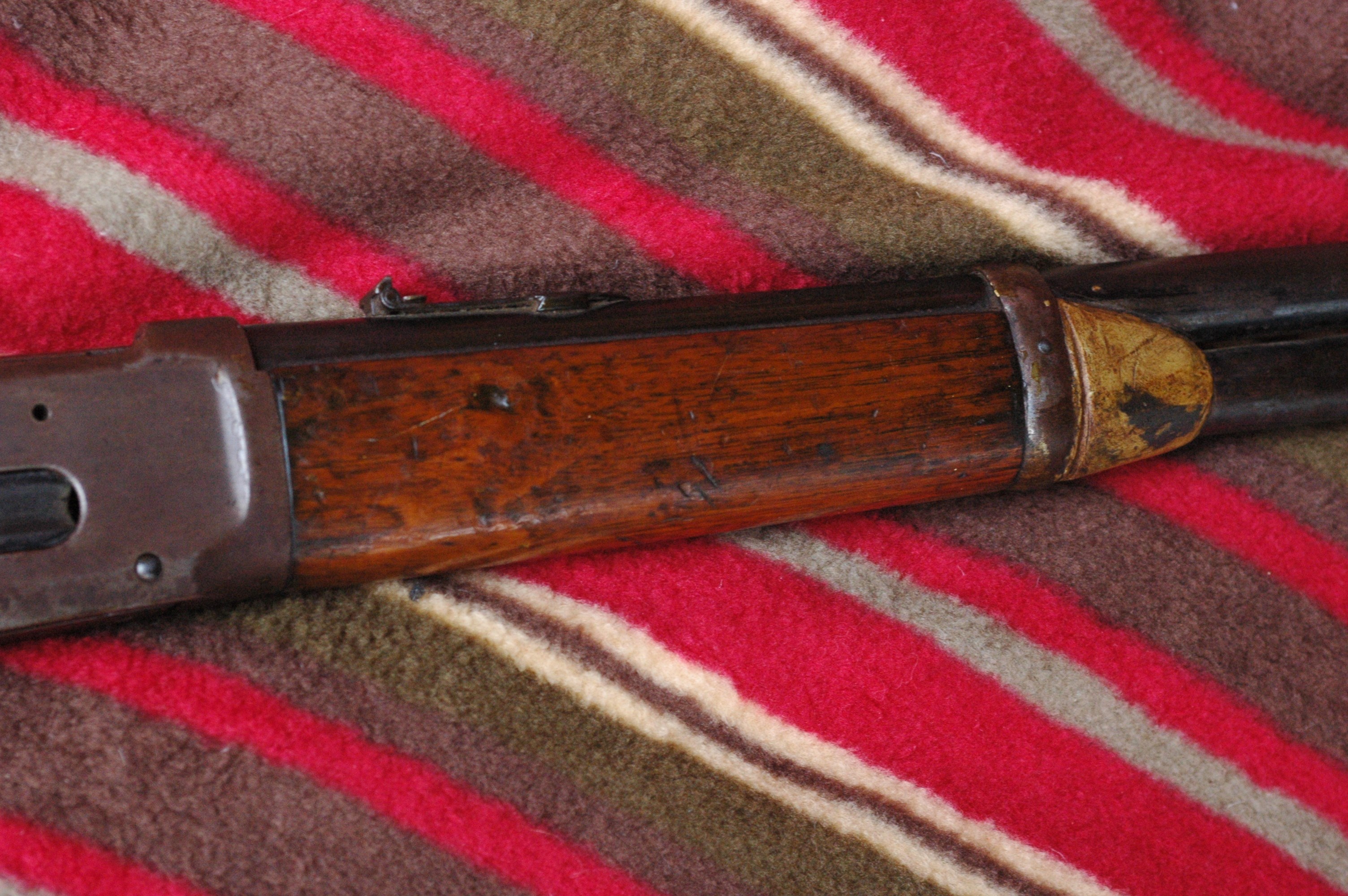

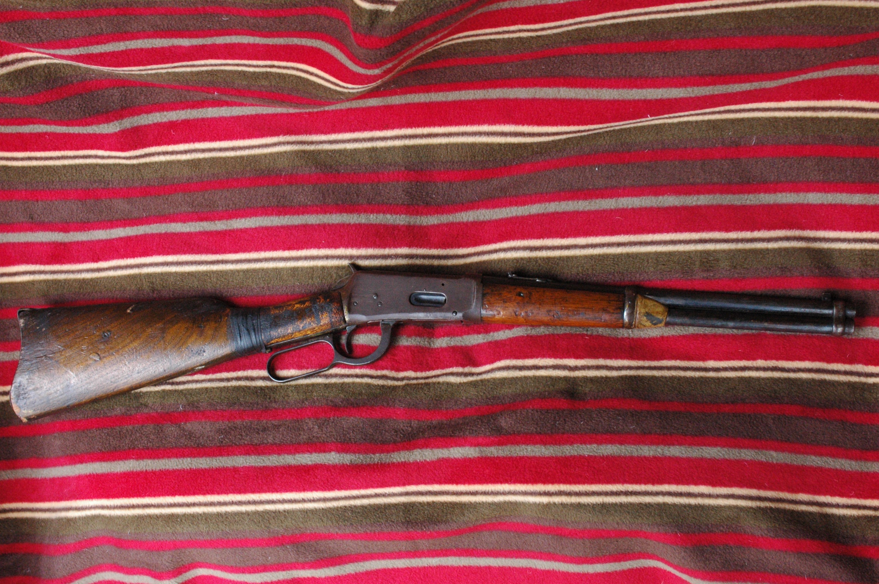

Firstly, I’d like to say I’m proud to be a new member of the most informative and well run forum for Winchester collectors anywhere. A truly awesome resource. A lot of guns run through my pawn shop and sometimes a treasure will slip in among all the plastic stuff. 1st order of business on this one is ATF clearance. It will be in the mail to them next week. I have developed a good working knowledge of collectible/classic firearms through the years but more importantly, I know what I don’t know. That’s why I’m here.
Best I can tell this is a 1927 Model 94 Special Short Carbine (S/N: 999288), original 15″ barrel in obviously rugged condition but I think it is all there. Functions as designed and the bore is very good. Previous owner bagged 2 whitetails with it last year.
My initial thoughts regarding restoration-
New/reproduction stock and fore end, install repro saddle ring (need advice here), have gunsmith check the internals out, go shoot it. Don’t know if the original wood is restorable please advise opinions as this is the ultimate goal. Sorry for the length, thanks in advance for sharing your knowledge.

What is your goal?  Do you intend to resell it after you get the BATF clearance letter?  If you do, I would not do anything to it other than a careful cleaning.  Spending any $$$ to fix it up is going to be a break even proposition if you are lucky.  More than likely, it will cost you more to restore it than you will be able to sell it for.
The stocks on it are Gumwood, and replacement stocks will be walnut. Further, unless you restore all of the steels parts, reproduction stocks are going to look very out of place on it due to the heavy patina on the steel.
That old Trapper Carbine earned its keep, and looks that way because it was used (albeit very hard).  Altering it at this point in its life would not really be of any benefit.

As a Trapper collector, I would do nothing to that gun if the rest of the barrel markings are correct. That Trapper oozes character and history. There are no parts that are restorable, IMO. If it took two deer last year, that would be remarkable.

I t is not possible to get a Cody letter for Model 1894 serial number > 353999.  Further, it is extremely unlikely that a stock for a Trapper will ever be found.  The forend stock length is unique to the Trapper carbines.

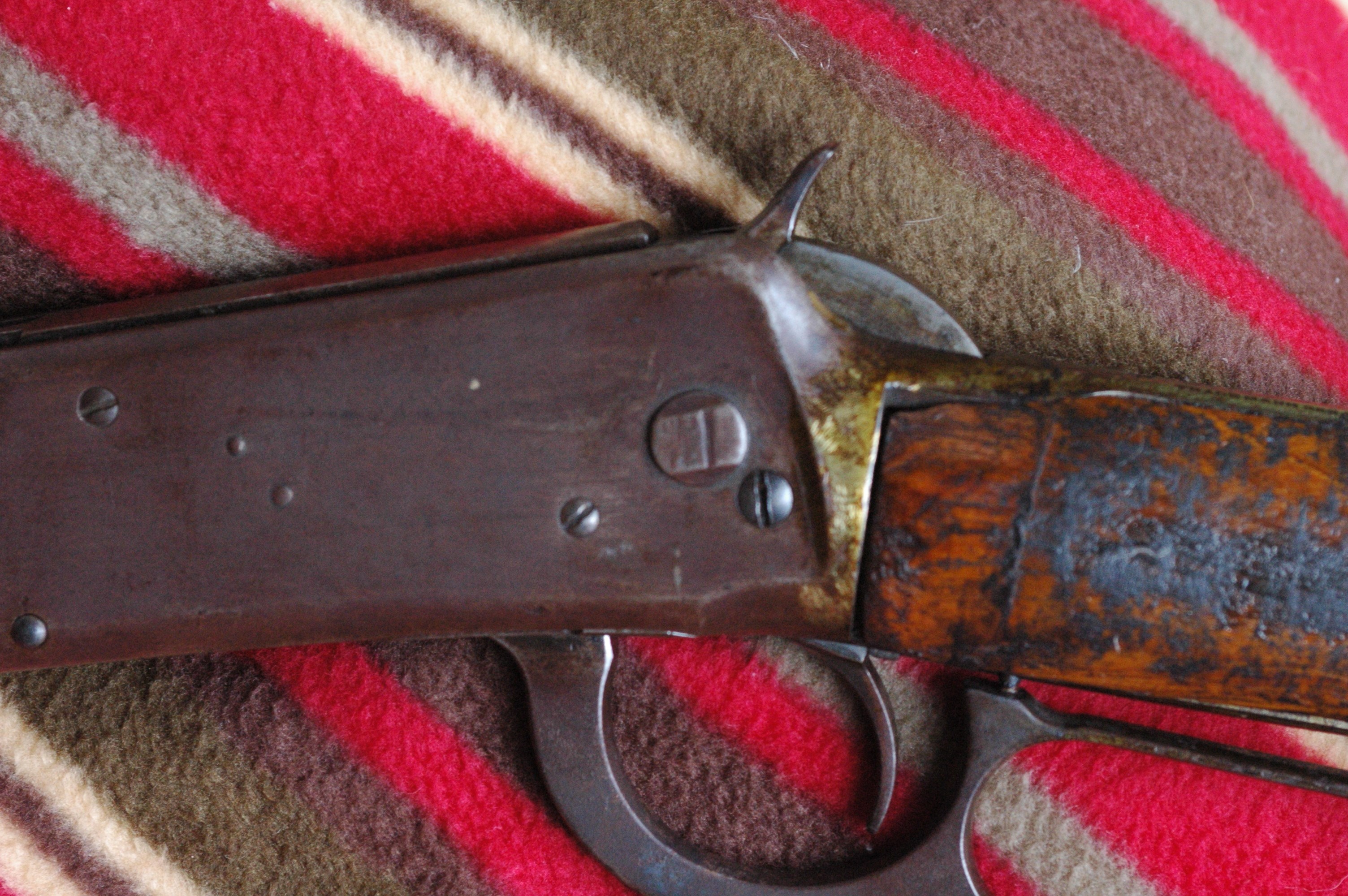

Thanks everyone for the input. Brian’s post outlines exactly what I have in mind. Bert pls advise the correct forend length for these as I have seen it listed as 7 1/8, 7 3/8 etc… I prefer not to use the gun with with the original stock which attaches rather loosely when the electrical tape is removed. Is the rearward tang bolt supposed to screw into the bottom tang? This one currently sports a nut under the bottom tang for attachment. I really just want to keep her shooting with better wood fitting and improve the cosmetics somewhat. My thought is that I can always put the original wood back on if needed for authenticity. Thanks again for the help.

Tang screw/stock bolt should thread into bottom tang..They either have the wrong screw, or the threads in bottom tang are stripped…. Like Bert pointed out it will have a shorter fore end..I knew that but did not think of it at the time I commented..

The correct length for a 15-inch Trapper is 7-3/8″.
