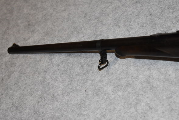

I am tracking Model 1895, 405, serial #53664 in an upcoming auction.  It has 24″ barrel, checkered stock, shotgun butt with rubber butt plate.  There is a barrel band for sling mount attached directly to the barrel just in front of the forend.  Is this factory correct or after market?  There does not appear to be a sling mount on the buttstock. The rifle otherwise appears correct.
Forum Posts: 14937
April 21, 2018 - 3:29 am
Mac,
Aftermarket.  Factory sling mounts were dovetailed into the barrel.

Thanks Bert,  I couldn’t find any discussion of the sling in any of the reference material that I currently have.

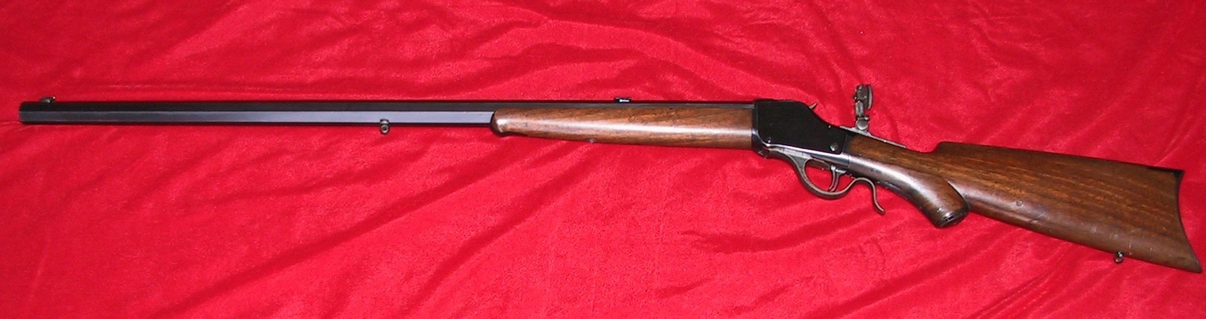

I know this is not a 95 but here is a picture of an 85 with sling mounts.Winchester-1885-45-90-L.jpg
