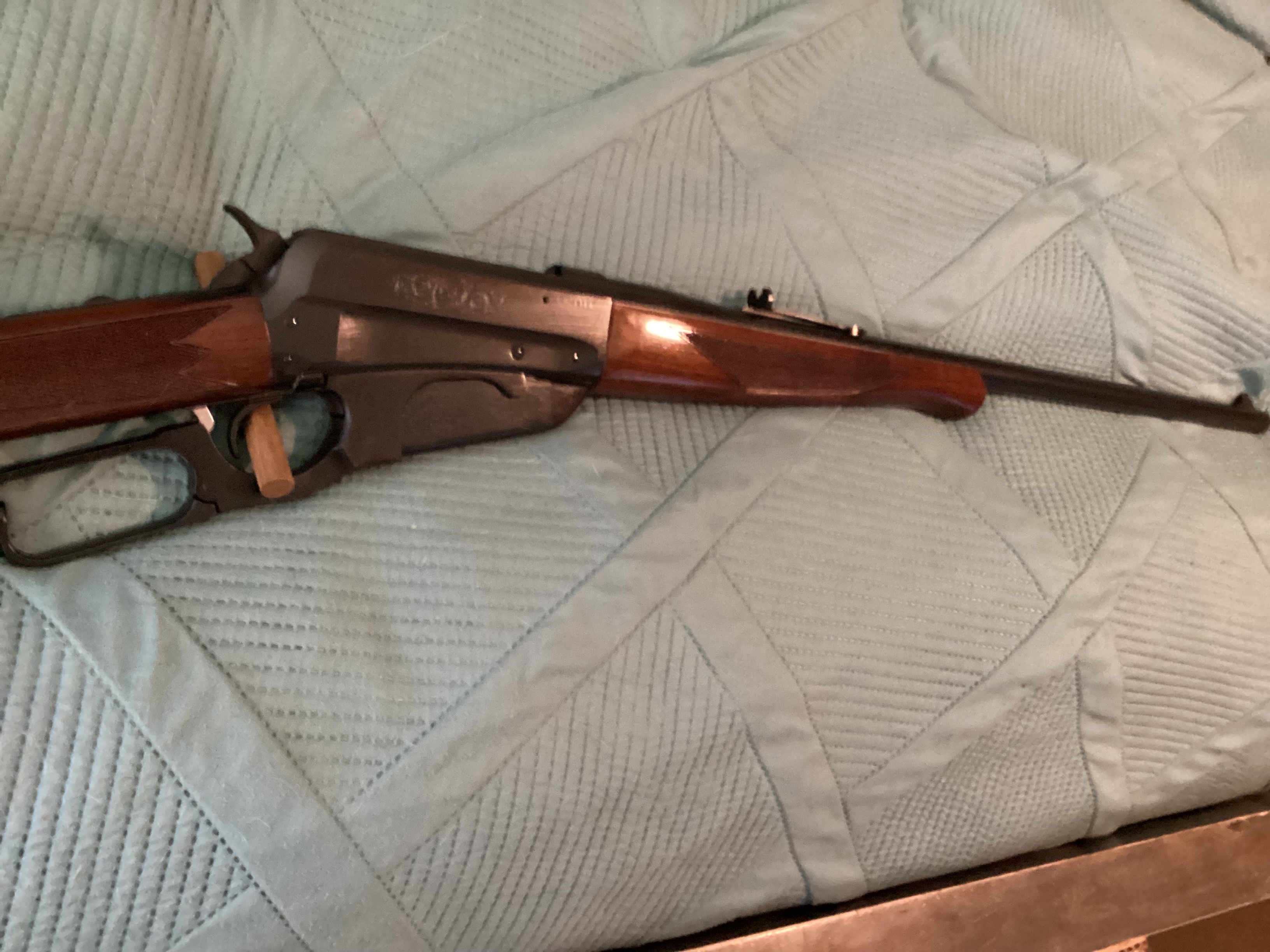

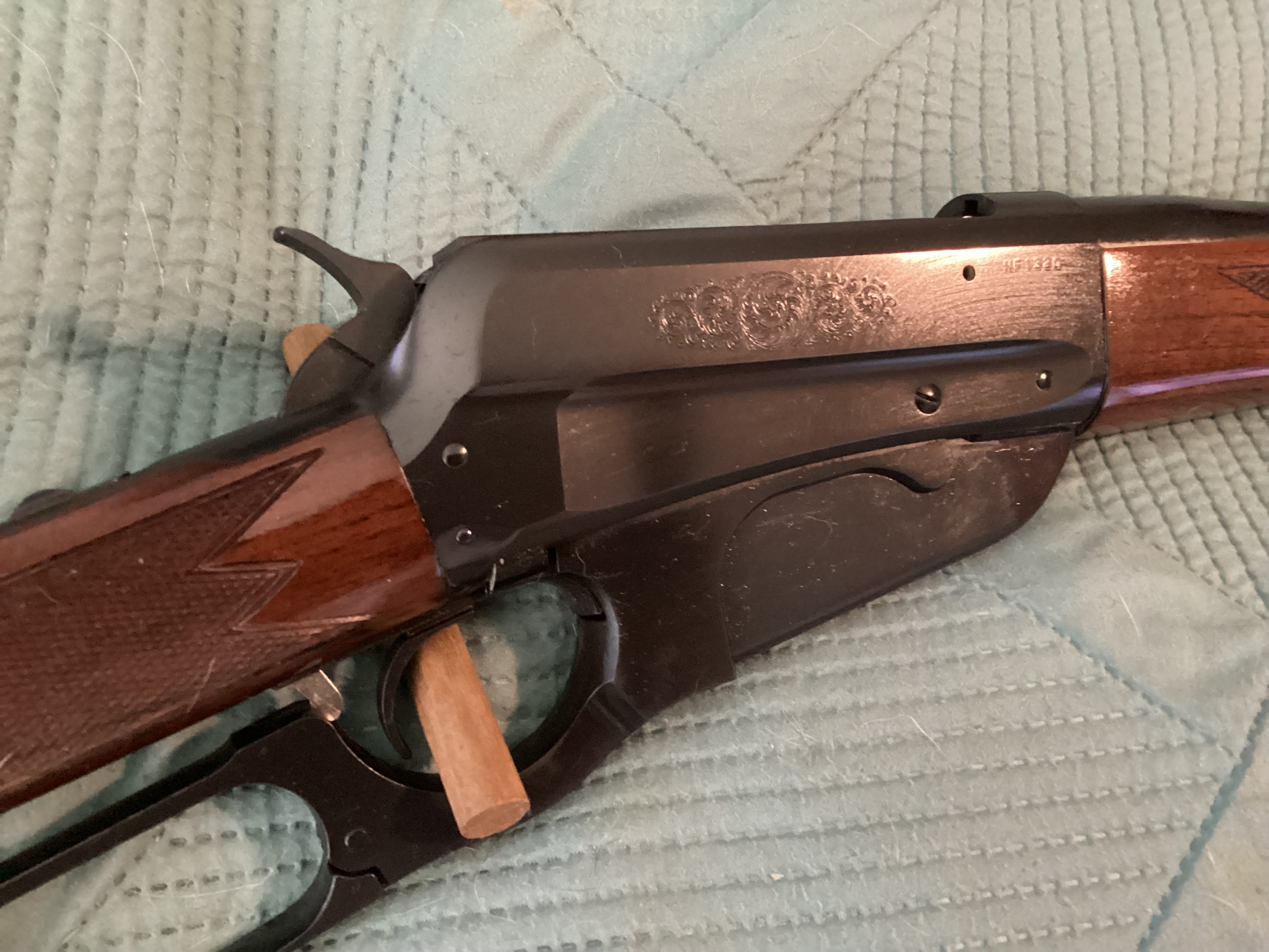

Fellow: I have an 1895 Winchester in 45/70. It. Looks brand new. only Winchester markings and address,But it says made in Japan. It don’t say by who?It has a tang safety on it. It is engraved with a cheynabyl stock. Generally if the are made by Miroku they say so. It is a beautiful rifle, both the stock and forearm are finely checkered. Does anyone else have one? The Bluing is sort of a Matt blue, instead of highly polished. The barrel says “Special Steel” your reply’s are appreciated.

 A couple of pictures and a ser# would be really helpful

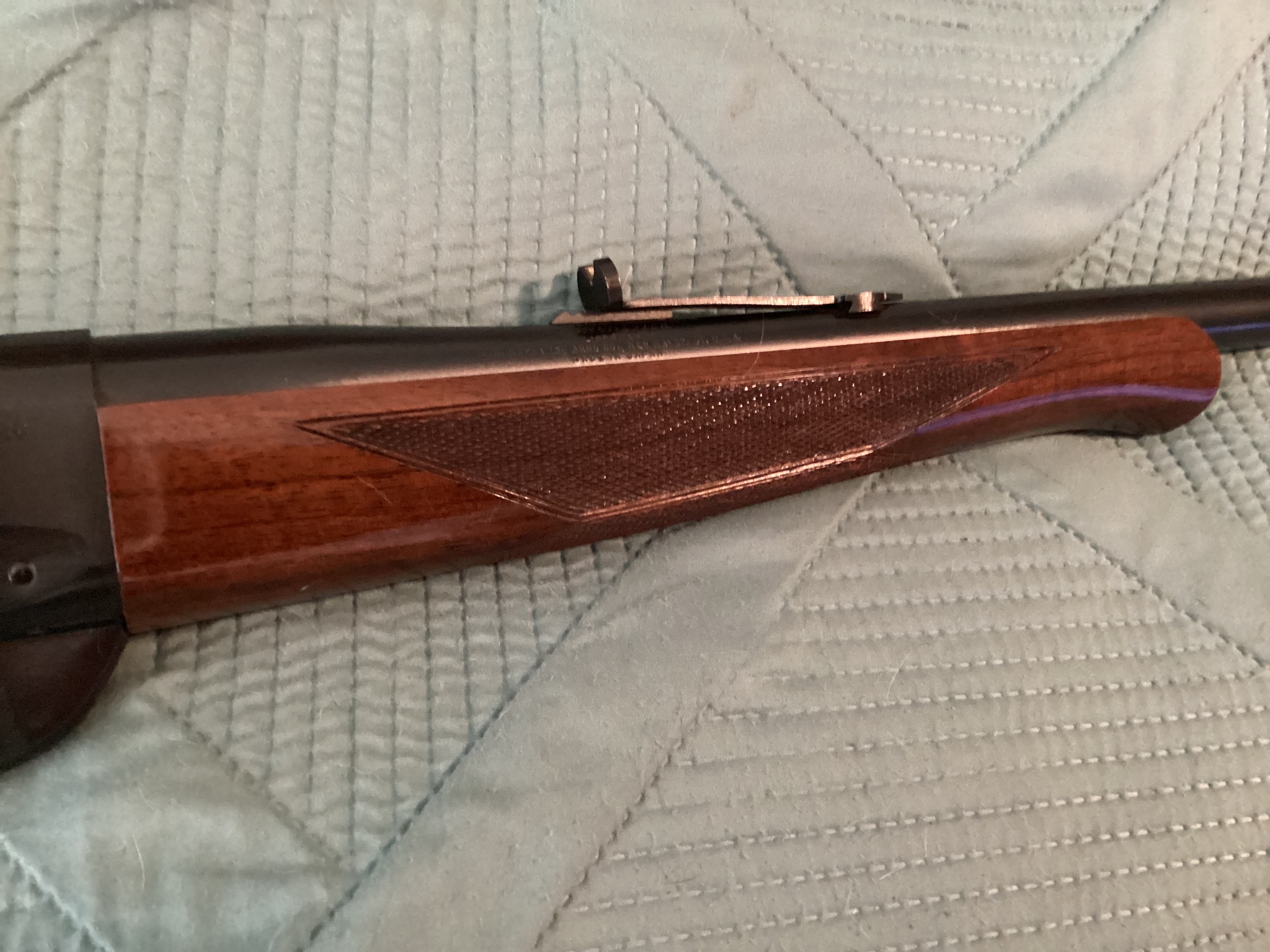

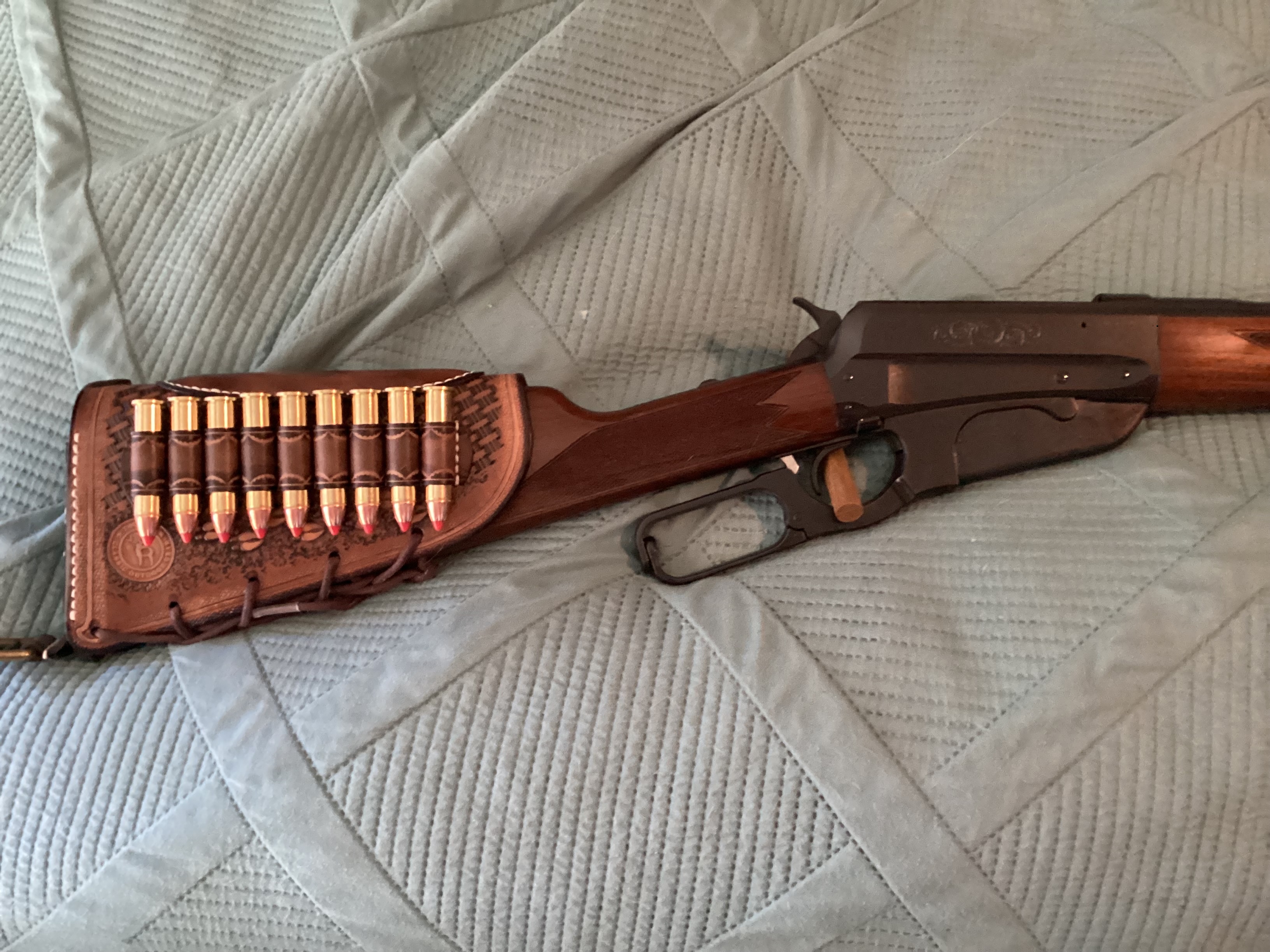

It must be the “Special Steel”?IMG_3104.jpegIMG_3105.jpegIMG_3106.jpegIMG_3107.jpeg

The bullets fit just fine.

Customer Service at WinchesterGuns.com should be able to help you.
FN Herstal has never catalogued a Model 1895 chambered for the 45-70 cartridge, whether branded as a Browning or Winchester product.
The photo showing a blued, engraved receiver is unusual, as well.
Could you measure and report the exact barrel.length with a cleaning rod from bolt face to muzzle?
Would you mind to post a closeup image of the barrel rollmark of the caliber.
The tang safety and “special steel” rollmark are consistent with Miroku built, Winchester branded rifles sold by FNH through its Browning Arms Company subsidiary, d/b/a Winchester Repeating Arms.
The odds strongly favor this being a one-off modified gun. If the caliber designation on the barrel has been altered, i would guess a .405 WCF barrel has been rebored to .458, assuming that is possible, and the barrel threads set back to allow rechambering to the shorter cartridge. A non-standard barrel length would be evidence of this.
Alternatively, MIroku has made round tapered 45-70 barrels for Model 1886 rifles, from time to time. Could this rifle have been rebarreled with one of those?
Forum Posts: 2534
June 5, 2026 - 10:10 pm
From what I can see of the receiver, it appears to have been a high grade, engraved and probably French gray receiver that has been refinished to a matte blue. The engraving seems have been rendered less distinct by polishing.
French gray receivers with engraving and gold overlays were a common feature of Grade 2 or High Grade Miroku Brownings and Winchesters. Tang safeties were not installed on the Brownng branded rifles so the base receiver is almost certainly a Winchester branded one.
If you would, I would like to see a complete list of all the marks, by location.
Unless shown evidence to the contrary, I believe this is a non-factory hybrid modified gun.

I need to apologize: The weapon is a 30/06 not a 45/70. Here are all the markings on the weapon. On the right side under the real sight it says “ Winchester” under Winchester it says. License. Under license it says. US Repeating Arms Co USA. Under that it says Made in Japan. On top,in front of the receiver it says 30/06 cal. Under the rear sight on the left side it says It says Especially made for Smokeless Powder, under that is says Special Steel Barrel. On the right side of the receiver to the rear it says NF 1320.  My 45/70 is a model 1886. Sorry. I am glad. I did not try to shoot it?

Oy. You even have 45-70s stored in the stock, and you stated they fit??
