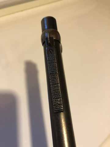

Hi!
Has anyone ever seen a front sight on a Winchester 1894 SRC (1927 mfg) like the one in the attached picture?  Is this original or has someone modified this in years past?   Thanks for your information in advance.IMG_0545.jpeg

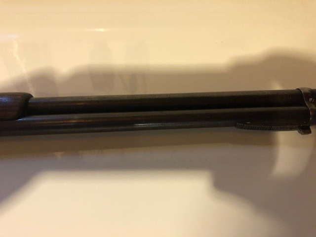

You need to take a picture from the side so we can see the sight profile.

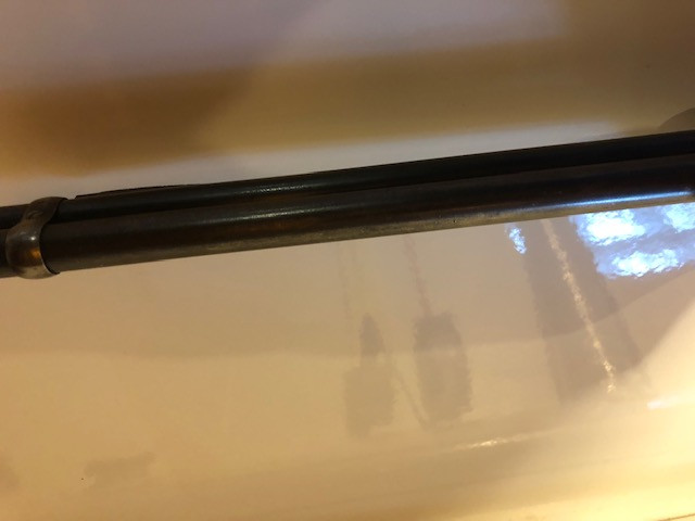

Here are the photos. You still need a good picture of the front sight. You can’t see any detail cause its so dark.

When I enlarge the photo on my computer, it has a gradual arced contour up to the height of the site.  Have you seen odd sites like this before from Winchester?  I’ve search Winchester photos all over the internet and haven’t seen anything even similar.

That is definitely not a factory original Model 94 SRC front sight.  What is the serial number on that SRC?

The integral front sight is still there, the ramp has been added.

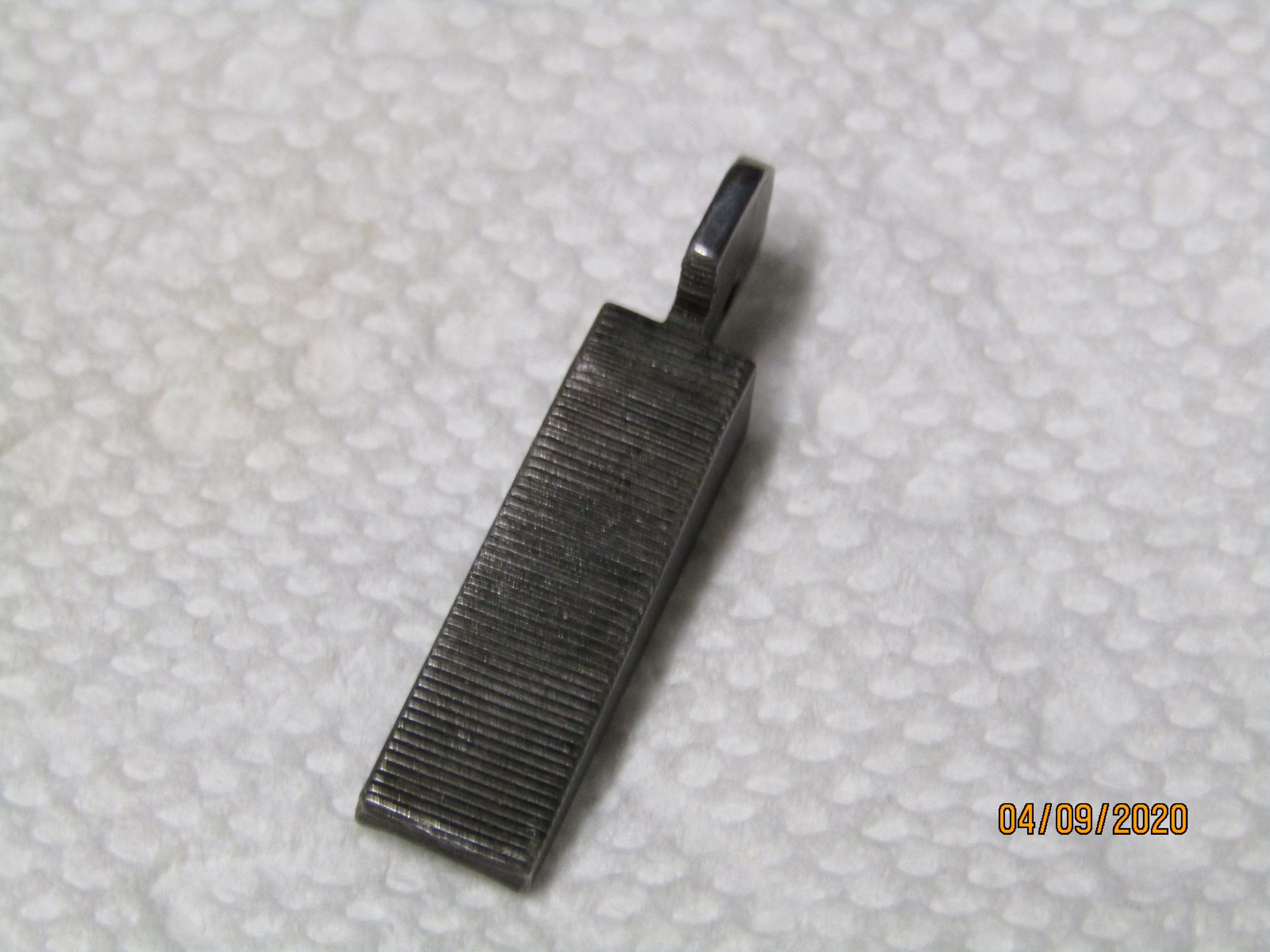

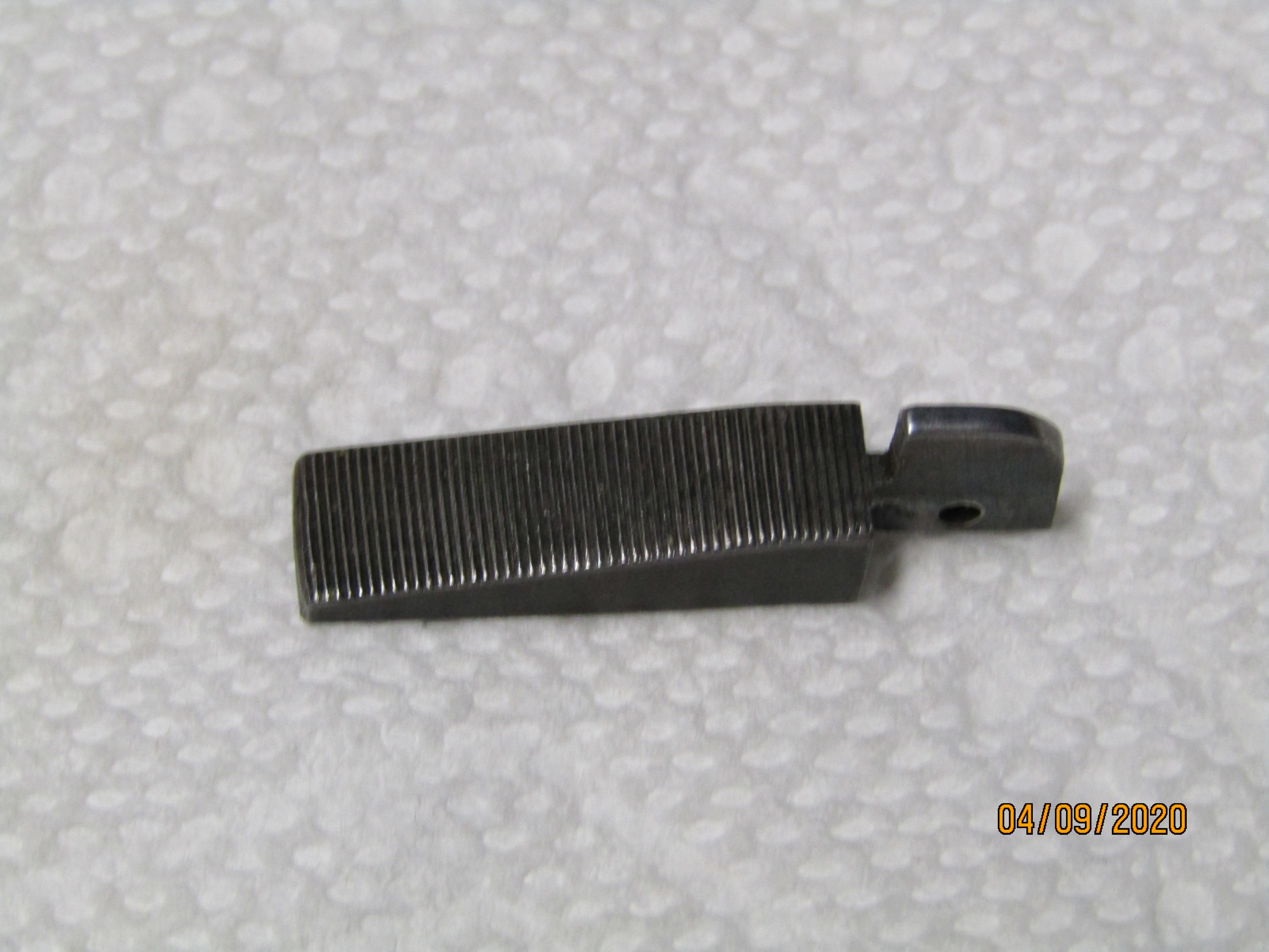

Maybe these pictures will help. This sight came off an 1892 .44 S.R.C.  I have a “thing” about unusual sights and I bought the carbine just to get the sight off of it.  I takes the place of the standard blade carbine sight and uses the standard sight pin to hold it in place.  The base is contoured to match the barrel radius exactly.  When in place it is almost impossible to tell it isn’t part of the barrel.  Roger B

The sight in question has a slotted screw apparently attaching it to the barrel.  The screw is near the forward end of the ramp.

It definitely is not a Winchester sight and as Bert said it is screwed to the barrel.
We need to see a side profile of the sight is what 1873man meant.  Here is a lightened version of the top view.
Forum Posts: 5002
April 9, 2020 - 5:36 pm
Thanks Chuck for the photoshop. Its a homemade ramp. They used a center punch to make the ramp matting. I assume the screw holds the ramp in the barrel which permanently killed the guns vale.

But I agree that it appears to have been made from a center punch for designing the texture on the ramp towards the original site.
And as Bob has mention, I passed on the purchase of the rifle due to the appearance that the barrel is more than likely tapped.
