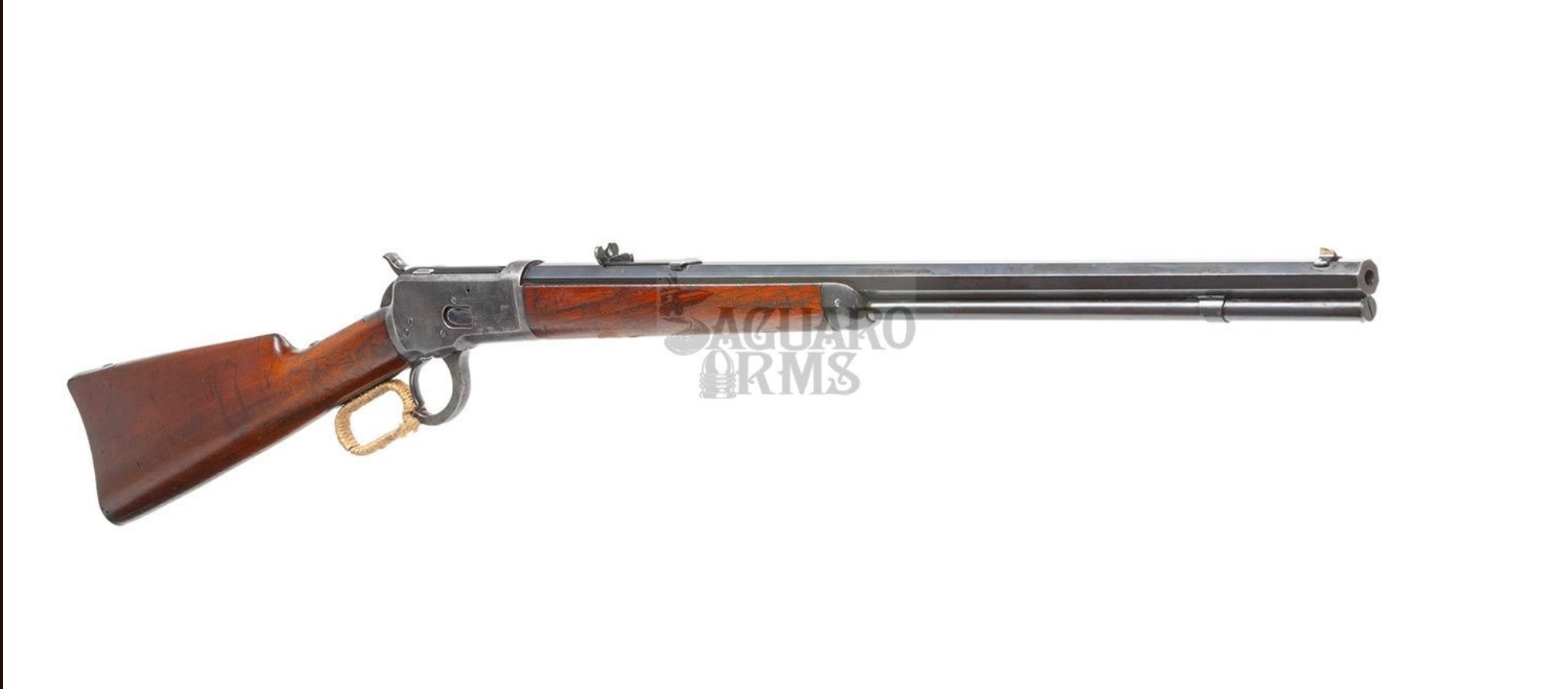

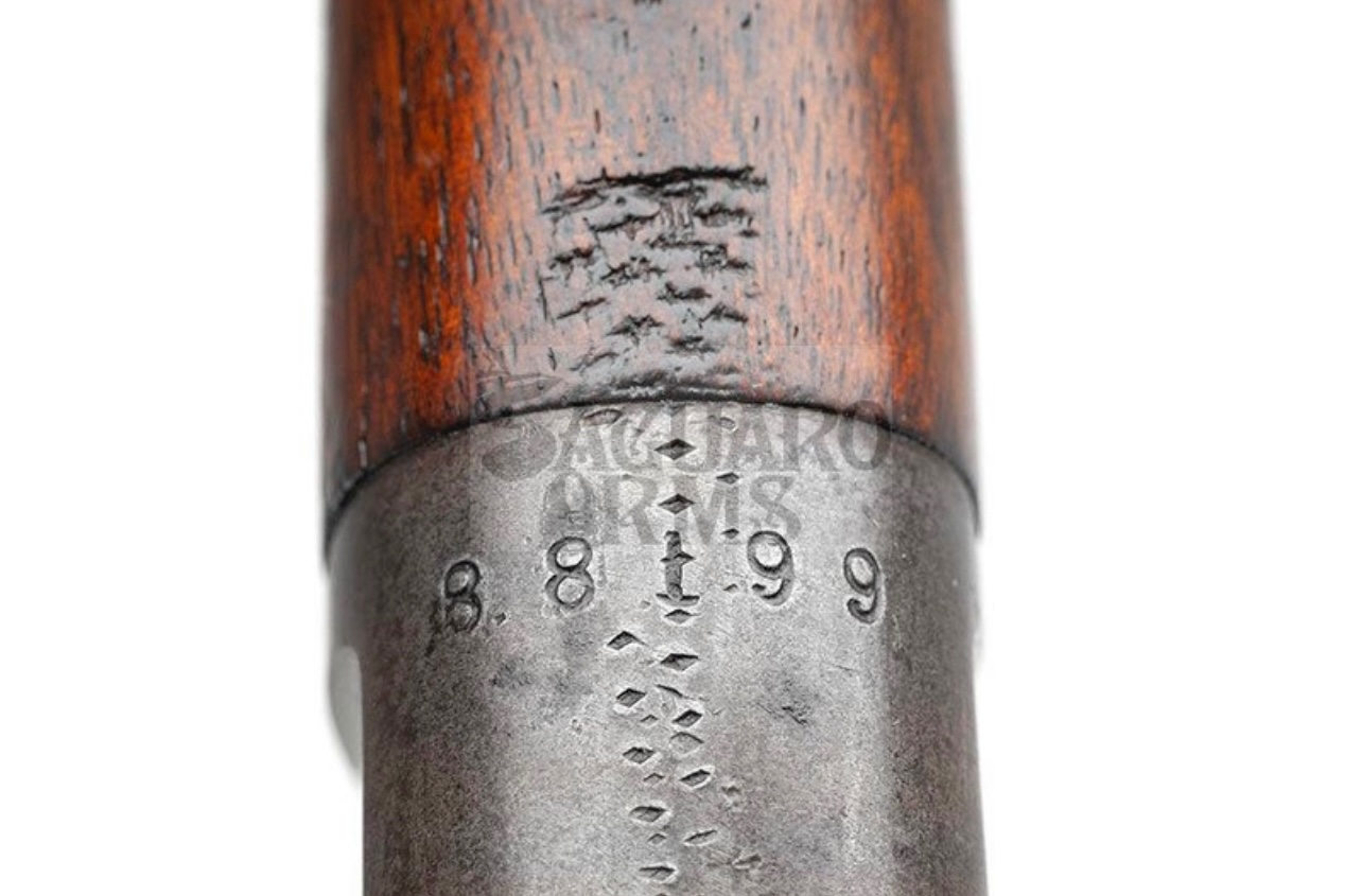

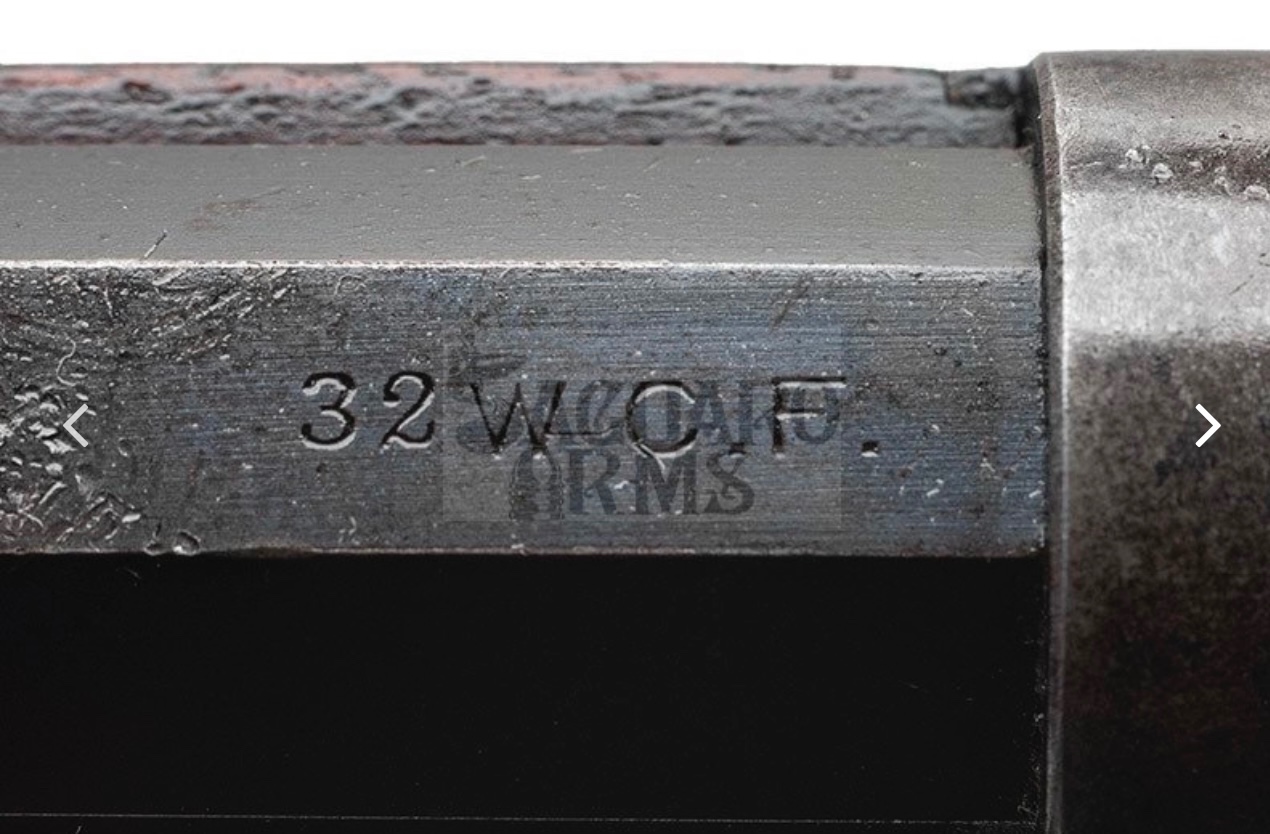

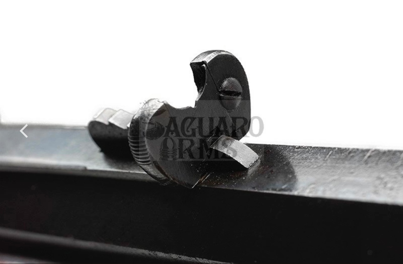

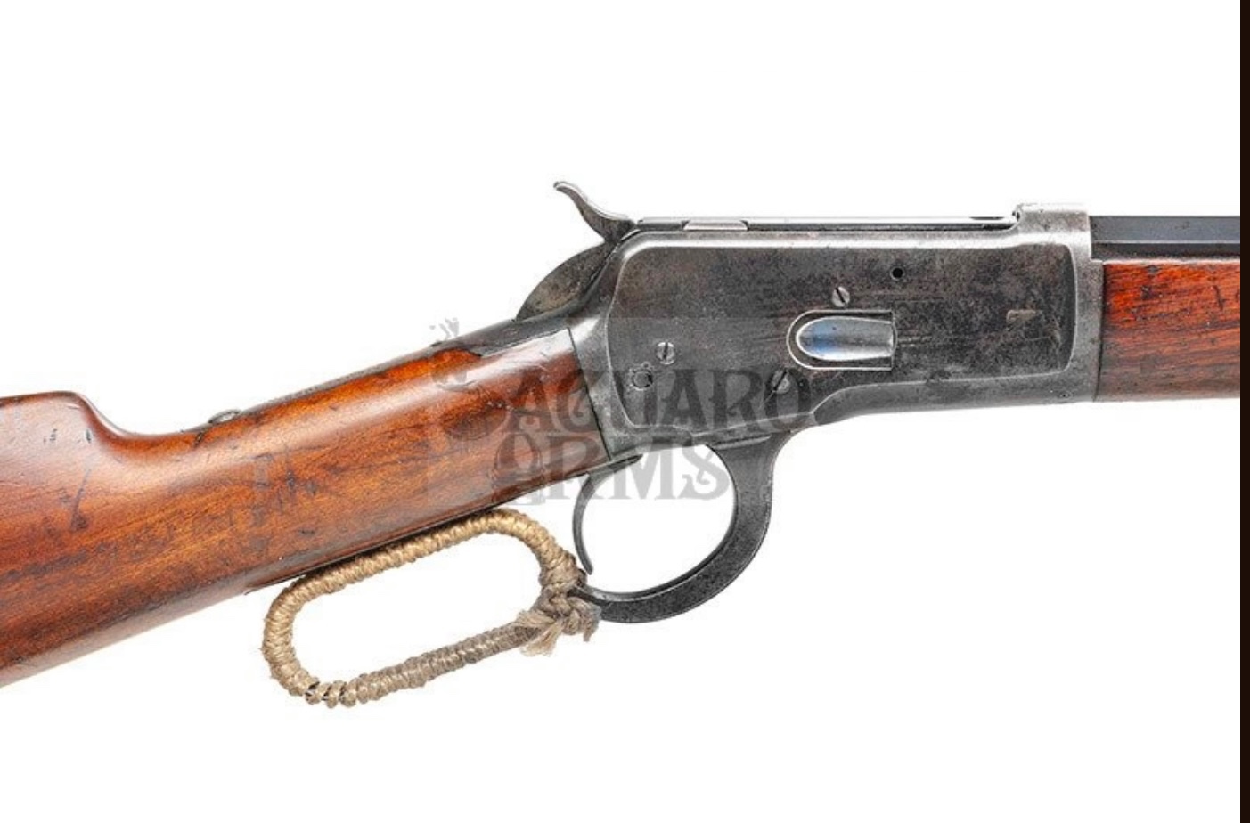

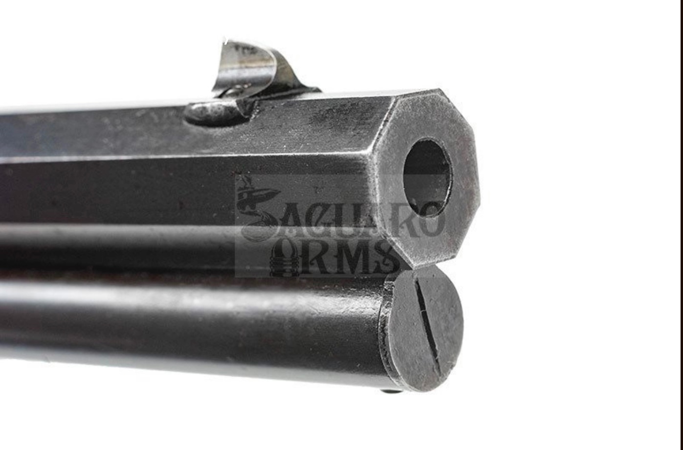

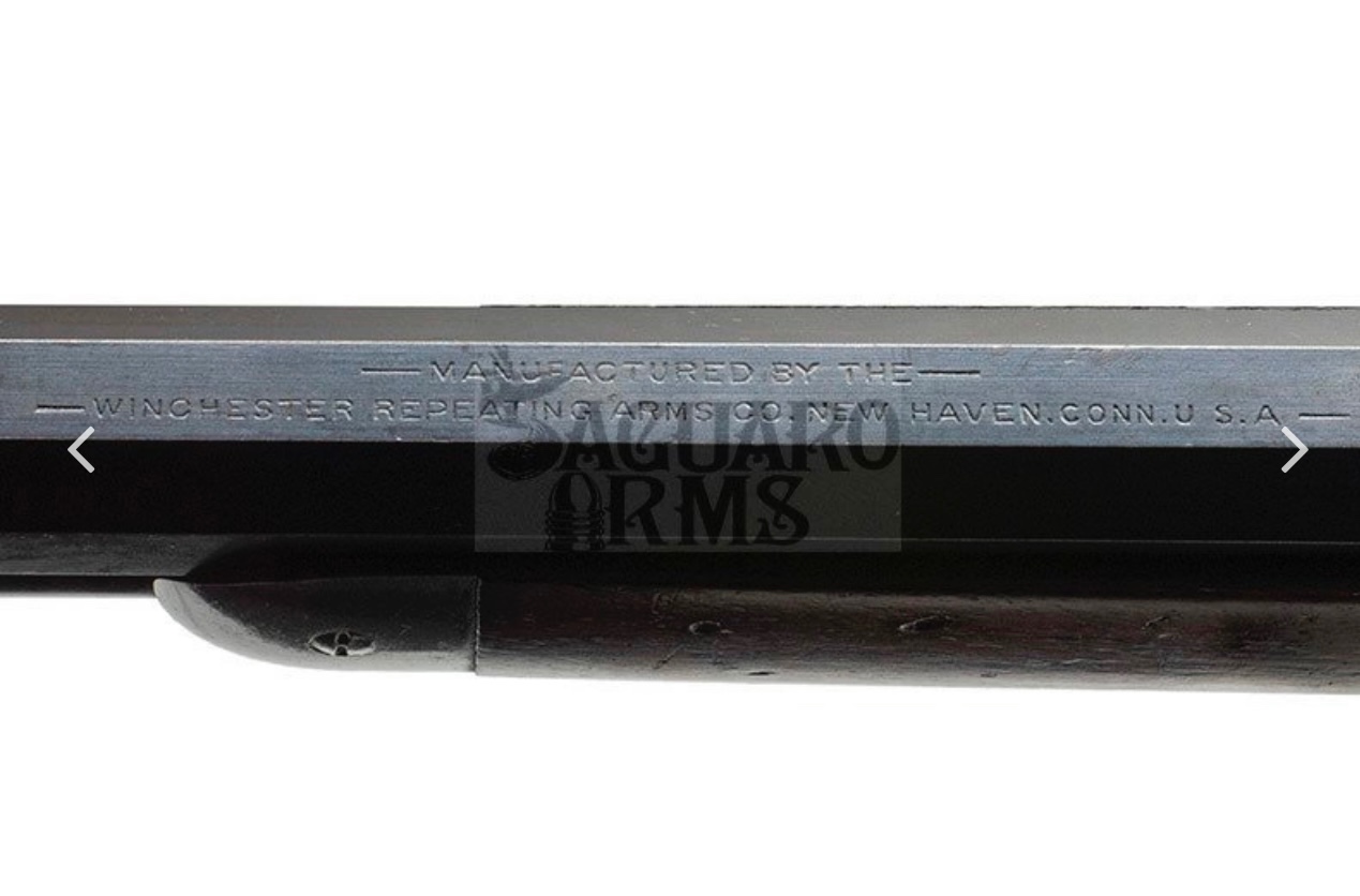

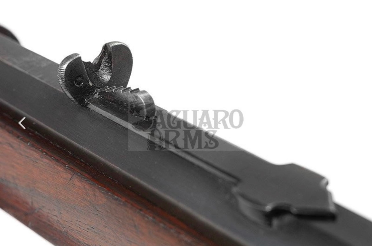

Hello Folks!I’m very happy that I found out this forum.I live in Poland and there is a nice 1894 Winchester live action rifle in a shop to buy.Please, I need your help to identify if it’s an original and if it’s worth to buy. I know these anre only pictures but maybe some of you who are experts will know. The salesman says its original 1892 Winchester 32 WCF. Production year is 1894. It’s in perfect condition and so on. Here are some of the pictures of the rifle. Serial number is 8899 or 88199 wondering if this vertical stamp is actually 1 digit. anyway, when putting both numbers manufactured date doesn’t match what salesman says-  it’s either 1895, or 1900. Please answer what’s your opinion about this rifle.Thank you very much for your help.IMG_2328.jpegIMG_2327.jpegIMG_2324.jpegIMG_2323.jpegIMG_2322.jpegIMG_2321.jpegIMG_2319.jpegIMG_2317.jpegIMG_2316.jpegIMG_2315.jpegIMG_2314.jpegIMG_2313.jpegIMG_2312.jpegIMG_2325.jpeg

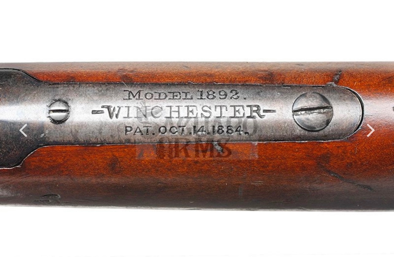

The serial number is 88199 and that identifies it as a February 1898 production Model 1892.

Thank you Sir for your answer.The serial number in 88199,not 88179 if my eyes see correctly.What do you think about the rifles,looking on the photos?Thank you,

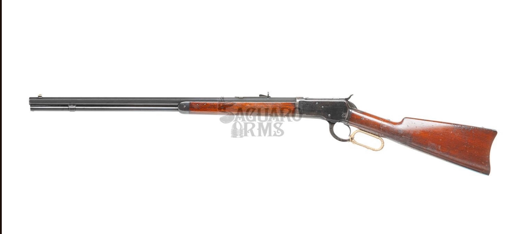

Correct, s/n is 88199.

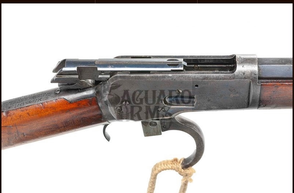

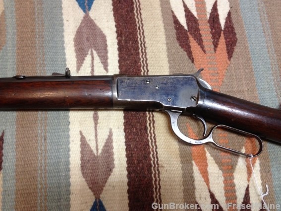

The butt stock is not original to that rifle (it is a Model 1892 Carbine butt stock).  It appears that somebody put the rifle in a bench vise which damaged the bottom of the forestock and receiver frame in doing so.  The rest of the rifle appears to be in good condition considering its age.

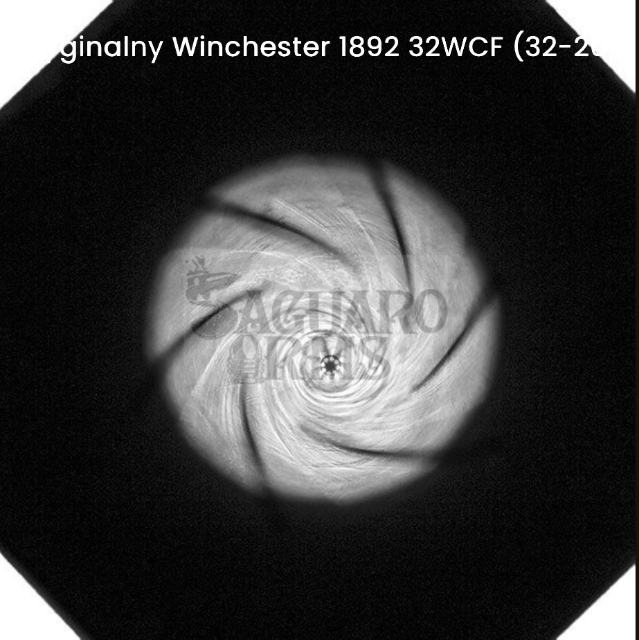

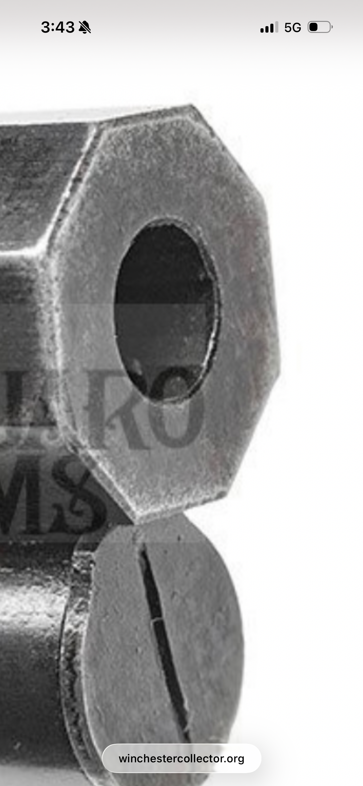

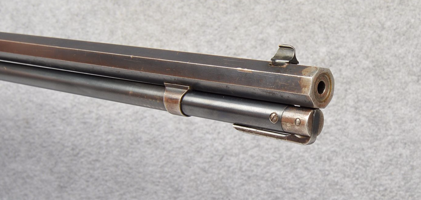

Bore looks better than I’d expect for this rifle, I’d want to look into the breech to see if it has been relined. Can’t tell from the muzzle face. Shame about the vise damage, nice looking rifle.

Those vice marks hurt my soul but I wonder if an original owner did that or someone who only viewed it as a utility tool with no cares for it…..I’m going to tell myself that at least. I think Bubba would’ve been kinder!

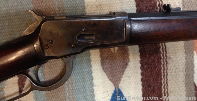

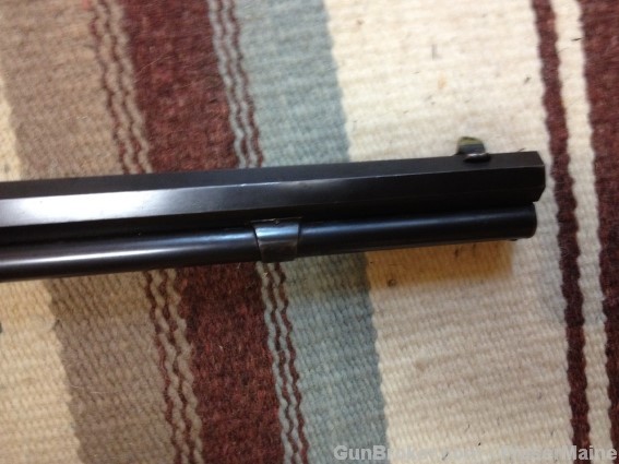

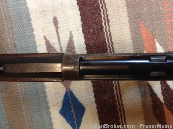

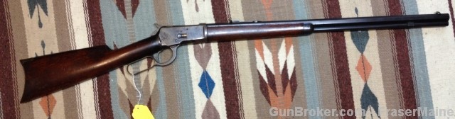

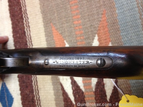

Od 13 lat prowadzę badania nad karabinem modelu 1892 i skatalogowałem już nieco ponad 22 100 egzemplarzy tej broni. Co ciekawe, karabin, o który Pan pyta, widziałem już wcześniej – w 2016 roku – gdy był wystawiony na sprzedaż tutaj, w Stanach Zjednoczonych, w stanie Maine. W tamtym czasie posiadał on oryginalną kolbę typu karabinowego, taką jak ta widoczna na załączonym zdjęciu. Poza tym elementem karabin jest zgodny ze swoim zakresem numerów seryjnych i znajduje się w dość dobrym stanie.
Tutaj, w USA, karabin ten prawdopodobnie sprzedałby się za około 1100 dolarów. Nieoryginalna kolba stanowi zdecydowany mankament w oczach poważnych kolekcjonerów, jednak wciąż znajdzie się wielu ludzi, którzy byliby zainteresowani jego nabyciem. Mam nadzieję, że te informacje okażą się pomocne.
Hello from Houston, Texas.
My father’s parents immigrated from Poland in 1911.
I have been working on a research survey of the model 1892 rifle for 13 years now and have cataloged just over 22,00 individual rifles. It is very interesting that I have previously seen the rifle that you are asking about in 2016 and it was for sale here in the U. S. in the state of Maine. At that time it had a correct rifle style butt stock as shown in the attached image. Beyond that, the rifle is correct for the serial number range and is in fairly good condition.
Here in the U.S. the rifle would probably sell for around $1100. The non original butt stock is a definite detraction for serious collectors but there are many people who would still be interested in it. I hope this helps.

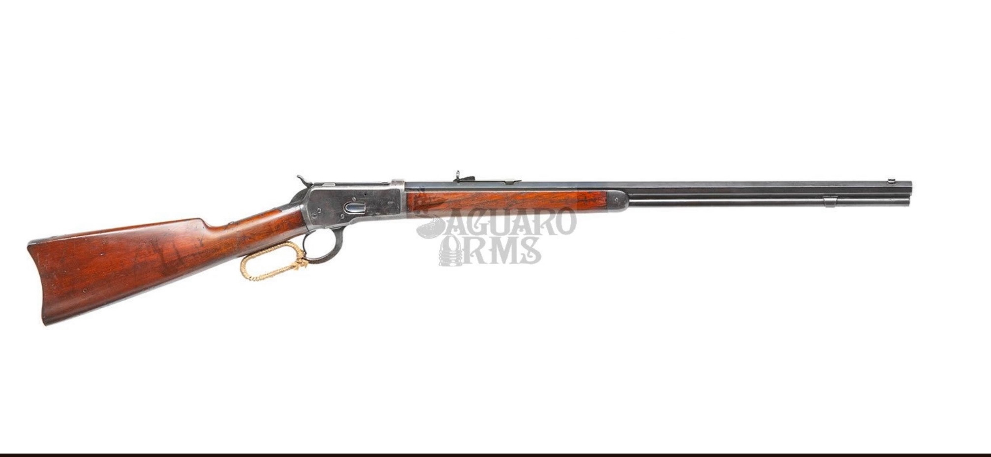

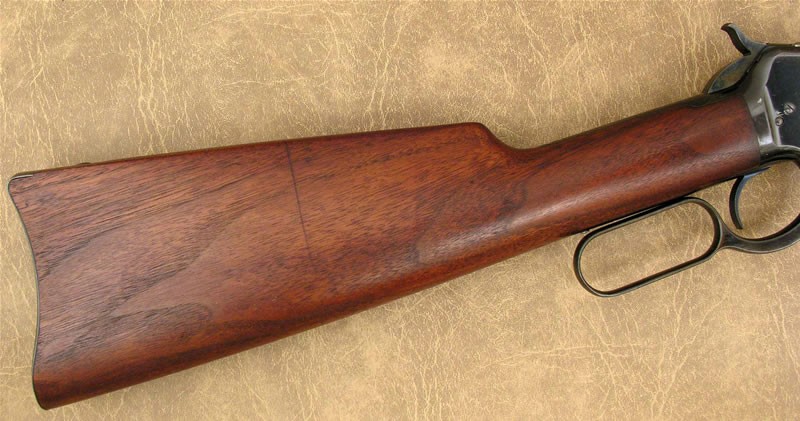

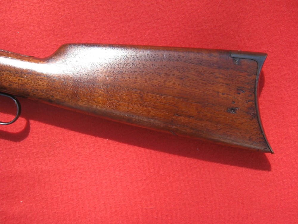

You guys are good, even looking at the two pictures, I don’t see a difference in the stock. Lol

Look at the difference in the shape of the metal butt plate.  Especially the upper corner.  Here are some better images to show the difference.

Ah now I see it. Much obliged.

Tex,   I thought this picture looked like it was lined. Looks like a definite edge just inside the bore

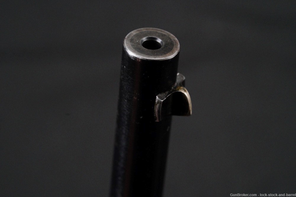

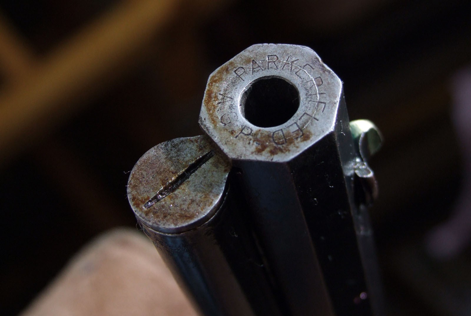

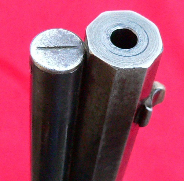

I would argue, very nicely of course, that the bore has not been relined.  Here are several examples of clearly relined Model  1892 barrels.  The insert is very clearly visible.

Could you please explain?If I understand you correctly,this barrel wasn’t relined,right?Is it good or not?Thank you.

Thanks Michael,  I obviously didn’t know what I was looking at.  What I was thinking the liner was is way too thin compared to your examples.
