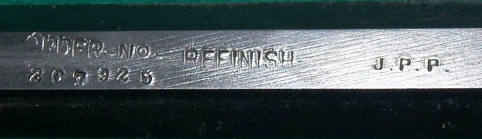

I haven’t ever seen a CFM factory letter, or even a single ledger record entry with “J.P.P.” mentioned either.  All that you will usually find is the “R&R” entry, with a date and a work order #.  On the guns I have found with the “J.P.P.” marking, there is also a work order number stamped near the initials, and frequently, a stamped “REBORE”, or “REFINISH” marking.  On the barrels that he shortened, it may only have his initials and the work order #.  Very very seldom does the ledger record entry ever mention what specific work was done to the rifle.  Below is a typical marking found with the “J.P.P.”

I just found this interesting post.  Here is a question.   Would a  ” j. p. p.  refinish” stamp on a factory shortened rifle add or detract from the value of the rifle?  Would the rifle be worth more in its original configuration even though it was shortened and marked in the factory?

The “J.P.P.” marking in my opinion is not ever going to increase the value of the gun.  However (and again in my opinion), it is not going to reduce the value either as long as the work order stamped on the barrel matches the work order number listed in the R&R entry in the factory ledger record.

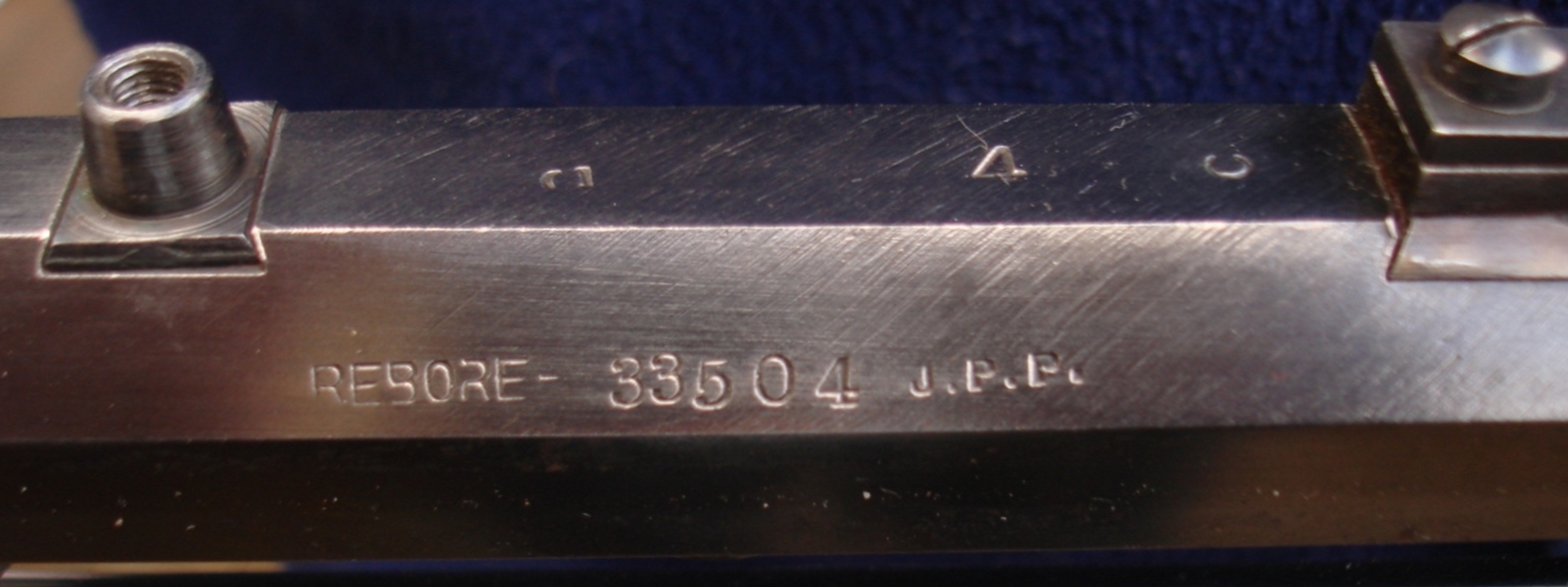

Just for fun, I dug through my photo files, and here is another “J.P.P.” marked Winchester (this time on a Model 1894).

Very interesting, thank you!  With all the various aspects that can affect the value of a winchester, I just wondered if this was one.
