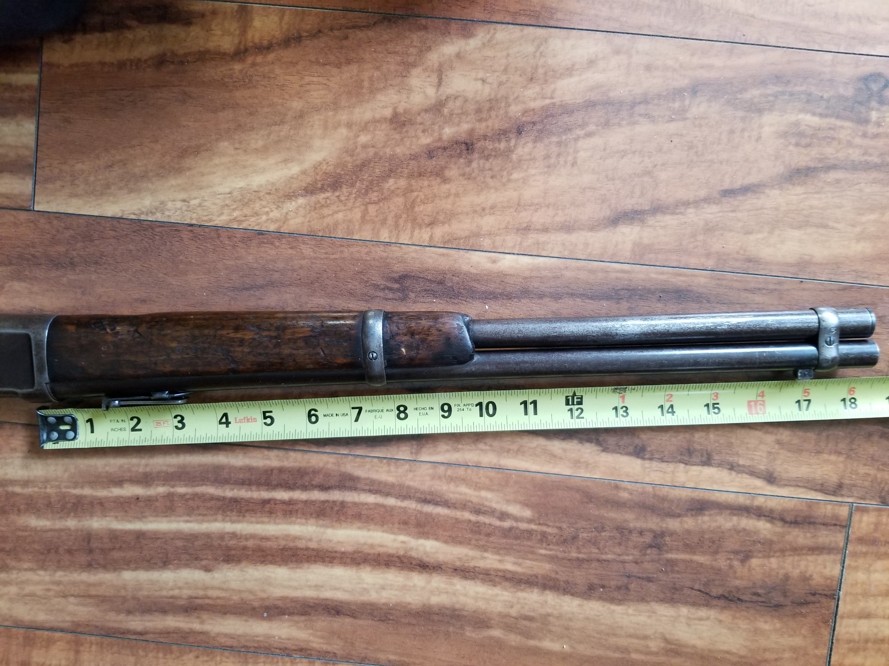

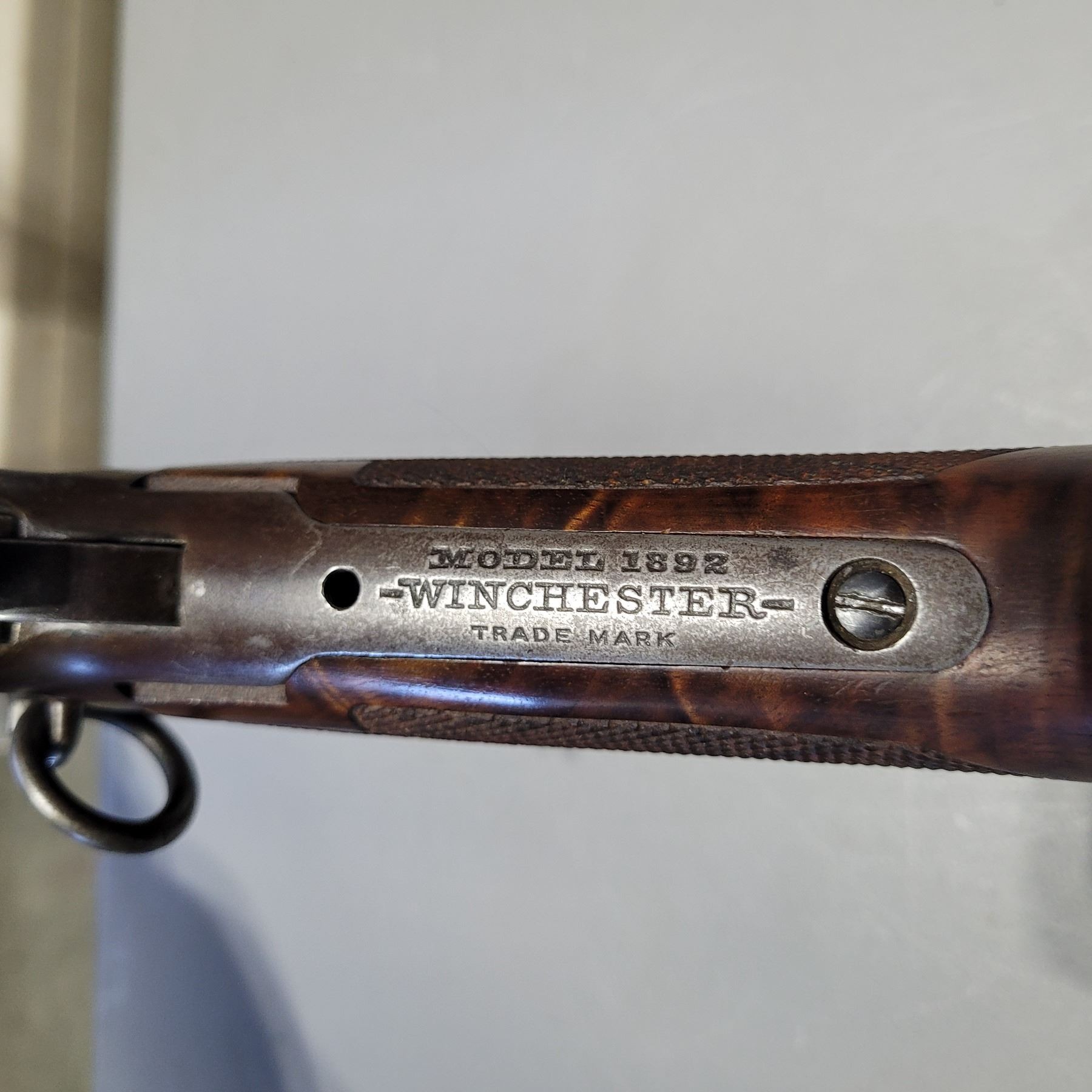

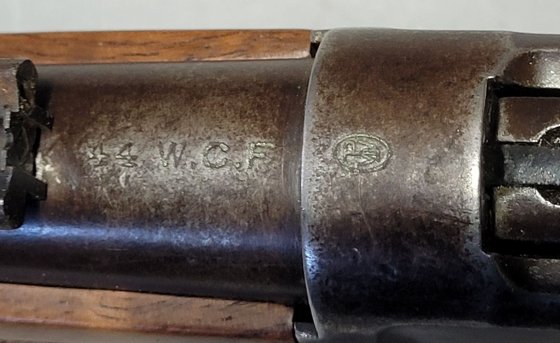

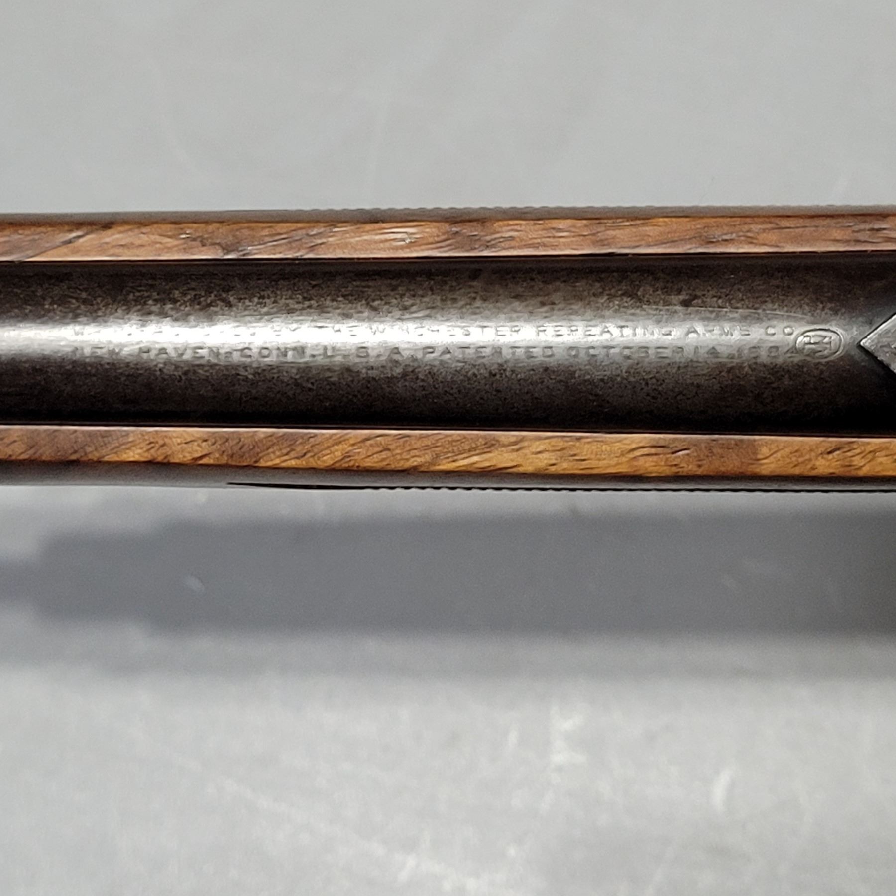

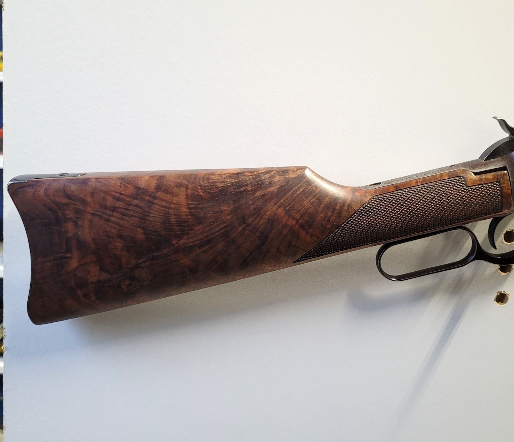

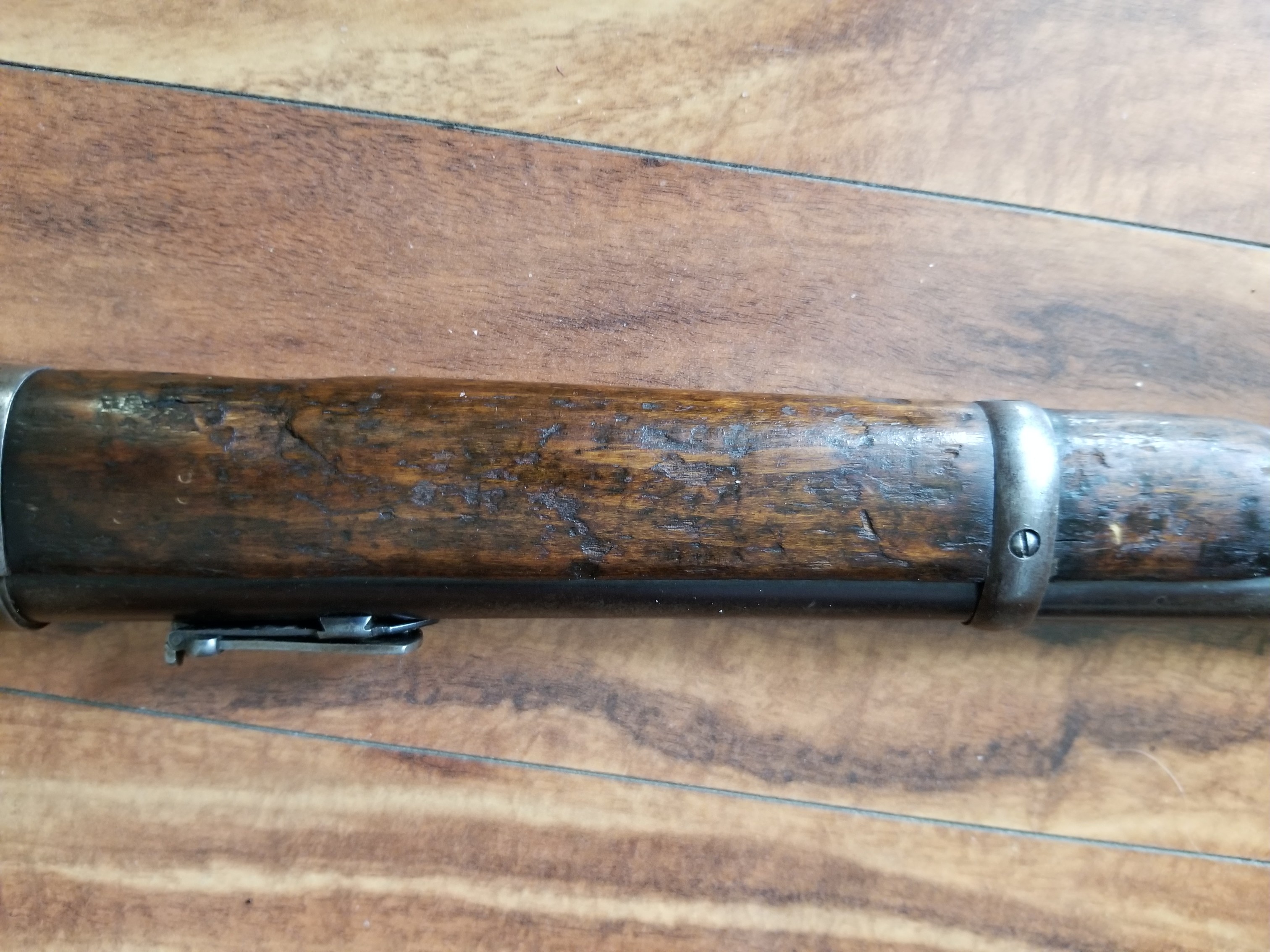

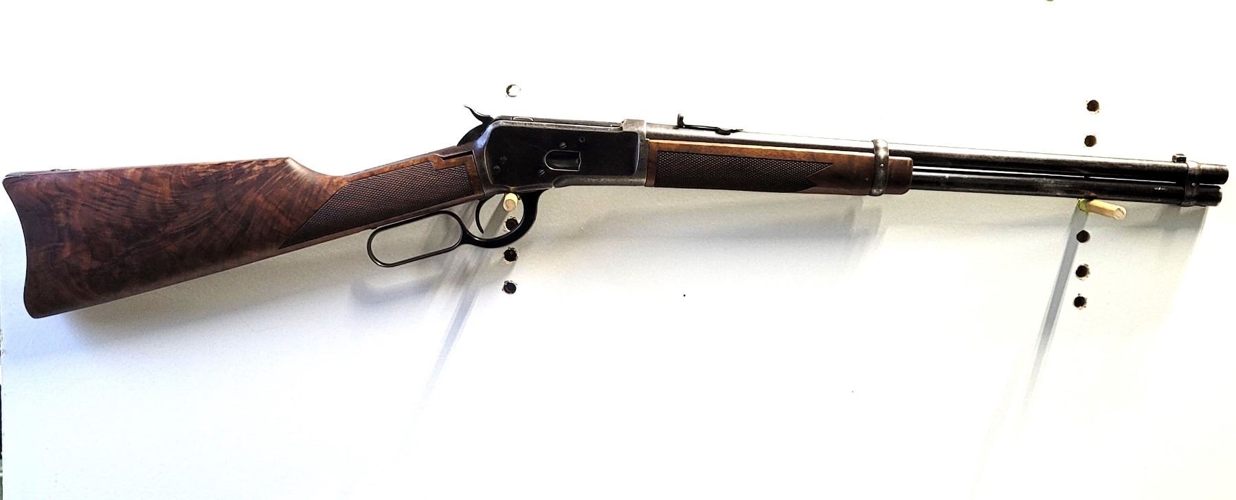

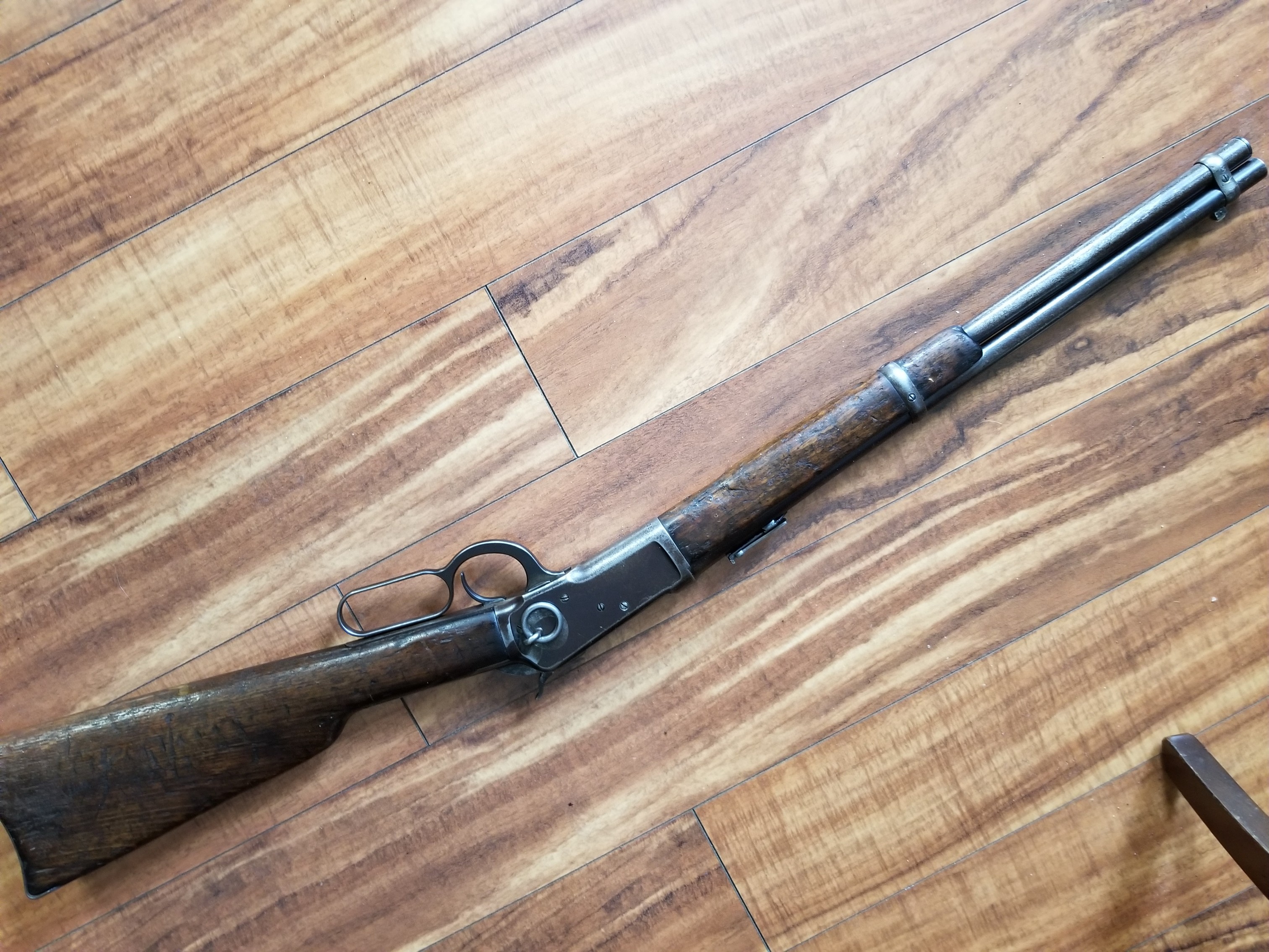

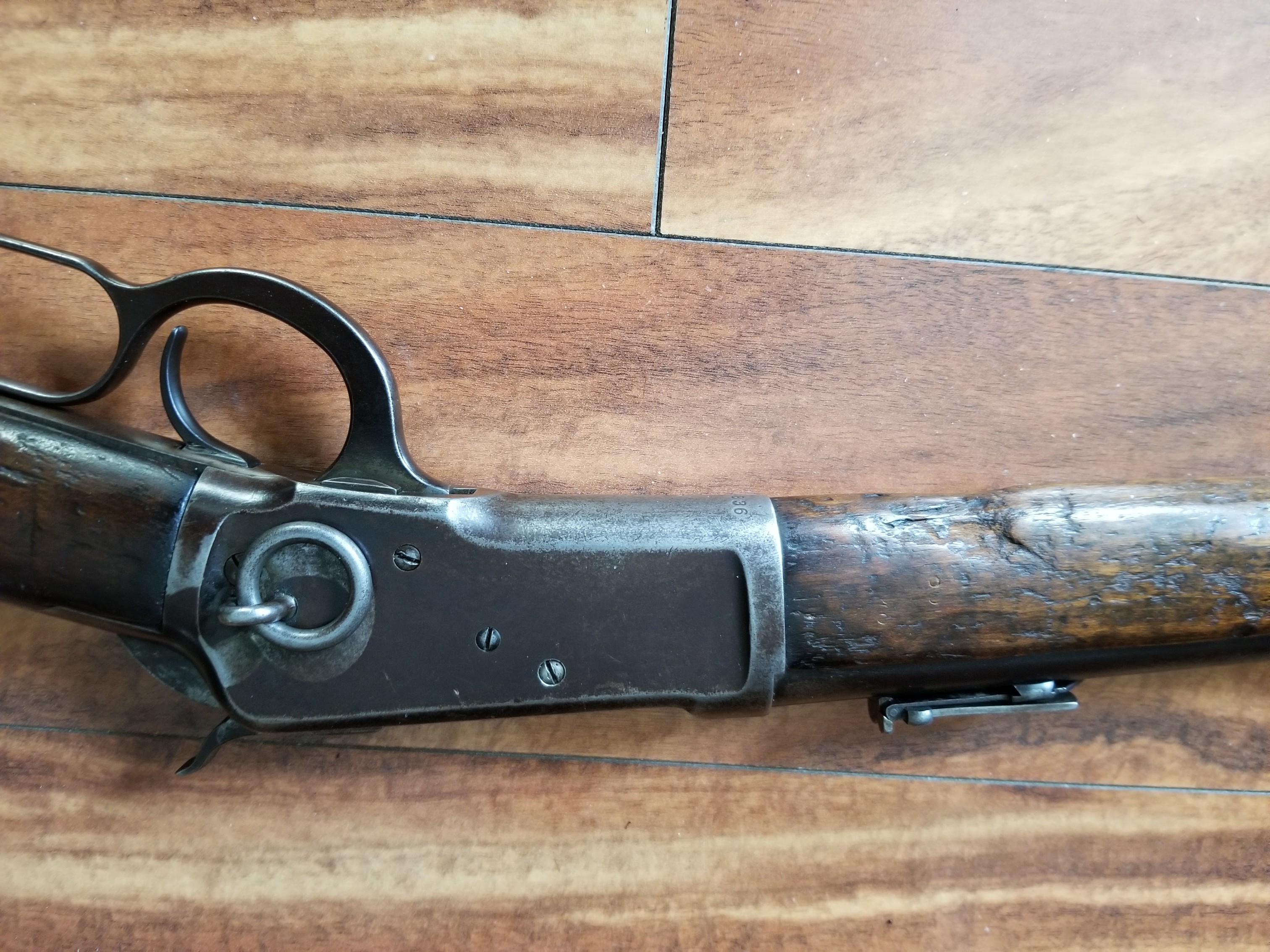

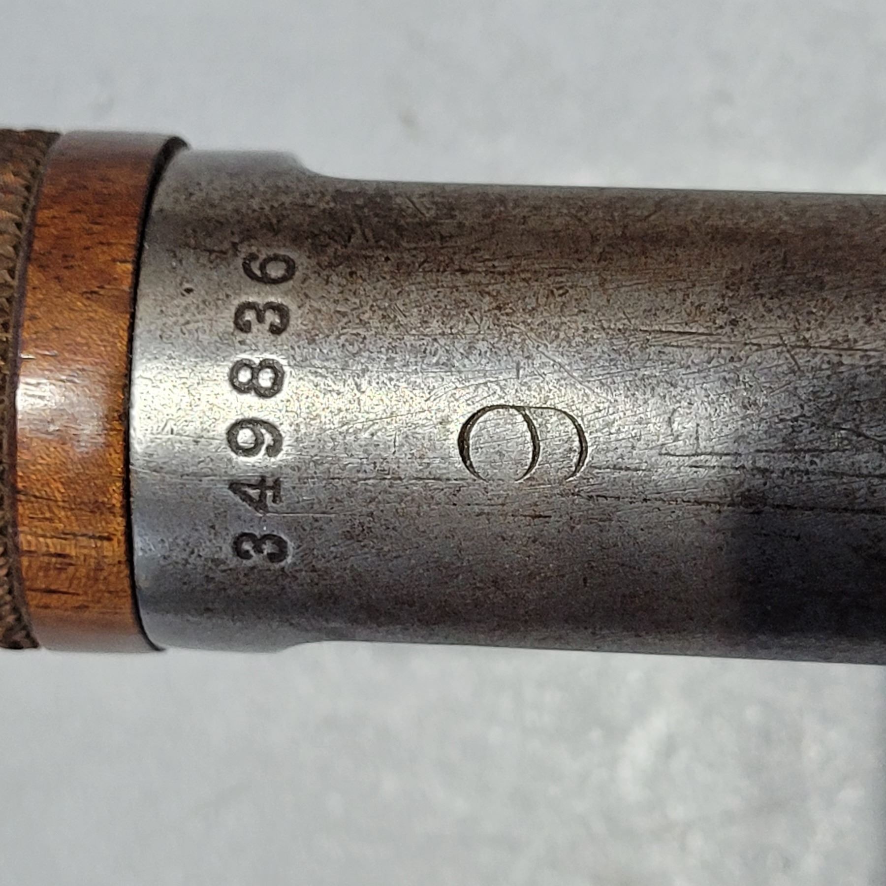

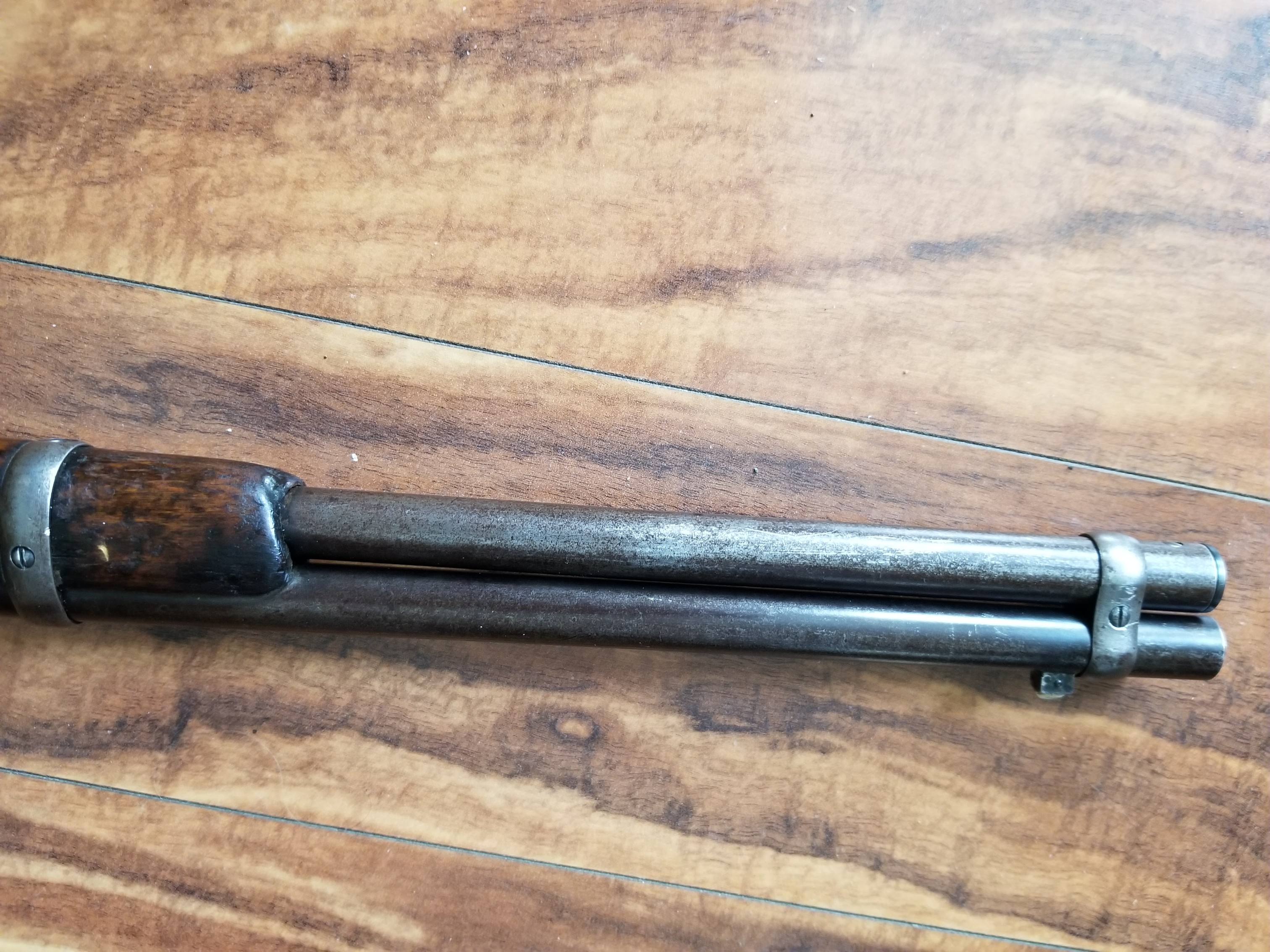

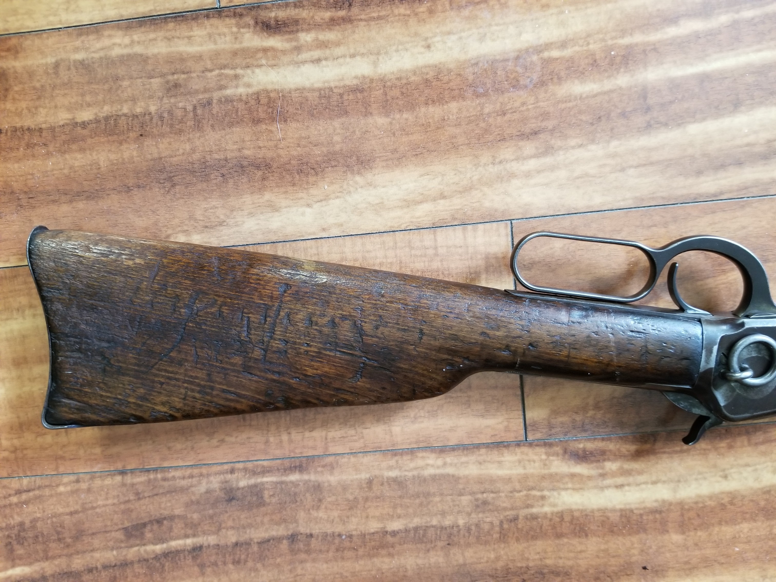

You do not want that rifle.  Here are the images that I have of it.  I first saw it in October of 2024 with checkered non original wood on it.  Here is the listing from Hunters Unite in BC.  https://www.icollector.com/Winchester-Custom-1892-Saddle-Ring-Carbine-44-40-Caliber_i54453101   It sold to “harkerlee” for $1100.
The second time it appeared was in January of 2025 with some really beat up “original wood”  on it.  In addition, the barrel does not measure as 18 inches based on the one tape measure image.  The rear sight has been changed between the two offerings.  Do you have current images of the gun?  I would be interested in seeing them.
