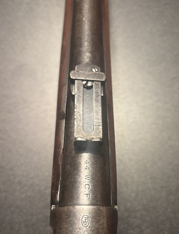

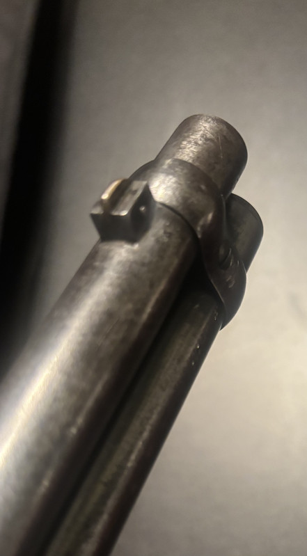

I shot my 1892 for the first time today. It was a great time. It grouped well but shot very high. At 50 yards with a 6 oclock hold it was 6 inches high on a 3 inch dot. At 100 yards it was 10 inches high. Are these the correct sights for a 1906 SRC in 44WCF?
I’d like to add a taller front sight blade.
Thanks, Tony

The rear sight and forward proof mark is correct. The front sight blade has been shortened. You can drift the pin out and put a taller blade in.
Chris

is ebay my best bet for a replacement front blade?
7th & 10th SF retired
Forum Posts: 2765
June 7, 2026 - 12:35 pm
You might try here:  https://homesteadparts.com/shop/sight-front-winchester-blade-steel-blued-for-winchester-1873-1892-1894-p-1457.html?cPath=1_9
