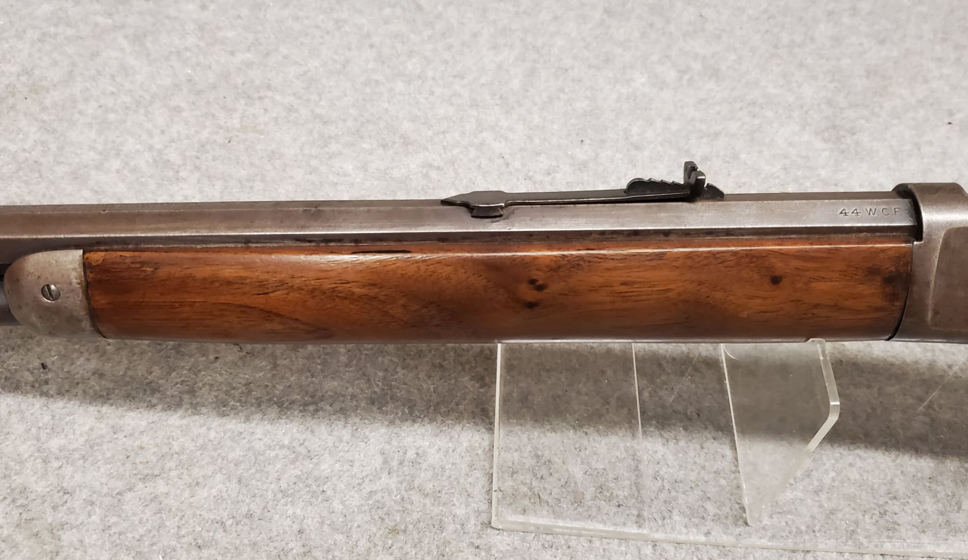

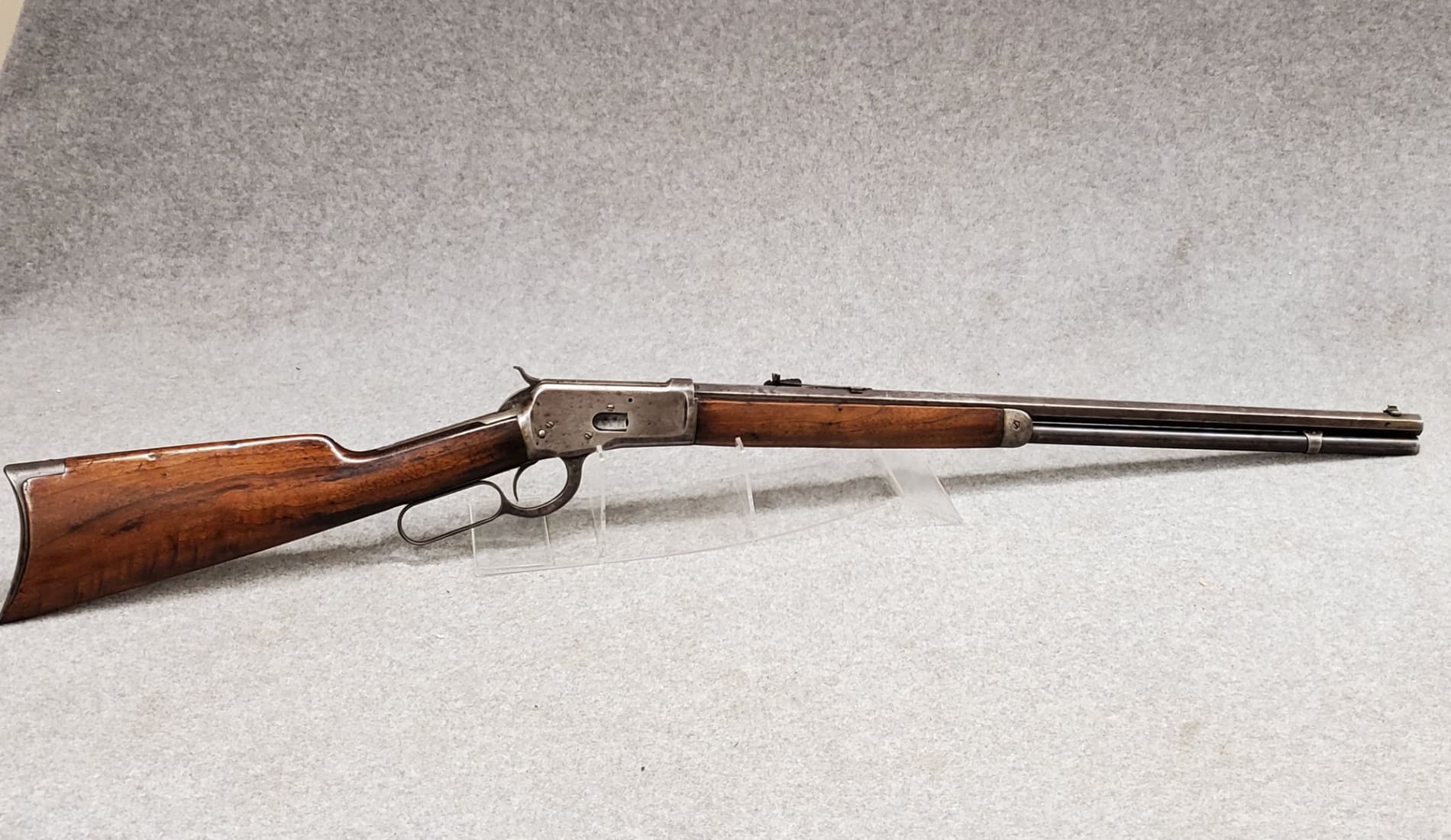

Hello,
I have a number of Winchester reproductions, but I’ve never bought a C&R type rifle before, so I am more weary.
I want an 1892 in 44-40 with an octagon barrel to shoot (not to look at).
I was thinking of buying this one, manufactured in 1910, but there is no marking anywhere that the barrel is nickel steel. I’ve read that I should look for this to make sure I get an appropriate hardness for modern loads. Even though I will still be loading down most of the time, I’d like to ensure it’s safe.
Any thoughts or input?

Ok thank you. I would also be curious of what the experts around here might think this gun would be worth, or if it looks like a nice piece. Its certainly not a $5000 collectible, but I also want to make sure I wouldn’t be getting ripped off.

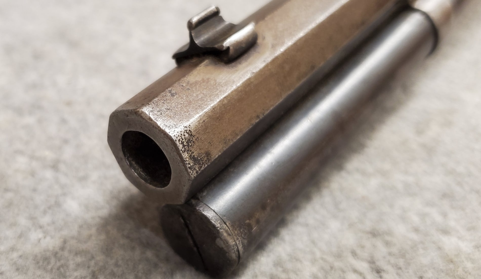

If your main interest is shooting it, you need to consider the condition of the bore.  They don’t necessarily need to be pristine, but the better the bore, the stronger the rifling, the more likely it will shoot well enough to make you happy.  Looking at the provided pictures, I would suspect the bore to be only average at best, but strange things do happen, and it might be a strong bore.  My thoughts only.  Tim

Some rifles with poorer bores will shoot much better with jacketed bullets.

Some guns have condition, this one has character. I wouldn’t be a bit surprised to hear it has a decent bore and I’ve found sometimes that’s all it takes to shoot a respectable group, break up some dirt clods or maybe chase a can around. Guns with condition are better investments, guns with character are more fun.
