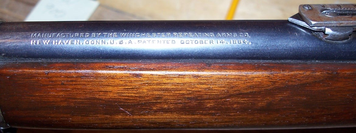

can someone post a pic of the correct barrel stamp on an 1892 carbine 439xxx range? Thanks Matt

Hello,
It should be a Type 3 style stamp.  2 lines of print of equal length and located on the top of the barrel between the rear sight and the rear barrel band.  Exactly as in the attached photo but on top of the barrel vs. left side as shown.  The caliber stamp will be on the left side just behind the rear sight.  Rarely on top of the barrel in this range.
