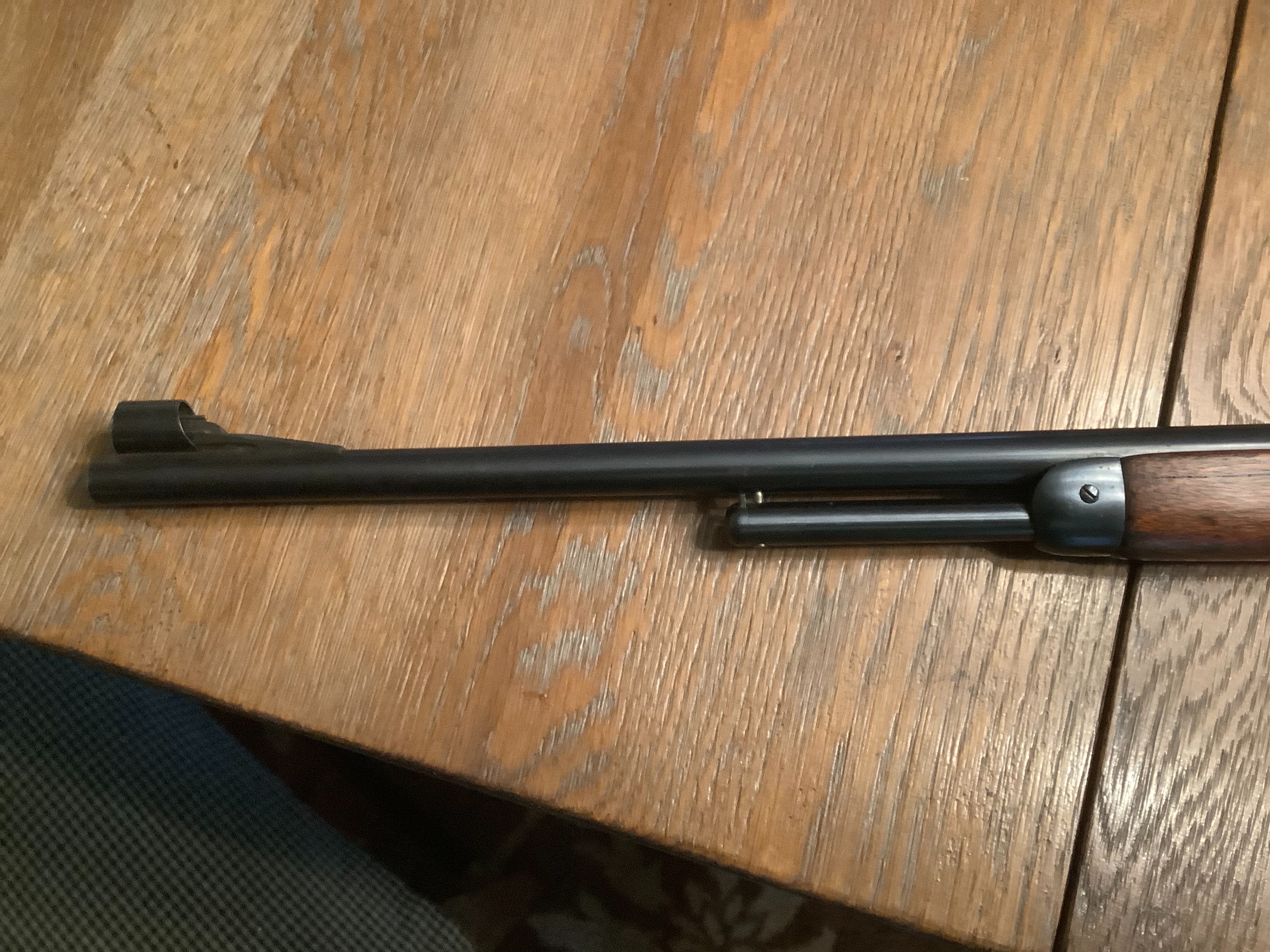

Off on another wild goose chase. Any input will be welcome.
Have accumulated several 1892 variation survivors out of an estate  Am still sorting out a way to describe what I actually have.
NUMBER ONE:  I think serial #1006031 is a legitimate model 65 in 32 WCF with the properly marked 22 inch barrel , 2/3 length mag.
Looks like the correct PG stock and forearm. Metal model 70 type buttplate
the reciever upper tang has NO rollmarks — it is smooth except for what appears to be “normal” factory accommodation for the tang mounted peep sight.
AND the bolt is machined properly for the bolt peep
This one appears to be very near the end of the 65 production and probably a parts cleanup candidate. Chime in with any comments I appreciate the experience you all have.  PH

Paul,
The rifle you describe is a Frankenchester.  It was a standard production rifle manufactured in the year 1941 (not a parts clean-up).  The upper tang should have a Type-6 marking on it, and the bolt should not be milled & tapped for a No. 98C peep sight.  In your shoes, I would remove the forend stock and magazine tube to verify the barrel date.  That will give us an idea if the barrel is original to the receiver and it has a replacement bolt, or if the barrel is a replacement and the rifle was originally a 218 Bee.

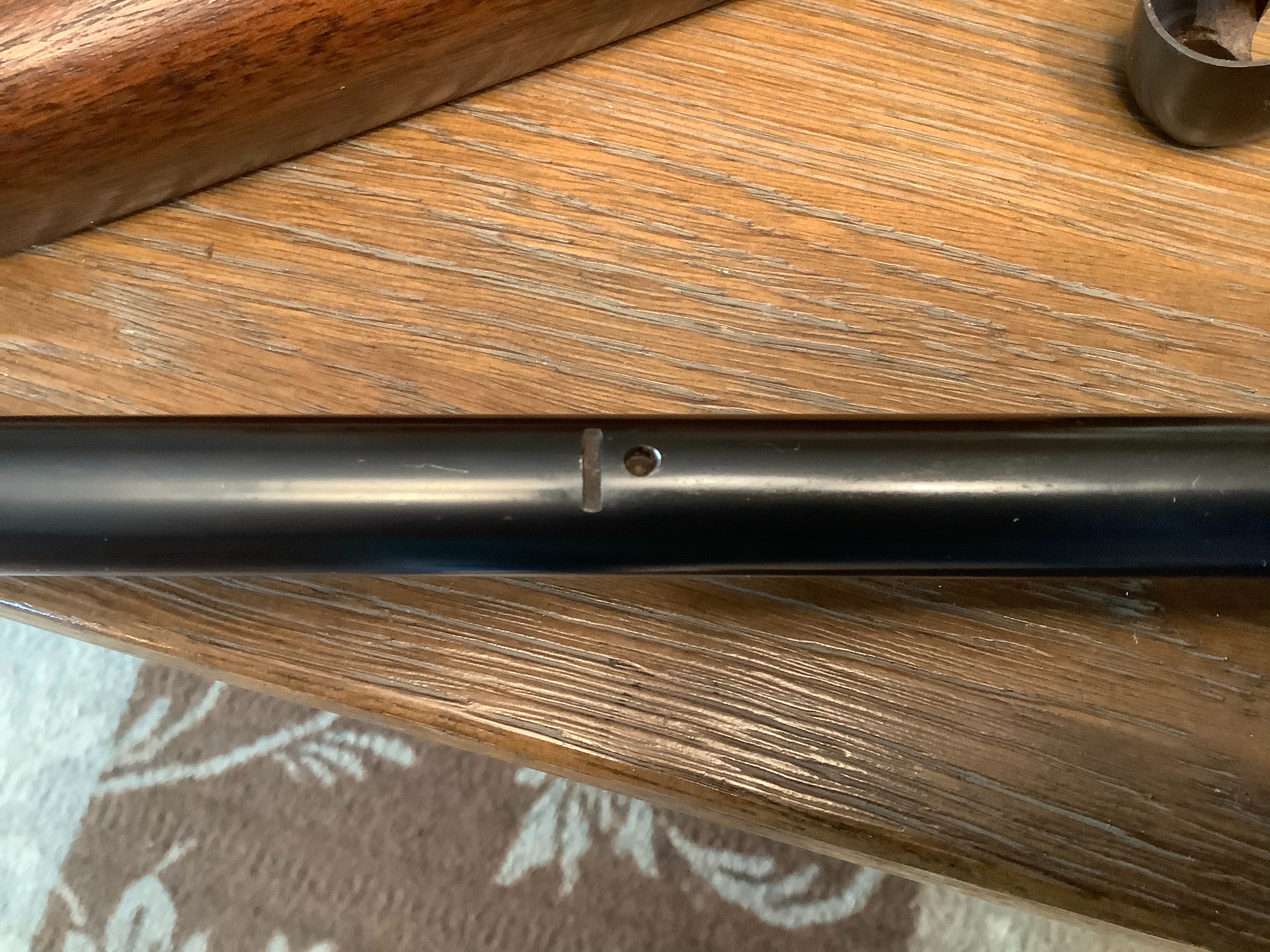

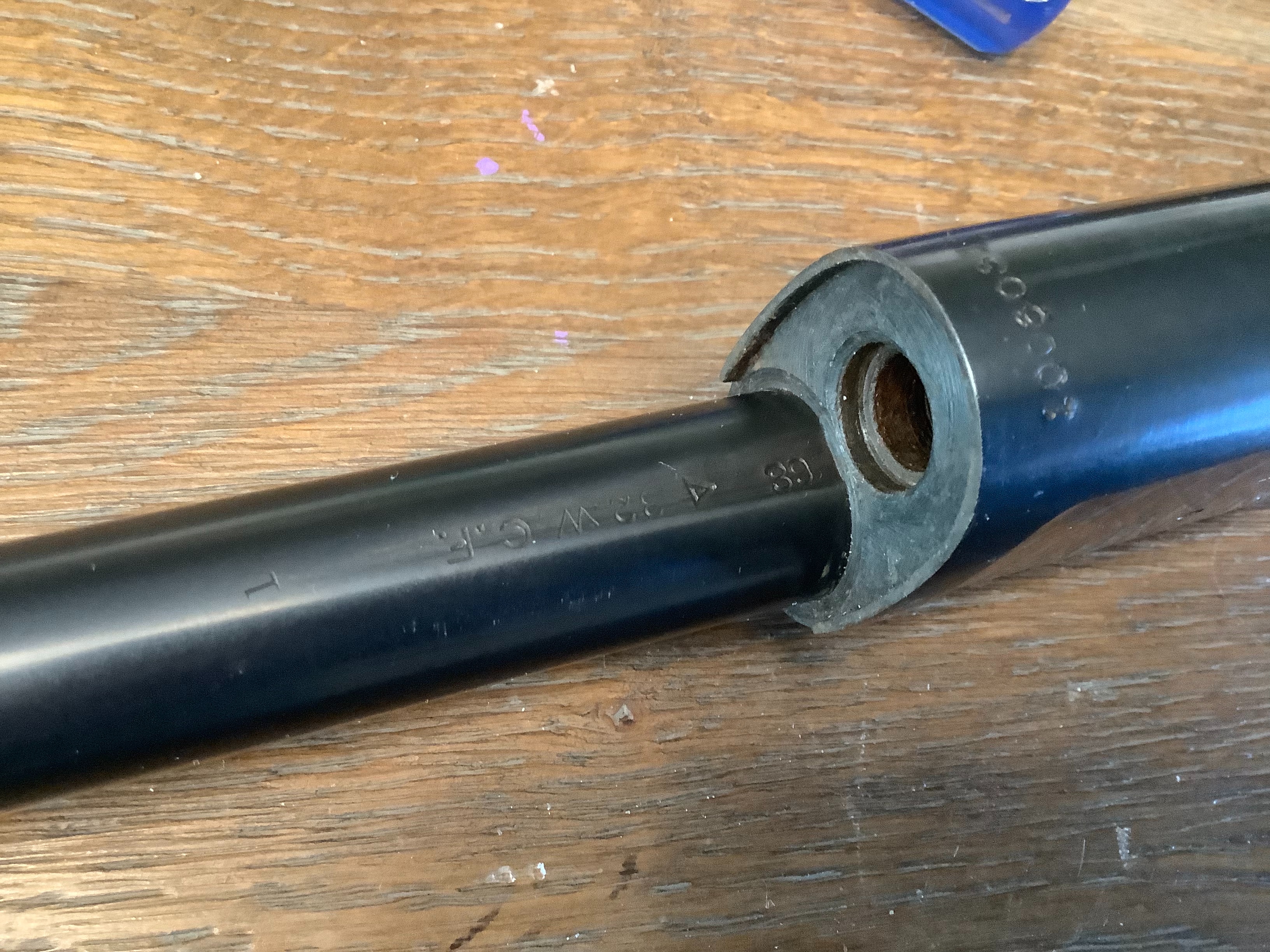

The barrel has a 39 closest to the reciever —-A triangle then the 32 WCF
2/3 mag with the slot and thru bolt on the magazine cap
PH
Forum Posts: 14957
May 16, 2025 - 5:50 pm
PH
Based on other 32 WCF Model 65 rifles in my survey, the “39” barrel date is consistent with the serial number.  Therefore, I suspect that the rifle was refinished and the bolt swapped.

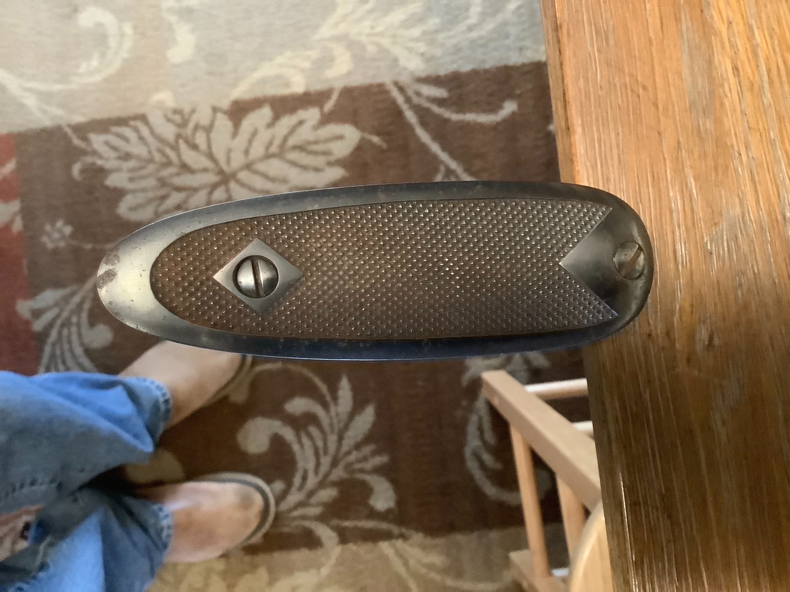

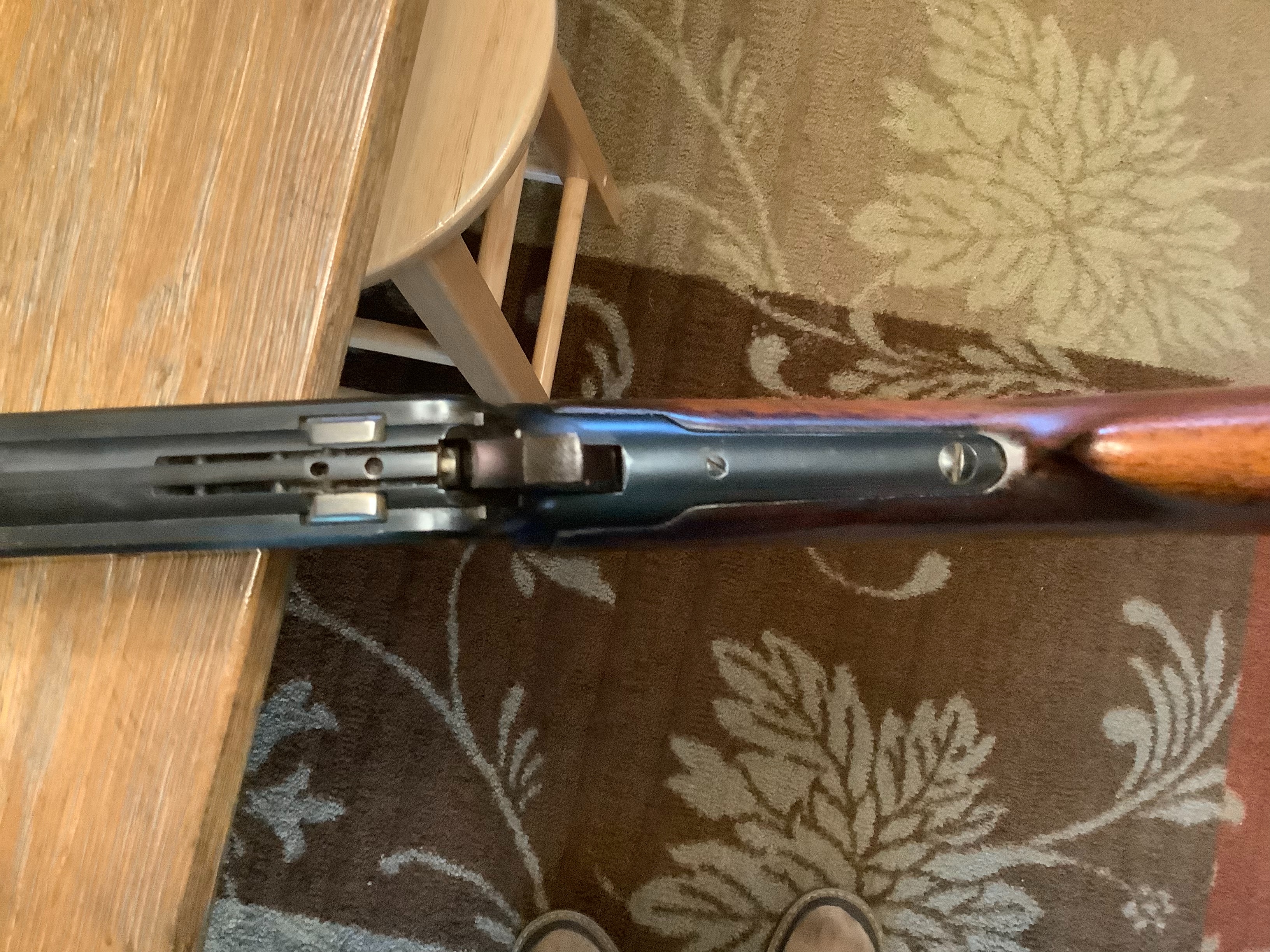

Paul H said
PicsB5CC9460-31D0-4B17-BD58-6CC0BFD76F79.jpeg2C3C1158-F03E-4C56-8BB0-587D78EBC774.jpeg
Can you post a clear picture of the upper tang area?

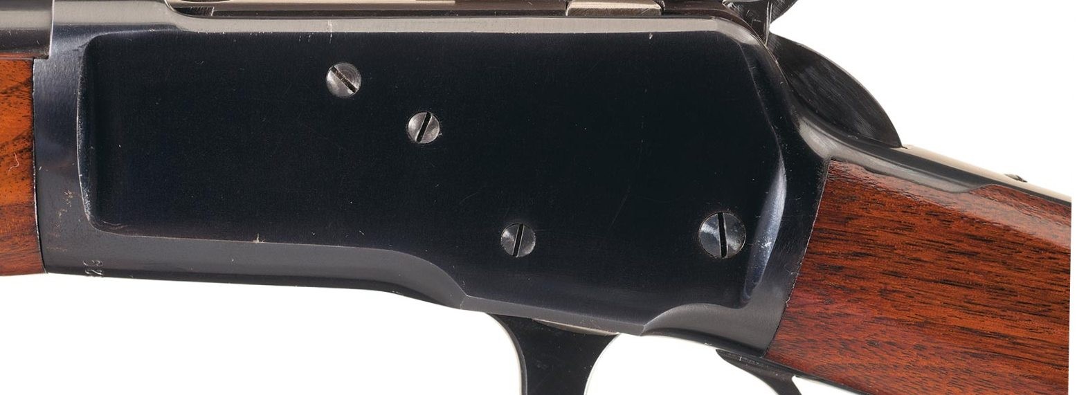

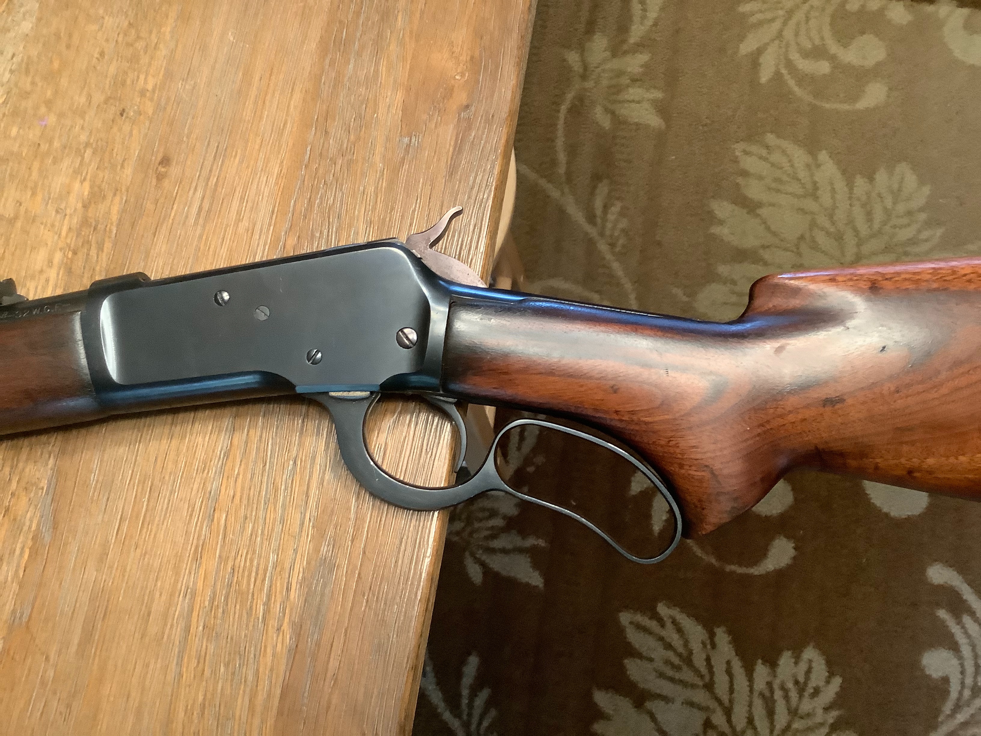

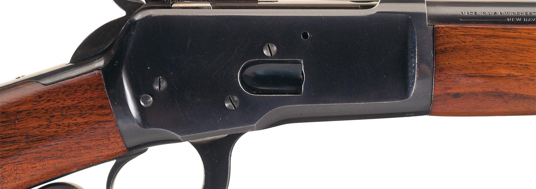

A6C81B5D-E742-4229-A301-7147AD972804.jpegE0272956-A301-49C5-8ADD-9B775864441C.jpeg654D836E-9BCE-4DB6-A2D6-B0898E1DBCB5.jpegF0453272-424A-4CFB-8B14-E4A700B19886.jpeg0AF3149E-5F4B-4628-884D-636757AFB123.jpeg Bert—-Fairly “light” refinish—little sign of sanding or polishing.  PH
 I see very noticeable sights of the polishing & rebluing of the receiver frame, and sanding & refinishing on the butt stock.
The attached pictures show the left and right sides of the receiver frame, and the fit of the butt stock.  Take note that the screw heads are not flattened (by a buffer) and how tightly the butt stock adjoins the receiver frame and upper tang.
Model 65 s/n 1005329

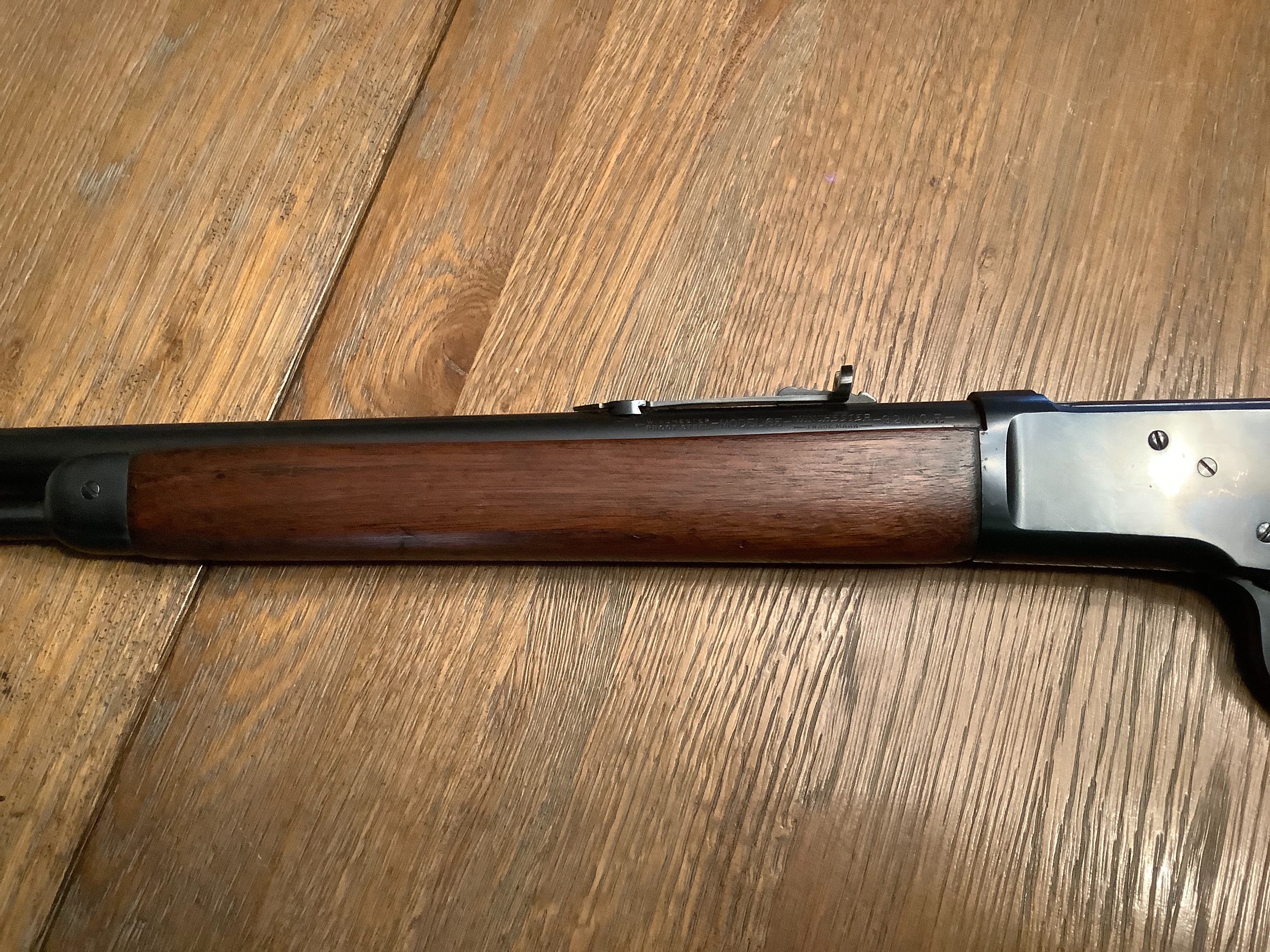

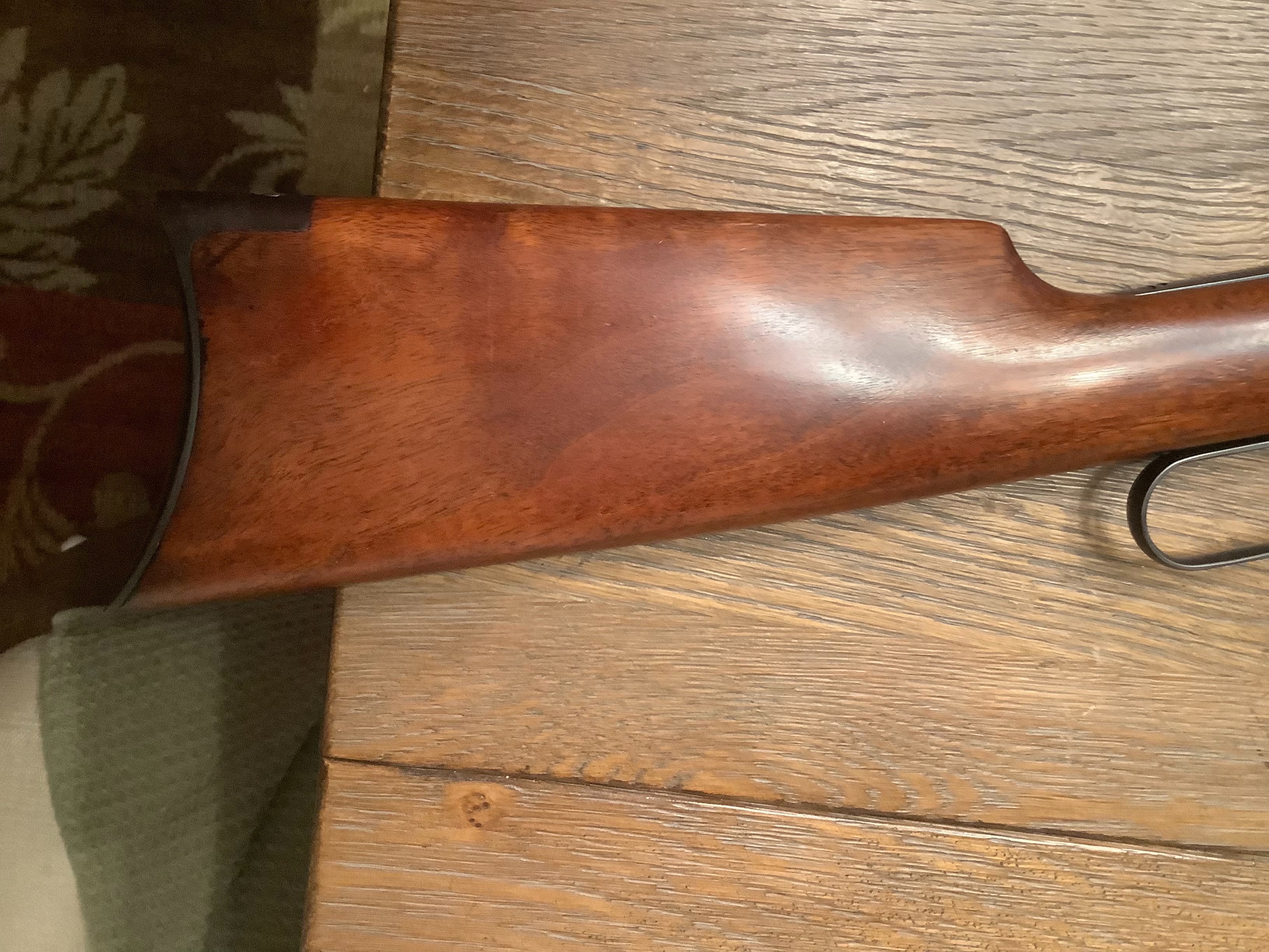

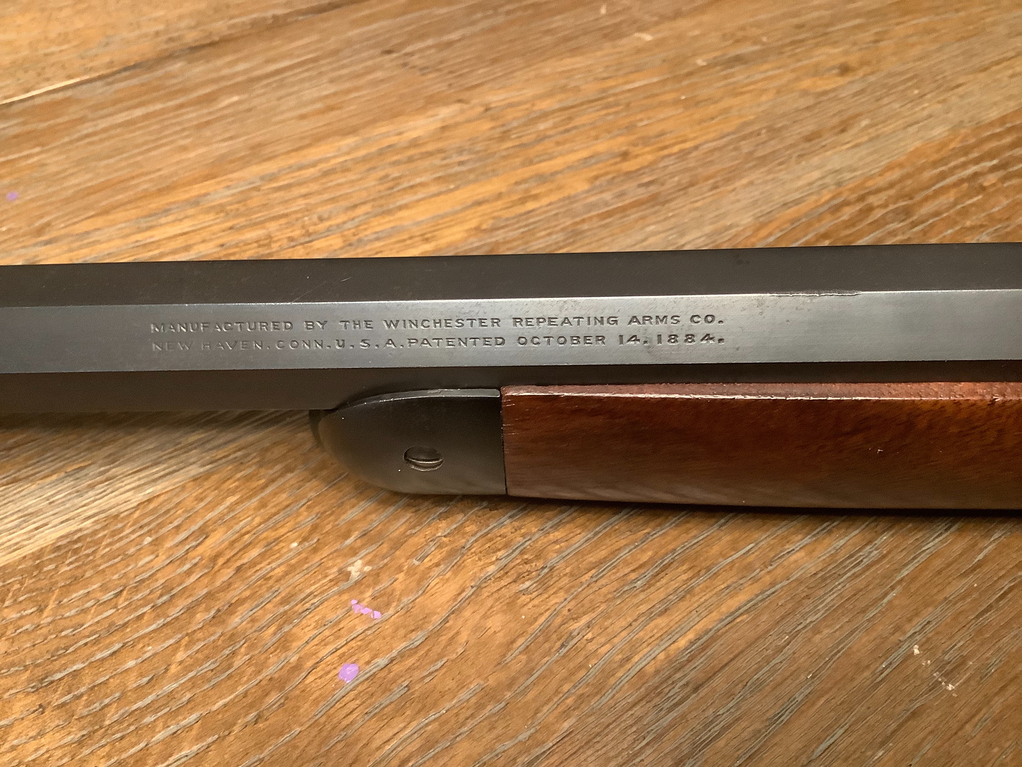

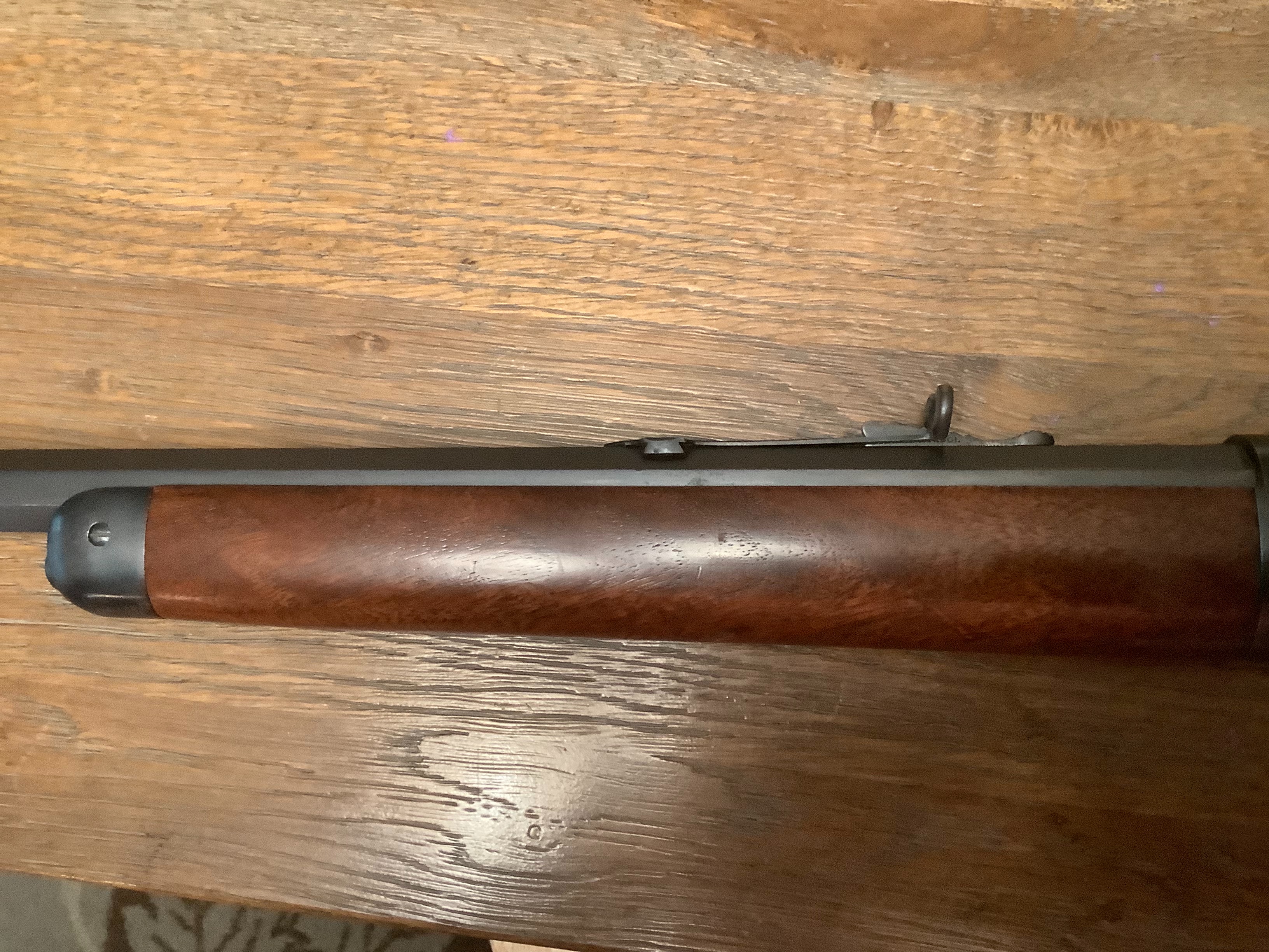

Good morning,
Can you please post several photos of the #2 rifle so that I can add it into my survey?
Paul H
Forum Posts: 91
July 22, 2018
Forum Posts: 2762

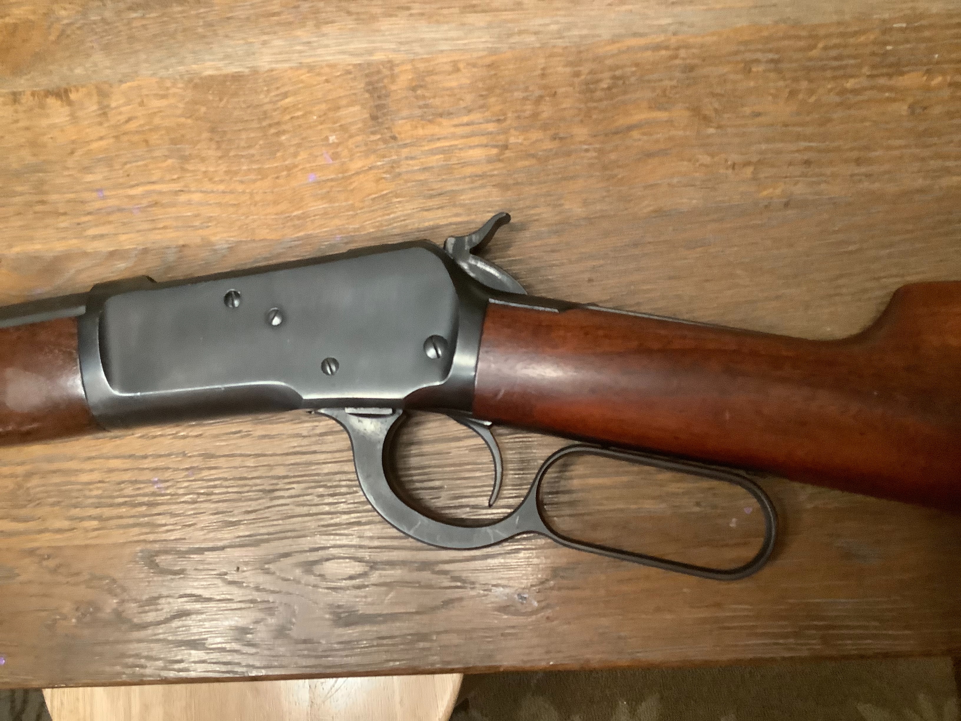

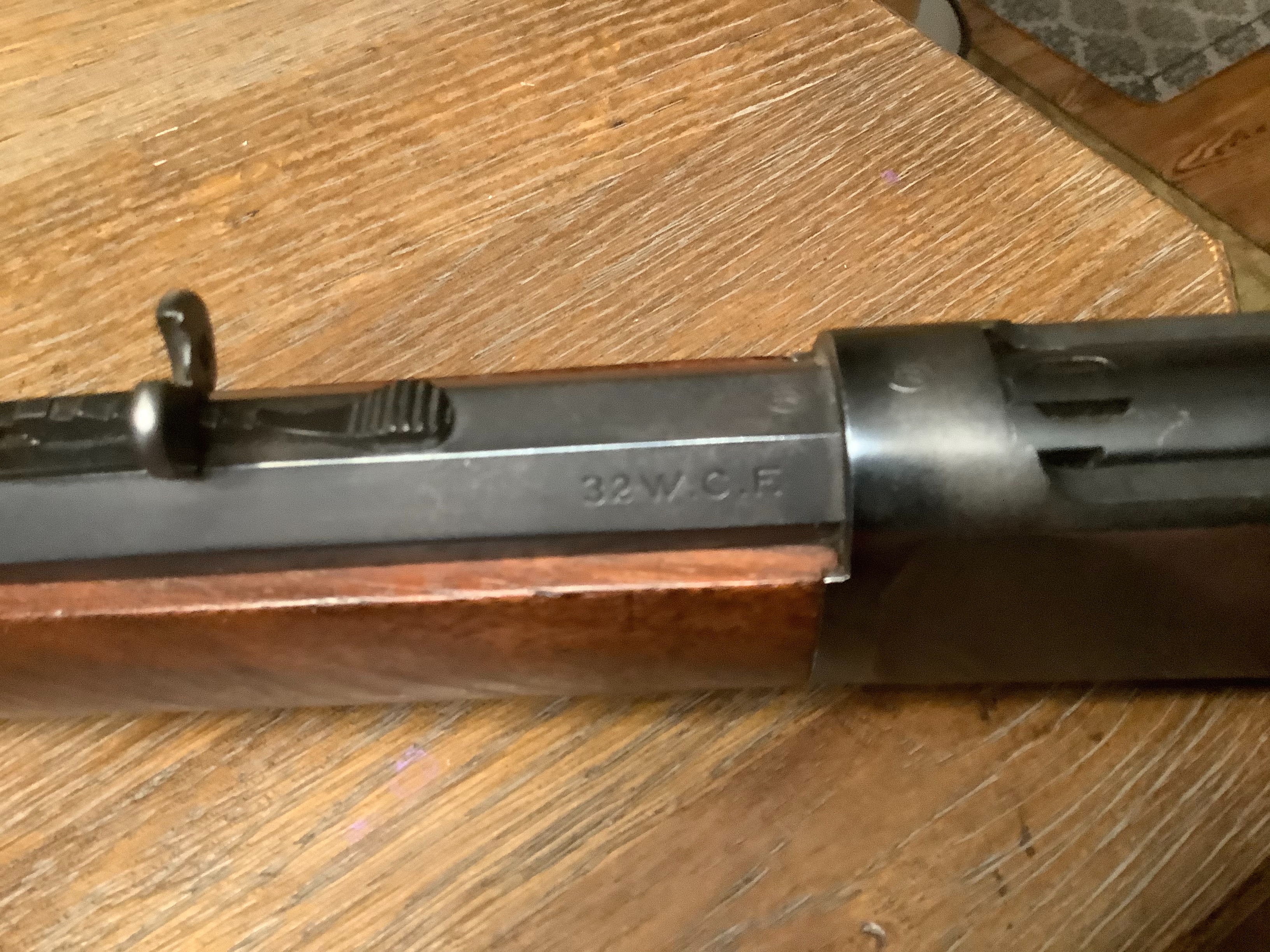

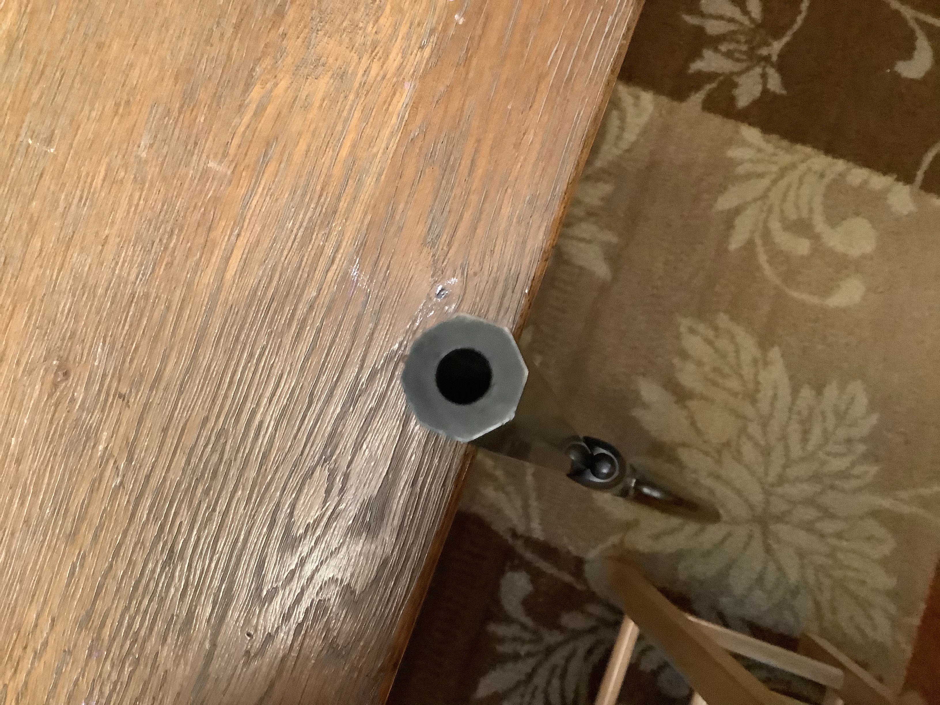

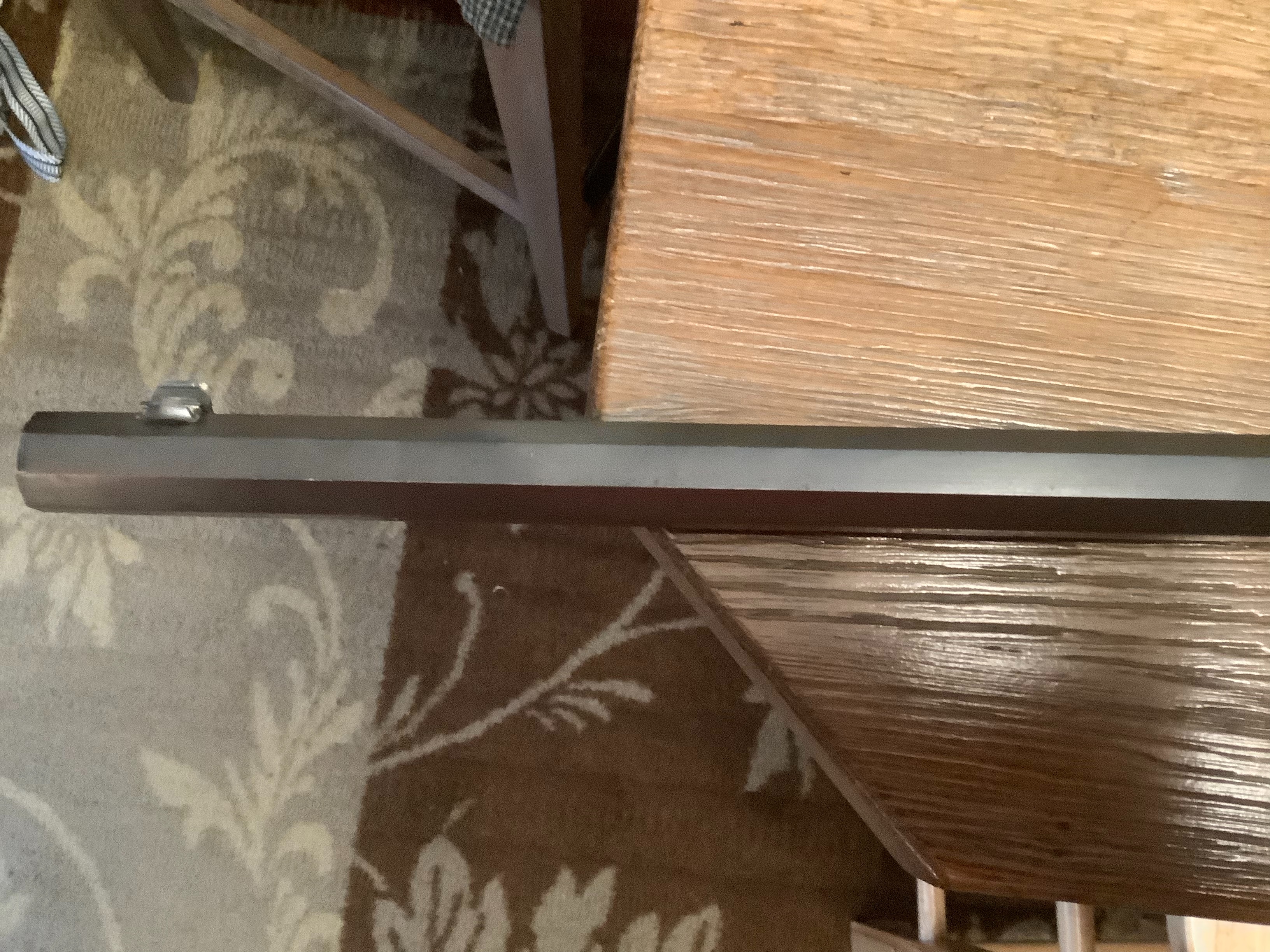

May 20, 2025 - 11:37 am
Paul H said
Hey Michael here are some pics of #648428—32WCF 92CDA507-D0D7-4884-ABD7-094B8E6D61EB.jpegCE0A51E1-FD5B-401C-A363-92EF7C36C206.jpegF1F2037D-87E0-42AC-9596-4AAB8952D9ED.jpeg2BE2749B-D402-42C2-92AE-35F624427B81.jpeg37F04B62-64E5-40F4-9EAB-4AF8CADE728E.jpegB7DE93D1-1663-4A76-A1E5-5A1EF4648531.jpegA10DE335-585F-4416-9D63-A5083B9791D2.jpeg1CA1AC89-6937-4855-8ACE-94C614E05872.jpeg2E4BA67A-7A32-459D-B65F-A2974146CAE3.jpeg4C787497-0436-4B94-8635-CD81998056C4.jpegF2C53501-1BAA-4F74-8A8E-8CC3EADFFB54.jpeg4A4A1440-4BE0-4D2B-9D6F-E4E7FE73CB14.jpegA dozen marginal pictures.   Rescued this one and several others out of a local estate.  Thanks PH
Thanks so much Paul.  I have seen many a worse refinish job!  I appreciate the help.
