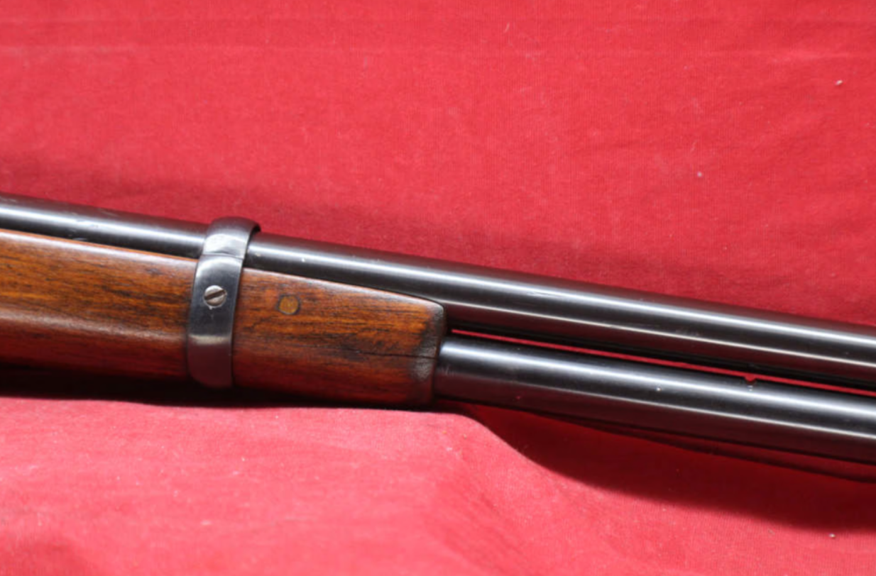

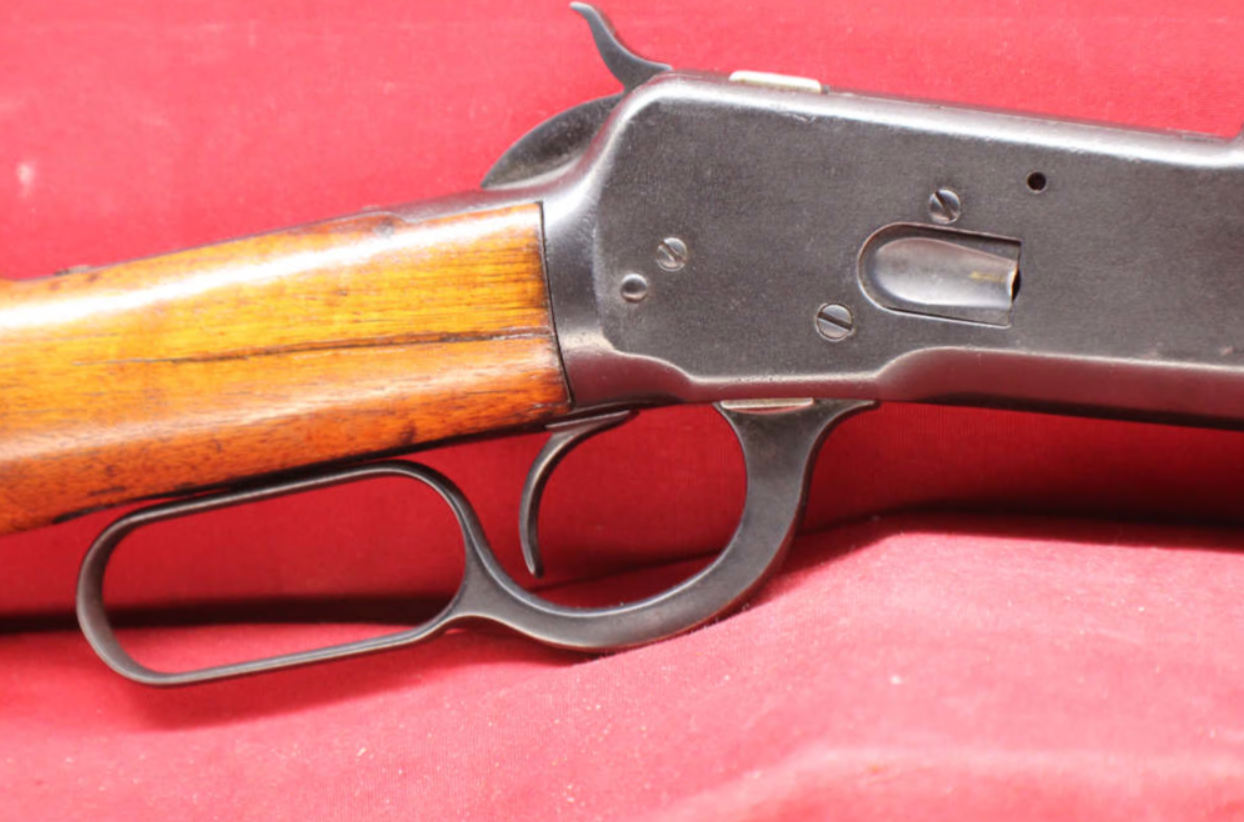

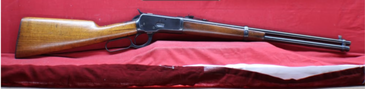

I will try to upload some pictures of it. and I am not sure but it is supposed to have a 20 inch barrel so I’m guessing it is a carbine? and it was made around 1903Screenshot-2025-10-12-130526.pngScreenshot-2025-10-12-115243.pngScreenshot-2025-10-12-115258.png
October 12, 2025 - 6:14 pm
It is a Carbine (and it should have a saddle ring on the left side of the receiver frame).  Based on what I can, it has been reblued and most likely a replaced forend stock.  The rear barrel band is installed backwards indicating the front end of the gun has been worked on.
If you are looking for a “collector” grade gun, that is not the Model 1892 you want to buy.  If you are looking for a “shooter” grade gun, the $1,100 price tag is reasonable enough if it has a nice clean bore.

I agree with Bert. The magazine clearance cut for the fore end screw should not be in that position either. You can clearly see it in your third picture. The magazine could be for another model such as the 94.

You are asking the ight question at the right time.  BEFORE you buy the gun!!  Too many folks buy one and then ask what it is worth.  That is a mistake.  What is the serial number of the rifle?  Also please get clear photos of the stamped writing on the barrel.  A replaced barrel is another value deduction.  Not only is the barrel band screw inserted from the wrong side but it appears that there is a filled hole in the wood forward of the band.  I would be skeptical of the shotgun butt stock being original also.  $1100 might sound cheap until you find out it is a collection of parts and worth 2/3rds of that.
