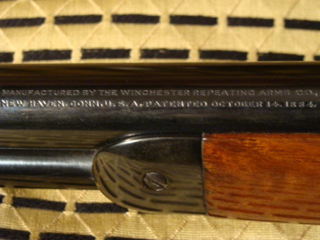

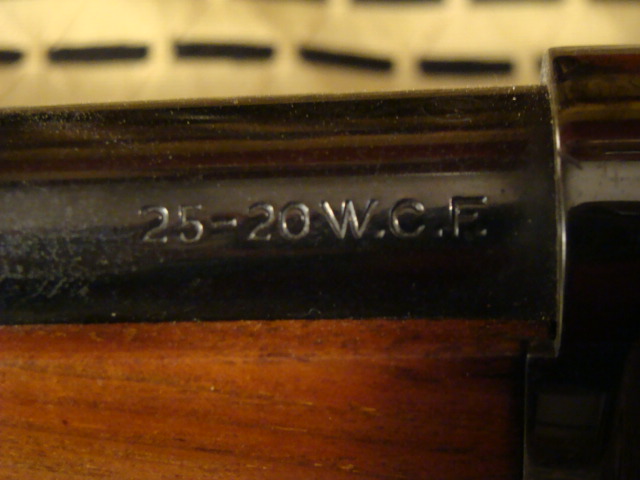

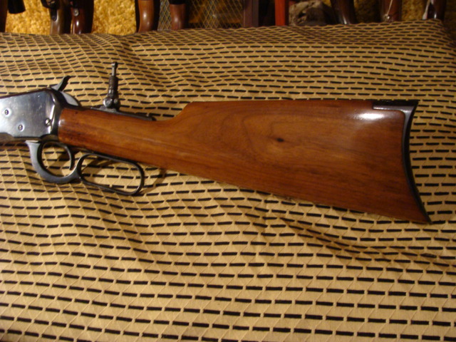

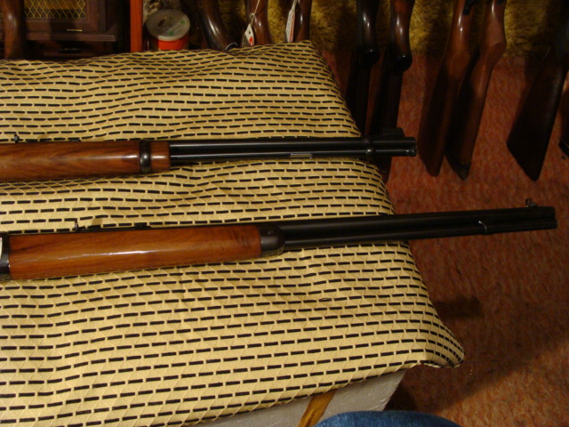

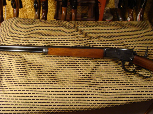

pics of the 25-20, 24″ barrel, sn 787680

$3000 is too much for that one! That not blue on the gun, its Black.
Forum Posts: 1173
March 6, 2015 - 12:13 am

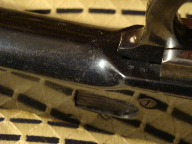

Definitely not the right shade of blue, screw holes on the receiver also look dished out.
A $3000 small caliber standard 1892 rifle would have to be nearly pristine to command that kind of money in my book.
Forum Posts: 4995
March 6, 2015 - 12:30 am
It was probable reblued by someone that does modern shotguns not old Winchesters.

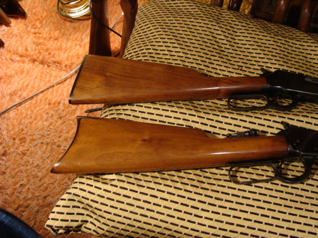

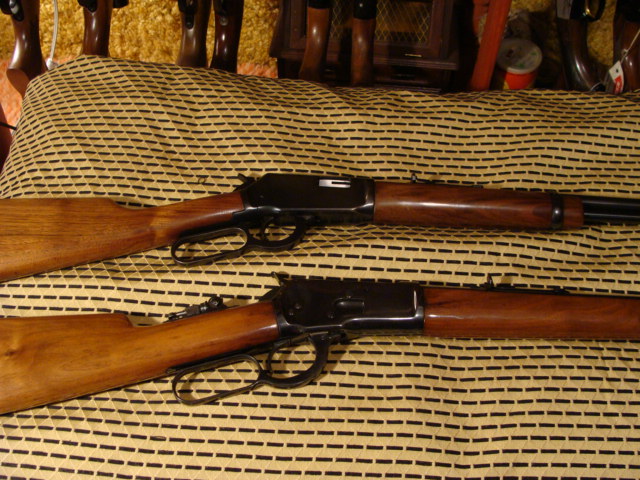

I don’t know if the location where pics were taken has anything to do with ‘color’ of blue or not; but here is a pic with that 25-20 beside a much newer 1975

You need to take some better pictures with a higher resolution so we can see some detail. If both guns are the same color then there is something amiss, A 1917 Winchester will have a different color blue than a 1975 gun. The signs of reblue I see is the metal it polished to a mirror finish, Winchester did not polish the metal that much. Its the wrong color, yes light can play a roll in what the camera shows but I also see the rounding of the corners which should be sharp. When Winchester finished the metal before bluing they had special screws in all the holes so a buffing wheel can’t grab the corner and round it. Thats what we call dishing around the screws. When you look at the gun with your eye, what color is it?
Forum Posts: 975
March 6, 2015 - 1:46 am
The color and finish on both stocks also looks very similar….
