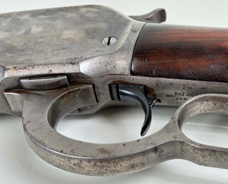

This is from a local auction site. It’s an 1886, made in 1887. Obviously the trigger has been replaced.
But does anyone know what the pin is hanging down by the trigger?

Its a set trigger. What caliber?  OB CB? tell us more–with pictures. If you do a SN check you will know if it was made with a set trigger..Bill
October 3, 2026 - 6:41 pm
Dave,
The very early production Model 1886s were equipped with a “single-set” trigger (similar to the Model 1876) when special ordered.  Most of the Model 1886s were made with the much more common “close-coupled” set trigger, often referred to (incorrectly) as a “double-set”.  That “pin” is actually a slotted screw, and turning it adjusts the amount of pull weight needed to release the trigger.

The rifle in question is a 38-56.. S/N 19490.
Here’s a link to the auction. It’s in Northern Michigan.    John Peck Auctions

Looks like some work has been done to the trigger or it has been upgraded. The trigger condition appears newer than the rest of the rifle.
