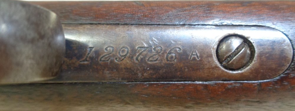

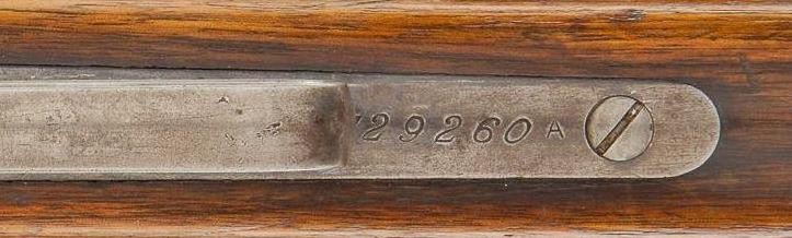

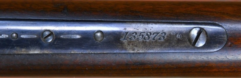

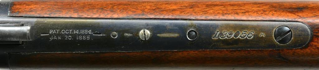

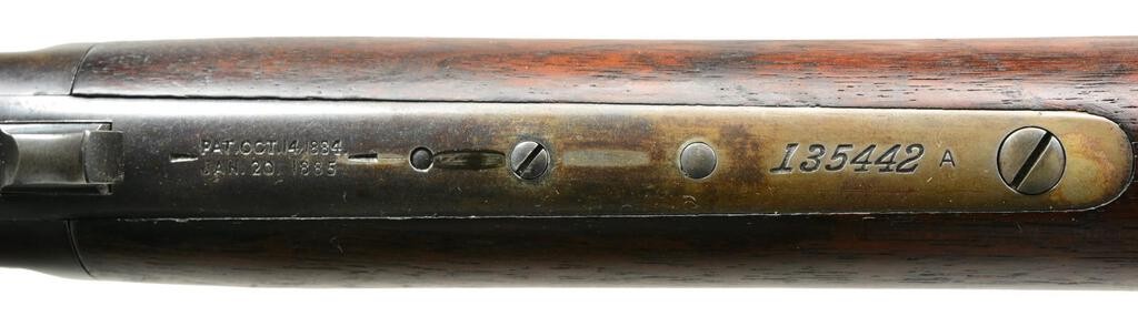

Looking at an 86 made in 1908. Has an A suffix on the serial number. Thought the A denoted a take down? this rifle is solid frame. Any input will be helpful.

According to my new 1886 booklet by John Madl (thanks Bill), at “SN approx. 130,000- EOP, the additional “A” added to serial number indicates a threaded magazine tube.”

The “A” is actually not part of the serial number (see the attached pictures). It was used on the Solid frame rifles when the change was made from a slip fit magazine tube to a threaded magazine tube. The earliest Model 1886s with the “A” were in the 128700 serial number range.
129260-A.jpg129726-A-33-WCF.jpg135442-A-33-WCF.jpg135873-A-38-56-WCF.jpg139056-A-38-70-WCF.jpg
