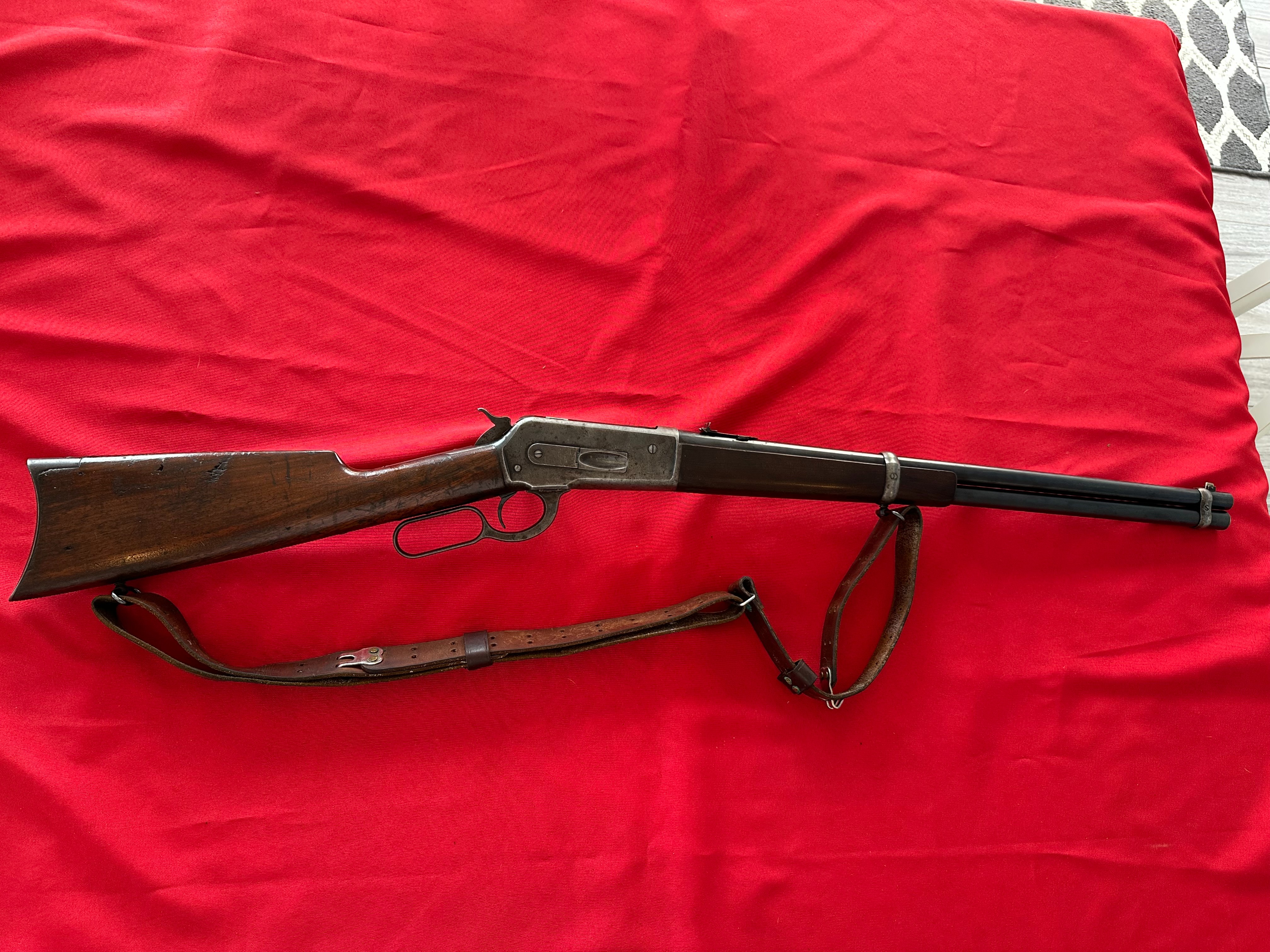

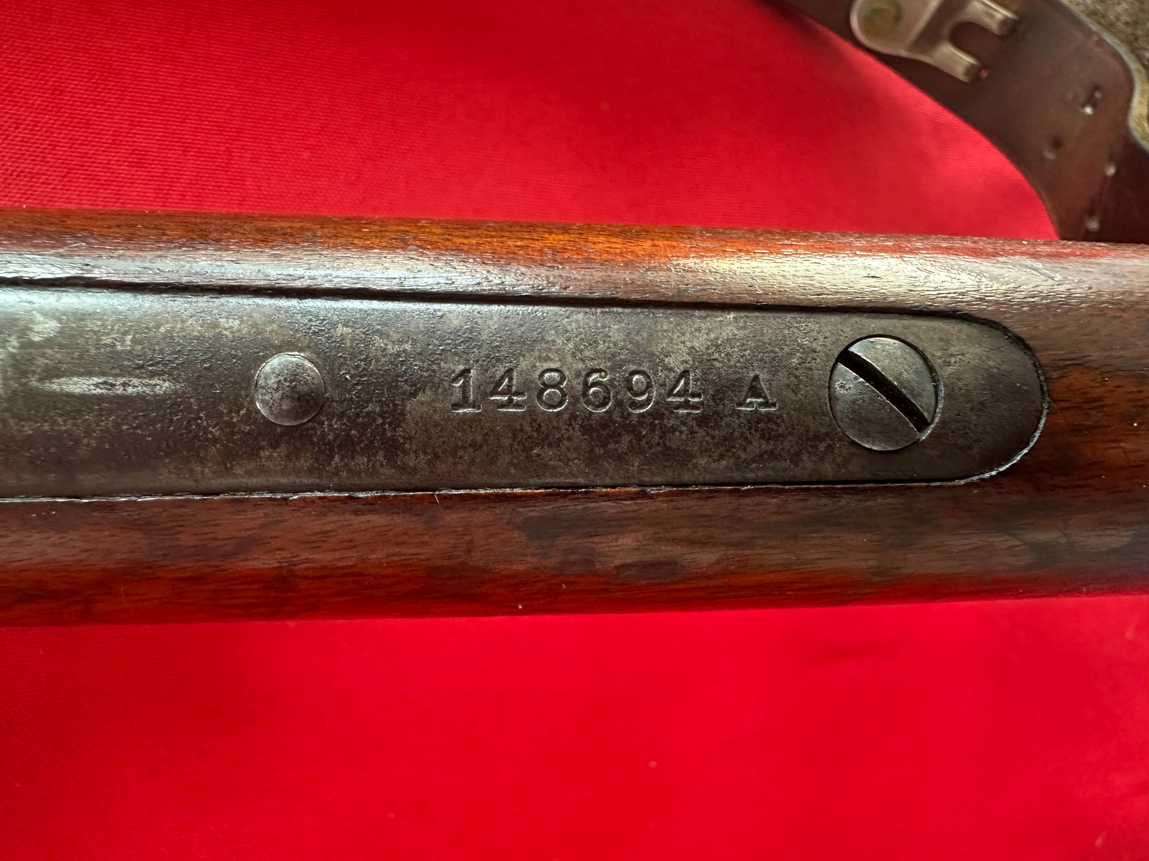

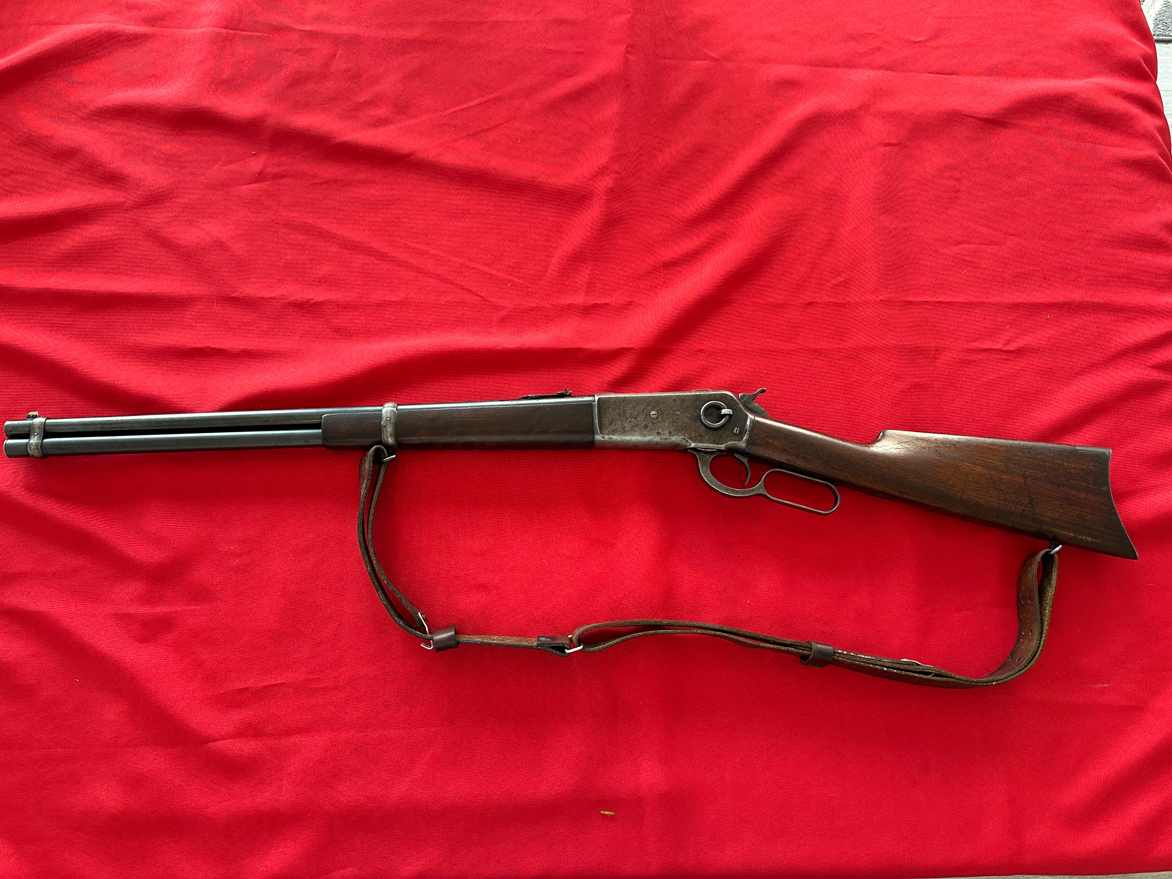

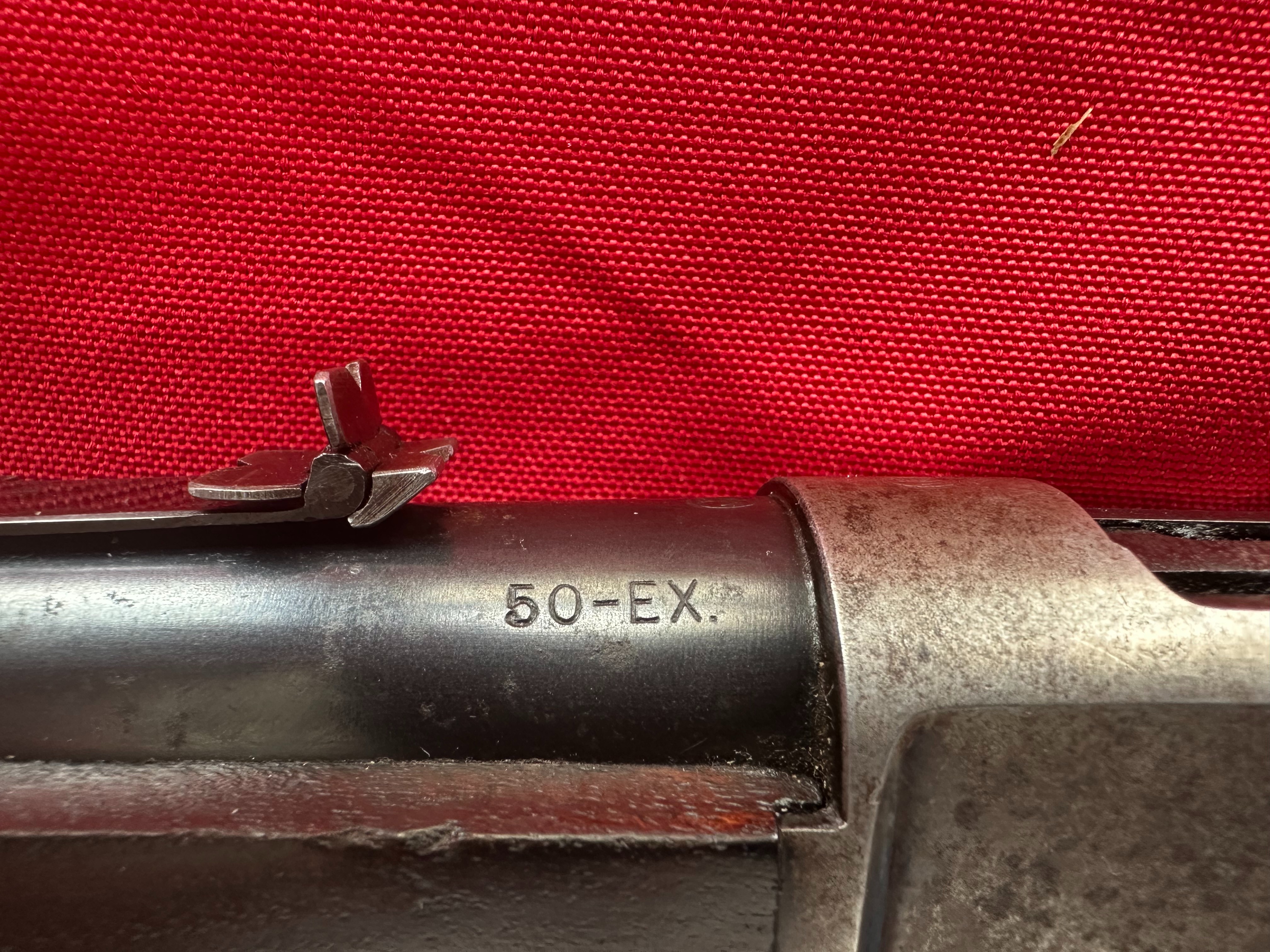

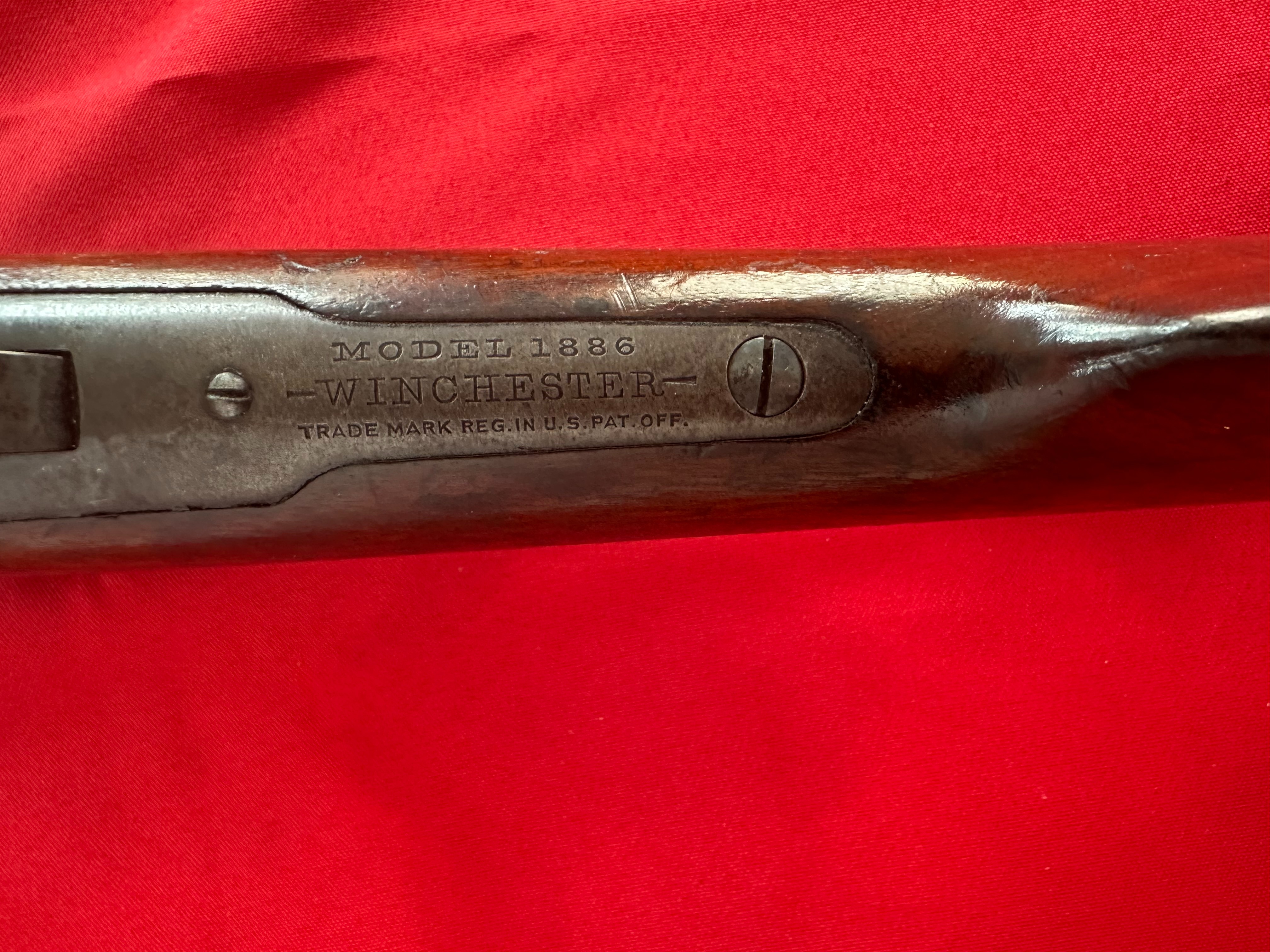

I have a 1886 Saddle Ring Carbine in 50 EXP. It is in a small group of rifles that records are not available for some reason. I believe this is an original 50 EXP from the factory but cannot verify through records. The A after the serial# indicates a magazine change during production. I think that helps?  Any thoughts would be appreciated. I have attached some pics. ThanksIMG_8215.jpgIMG_8213.jpgIMG_8212.jpgIMG_8214.jpgIMG_8217.jpg
June 29, 2025 - 4:33 pm
Interesting carbine.  The M1886 carbine was standardly produced with a carbine buttstock and carbine buttplate.  I have seen M1886’s with special order rifle buttstocks (and they lettered).  It’s also not uncommon that buttstocks got swapped as a M1886 rifle buttstock will readily fit on a M1886 carbine.  If your carbine is original, I think it would be quite uncommon as I have never seen a rifle buttstock on a .50 Express carbine.  As right as it might appear (e.g. consistent overall condition/wear) you will likely not be able to convince a collector it is original.  Have you taken the buttstock off?  I would be curious if there are any markings on inlet for the upper tang or on the metal on the right inside of the tang.  I’d also take the forearm off to see what markings are on the under side of the barrel.
All M1886’s (carbine or rifles) in .50 caliber took some additional manufacturing steps (e.g. machining of some of the internals of action, as well as the breech end of the barrel) for the big .50 caliber cartridges to cycle through the gun and feed into the chamber.  If I had your carbine, the first thing I would do is check to insure .50-110 cartridges would feed and cycle through the action.
June 29, 2025 - 4:42 pm
It appears to be a correct (legitimate) SRC with a special order “rifle” butt and sling mounts.  Does it properly cycle rounds from the magazine through ejection?

Certainly looks like an honest carbine. That doesn’t preclude a stock swap when it was much newer. Probably worth a closer look.

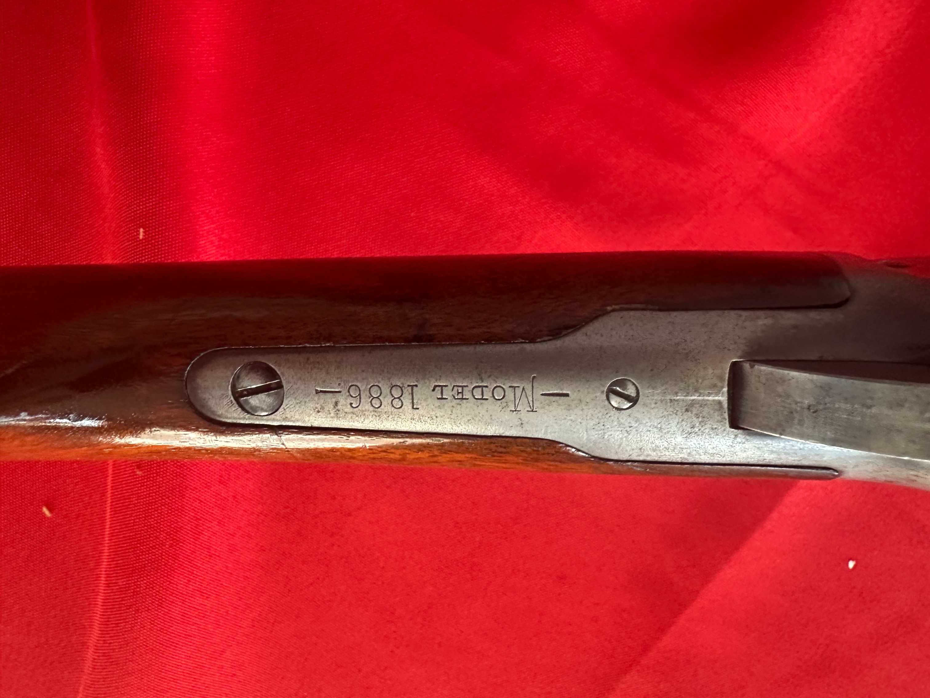

I also have this 1886 50 EXP with a letter. It seems it went back to the factory for a smaller caliber, and the 50 Exp barrel subsequently put back on. I am posting pics for any thoughts. Thanks BillIMG_7181.jpgIMG_7176.jpgIMG_7196.jpgIMG_7192.jpgIMG_7188.jpgIMG_7186.jpg
July 5, 2025 - 1:08 pm
Interesting.  Nice rifle.  You don’t see takedown .50 Expresses every day.  At least I don’t.
So I suppose when he had the .33 barrel fit to the rifle, he kept the .50 Ex. barrel.  He probably didn’t even send it with the rifle.  Then later, the .50 Ex. barrel ended back up on the rifle and the .33 barrel somehow didn’t stay with the rifle?  Maybe ended up in a closet, forgotten, unknown to the heirs?
Forum Posts: 1650
July 5, 2025 - 1:18 pm
The way I read it; Gun was mfg’d 1895 in .50 cal., repaired in Nov. 1895 then returned in 1903 changed to .33 cal. , but didn’t ship out again till 1905. Nowhere does it say it was changed back to .50 cal.. I’m not sayin’ the gun ain’t right , just it’s one of those baffling letters that a person has to interpret with the gun in hand, I’ve had a few of ’em .

I am not seeing something here. The letter tells of an R&R 4 months after being shipped in 95. Then it was returned in ’03 and someway made up into a 33wcf, whether the whole rifle was there or just a TD assembly, is hard to determine. BUT, what ever it was sat there for over 2 years before it shipped. this is the conundrum for me. I hate to say it but with out definitive proof I suspect the barrel on it is not an original barrel.  What leads me to this is the caliber stamp. It is missing the hyphen and the ends of the letters are round as if laser engraved, and the 5 doesn’t have the little curl up at the opening.
Edit to post, it would appear that the hyphen may not be as big a deal as I originally thought as I was digging and found that it wasn’t used all the time.

One cannot assume the barrel on it now is the original one.  If the gun returned to the factory in 1903, and was shipped in 1905 in the .33 Winchester configuration, it’s unlikely that the owner in 1903 sent it to be changed to .33 Winchester due to the two year lag.  I think it was returned and the original owner ceded ownership for credit or otherwise.
I am guessing that for whatever reason it languished at Winchester, and was changed to a newer chambering (but I have no good explanation why).  In those days, these were not collected, but used, so it’s doubtful this rifle shipped in .33 Winchester in 1905 also with its original .50 Express barrel, and, if it did, I think the letter would state such.
I think that, since additional steps are required for fitting to .50 Express, someone might have recognized this, and reconfigured to .50 Express due to added value.  It could be that an original .50 Express barrel was used, but those aren’t exactly a dime a dozen.

This rifle should positively be a 33 WCF.  The original 50 Express barrel was not returned or resold with the rifle, hence it should not have a 50 EX barrel on it today.
Based on how the factory letter reads, this rifle was sold to a dealer (business) and it did not sell.  The dealer/store subsequently sent it back to Winchester.  Winchester then rebarreled it to the then brand new smokeless cartridge and it then sat in the warehouse for a few years before it was sold & shipped.
Because it is a Take Down, swapping the barrel assembly is a relatively easy task, and somebody well after the fact illicitly did exactly that (undoubtedly to enhance the value of the rifle for a more profitable sale).
