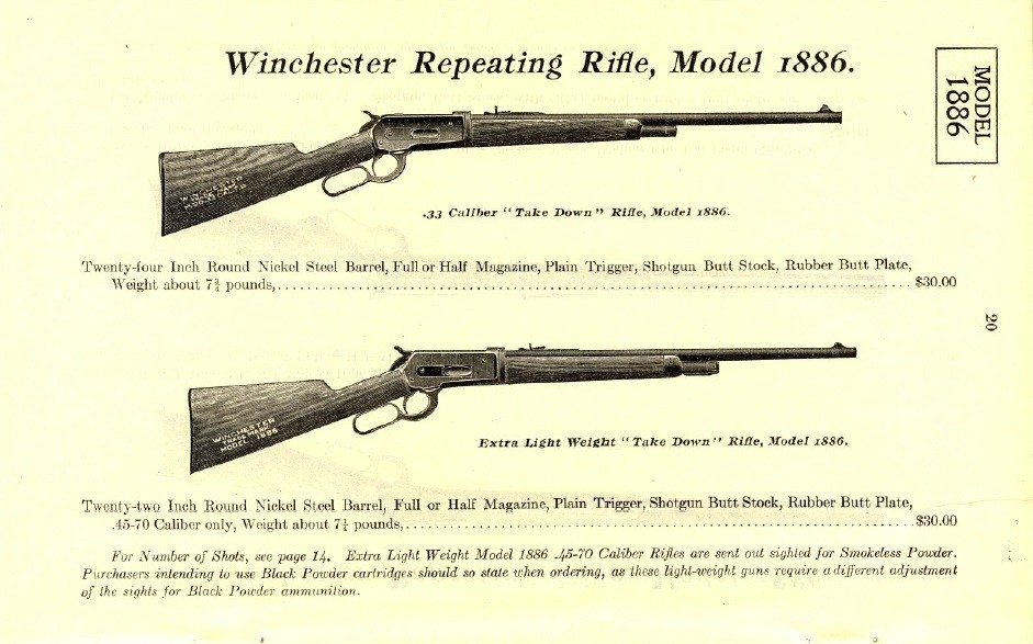

Winchester never used the term “lightweight” for their Model 1886. They only catalogued the Extra Light Weight. The pre-1902 Extra Light Weight rifles should have case color finished levers and hammers.

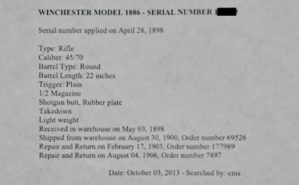

An old thread here but here’s another that excluded the word “Extra” and only says Light weight. It is within the same time(3 days) in 1898 that Tim mentioned above.

Rick,
The term “light weight” as written in the factory ledger records and on the CFM factory letter you posted denotes an Extra Light Weight rifle.  There is no doubt that “light weight” was written in the ledger records, but that the rifle in question was actually an Extra Light Weight (as in the case for s/n 116919).

I would love to examine this rifle.  Better yet, have it in my safe.

I have stated this in previous topics… It is the barrel length that defines what is (or is not) an Extra Light Weight rifle, not the magazine length.  All of the Model 1886 ELW rifles have a 22-inch barrel.  The 33 WCF rifles were standard with a 24-inch barrel and therefore are not “ELW” or “lightweight” rifles.

Steve,
There are a very small number of 33 WCF rifles with 22″, 20″ and even and 18″ barrel.  While I have not examined what was written in the ledger records for each of them, the two factory letters I reviewed for the 22″ rifles did list them as Extra Light Weights.
As for the non-standard caliber “ELW” rifles, almost anything could be possible and recorded in the ledger records.  I consider them as “special order” rifles versus true ELWs.  When the Winchester employee entered them in the ledger records, he/she likely used them term “lightweight” to describe a rifle with a shorter than standard barrel length, or a specially ordered smaller diameter barrel.
