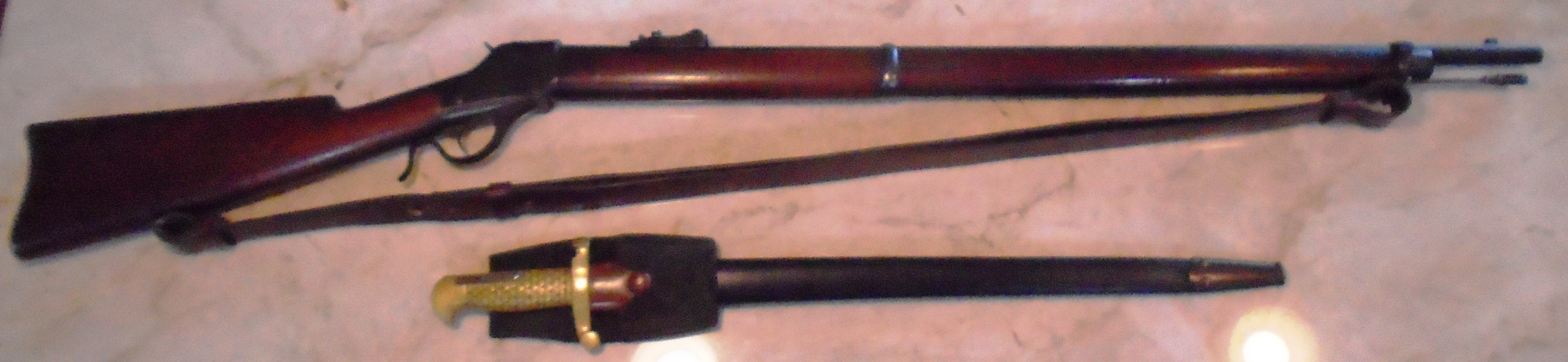

[Image Can Not Be Found]Can (and have) taken photographs. Can’t sort out how to post them here.

If you send them to me, I will post them.

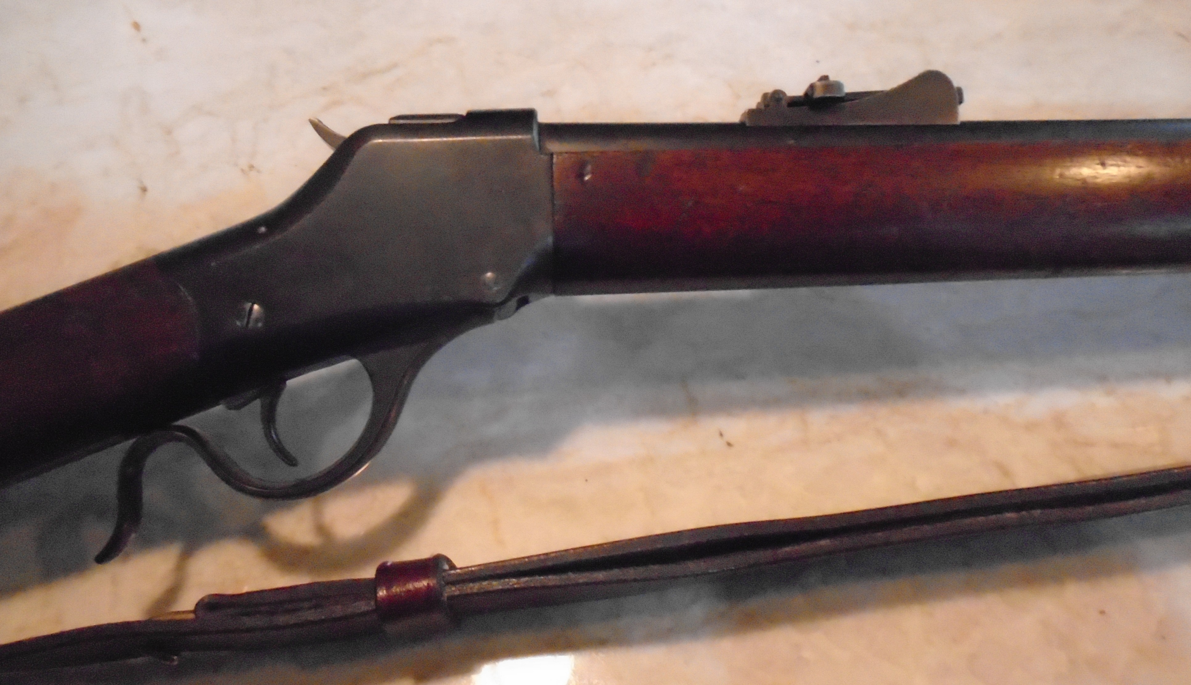

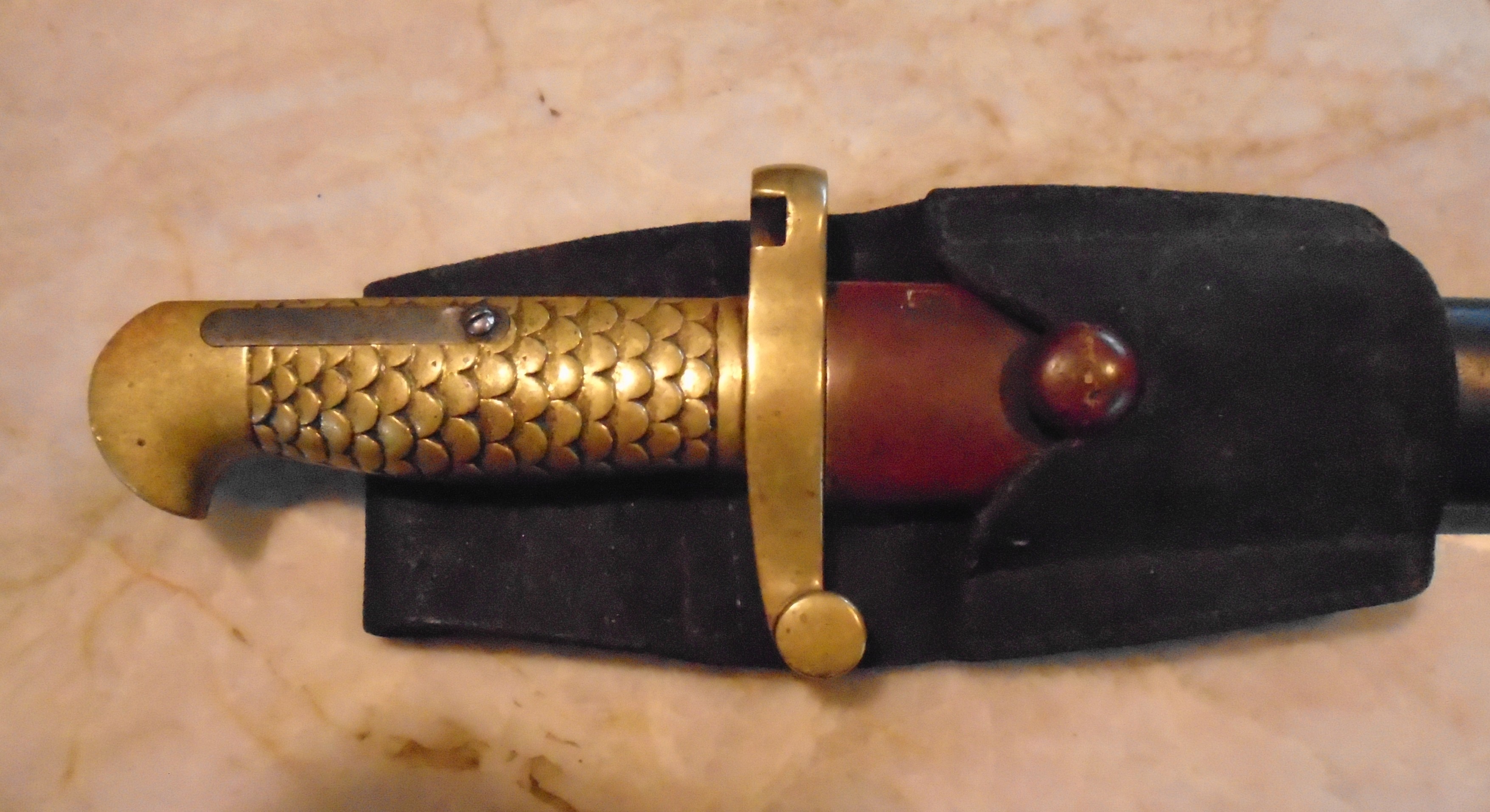

April 29, 2025 - 11:13 am
Re: Photos. Done.
And here they are…
Forum Posts: 2106
April 29, 2025 - 10:18 pm
That’s a great piece with everything all together. You don’t see too many bayonets with patina like that.
Thanks for sharing! Smile
