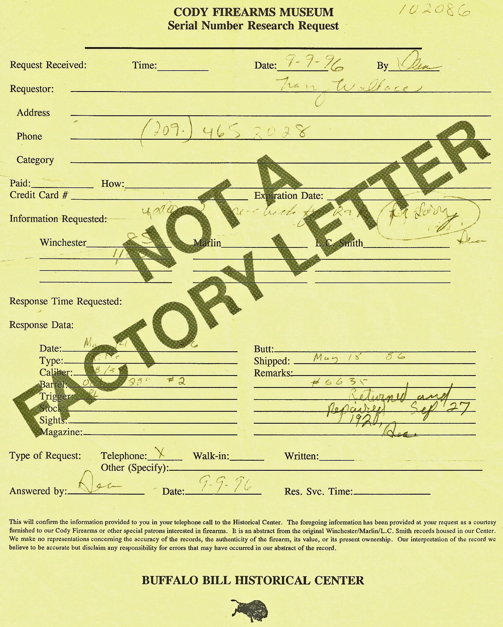

I recently got a letter on my 85 ser. #1100.  I also have a factory yellow sheet from 1996.  Neither mention that the gun is case hardened.  The yellow sheet states the gun was returned for repair on 9/27/20 but there is no mention of this on the factory letter?  Any way to see what was done?
That was the standard finish at the time–why mention it?
If presumed factory work isn’t described on the factory letter and/or yellow sheet, logical inference & common sense is pretty much what you’re left with…though those aren’t bad alternatives!
Forum Posts: 14830
April 8, 2018 - 4:40 am
As Clarence stated, case color was the standard finish for the Model 1885, and as such, it would not be noted in the factory ledger records.  If your factory letter does not mention an R&R, the yellow sheet contains incorrect information.

Thanks Bert…can someone post a picture of one? Peter

Here is the yellow sheet that shows the return for repair.Yellow-Sheet-1885-38-55.jpg

Thanks for the photo. I have not been collecting long enough to see one of those I guess. Peter

That yellow sheet as some fictional information on it… specifically, there was no “R&R” for serial number 1100.  Based on the date on your yellow sheet, I suspect that Waddy was the person who created it.

Bert do you recognize the initials?  Looks like DEA.
Clarence that is why it took years for me to pay for a letter on a gun that I knew was correct.

…nor I. Thanks!!
Forum Posts: 14830
April 9, 2018 - 2:53 pm
No, I do not recognize the initials.  The scanned copy is not large enough or clear enough for me to read and interpret everything on it.  That stated, it might have been Dena Hollowell who wrote your yellow sheet. She used her initials “DLH”
