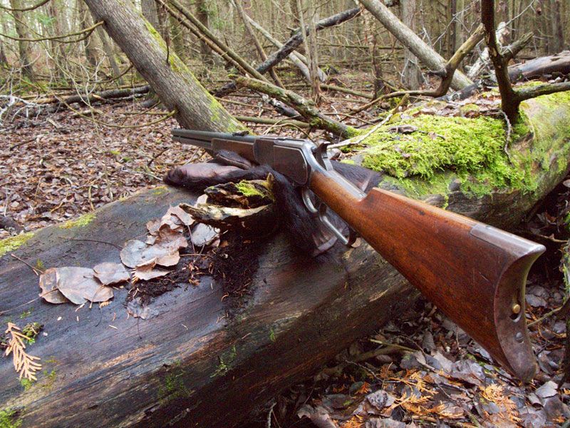

I’ve had two different original Model 1876’s. One was made in 1878 and the other in 1886. Both were 45-60’s and I shot them a lot and even hunted with one, one year. Here’s a photo of it hunting in a Cedar swamp …
As for brass and dies, Buffalo Arms sells some beautiful 40-60 W.C.F. brass made by Captech (formerly Jamison) http://www.buffaloarms.com/40_60_Winchester_Brass_Cases%20_it-160058.aspx?CAT=3838 . Excellent quality and cheap like Borscht. However, I doubt they ship to Canada, so you will need to figure out how to get it. Sometimes Ellwood Epps sells hard to find brass. For dies, several companies make dies. I was completely happy with my Lyman dies for the 45-60 and they also make dies for the 40-60, as does RCBS and Lee. http://www.buffaloarms.com/39_40_caliber_reloading_dies_pr-4043.aspx For smokeless loads, I would only recommend one powder …. 5744. You will have to start low and work up until you achieve the original Black Powder velocity with a 210 grain lead bullet at 1,533 fps. Only do this with 5744, as a BP equivalent ballistic will give you a lower peak pressure than FFg. DO NOT use IMR 4227 …. waaay too position sensitive for a ’76.

Kirk that is a good looking 1876, Thanks for sharing picture.
