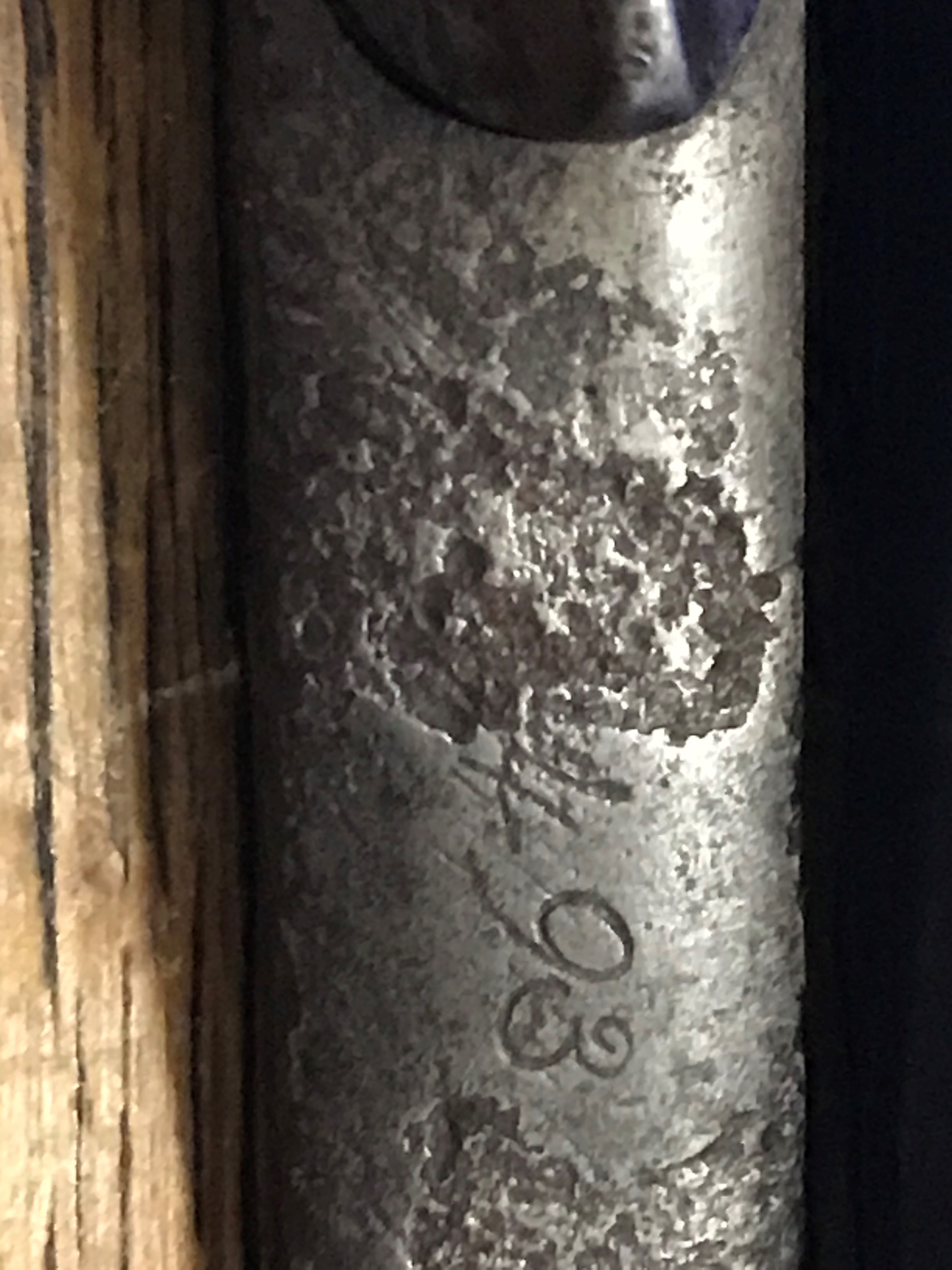

     Yes’sir good advice.  Yes’sir I understand that the new parts need to match to look correct.  The only problem with getting the correct configuration is that the first two numbers of the serial I cannot read.  The last 3 are readable.  It is definitely a 5 digit number.  It looks like damage from blood too me but I do not know if blood will wipe out serial numbers.  Of course I don’t think the depth of the numbers were that deep during the 1881 era.  Seems like I read in Madis that they made the numbers deeper somewhere around the 600,000 era.  I know not being able to read the serial number hurts the value but the guns value is in its story, history and patina.  I am going to meet with the man that sold it to me and get the full history of the gun.  Thanks for the info.
Forum Posts: 4995
December 11, 2019 - 4:17 am
Take a good close up of the serial number and post it.

December 11, 2019 - 5:40 am
Forum Posts: 4995
December 11, 2019 - 5:52 am
Yes that is rusted a too much to see anything else. I don’t think even acid would lift the numbers.
