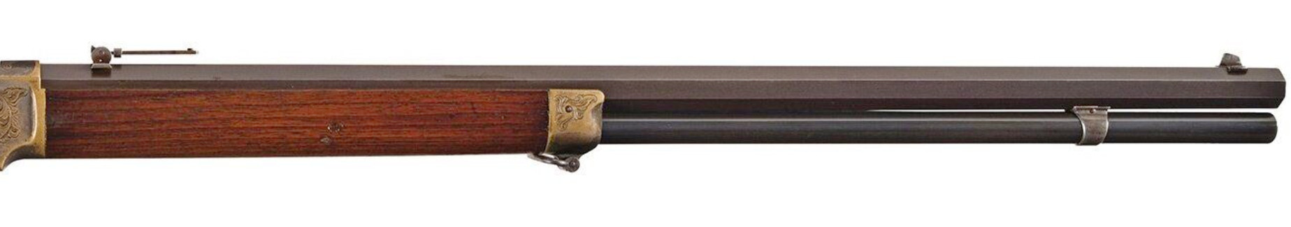

I checked a old 66 survey I have and it listed the gun was in a RIA in Aug 2005 and Sept 2006. They are not on their web site but did have the 2005 catalogs. Attached is the photo of the page. I don’t like the barrel and tube. Absolutely  no wear or dings in either and the color of them don’t match. The fit of the tube to the barrel is ugly. If your serious about the gun, get detailed pictures of the entire gun is in order. The pictures they posted are horrible with the white background which darkens the gun to hide detail. I grabbed a picture of the barrel/tube and lightened it so you can see it better.

This. Add to that they only included 6 pictures on a gun that potentially could be worth north of 10k….plus as mentioned, it’s not in a premier auction. Red flags and they know something we don’t….or that we do I guess.
