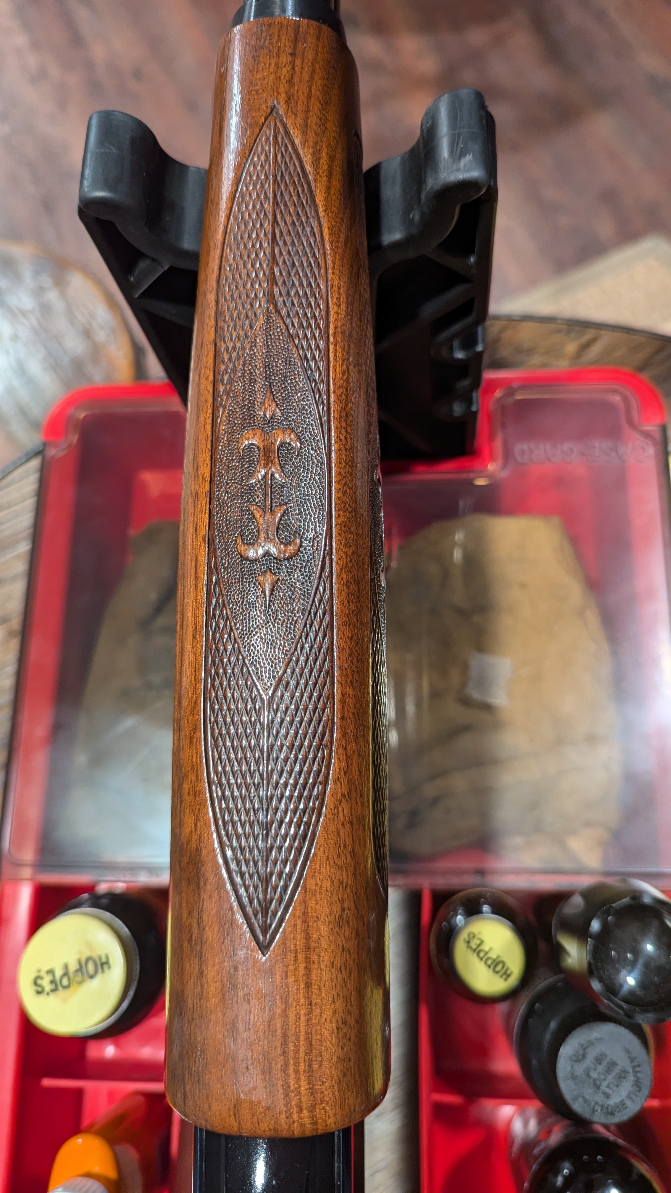

I’m not 100% sure what info you’d like but I have a 1200 with SN L612422. Tell what you’d like to know about it.

I can guarantee that # L612422 is a 1970 manufacture.  In fact its serial number was applied on April 13th 1970, and it probably left the finished line six to eight weeks later.  I cannot tell you its Gauge for sure, but I suspect it is 12 Gauge, but not a Magnum, and it is not a left handed model, but thats all I can tell you, just from the Serial number.
If it was purchased new, perhaps you can advise when it was purchased (for the benefit of the readers).
But I would like to know the following:
Barrel Type (Plain or VR), Choke (F, M, IC, Skeet or Winchoke) and Length, and the Barrel Address (which occasionally changes)
Stock Checkering Pattern, and But Plate or Recoil Pad and type, writing (and if Hydrocoil); Forearm Checkering pattern (and if Hydrocoil)
I can get all the data I need to get the Factory Code Number for a gun except all the barrel data from appropriate photos (about 9 are required as listed in Post 4) and if the quality and interest are there I could use them in the publication.   The Model 1200 was made in over 80 different types, Factory Code G120003 being the most common – 28 inch Plain Modified Choke Barrel, differing only slightly in appearance and features from 1964 to the end of production.
A full description of Factory Code G120077 (introduced in 1966) Model 1200 Magnum Field Gun 20 Ga, 3″ Shell 28″VR FC Bl MBF Sights, XX F’end, Walnut Stock Tailed Checkering, Fluted Comb, Black Pistol Grip Cap, Red Recoil Pad, again differing only slightly in appearance and features to the end of production.
Basically I am looking for the first and last serial number of guns with known descriptors  and years of production to sort out the last serial number for a year.  At the moment, I am looking for serial numbered guns to pick the 70/71 and 71/72 change # number, and the photos, in conjunction with the Stamping Records I have, assist me in doing that (as I apply the Factory Code to each record).

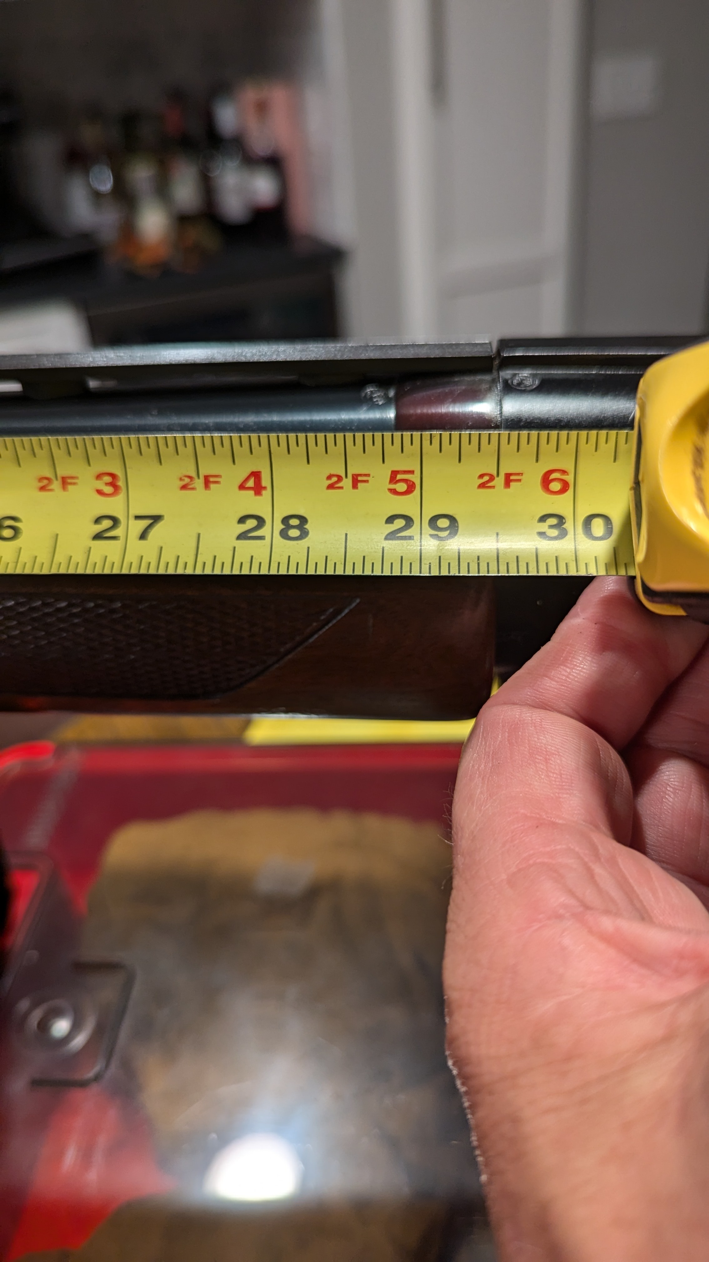

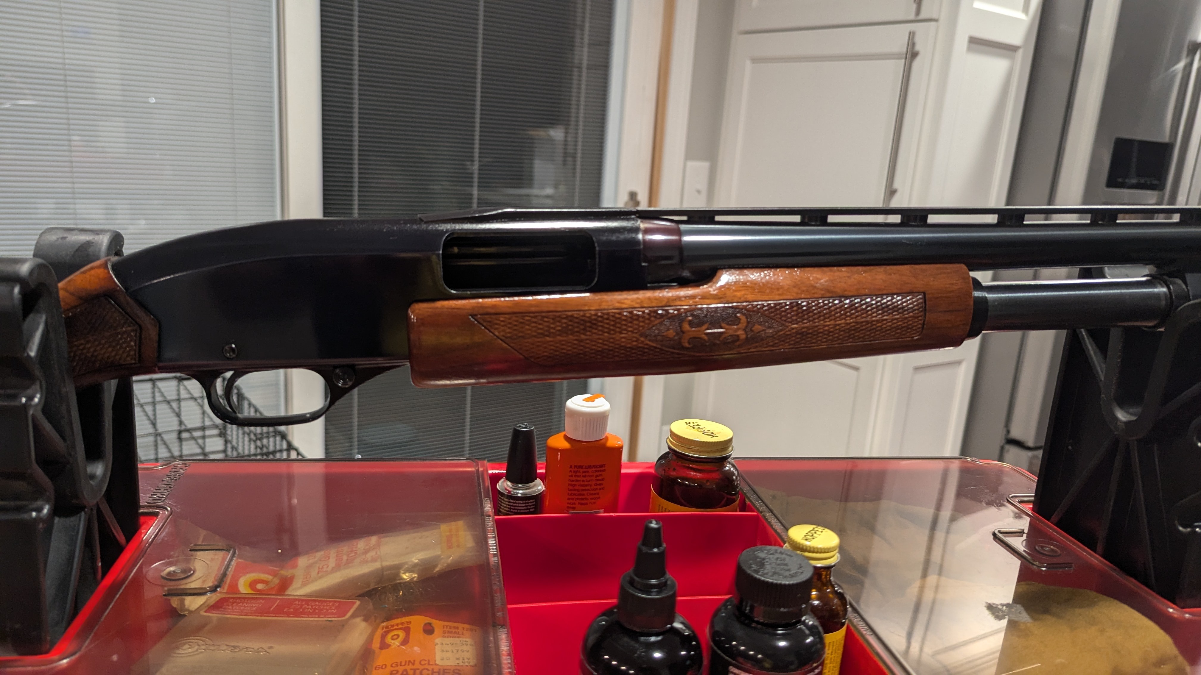

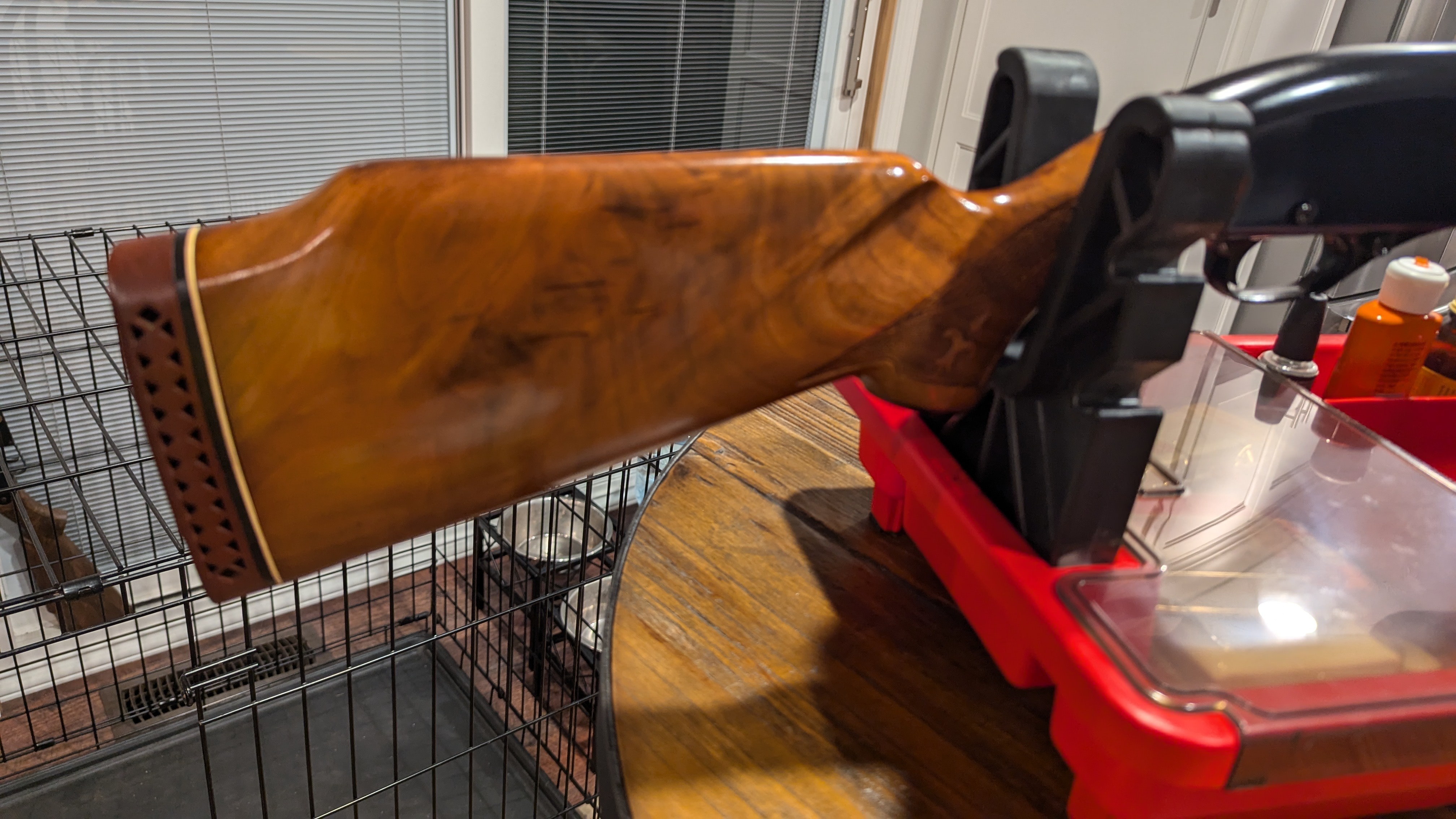

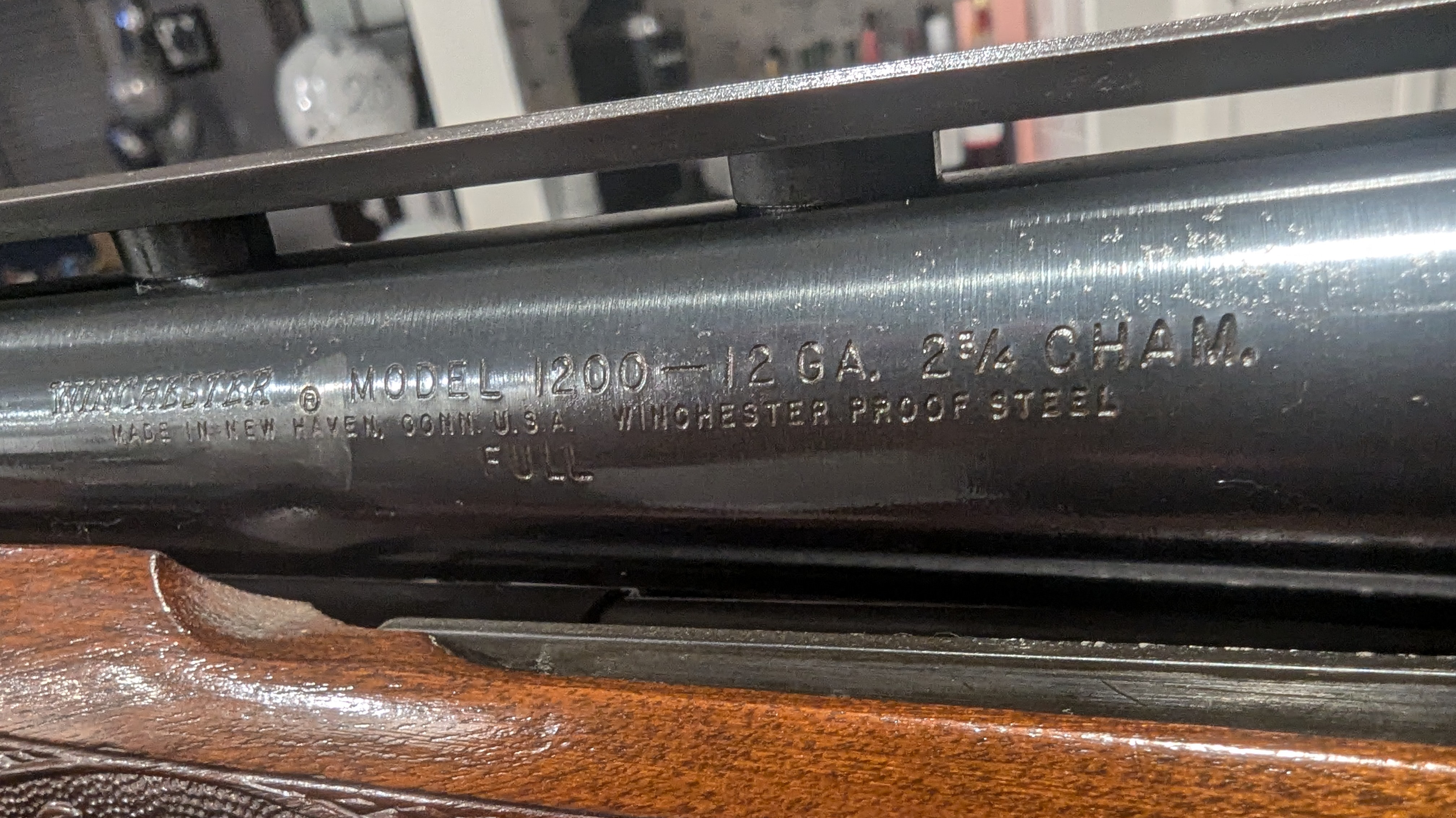

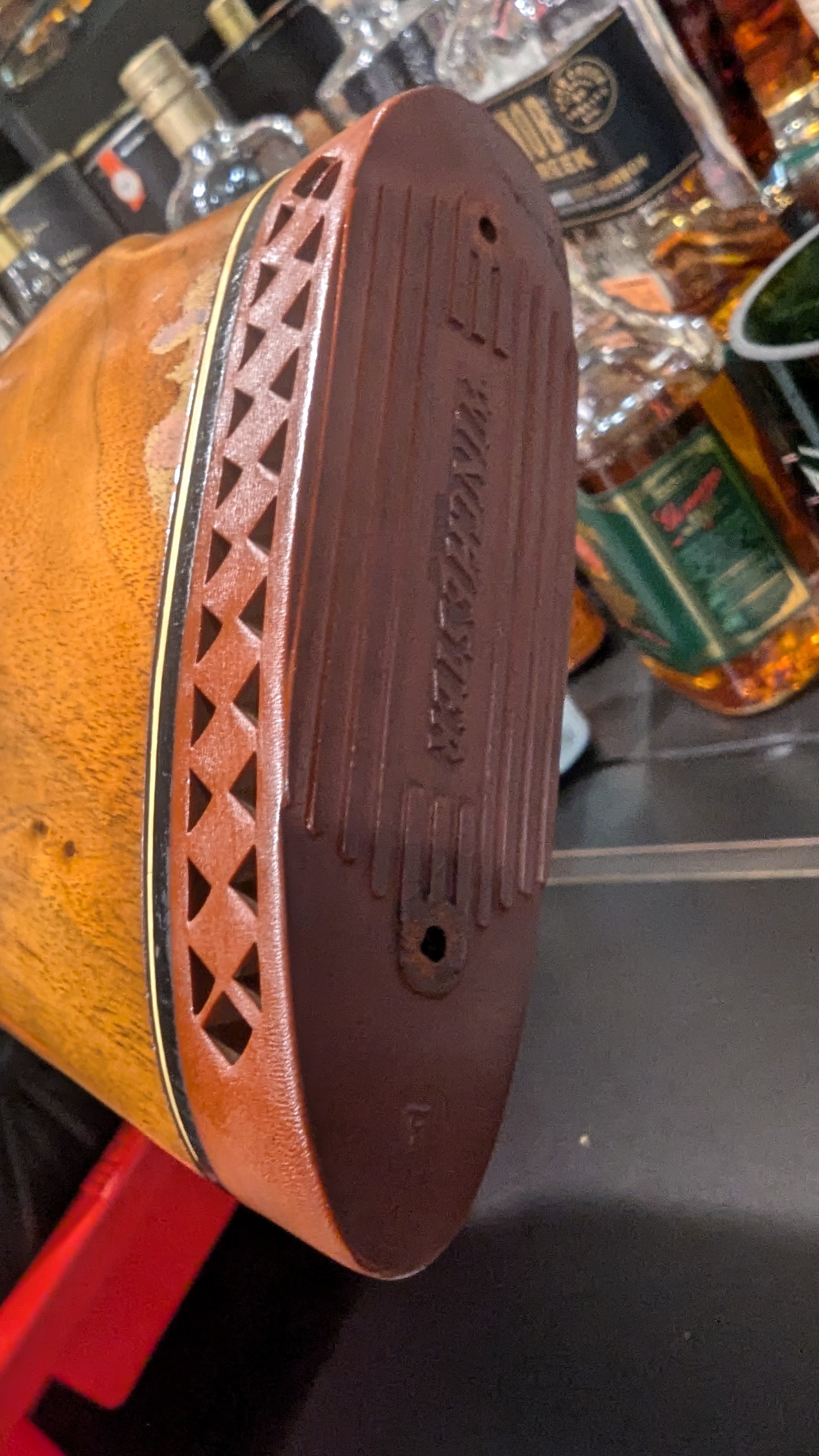

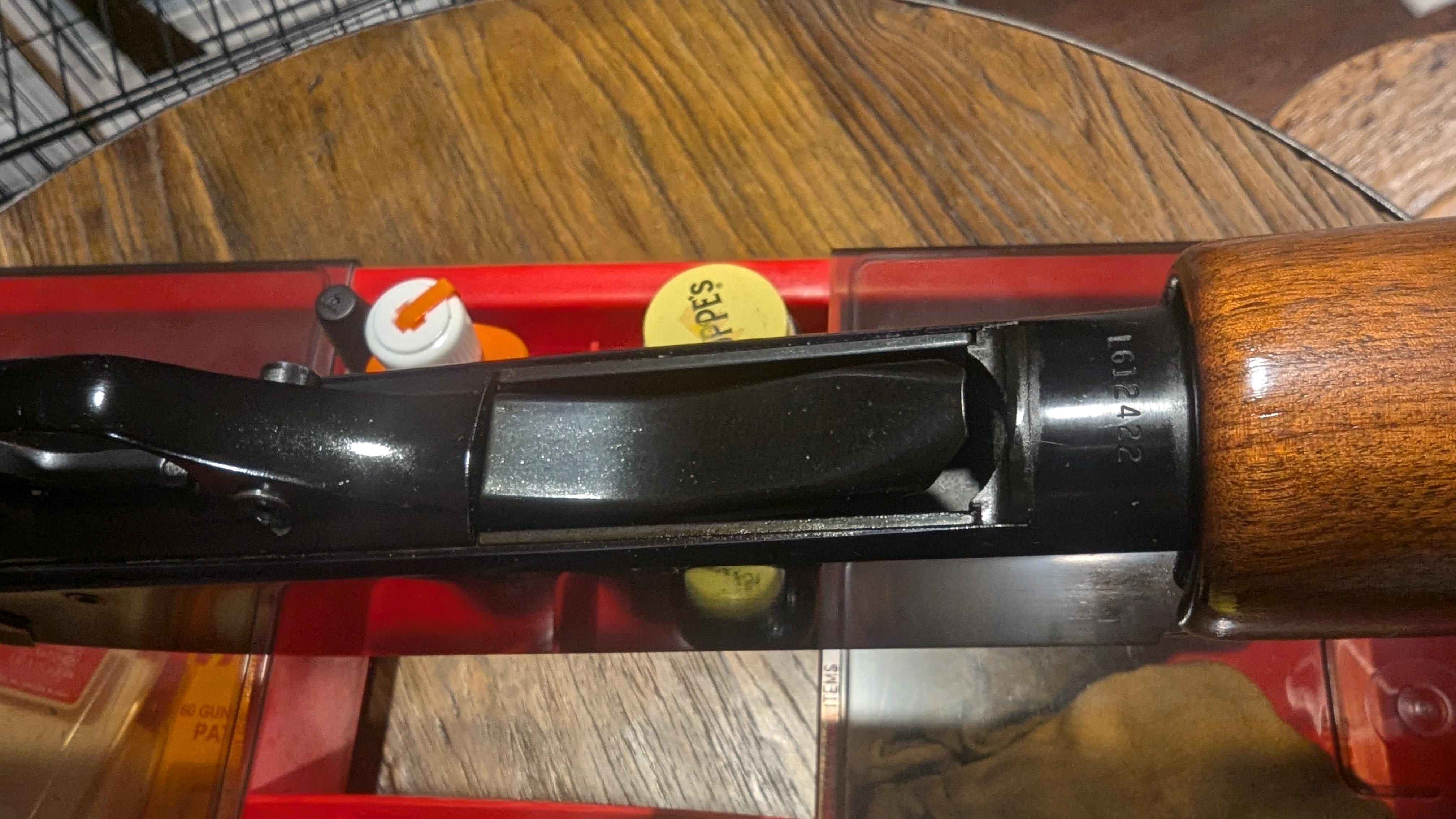

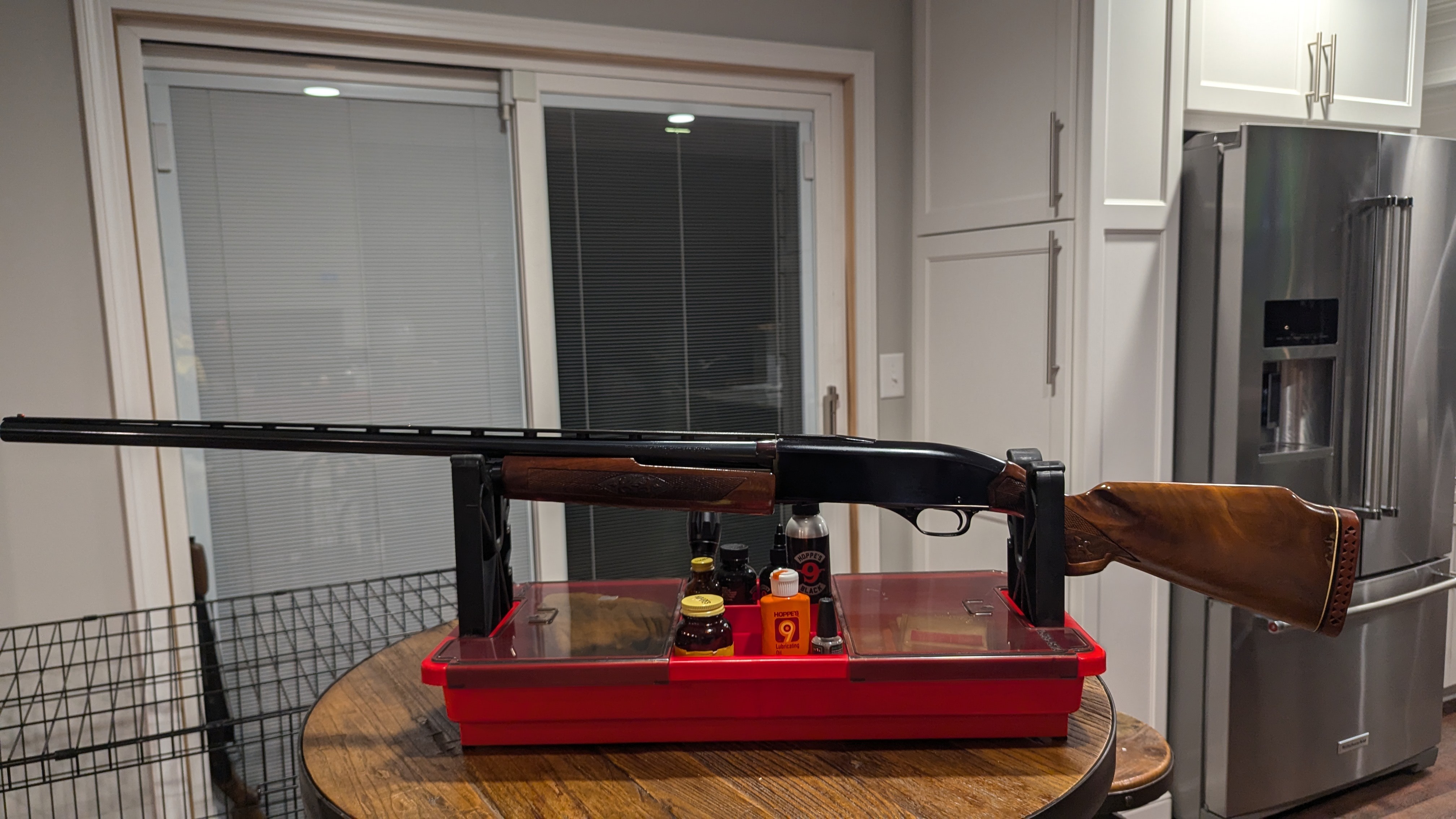

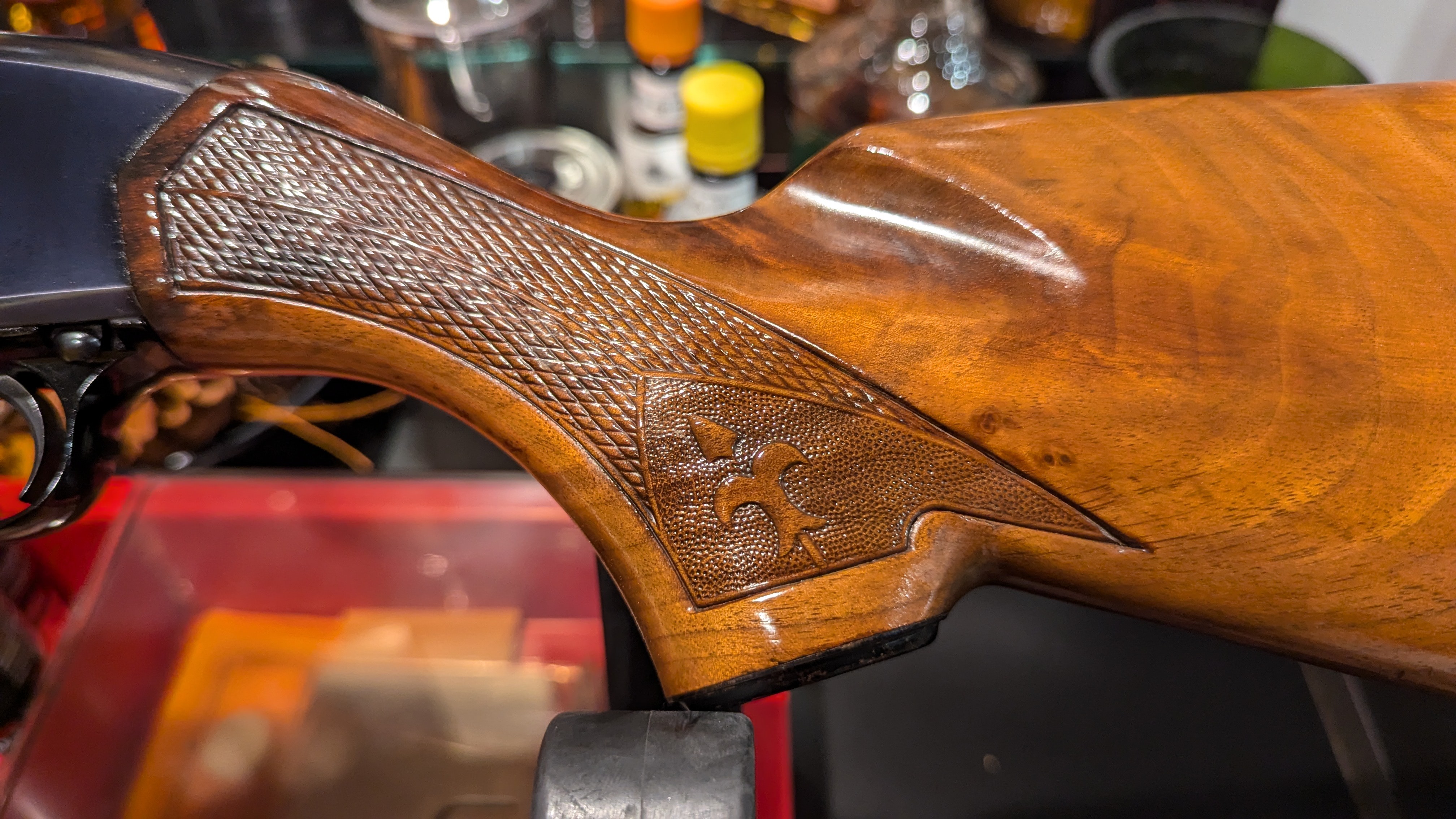

Keith, I think I have what you need. I’ve taken pictures for you. I’m not certain where to find your email on this forum… I’m new here,  sorry. Here are a few pics. The barrel is 29 1/2 at the receiver and approximately 28 7/8 to the forward edge of the taper. PXL_20241015_013234848.jpgPXL_20241015_013350583.jpgPXL_20241015_005349642.jpgPXL_20241015_005326412.jpgPXL_20241015_012952082.jpg PXL_20241015_010704745.jpgPXL_20241015_010533671.jpgPXL_20241015_010709342.jpgPXL_20241015_010735344.jpgPXL_20241015_013035147.jpg

I am pleased to say you have an excellent example of the Model 1200 Trap in 12 Gauge with a Monte Carlo stock. This model was Factory No G120036 and was made from 1966 to 1973, with occasional changes to the woodwork and recoil pad, which  has Fleur de Lys Checkering on the stock and forearm.
The photos are excellent and high density and I could use some in my book but to use all they need to be on a plain background – eg in front of a plain wall is excellent – If possible I would like a photo of the Pistol Grip Cap which you could send with ancilliary photos to [email protected] .  I have saved your photos as “# L612422 Model 1200 MC Trap12 Ga 30 In VR FULL Bl WACA Motocop-” – If I use them would you prefer to acknowledge your name instead of Motocop?
In my Database I have photos of the following: # L610037# L610401, # L612422, # L612739, # L612881 and # L613065.  Your # fills a gap.  Thank You

I am glad this helps you some in what you’re doing with the 1200  research. This is very interesting to me as most of this information I would have never known if not for your research work. I have an idea of how to get you the pictures you’d like with a plain background. You are certainly welcome to use whatever pictures you’d like for your work. You may use my name rather than the silly forum name. I will do my best to email  those pictures etc. to you in the next day or two.
Here’s a quick back story on the gun. This particular shotgun is special to me because it belonged to my father. We sadly lost him in 2018. He enjoyed shooting clays in the 70’s and 80’s and I know he was very fond of this Winchester. I don’t believe he bought it new but I know I have the receipt in a box somewhere….I’ll have to dig it out to satisfy my own curiosity. It is interesting to know that based on the manufacturing dates you provided here this shotgun and I are almost exactly the same age …. the Winchester is definitely aging more gracefully. I’ll be emailing you soon, Keith. Thanks you!
