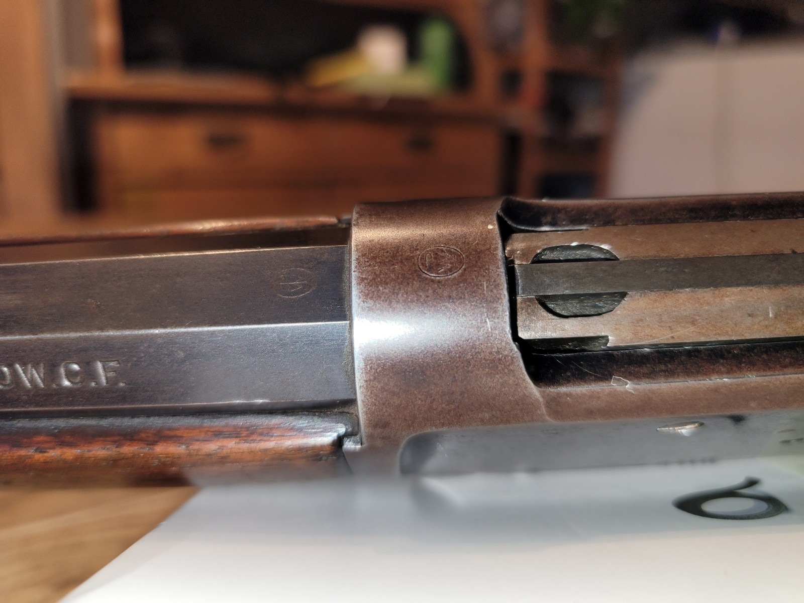

I bought a old winchester rifle model 1894 ser. No. 82431 .
It was just marked for Germany with the required proof marks “CIP N” (laser tags). I use it for target shooting as a sport shooter.
I am aware that the rifle is not expensive or rare. I would like to own a Winchester Rifle that is as old and authentic as possible.
I have been trying to determine the age. According to the serial number, I found the production year on the Winchester website to be 1887. According to the WACA website, the production year listed is 1900. Since the rifle has the “Hallmark of Quality ” it should be built after 1905?
Maybe the serial number is not correct? I have attached some photos of the rifle. Can anyone please help me? Laugh

2 observations.  Someone has done some file work in the area of the serial number and a possible double strike on the first numeral.  The magazine tube looks to be longer than the barrel.

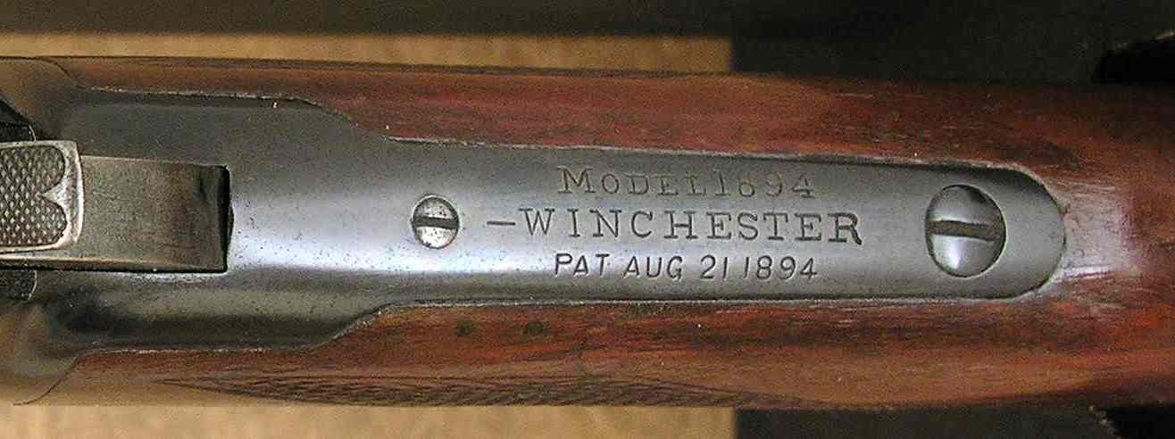

To me the most glaring “problem” with the gun is the mismatch between the implied DOM relating to the serial number and the style of the upper tang stamp.  A 5 digit gun should have the first style of tang stamp as in the attached image.  The style found on this rifle did not come int ouse until in the SN 750,000 range (Renneberg p.124) corresponding to a DOM in 1915 or later!  Another “problem” is the script style used in the serial number.  Early rifles had more rounded 2 and 3 digits that this rifle does not.  There is a darn good chance that the original first digit of the serial number has been removed making a 6 digit rifle a five digit rifle.  This would also then fit in line with the presence of the proof marks, the upper tang stamp style, The SN number font style, the left flat position of both the barrel address stamp and the caliber designation and the hammer style.  I am afraid that the rifle is not nearly as old nor as authentic as it was presented to you.

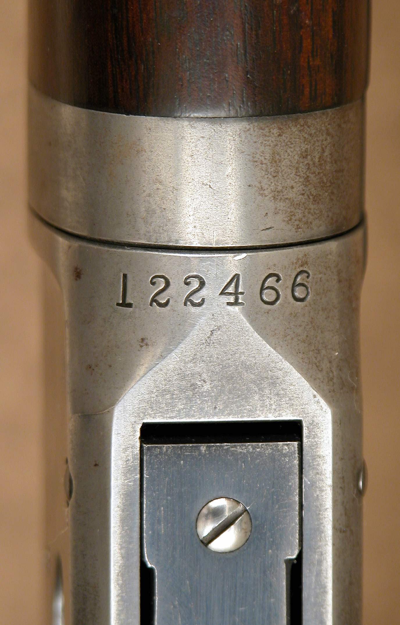

Absolutely with respect to the serial number.  Compare the flat surface areas just below the SN on the rifle in question with the two images I posted above and this one also.  No doubt that the number has been changed.

I would wager a large sum of $$$ that the original serial number was removed and a new number stamped in its place.
As pointed out, the upper tang marking is of a later production period.   Winchester first began using the Type 4 Model 1894 marking in late 1914, and continued to use it until early 1920.
