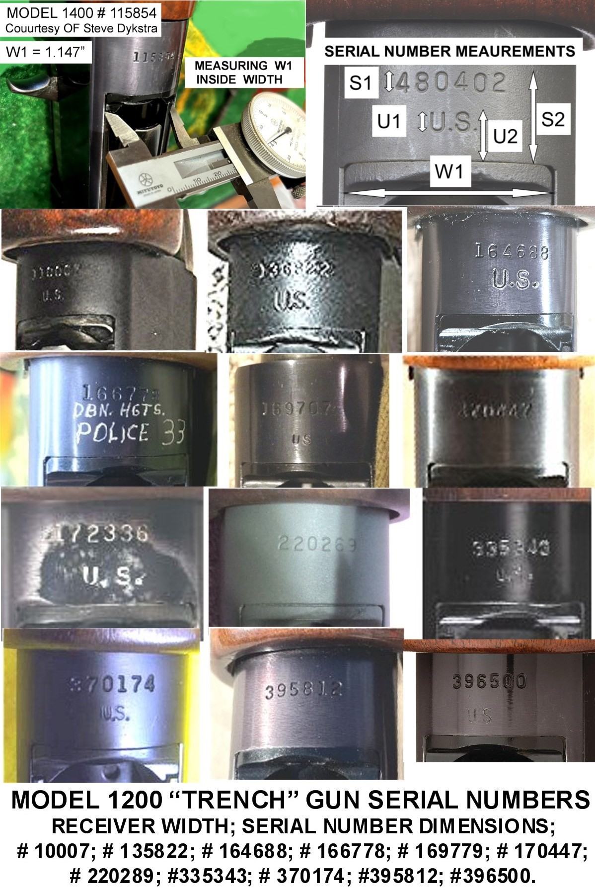

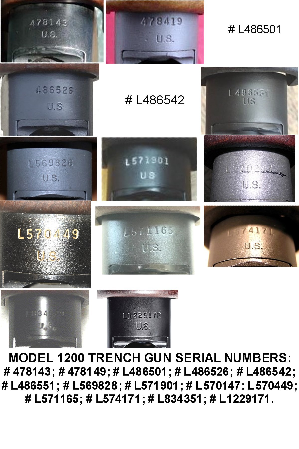

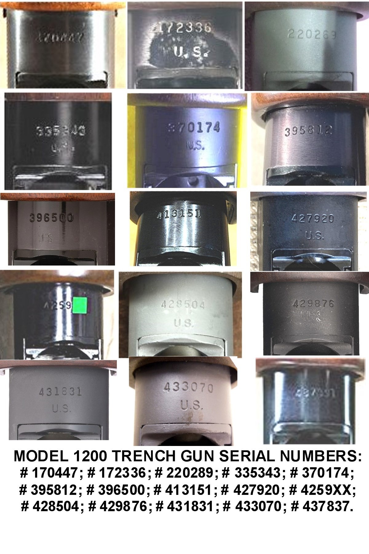

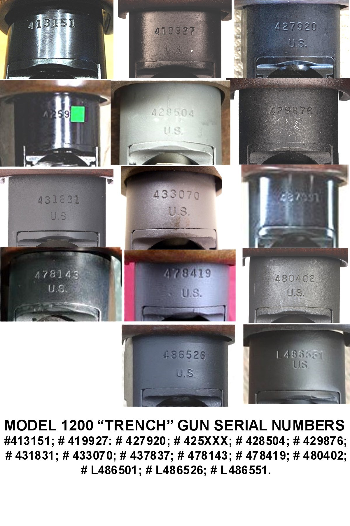

Many of you know I am writing a book on the Winchester Model 1200 shotgun (and others), and I have just completed a chapter on the Model 1200 TRENCH GUNS, which I started collecting examples of since 2013.  With the models named in Bruce Canfield’s book (38) and in collaboration with two WACA Winchester Military Arms collectors, I have reviewed 101 records dating from 1965 to 1978, some of these are genuine Vietnam Era guns, the early guns from 1965 I have attributed to Winchester prototypes, and I am not making any comment on post 1969 series guns (# L572000) of which I have three examples.
As a matter of interest, I have 9 examples from 1965 and 1966, a few advising they were Replicas, 2 from 1967 (including one Replica) 30 from 1968 excluding Canfields 38 examples which cover 1968 and 1969), 9 from 1969, and of course 3 from 1971 to 1978.
The actual Vietnam Trench Guns were ordered from the army in four orders, one of 1500 and three of 5000, the last batch being started in December 1969 and delivered in early 1970.  From the illustrations and the Serial Number stamping dates I have I have identified the serial number ranges to within a few hundred serial numbers, and as I acquire more serial numbers of Model 1200 guns I will further narrow this down.  I have carried out a study of serial numbers and where shown the US stamping and attach four montages of serial numbers which were enlarged to full screen to measure the heights and distances shown in photos (continued below):
Fig.-7.2.8-2.-Model-1200-Trench-Guns-Serial-Numbers-to-335343.jpgFig.-7.2.8-3.-Model-1200-Trench-Guns-Serial-Numbers-to-L486551.jpgFig.-7.2.8-4.-Model-1200-Trench-Guns-Serial-Numbers-to-169767.jpgFig.-7.2.8-5.-Model-1200-Trench-Guns-Serial-Numbers-to-L1229171.jpg
Basically all of the guns had the same size Serial Number height (1/8″) and were placed 0,5 inches above the Loading Gate.  The height of the US was the same as the Serial Number, and the same distance above the Loading Gate for all of the true Vietnam Guns.  It is certain that the US was added by Winchester as it would have been in the Contract.  In all other cases the recipient, whether the Army or a civillian, added the US Stamp which varied in letter height and distance.
I am sure that many of the 1965 and 1966 guns are Prototypes made by winchester and issued to army establishments under “-  a military shotgun development program instituted by Winchester in 1965”,  (Swearengen, P220),  so it would not be unreasonable for Winchester to make Prototypes and to issue them to Military units for review.  This is especially when “Later in the year, Winchester personnel went to Vietnam to demonstrate the Liberator counter-insurgency shotguns. During the demonstrations, these representatives came into contact with individuals who were quite knowledgeable in fighting shotguns and their role in jungle combat. The desired fighting shotgun characteristics that these men relayed were carefully noted by the Winchester people.”  (Swearengen,  P220).  However, there is nothing in Swearengen’s writings to suggest that Riot Guns with either 18 inch or 20 inch barrels were not being made as Prototypes for the Military forces to review.  I would like more definite proof, and would apprciate anyone who may have such proof.
Late 1967 and early 1968 Trench Guns likewise possibly were also Prototypes, as Swearengen (Page 225) states:  “Although the US military ultimately purchased the Model 1200 Trench Gun, it was the AirForce that initially requested Models to test in Autumn 1967, and this allowed Winchester to submit standard, commercial-grade riot guns for consideration..  Four identical Model 1200 slide-action riot guns with 18 inch barrels, a standard commercial finish both on the wood and on the metal, were delivered for the Air Force tests. As well the stocks had recoil pads, and forearms had impressed checkering for 1967. ”   Again, I would like more definite proof, and would apprciate anyone who may have such proof.
I am seeking anyone who owns a Model 1200 Trench Gun to contact me and send photos (either uploaded, as a personal message, or by email to [email protected]) with provenance if possible, and I will advise the date the serial number was stamped, and whether I consider it to be one of the Vietnam Trench Guns or a Winchester Prototype or a Replica, and say why.
As well I am particularly interested in receiving photos of Model 1200 guns in the #382500 to # L572000 which I can add to my database and more closely define the serial number ranges for the true Vietnam guns and the Prototypes.  In return I will reply to all with documentation of the serial number stamping date for the gun supplied.

I am not knowledgeable about the Model 1200 at all and I am looking forward to your book.  I did have one comment, the serial numbers listed below the photos do not match the serial number in the photo in a number of cases.  On the last photo page for instance the printed number of 478149 shows a photo of “478419″ (numbers transposed), L569828 shows L569826, 570147 shows 570247 and L1229171 shows L1229172.  Those are only some of the number discrepancies on the last page, there are others on the previous pages as well..
I don’t know how that affects the accuracy of your survey but you may want to carefully double check your numbers with the photos.

Thank you for noting the errors.  It was a bit of dislixia on my part on the photos.  In the excel spreadsheets where the data and rations are there are no errors, and the illustrations were not used in the book, but I will double check the issues.
I am very interested to get barrel Addresses from the 1968 -1969 Trench guns, especially if they have an address on both sides.  A friend has emailed me some more and I am presently reviewing the,

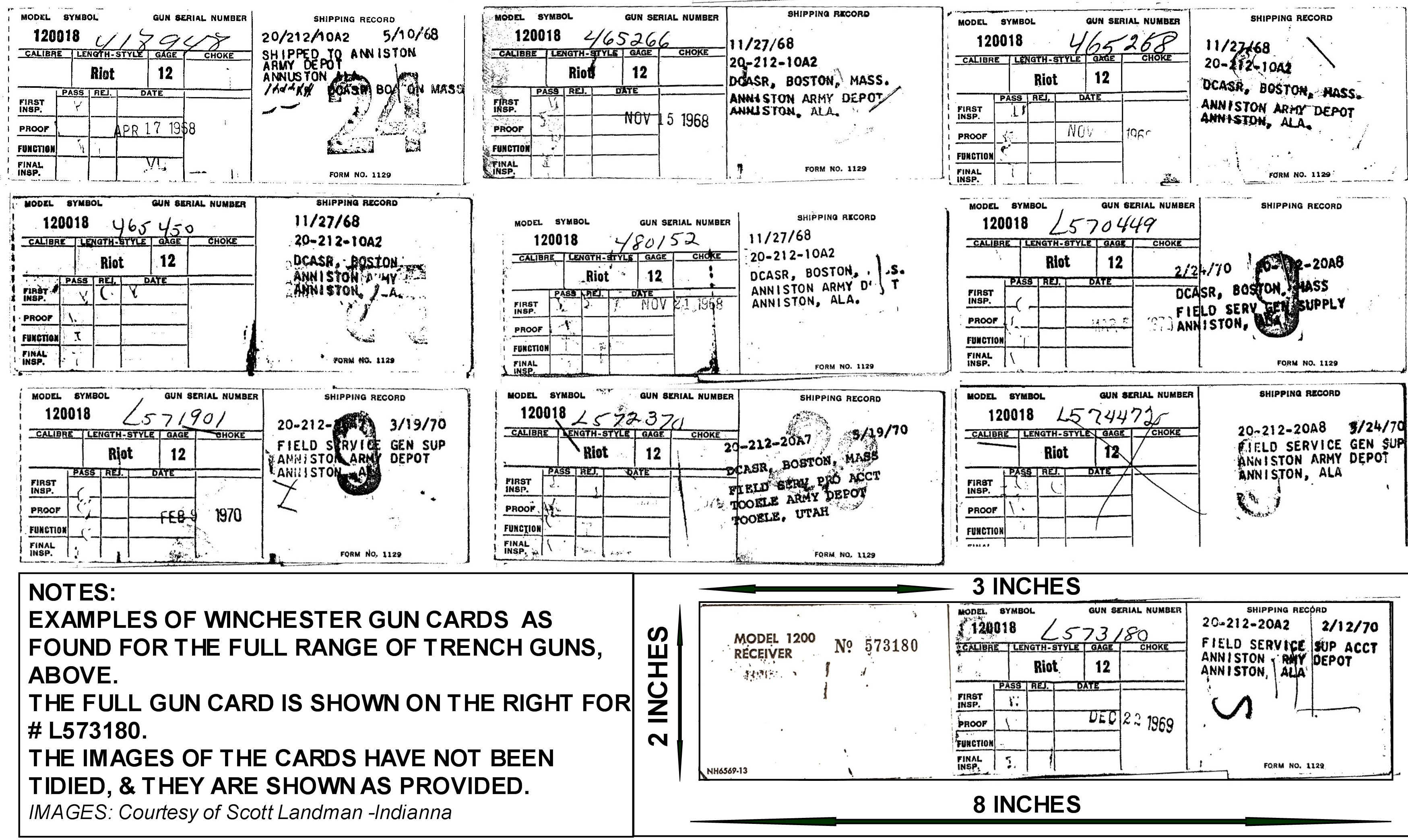

Just when I though I was finished with this chapter, another Collector, Scott L provided me with more useful data, which expanded my database, and narroewd down the range of the 16500 guns the Army ordered.
Has anyone got any Winchester Gun Cards like the ones in “Fig. 4.7.Z. Model 1200 Trench Gun Production Cards” the Z means I have not yet modified Chapter 4.7 to include it.Fig.-4.7.Z.-Model-1200-Trench-Gun-Production-Cards.jpg
The information on the cards is of interest, as they give the date the gun was Proofed and the date it was shipped, and, with the Date of Stamping (from the Stamping Foreman’s Notebook), gives the delay from Stamping to Proofing, the days elapsed from Stamping to Shipping, and the days from Proofing to Shipping.   I have estimated the size of the Cards by scaling the images on the Quarto Backing Sheet.  There are five to a page.  I would really appreciate accurate dimensions of these cards from someone who has an original.  As well, I would appreciate cards from any of the post 1960 Winchesters.
On another matter, at least 692 Model 1200 Trench Guns were sold to foreign countries in 1970-71 under the Military Assistance Program.  A knowledge of these individual serial numbers would be of assistance in narrowing the serial number ranges of the four Army Purchase Orders.
To get these figures one would have to a make a Freedom of Information (FOIA) request.  Below is a link to the FOIA website. The Author is not able to make a FOIA request directly to AMSAC, DSSA or MAP, but some of you Military specialists probably could at FOIA Website:  FOIA.gov – Freedom of Information Act
There are probably programs run by some specific Government Department or Agency, and one would have to make the FOIA request to the specific agency that runs the program. Based on a document detailing the transfer of Trench Guns to a Police Department, I think the place to start is the Anniston Army Depot.
If anyone would like to have a go, I can provide the countries, the number of guns, and the date.  Also included are the other Trench guns bt Winchester, Remington, Ithica and others.
