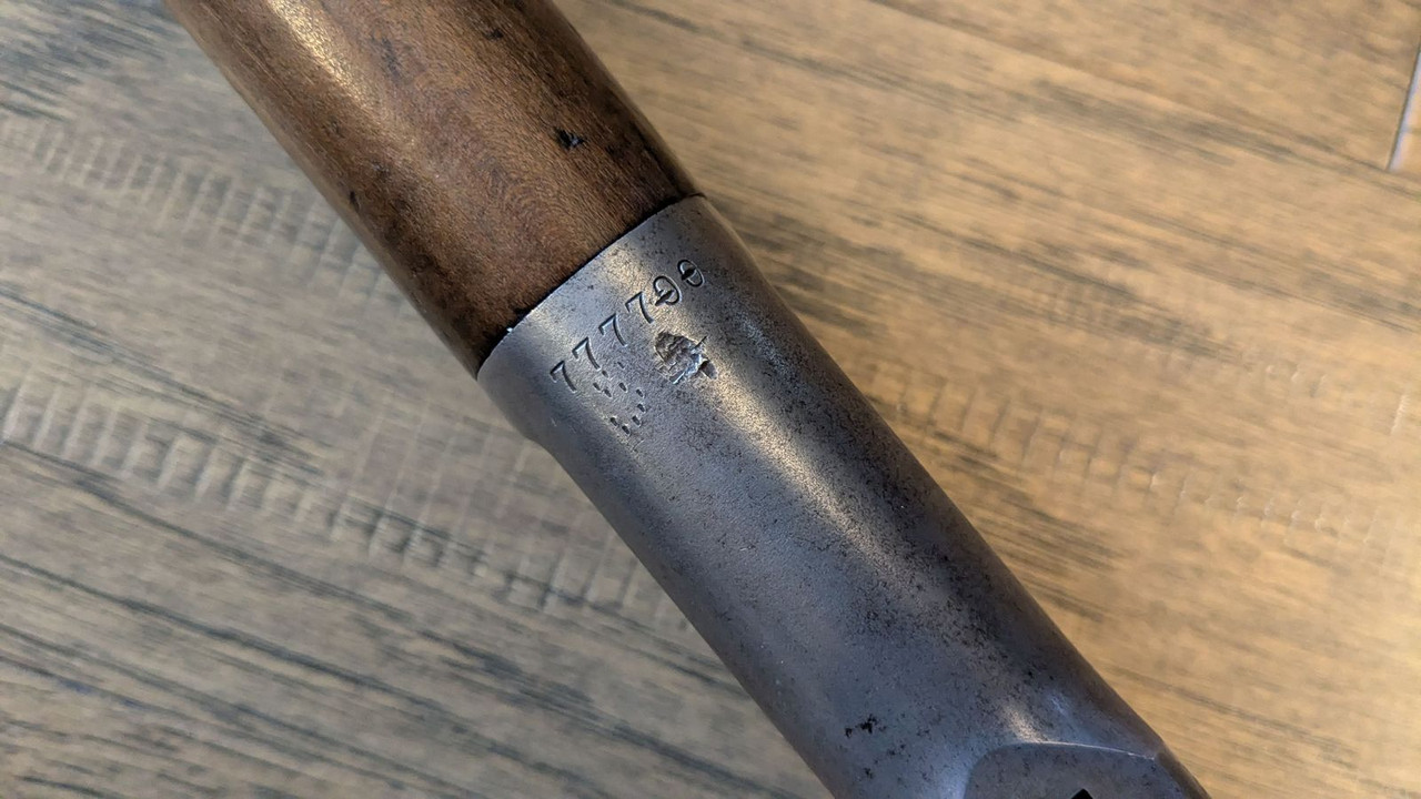

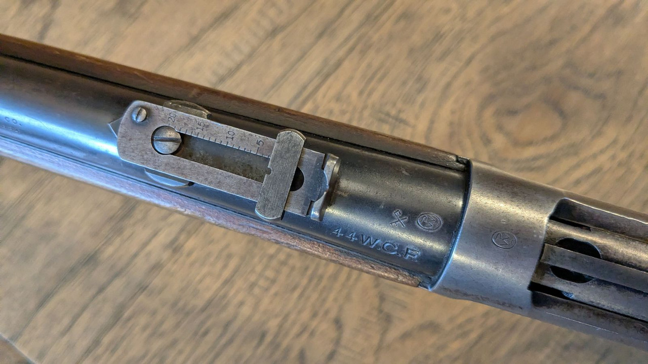

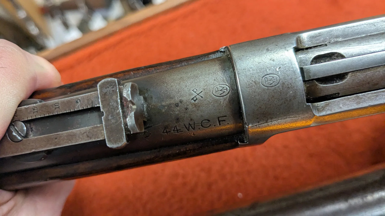

Here’s 7th carbine with “crossed pennants” or “crossed lances”
https://i.postimg.cc/TPHXPyxb/PXL_20251030_191201264.jpg
https://i.postimg.cc/5tkMtHJv/PXL_20251030_191207933_MP.jpg
https://i.postimg.cc/s20R2BzQ/PXL_20251030_191120580.jpg

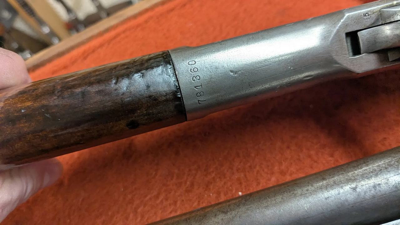

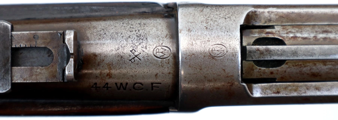

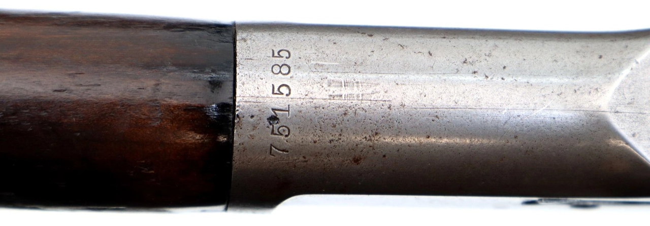

Two more: 751585 (the lowest so far) and  781360
https://i.postimg.cc/wTb50g9t/image.png
https://i.postimg.cc/jSpHYcw2/image.png
https://i.postimg.cc/Y2dQCMLc/image.png
https://i.postimg.cc/TPvD4PFr/image.png
That makes 10 in my database.
Thanks so much

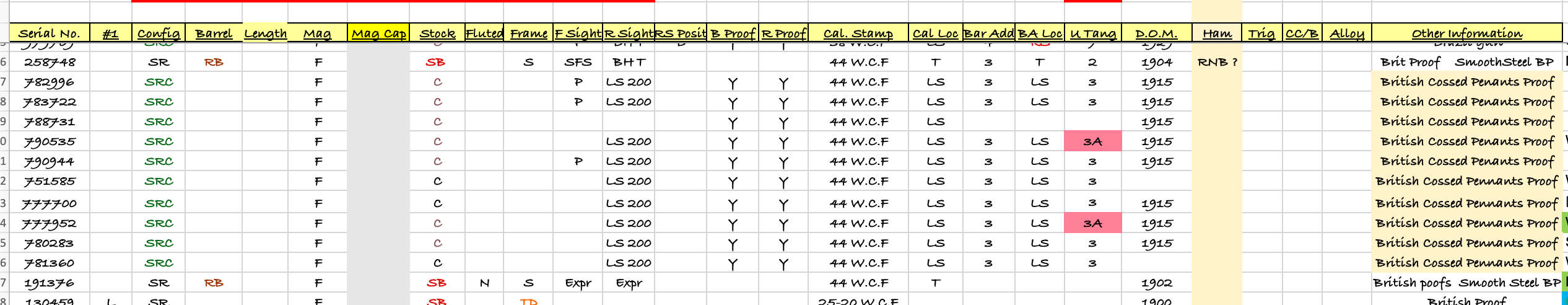

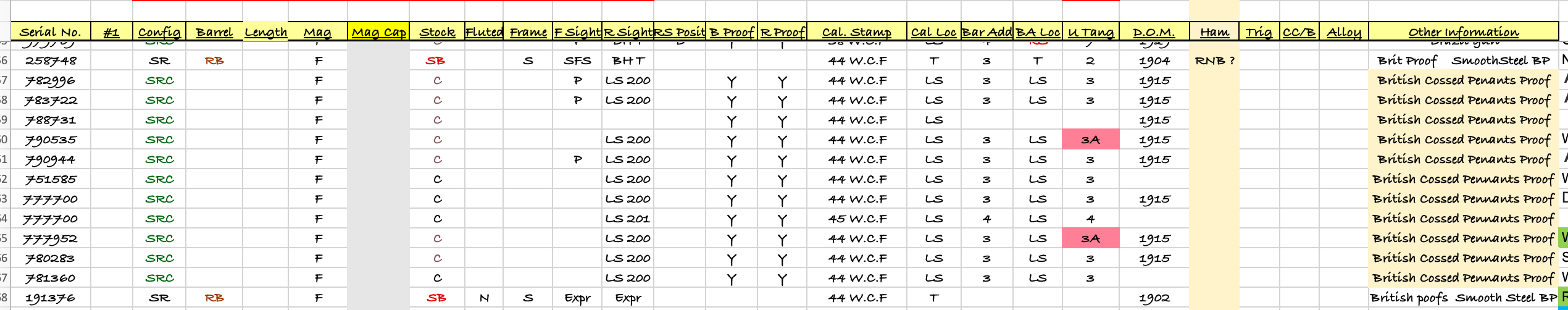

Here is a portion of my spreadsheet that has them.  I would also be very interested in any local Canadian auctions or websites that I can include in my usual searches for ANY Model 1892 rifle for my survey.

Michael,
That’s a well organized spread sheet! Nice work!
Forum Posts: 2760
February 15, 2026 - 3:18 pm
Anthony said
Michael,
I am no Excel wizard by any stretch.  I can obviously search via different columns and progressions of columns to isolate a certain configuration or characteristic.  This is sorted on “Other Information” where i note Things like proof stamps of engraving styles or anything that is typically not consistent over the entire production and therefore I do not have dozens of more columns with info in very few of them.

Michael, crosschecking your and my list I found a serial that is not present on yours – 780257. So total number of serials is 11.
As for for monitoring Canadian market. I monitor auctions, some Canadians stores that specialize in vintage firearm, local gunshows. I plan to continue to share my finds with you and Bert (in case of 1894s). I suppose the only thing you can monitor remotely is auctions – go to iCollector, filter by Canada and Firearms/Guns type of auctions. Big 3 of Canadian gun auctions are Switzer, Landborough and Ward. Mind that descriptions are not always to be trusted. Last Switzer auction had 751585 listed as “DCP marked” gun.
