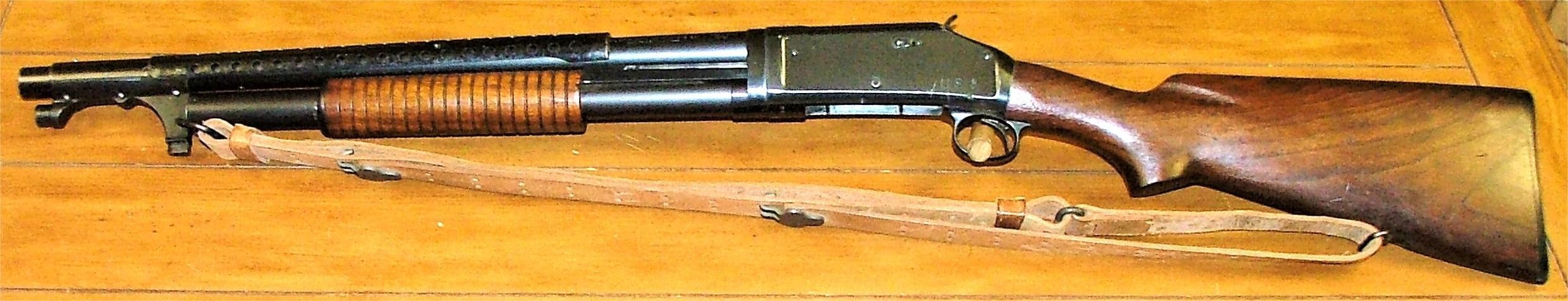

Your pics show the gun to be parkerized or devoid of blue. Originals had a deep blue. Maybe it just the photo’s. Two grand is a good price. Attached
is a pic of mine. It too s a late gun. Later than yours. Big Larry

Great looking shotgun! Yeah, I do think mine has been refinished. It’s more of a very dark, polished grey now vs the deep bluing on yours.
Which is fine, I don’t plan on ever letting it go as it’s one of my grail guns. Do you know if they were ever refinished at arsenal or was this likely done by a previous owner?

The various Arsenals did refinish guns that needed it, but they will usually have markings on the gun that identify the specific arsenal that rebuilt/refinished the gun.
