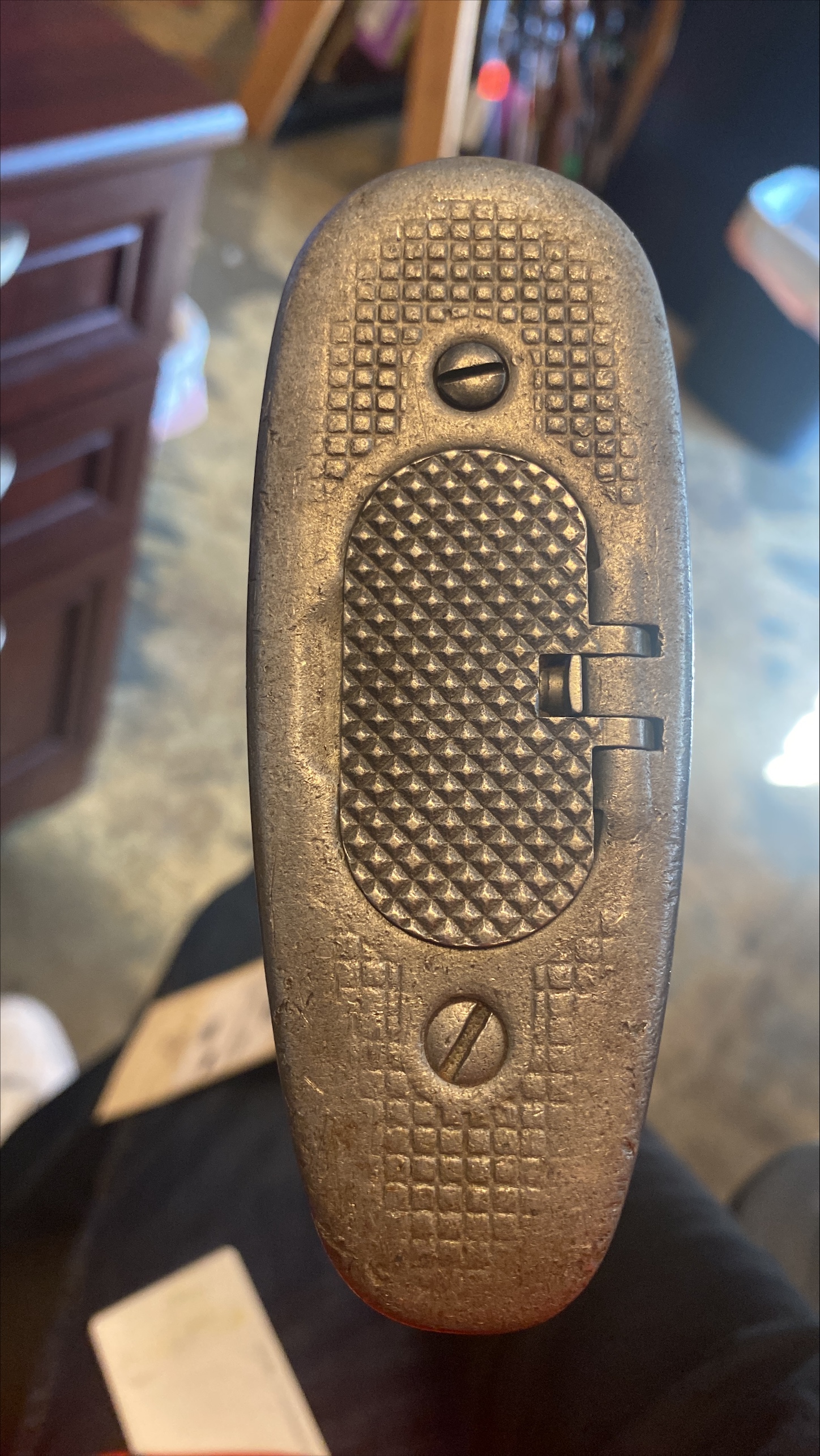

I would also like to see pictures of the butt plate…
I’ve requested a photo of the butt plate, thought the same thing. I’ve purchased firearms remotely from Collector’s Firearms before, very legitimate location from what I’ve found. But it was odd they didn’t include a photo of the butt plate.
You need a picture of the underside of the buttplate too but you may not get one. Winchesters are marked S2.  A good picture of the front barrel band would be nice too.  I talked to my friend about this gun and I am sending him the listing so he can look at the pictures.  He really did not like the fact that there are no visible cartouches.  Stocks can cost $800 or more.  He doesn’t like the fact that the rear sight does not have the locking bar.  The sling could be correct.  They did use the khaki colored slings early on before the more common OD green.  I’ll let you know more after he looks at the posting. Take a look at Larry’s gun. He shows what the cartouches look like and one side of the rear sight.

October 16, 2022 - 2:06 am
11B826C5-CD1D-42BE-87CF-5002CE1FE916.jpegButt plate pic sent today, attached FYI.
Here is my friends reply.
Chuck:
The problems I notice with the WRA M1 are:
The sights are 1947 post war replacements and the peep is not WRA.
The wrong rear band, it should be grooved.
No cartouche which should be WRA/RS with an ordnance wheel. The profile of the stock doesn’t look like a WRA stock.
The early S/N looks like one of the educational rifles which had a solid Butt plate, no door.
There may be more wrong but that is all you can see from the photos.
October 17, 2022 - 9:28 am
Chuck said Here is my friends reply.: The problems I notice with the WRA M1 are: The sights are 1947 post war replacements and the peep is not WRA. The wrong rear band, it should be grooved. No cartouche which should be WRA/RS with an ordnance wheel. The profile of the stock doesn’t look like a WRA stock. The early S/N looks like one of the educational rifles which had a solid Butt plate, no door. There may be more wrong but that is all you can see from the photos.
 Ok, ok, some trivial problems…but then the gun is only 4 Gs!  What, you expect perfection?
