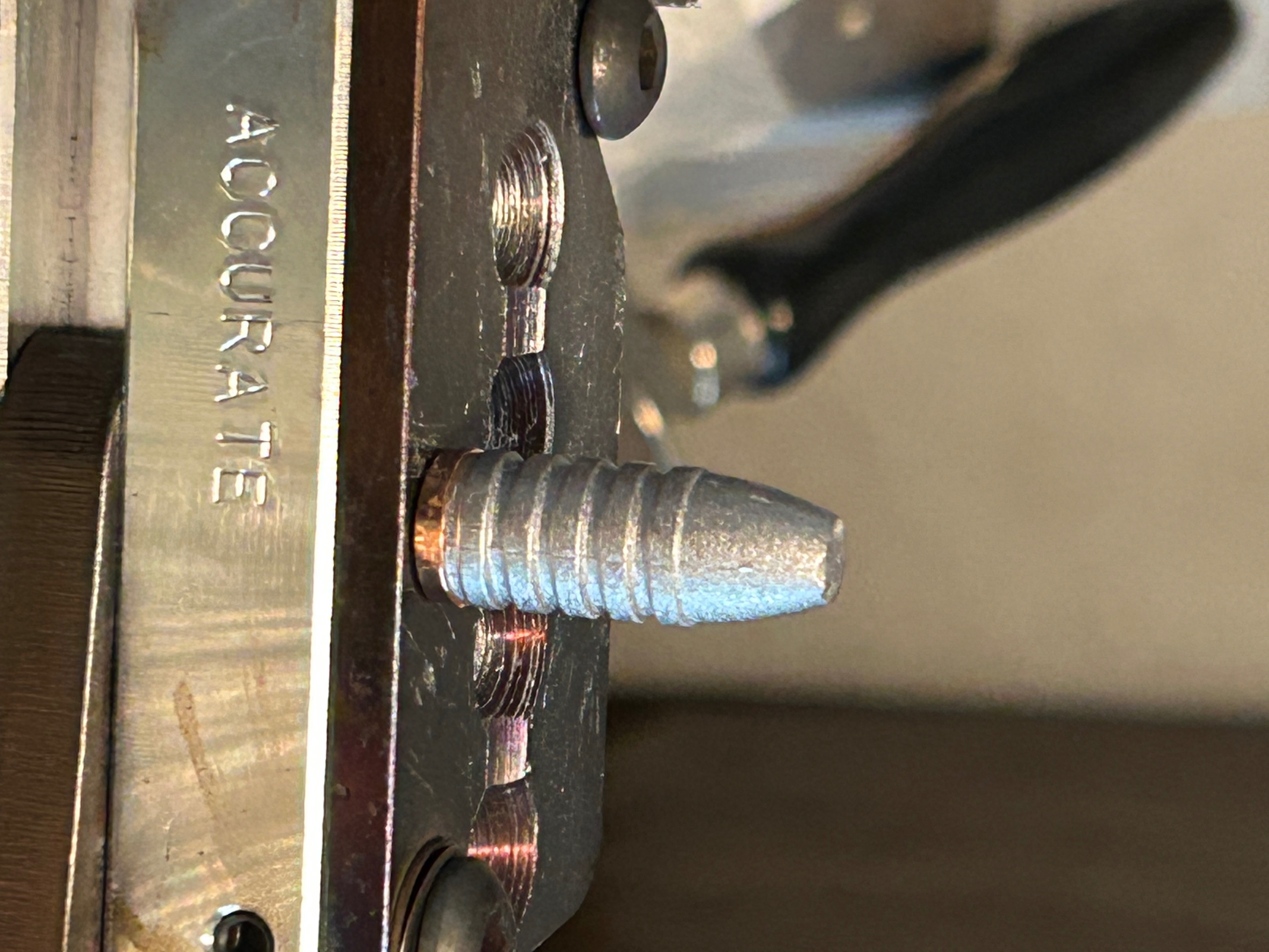

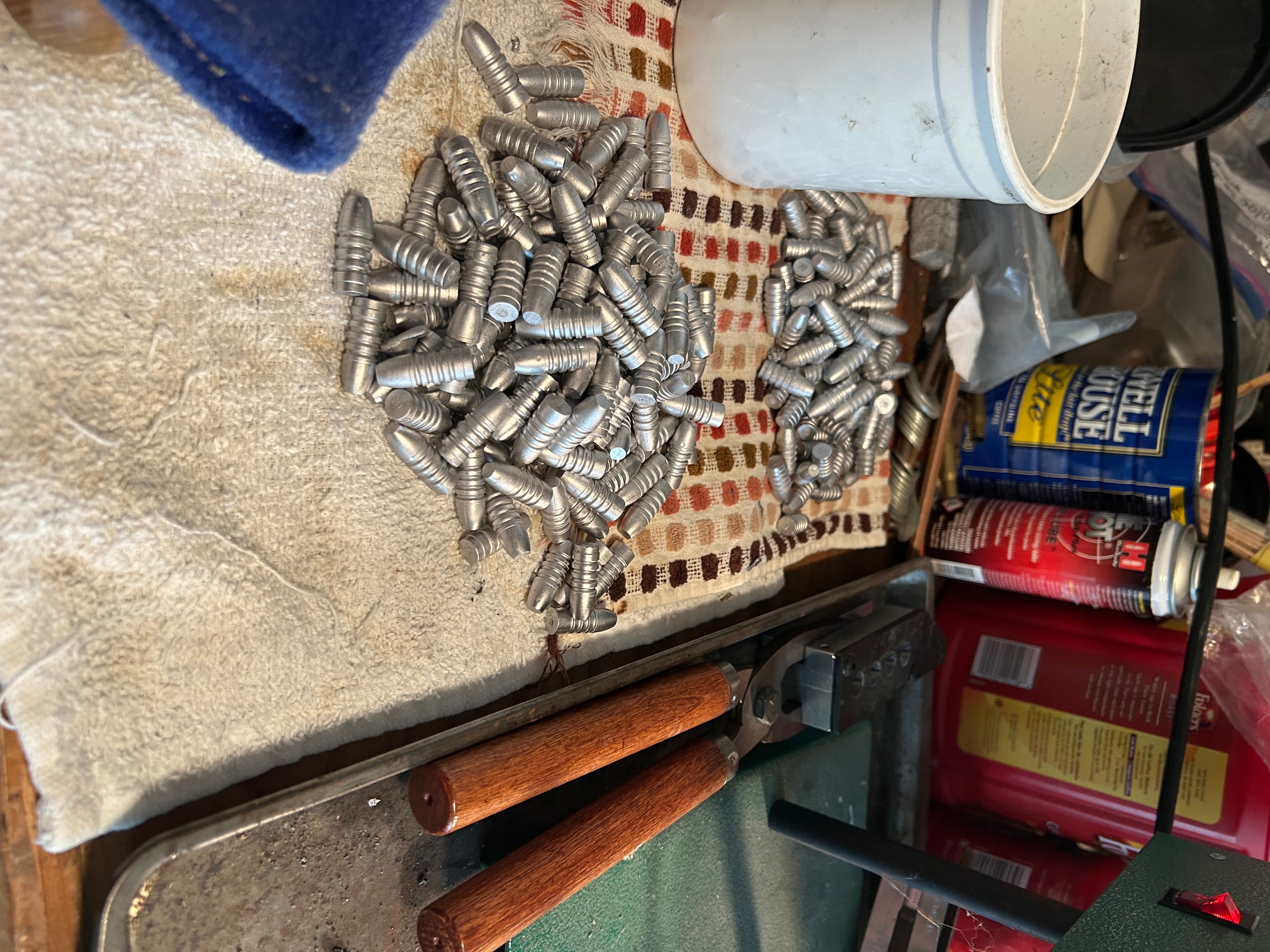

I love my morning walks but my neighbors’ driving “skills” are scary on a clear morning. Cool enough for my casting PPE so I killed some time in my loading room. I wanted to test a mould modification, check shank was a few thousandths undersize. Perfect snap fit! Was also running low on bullets for my 38-55 project. Fresh bullets quicker than Amazon!

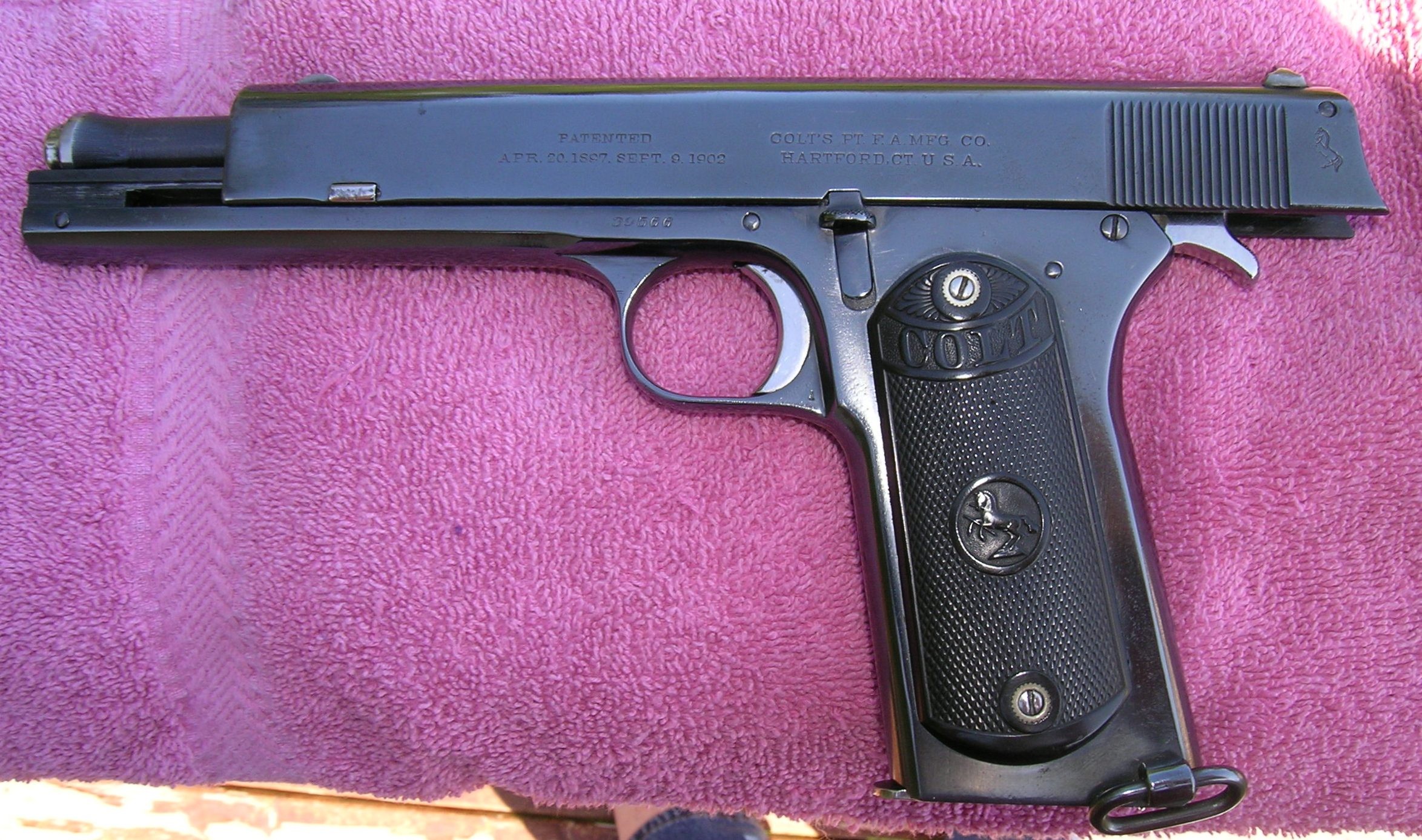

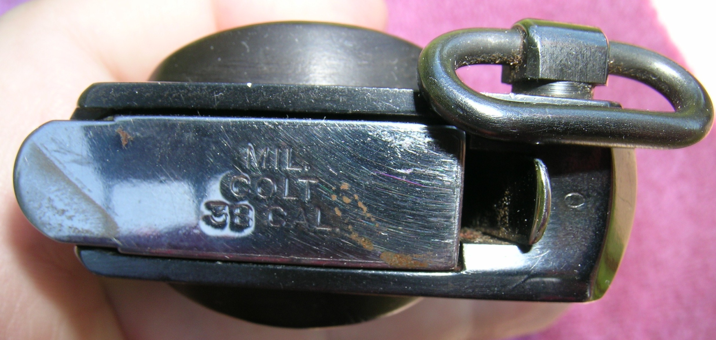

The weather has been rather grim and foreboding out here in western Washington (lots of strong wind & rain the past few days), so I too spent some time in my “Man Cave” loading.  Late last night I loaded (200) fresh (once fired) 9 MM cartridges… 5.0 grains of bullseye under a 115-gr Speer FMJ.  I have another 2,800 empties to prep and load (it will be my winter project).  After I finish that, I have (300) 38 ACP cases that need to be loaded (for my Colt Model 1902 Military).

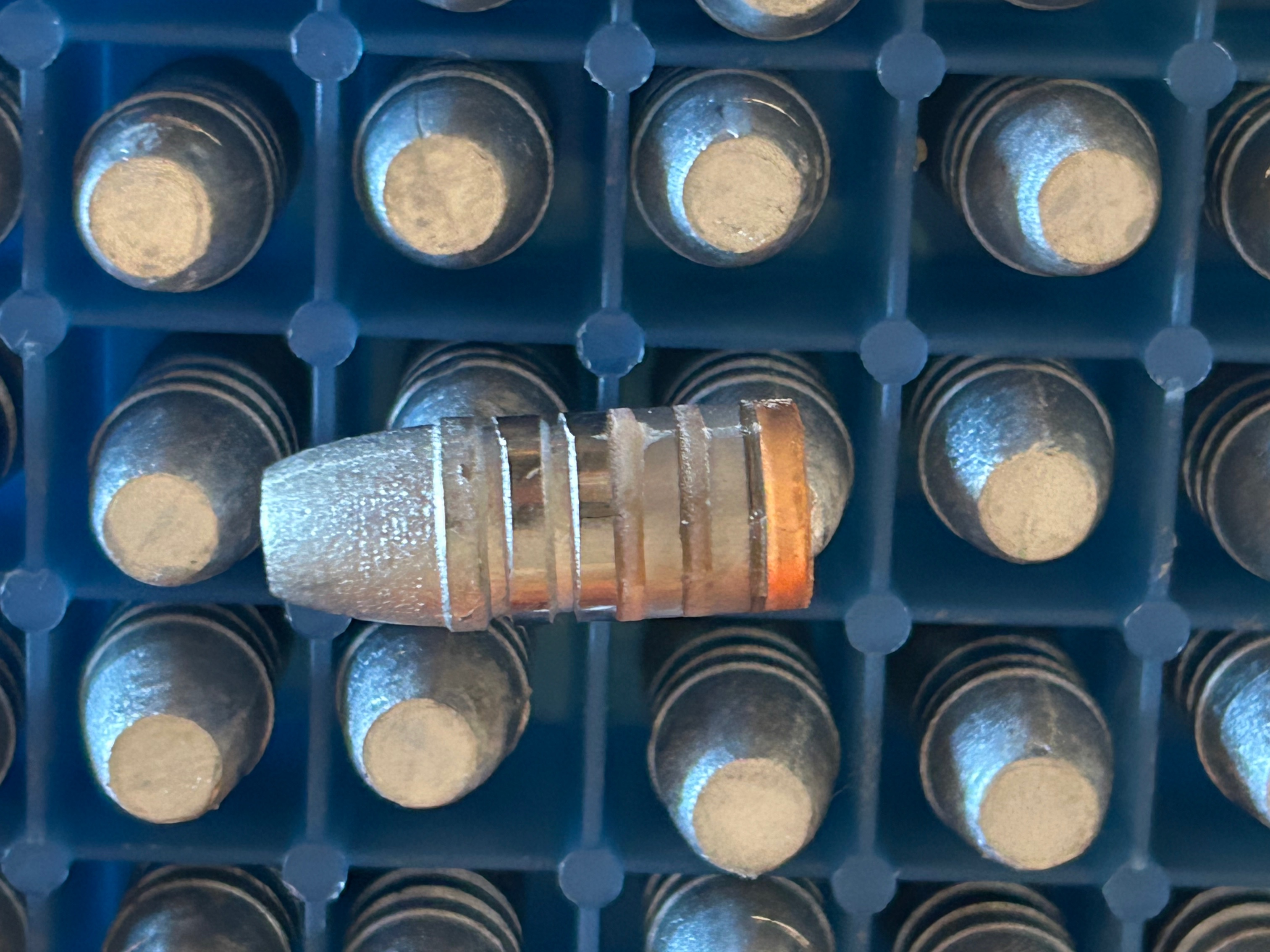

What diameter are your bullets?  I need some 38 cal bullets that are .380″ or very close to that.
Nice pistol.  My favorite Model of the early Colt semi autos.
Thanks, it is the only Colt auto I own that is not a Model 1911/1911A1.  I load for it using an original Lyman Ideal 310 tool & dies.  It is a bit time consuming, but it allows me to mentally unwind and do something constructive with my spare time.

October 26, 2025 - 6:31 pm
Chuck-
My NOE mould drops at just over .380″ with WW alloy, my Accurate mould drops at .384″. I size them to .381″. Both shoot pretty well in a .380″ bore.

Forum Posts: 7702
October 26, 2025 - 7:50 pm
WCC is good brass, never had a 9mm that was picky so I just tumble the brass and load in my Dillon. Haven’t had a wondernine in quite some time, should probably buy one just to shoot the ammo I have around here. I loaded the 9 with Unique, a rather snappy defense load that I won’t post here. At that pressure Unique is actually not terribly dirty.
I think them bullets have cooled enough to size! More importantly the casting furnace has cooled enough to set it off the bench. Takes awhile for 20+ pounds of lead to cool down from 700 degrees.

I think I make a pretty sexy bullet. Or maybe I need to get out more.😉

Chuck-
I see that Bear creek has a .380″ diameter bullet.  It’s a bit heavy but I can cut off some of the bottom.  I slugged the barrel and it is .380″ in the grooves and .374″ at the lands.

Chuck-
Bear Creek lists a 255gr bullet. The problem with bullets over bore diameter for the 38-55 is they often won’t chamber. I suspect original factory loading used bullets of about .377″. .380″ is about as big a bullet as you can get into a Starline case and get it to chamber without applying a very slight “taper crimp” with your sizing die.

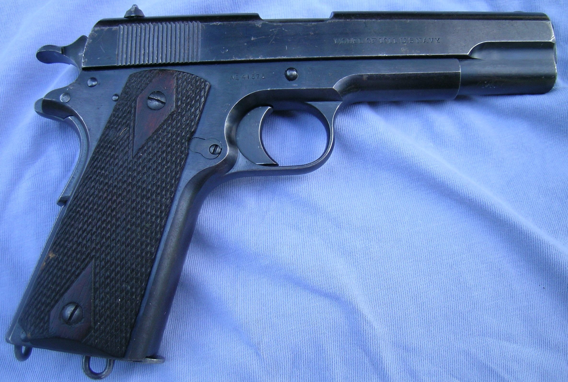

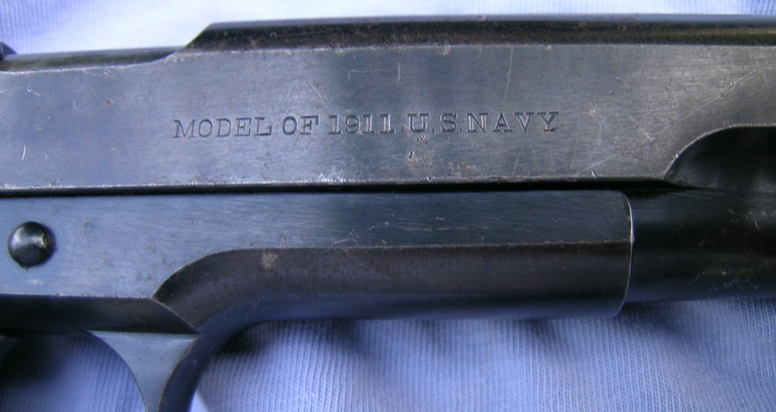

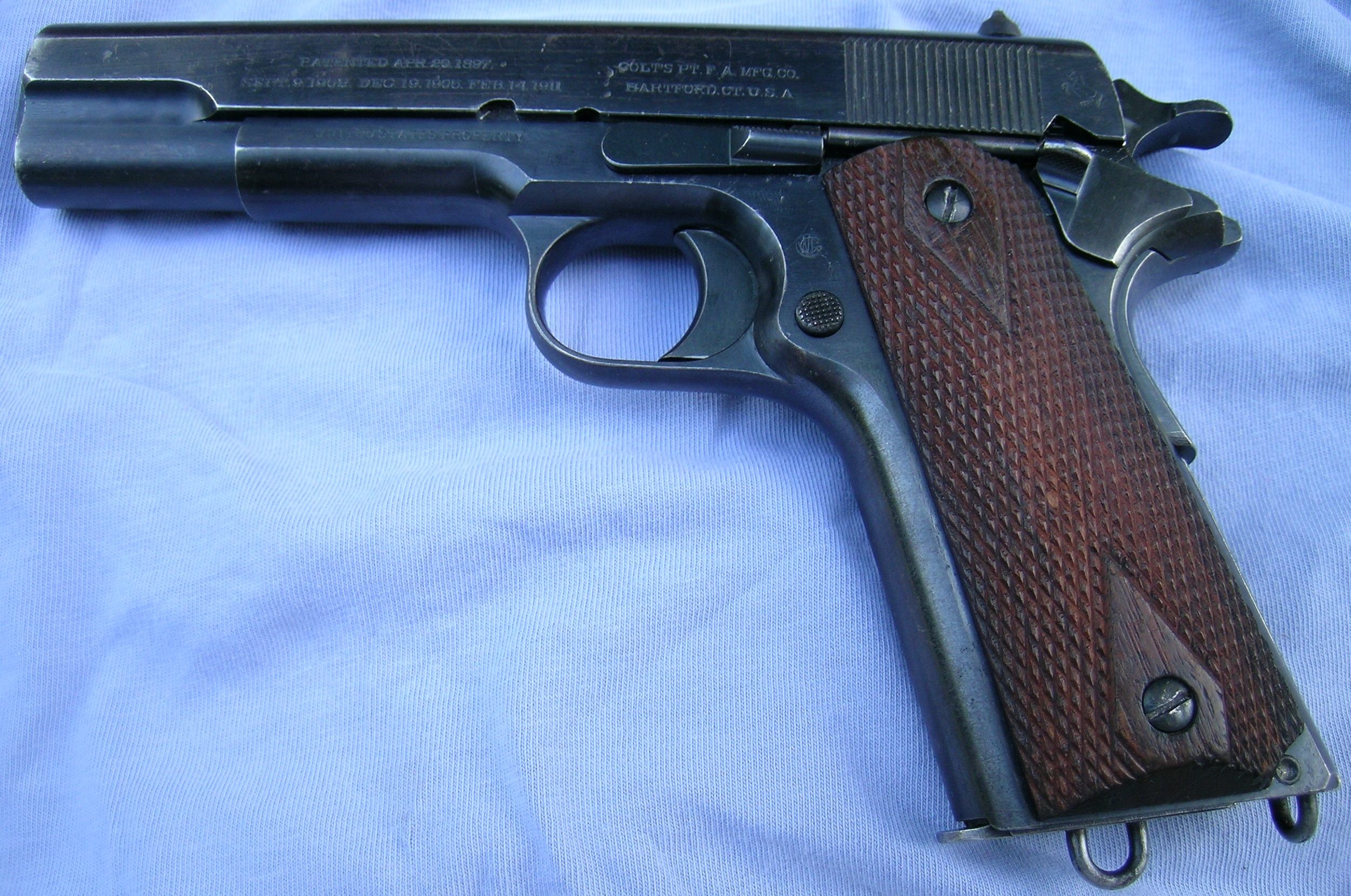

Actually, I don’t, but I make up for it by not sleeping very much.  Old habits (life on a submerged submarine) caused me to develop strange sleeping habits.
I have just two Colts in my collection… the Model 1902 Military 38 ACP and this one…
